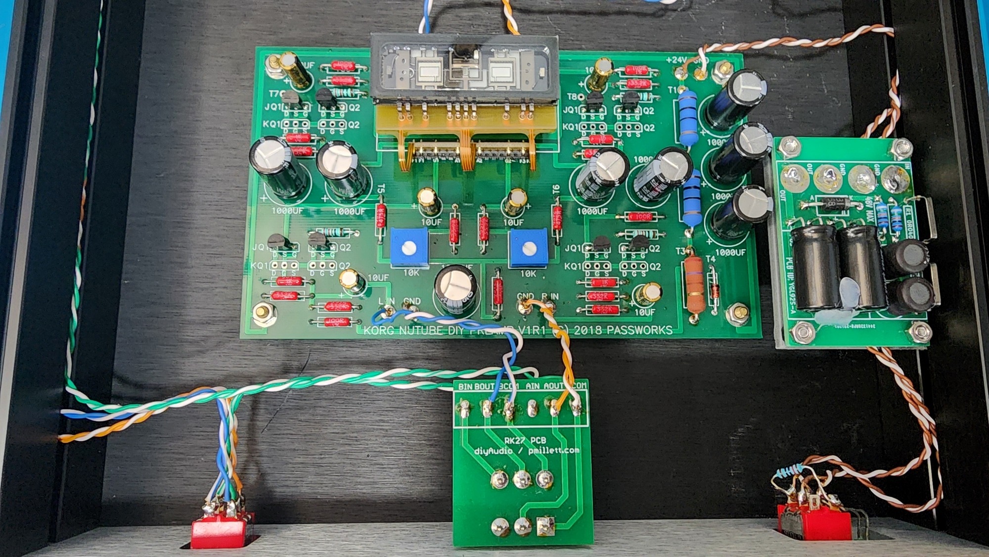

Do you have actual pics of your build (nutube cover)? I'm curious how it looks, as I can't imagine how it looks based on your description alone.

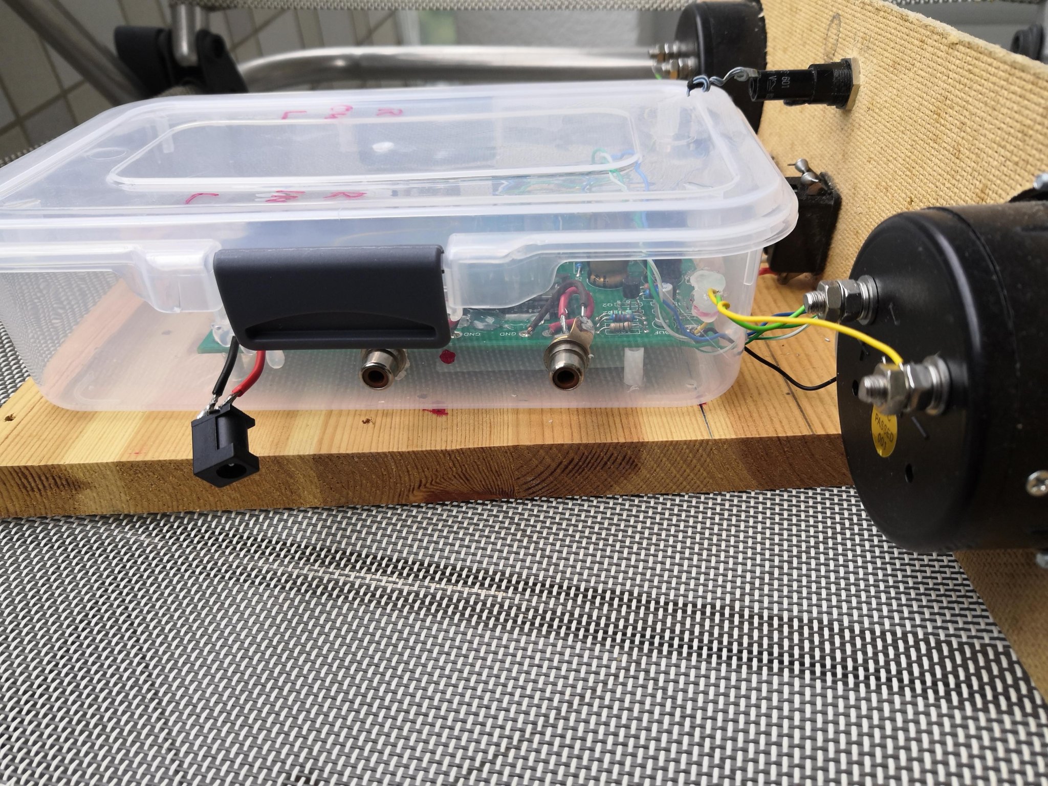

How much hotglue did you use on the NuTube? Under it, or did you apply it over and all around? As to the plastic box, can you explain more clearly. The NuTube and PCB is in a plastic box inside the case?

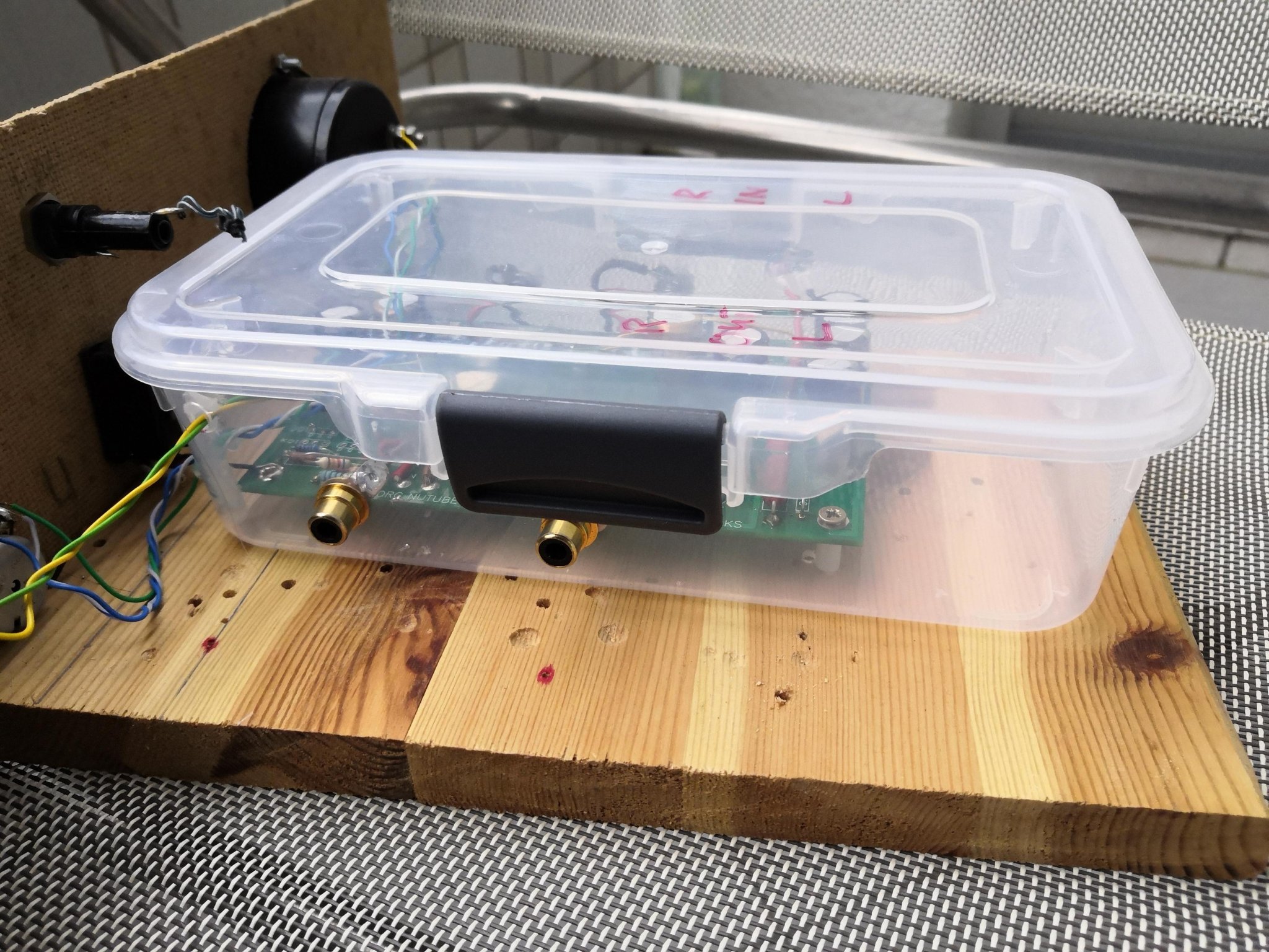

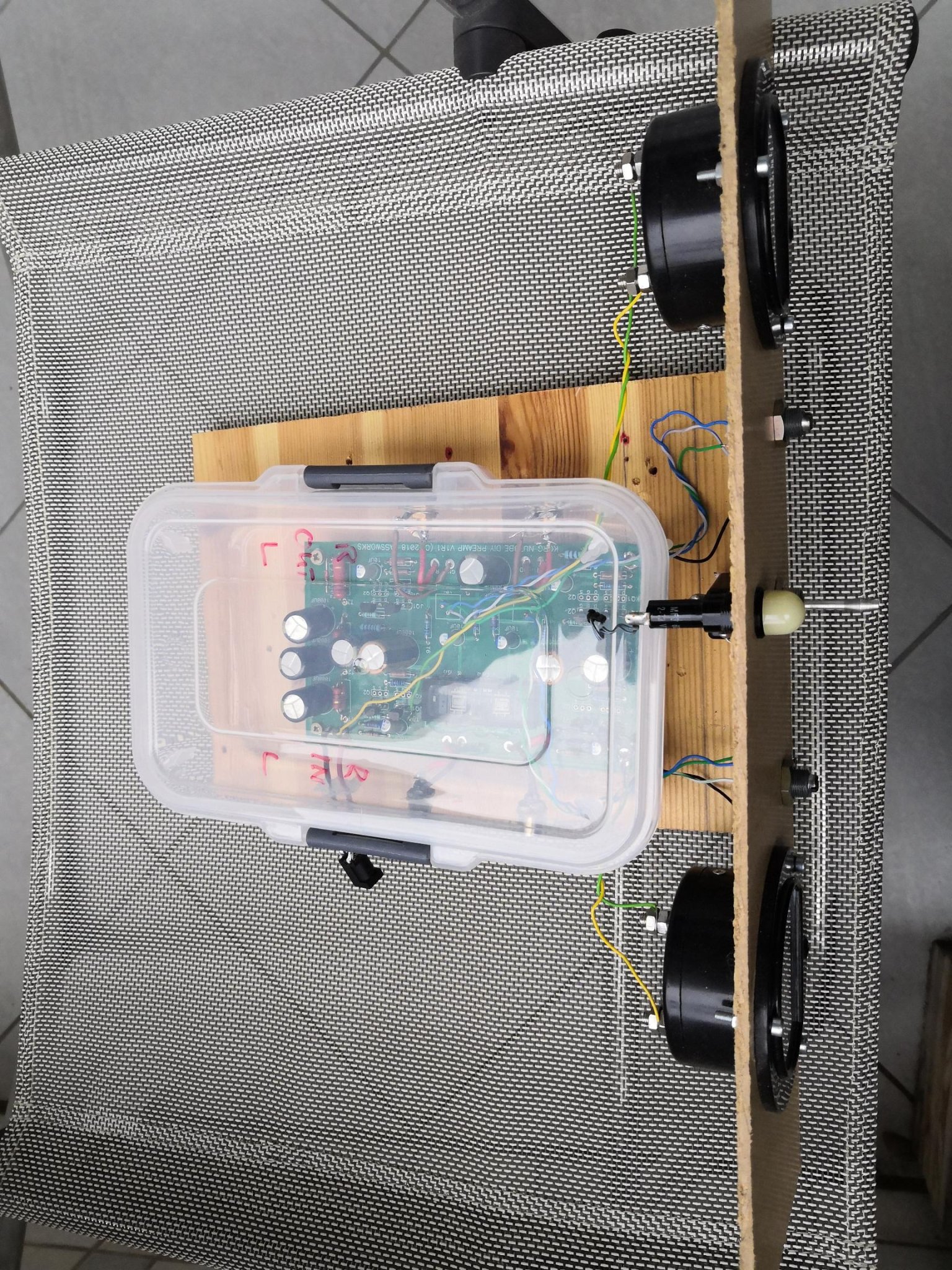

Hi, sorry for the delay.

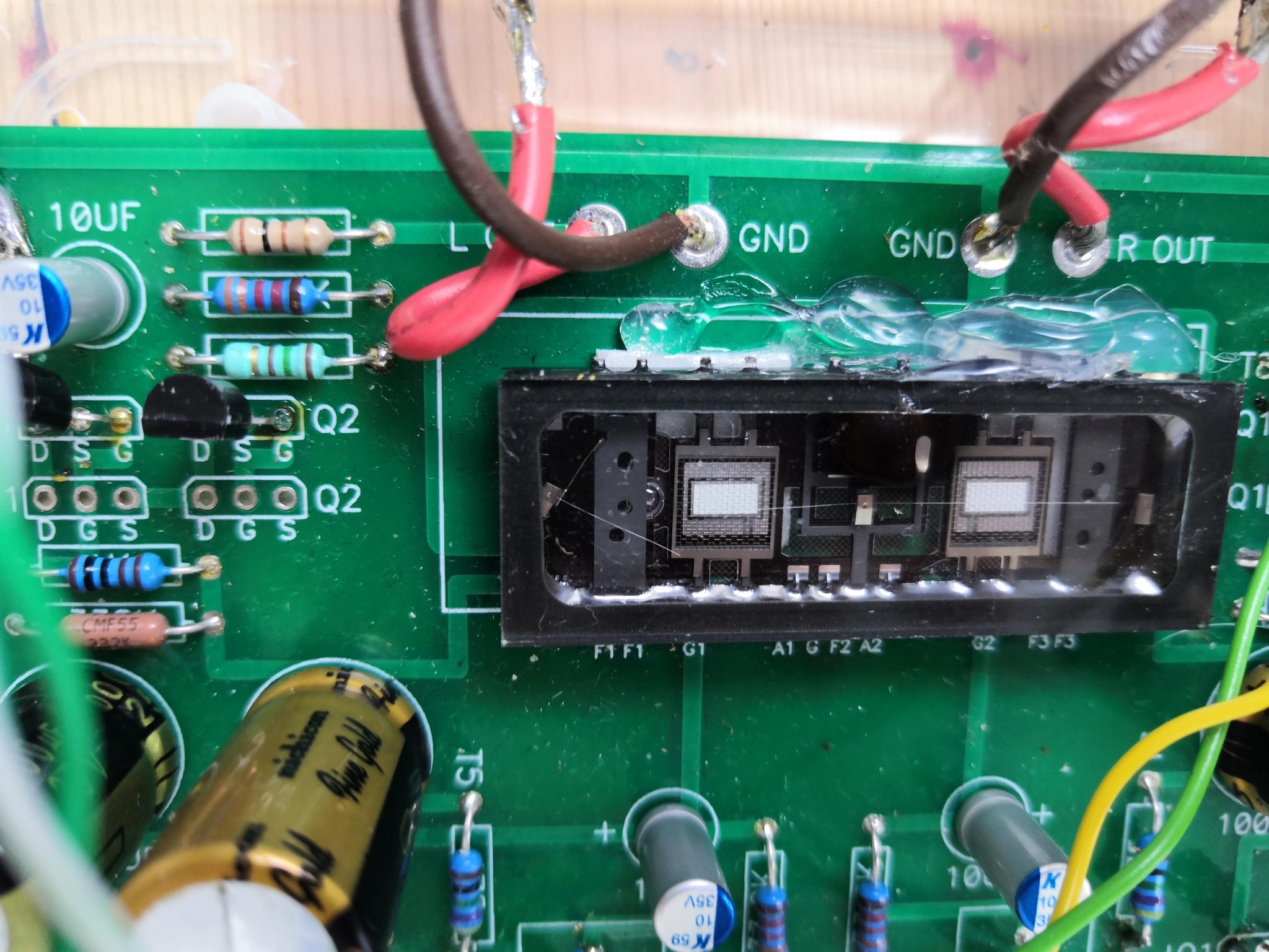

I applied hotglue just to the long side of the Nutube were there are no connections to the PCB. As I could not remove the double sided tape I just put hot glue at the edge approximately 3 - 5 ml. Just enough to fix the nutube to the PCB.
As some members cited accoustical feedback to the nutube (air gaps in the enclosure were closed etc.) I bought a plastic container for food with a lid. The whole PCB is inside the Box. Made holes for Input/Output and DC. Sealed the holes with hot glue.
The critical measure was to fix the Nutube to the PCB. I can literally drum with my fingers on the container with no feedback at all. No drumming sound from the speakers.
My Nutube is dead on one channel. No light any more on this channel. The miniscule wire which runs over the enligthed window (do not know what to call it exactly) is broken. The unit worked for about one to two weeks continuously. I sounded marvellous.
It was not moved. No mechanical shocks. It was just sitting there. For 50 USD a piece it is an expensive experience.
Any help?
Here pictures of my (dead) Nutube. I just startet to build a nicer enclosure.

Thanks for the clarification and photos. Very helpful. I will try the hot glue method first, as it will be easier than de-soldering. My NuTube came with a two very, very thin pads to mount it on, so there is space between the PCB and NuTube on the long, un-soldered side.
My double side tape also has lost its stickiness and after pulling off the eraser I have a thin film of easily removable goop atop the NuTube. So I need to clean the top of the NuTube and try with better doulbe-sided tape.
Hopefully that and the hot glue will help.
Personally, I would not use hot glue on the case of the NuTube. It could possibly be the cause of filament failure (heat stress/expansion on the case causing increased lengthwise strain on the filament). Why add yet another possible failure mode? I suggest using some ordinary adhesive, assuming that the glue does not touch a seam on the szce (again, trying to avoid adding a new failure mechanism.

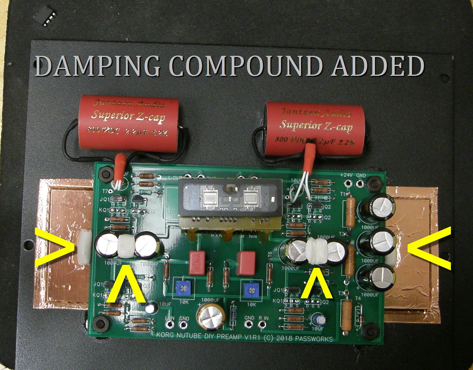

It's been mentioned before I'm sure, and I'll add it again that Pete Millet sells an anti-vibration mount for the Korg. I'm sure you could reach out to him, or use ebay as I did. I've built 3x Korg B1's and as of tonight all three now have the anti-vibration mount and SMPS filter board.
It works well, although you can't use all the foam pieces included in the kit as it will touch the top of the store chassis (learned that one the hard way). I just cut the white foam piece in half to reduce the stacked height and it fits nicely.
I just installed one tonight on my first Krog B1 build (I didn't have the fancy anti-vibration mount on hand for that build), which required me to de-solder (very carefully and patiently) the Nutube from the board, and then reinstall with the anti-vibration kit. I also added the SMPS filter board while the case was open. I 3D printed a beam to hold the SMPS filter board which slides into the rail slot in the side of the Modushop chassis with a little sanding of the beam to ensure a tight fit into the slot (attached as ZIP). I took some photos so I thought I would share what it looks like in a mosaic (see pdf).

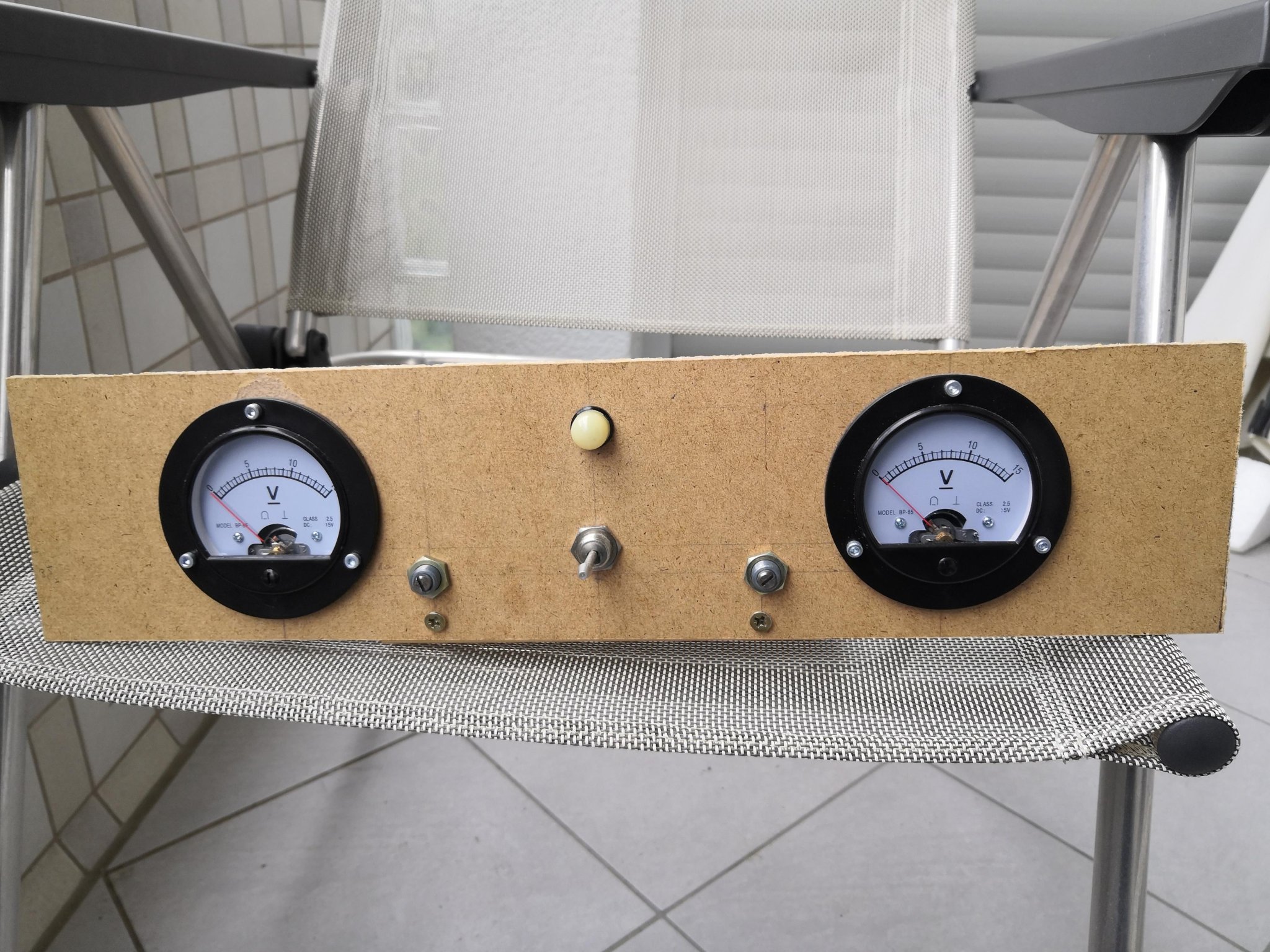

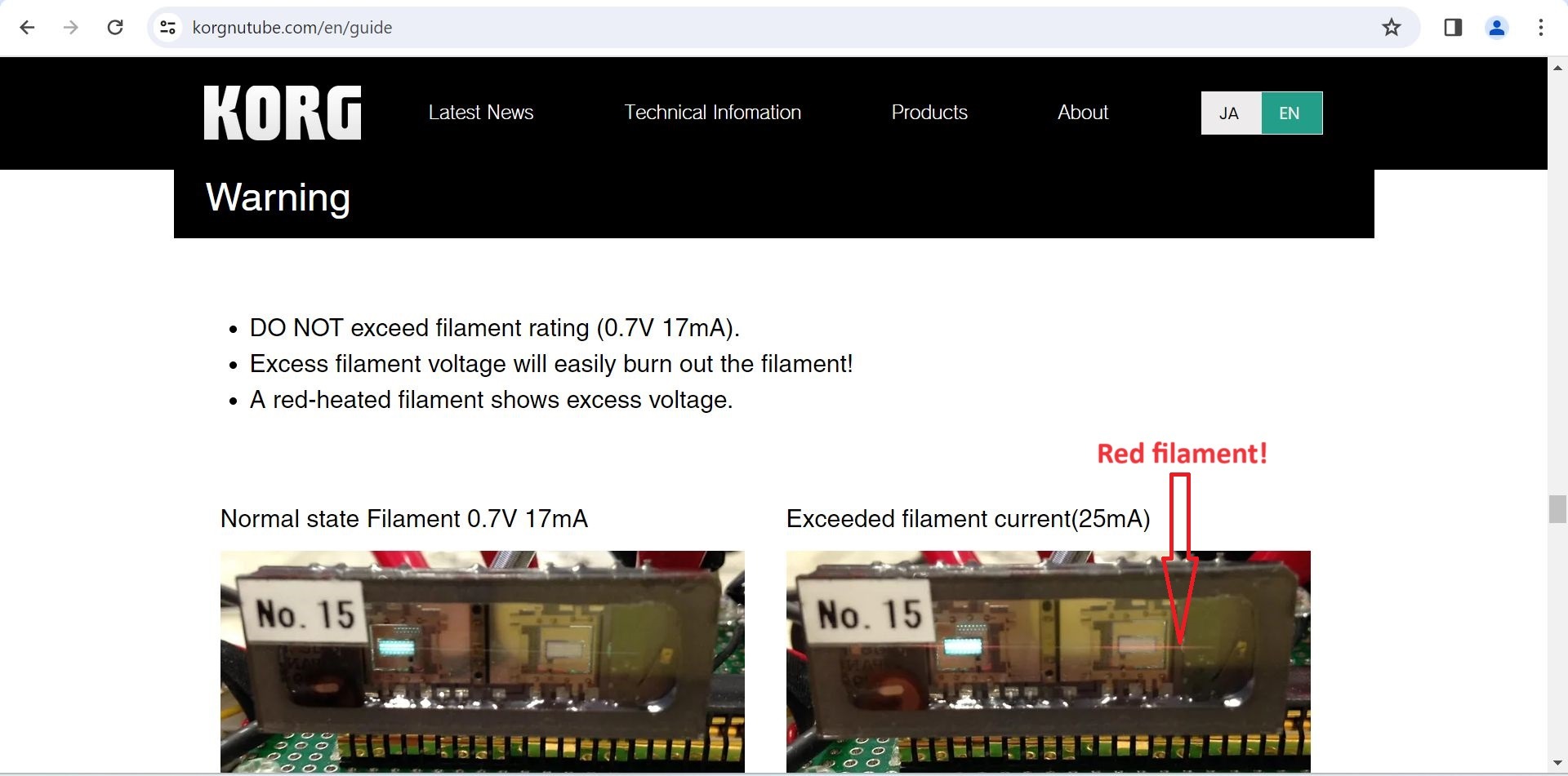

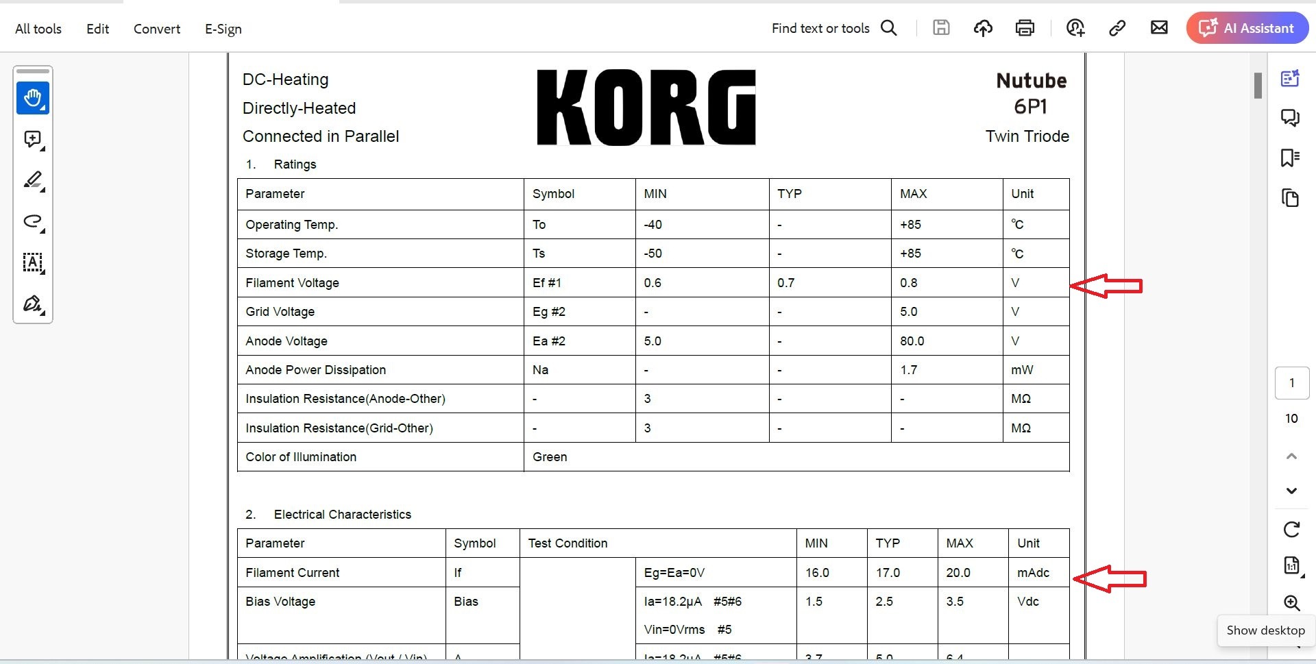

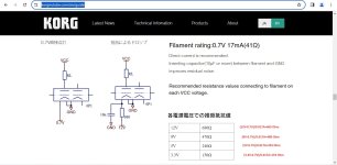

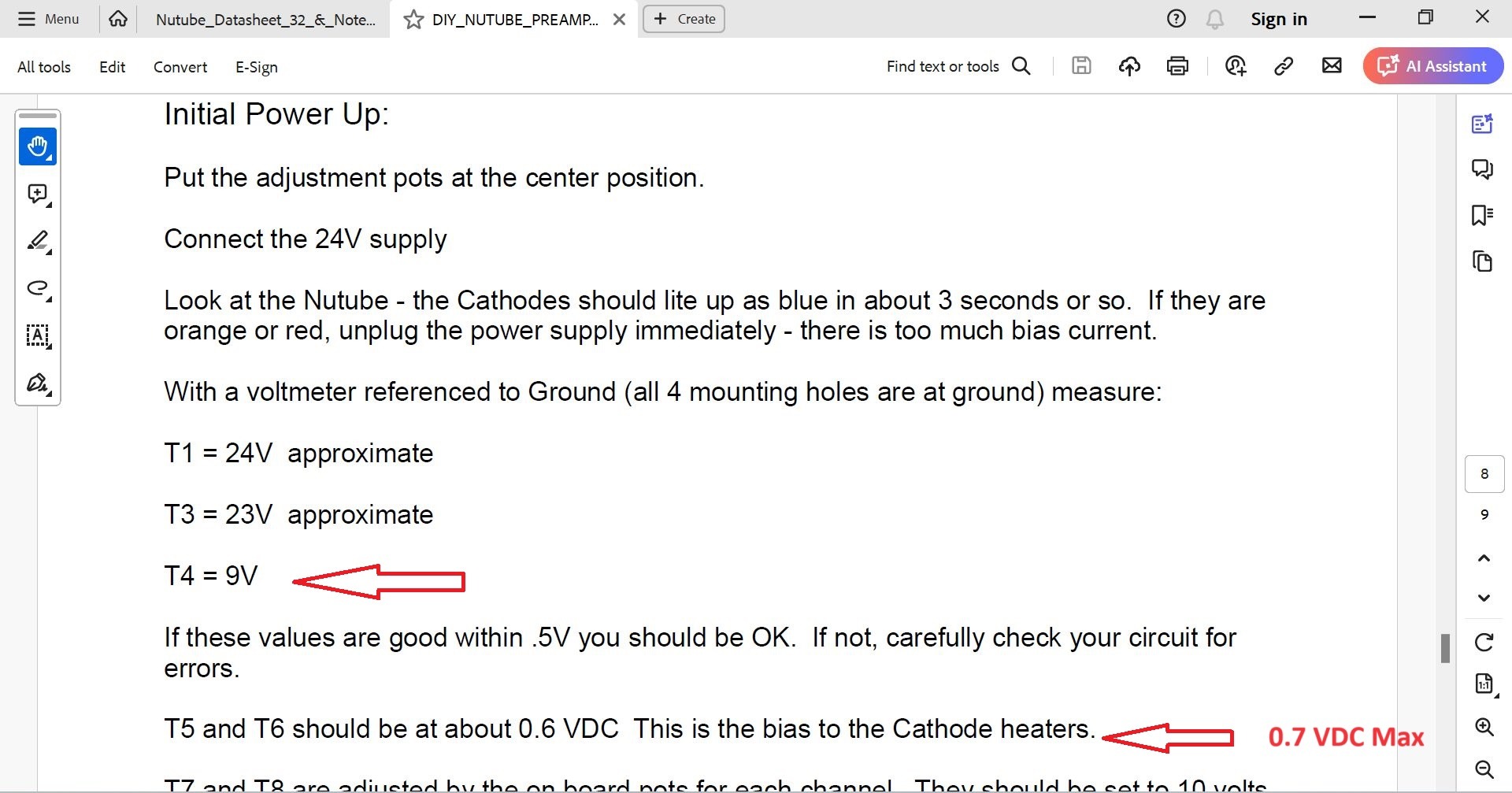

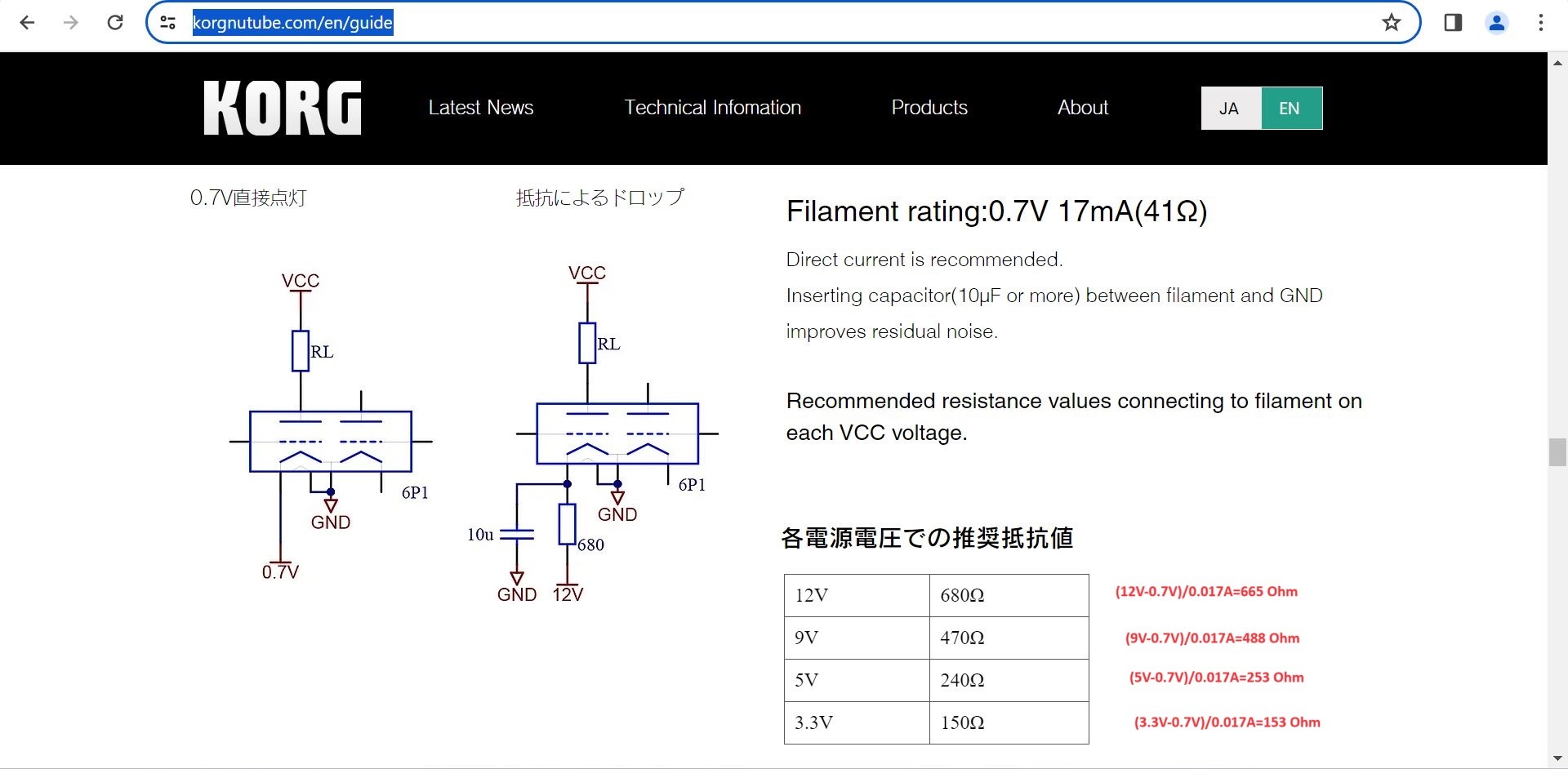

The information published by Korg warned of excess filament voltage, which may destroy the filament. So from a diy construction standpoint it is important to measure the filament voltage. On the B1 Korg, that would be the voltage at T5 and T6. Nelson noted in his DIY Nutube Preamp pdf article that the voltage should be at about 0.6 VDC. Note that Korg specified this to be 0.7V maximum. Anything higher is too high!
Another voltage to be careful of is the voltage at T4. This is set by the 9.1V zener diode in the power supply section. This voltage is the supply for the Nutube filament. Electronic components, including zener diodes, have manufacturing tolerances. With the specified zener diode the tolerance is +/-5%. So the voltage may be somewhere in the range of 8.65V to 9.56V. The high voltage is a concern as that may cause an overvoltage problem at the filament.
So measure T4, T5, and T6. If they measure high, further investigation and changes may be necessary. Potential fixes would be to replace the zener diode if T4 is too high, or change the 475 Ohm filament voltage resistor if T5 and T6 are too high. T4 may be at 9.1V but T5 and T6 may be high if the Nutube draws less than 17mA of current.
Looking at the Korg Nutube website their recommended voltage dropdown resistor for the filament seemed a bit low for 9V. A higher value resistor would be beneficial in keeping the filament voltage within specification. That would be even more critical if the supplied voltage is much higher than 9V and if the Nutube filament draws less than 17mA.
https://www.korgnutube.com/en/guide
  • DIY_NUTUBE_PREAMP_Revised_2020-07-25.pdf Initial powerup filament voltage.jpg
