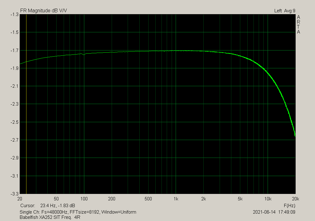

Zen Mod, please do you expect a big difference in distortion at higher frequencies between the two devices? I saw your frequency sweep but am wondering if the SIT geometry offers any advantage up there when pushed. (Probably not given they are both large devices but who knows...)

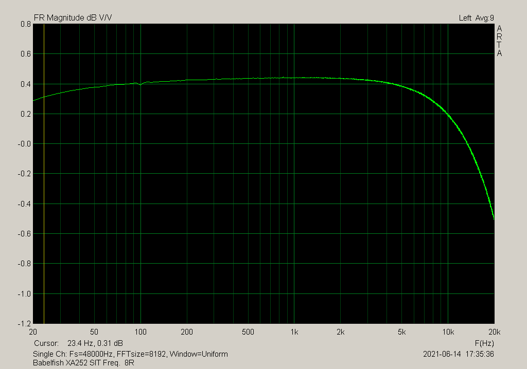

all MOS iteration, even if we can see tiny roll-off at 20K, in listening tests didn't rise a brow regarding bloody anything
so, looking just at Freq. graphs, comparing all MOS and DEF iterations, DEF is looking more linear up, but - as I said - MOS is flawless, so what one can expect from even more flawless?
I know main culprit why there is little sag at 20K in MOS version - generally, I was overcautious with cap compensations everywhere, main reason for that being that I wanted to have relatively broad range of BFR values, without need for varying feedback lag cap ( there is none in present amp, even if there is position on pcb, and it is shown on sch)
so, I got that ; looking at 10K squares, with 22R for BFR , there is sliiiight overshoot at leading edge, while with 510R as BFR - there is sliiiight softening of leasing edge

Thank you Zen Mod. I was not clear, sorry. The small roll off, especially above 15K, is of little concern to me, having played with speakers, placement, crossovers, etc... Agree with you there are bigger factors at play there.

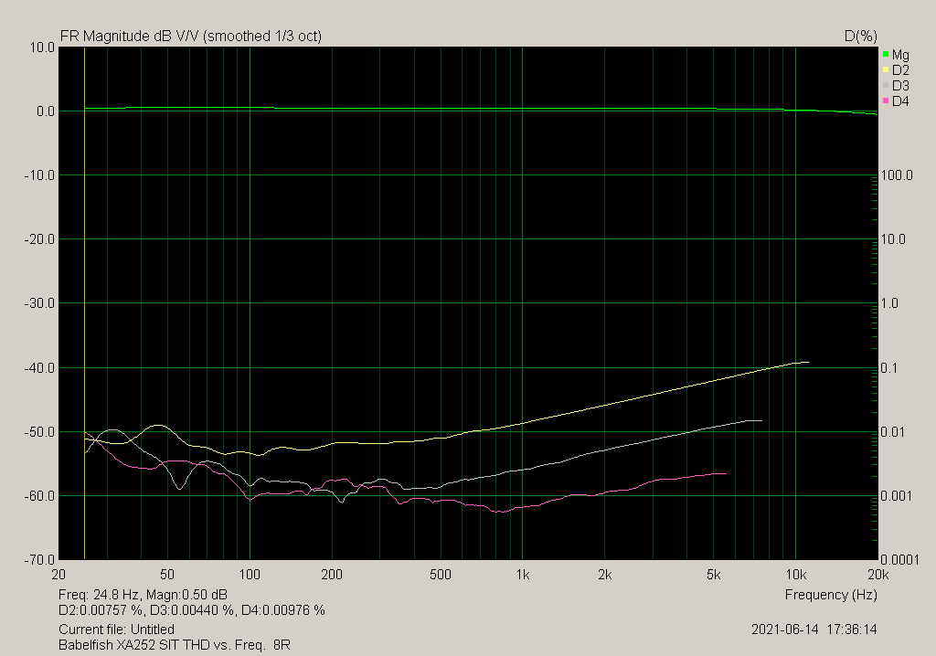

I was referring to your distortion vs frequency graph. The Stereophile measurements of Papa's amp at 8.9V output show that distortion rises at higher frequencies, and I am wondering whether the THF51 in your design behaves the same, better or worse. The distortion remains very low in level considering the size of the devices. After re-reading your SissySIT (thank you for hint) this sounds like an academic question, so please feel free to disregard! Thanks for sharing.

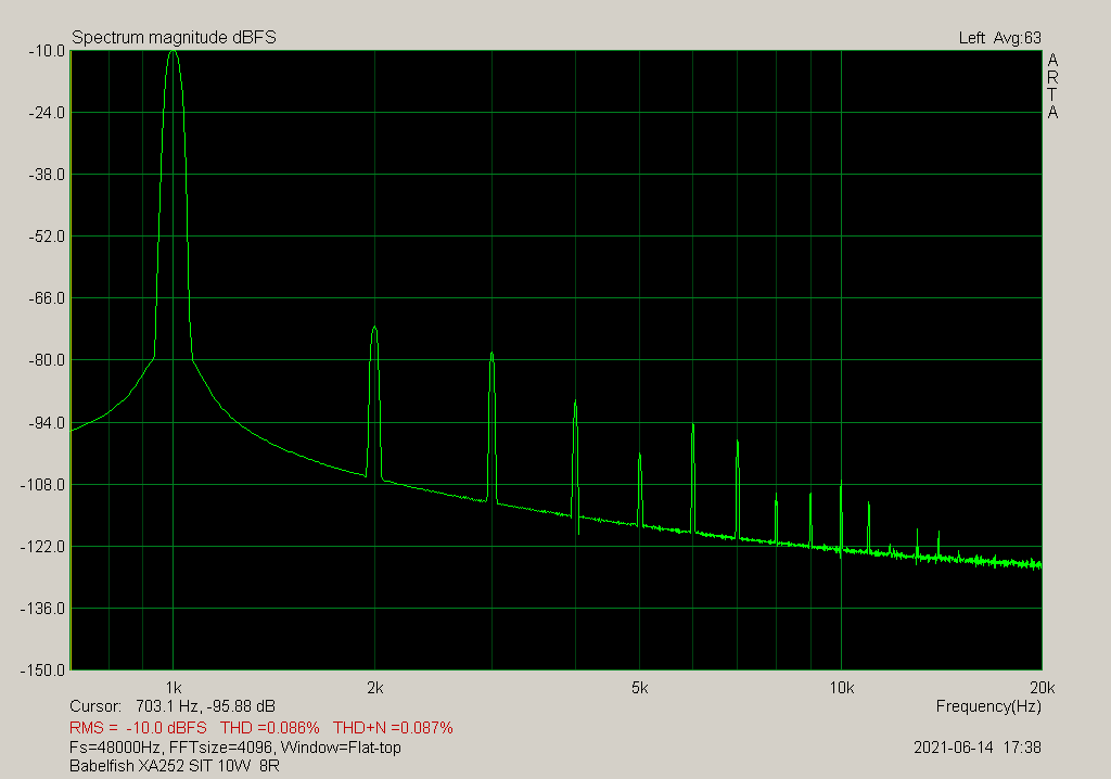

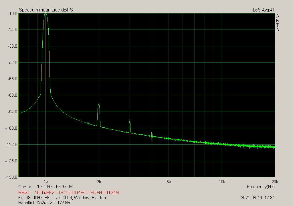

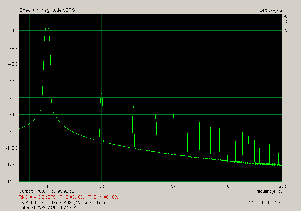

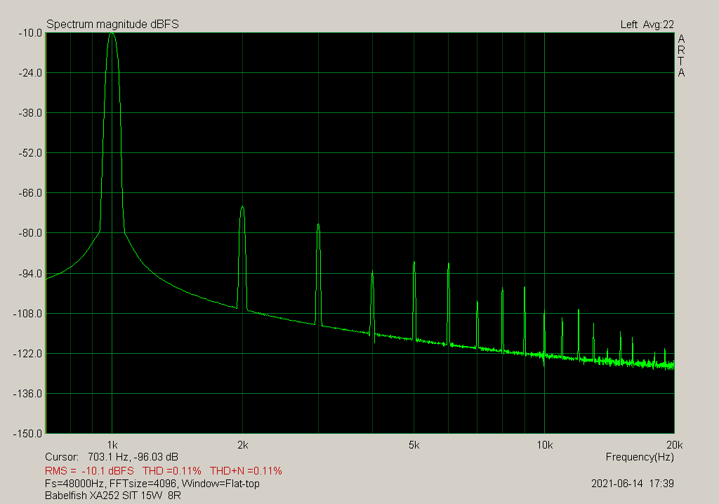

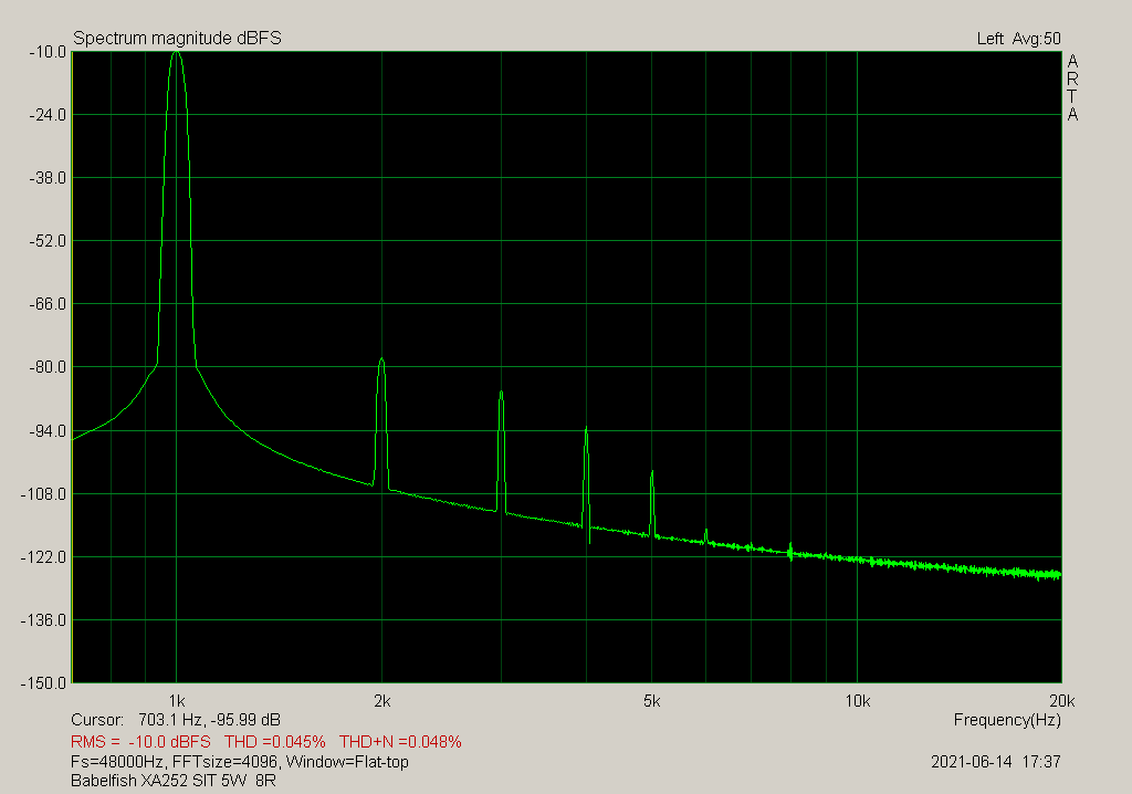

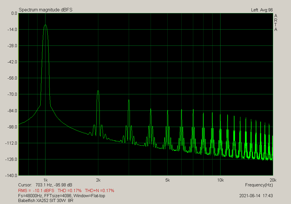

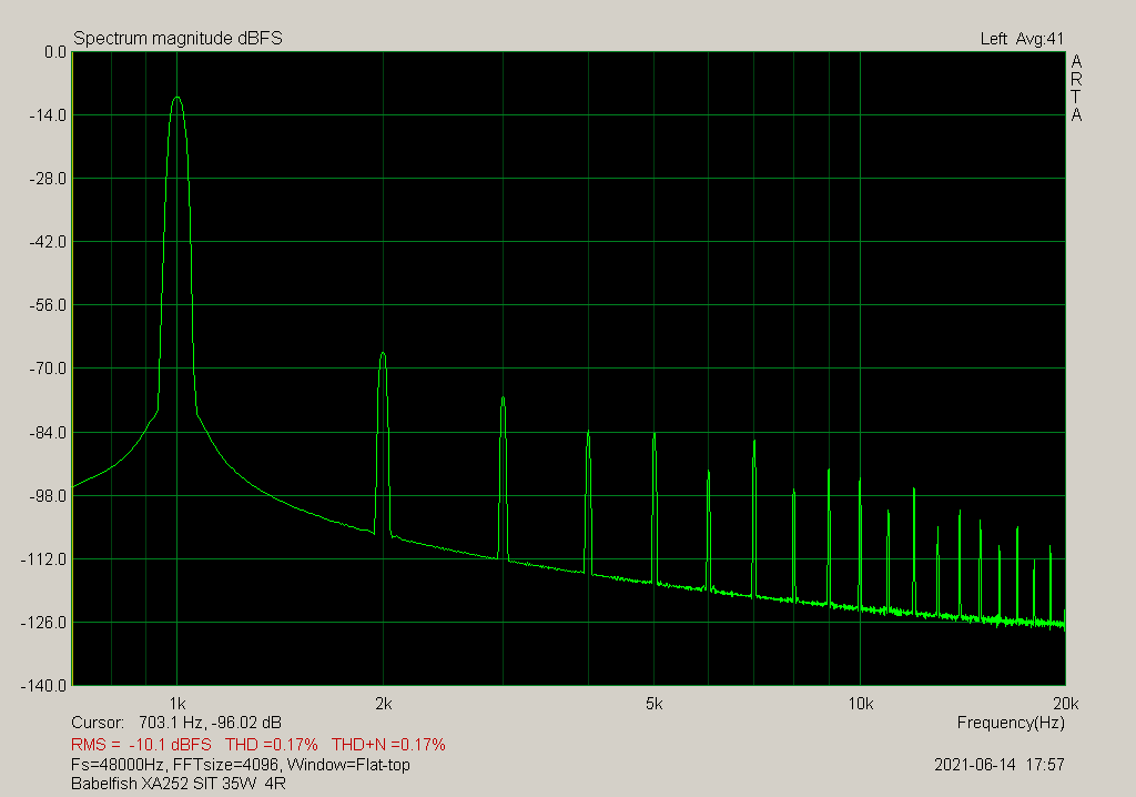

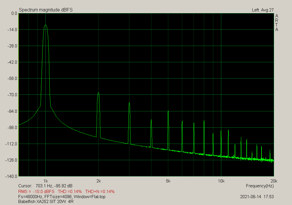

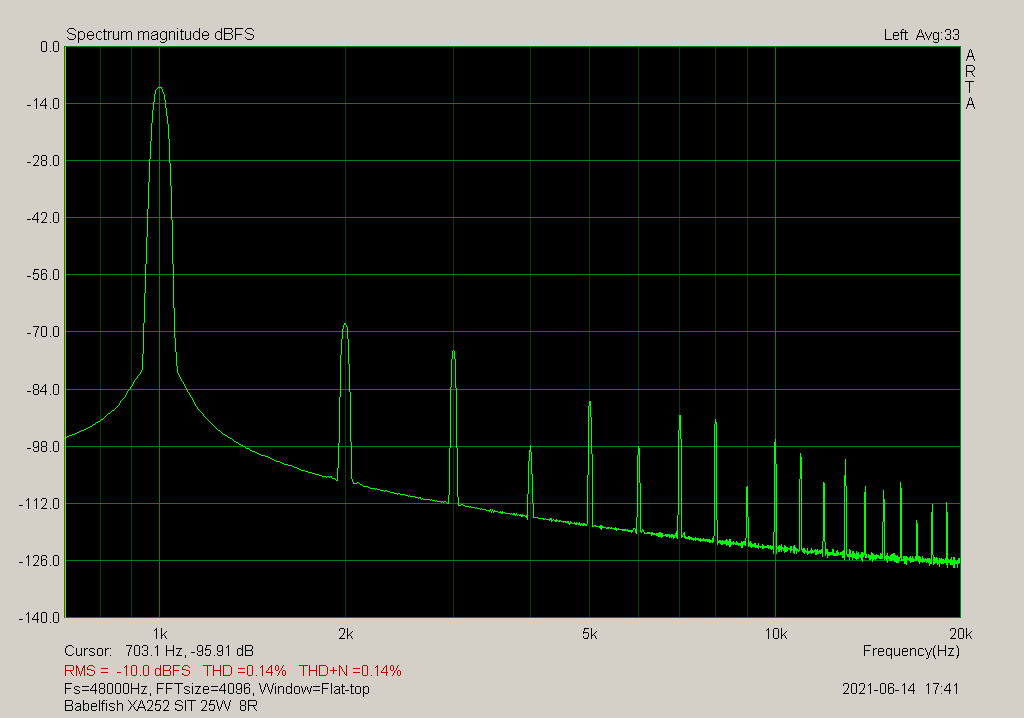

Babelfish XA252 SIT - graphs , 8R load, BFR=510R
.... everything same (rails +/-30V, Iq 1A7)

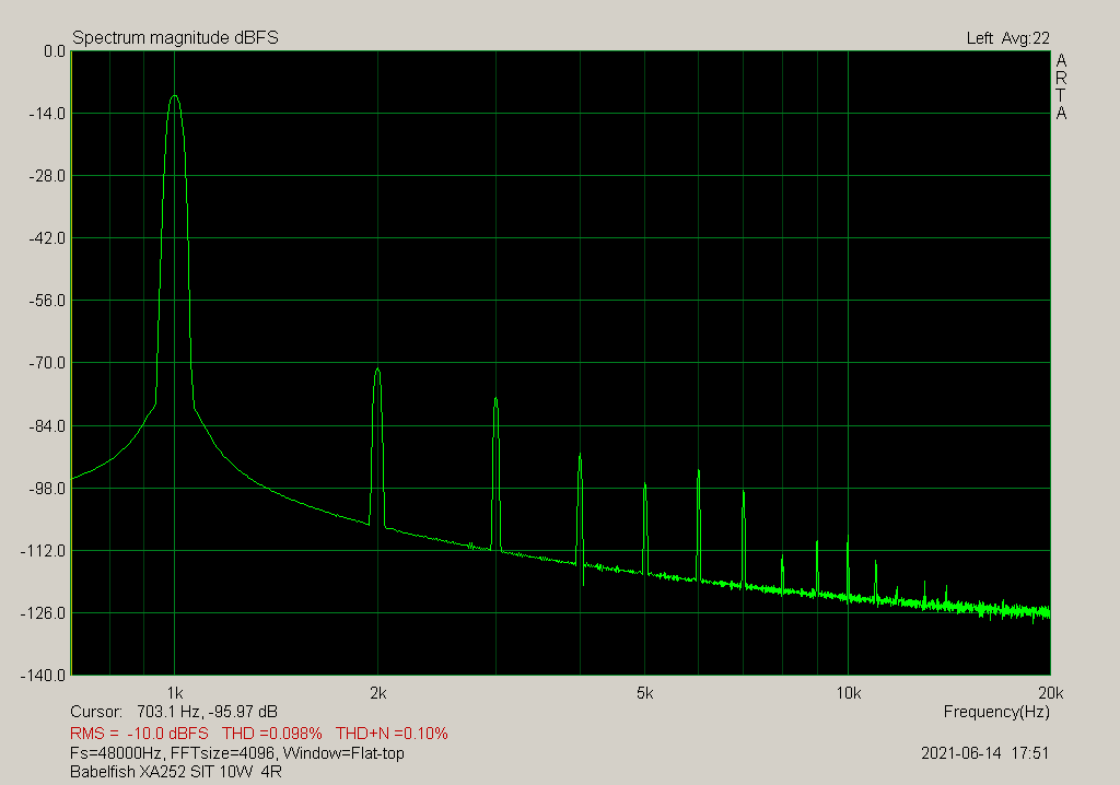

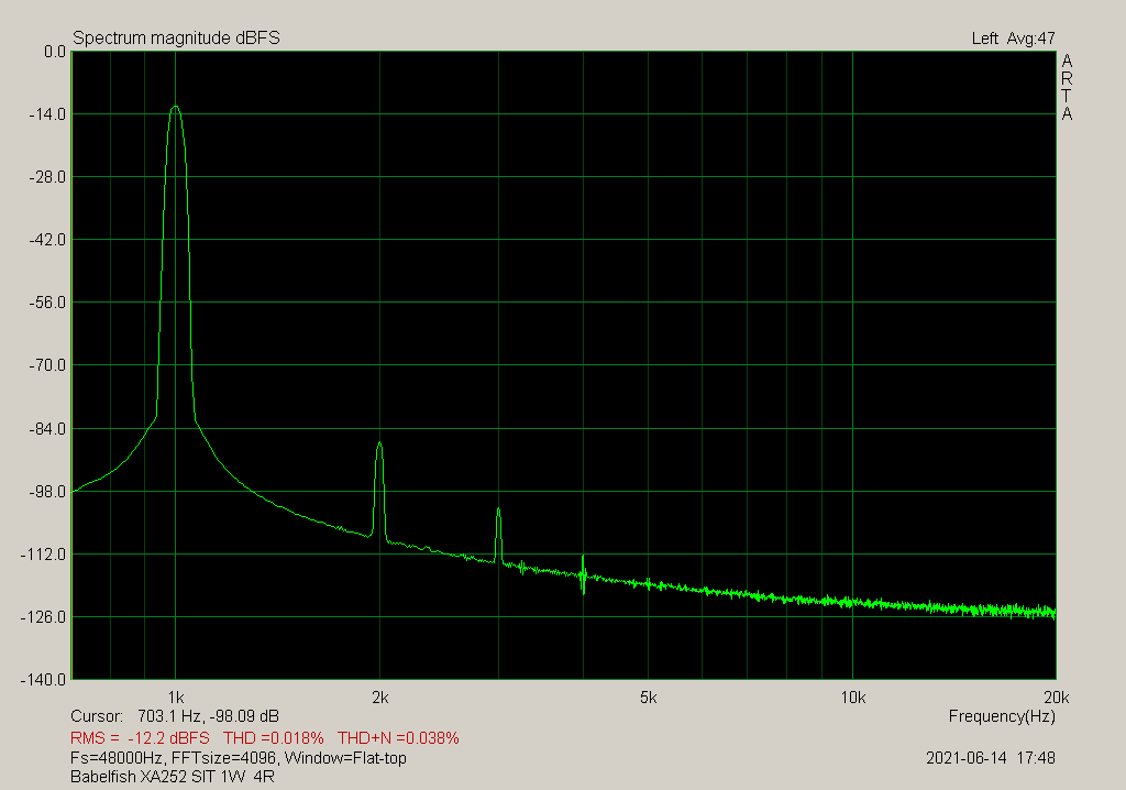

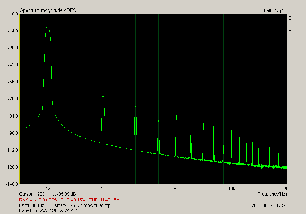

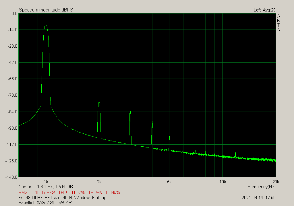

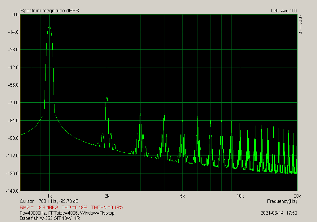

Babelfish XA252 SIT - graphs , 4R load, BFR=510R
Load changed to 4 Ohms
post 1 of 2, more pics than allowed for one post

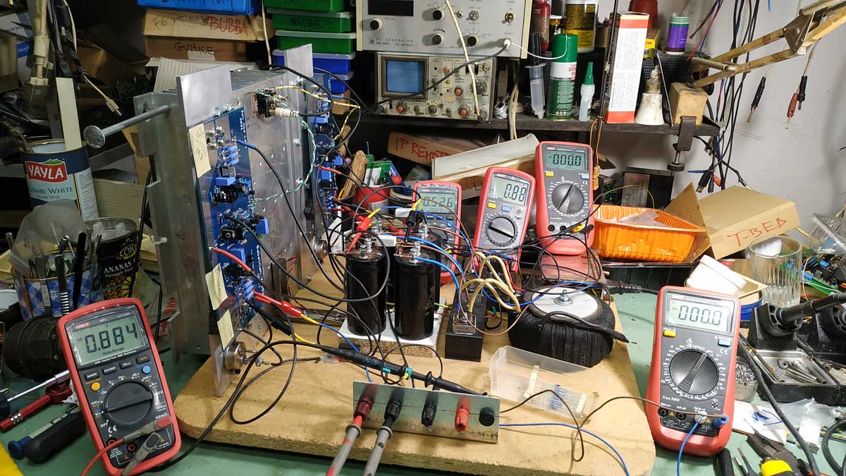

however, as I completed both SIT channels on T-Bed 2 yesterday, couldn't resist today afternoon and I did some listening in my workshop
Spoooooky and so much ball$$!
dunno (as said) how's in comparison with anything (I need probably just time to re-set, peaceful time without making new ones) but it's as microscope size of Palomar ......... Rocking!
sense of foundation and authority, as I remember, even greater than with 100W Babelfish Aleph XJ
go figure
