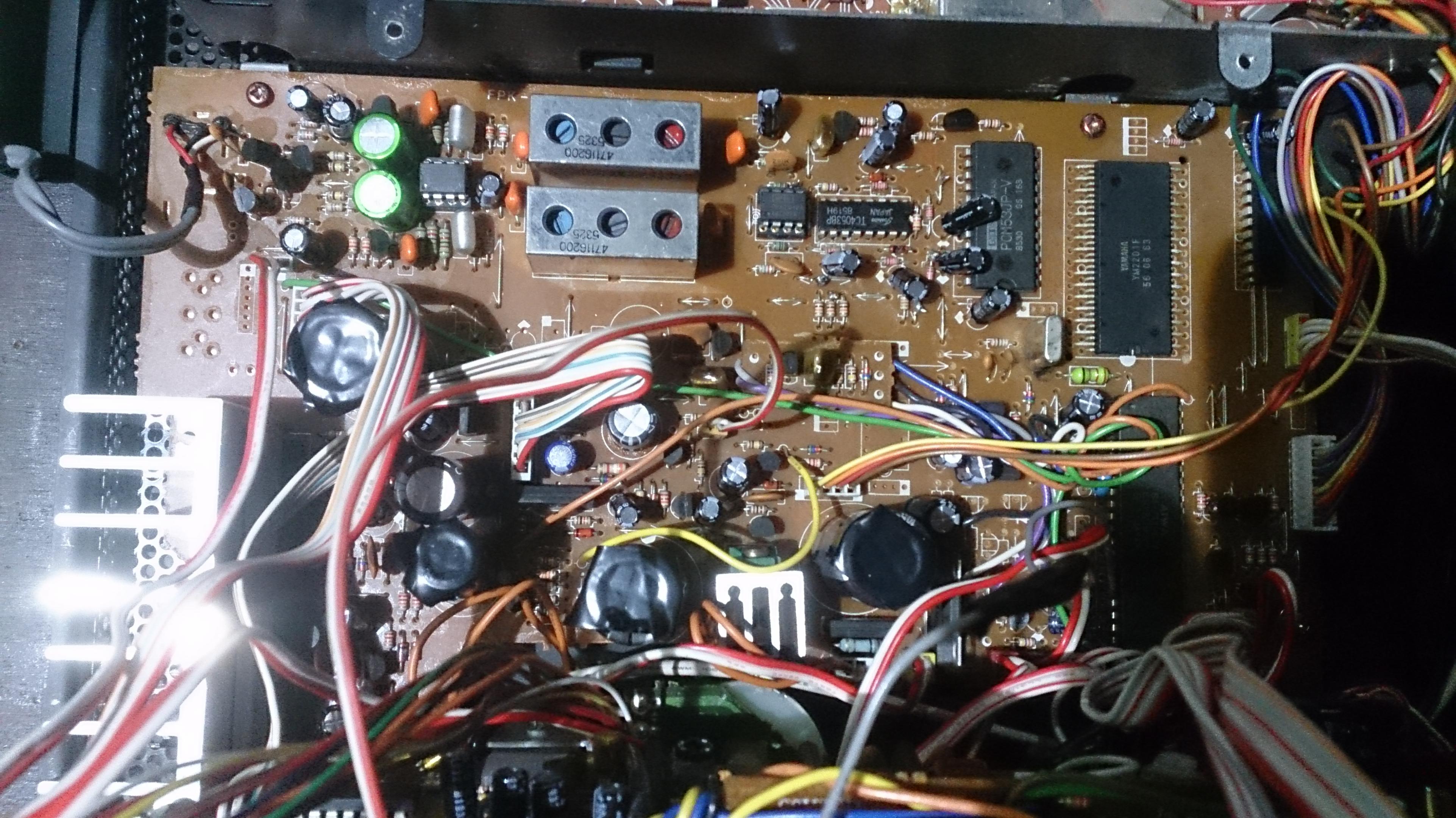

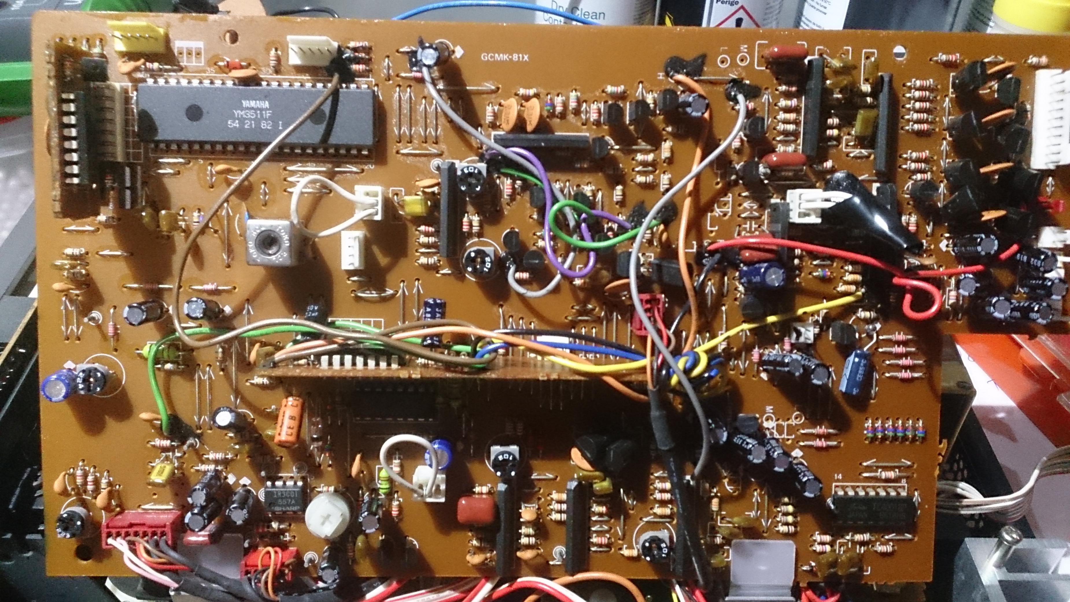

Btw, I measured some of the old electrolytic caps that I changed - almost all 10uF was down to about 7uF and a couple of 100uF were down to 25uF... None of them was shorted. But this shows how important it is to recap old equipment, even if it's still working, as many of the caps loose capacity over the years.

I also attach a couple of pics of the boards with new caps.
Ah, before I forget: I also exchanged the X2 cap in the power supply section, as they have a tendency to blow up spontaneously when very old (happened to my oscilloscope, for example). And that weird "golden" electrolytic cap next to it (100uF) was also changed - it was down to 20uF!!!
