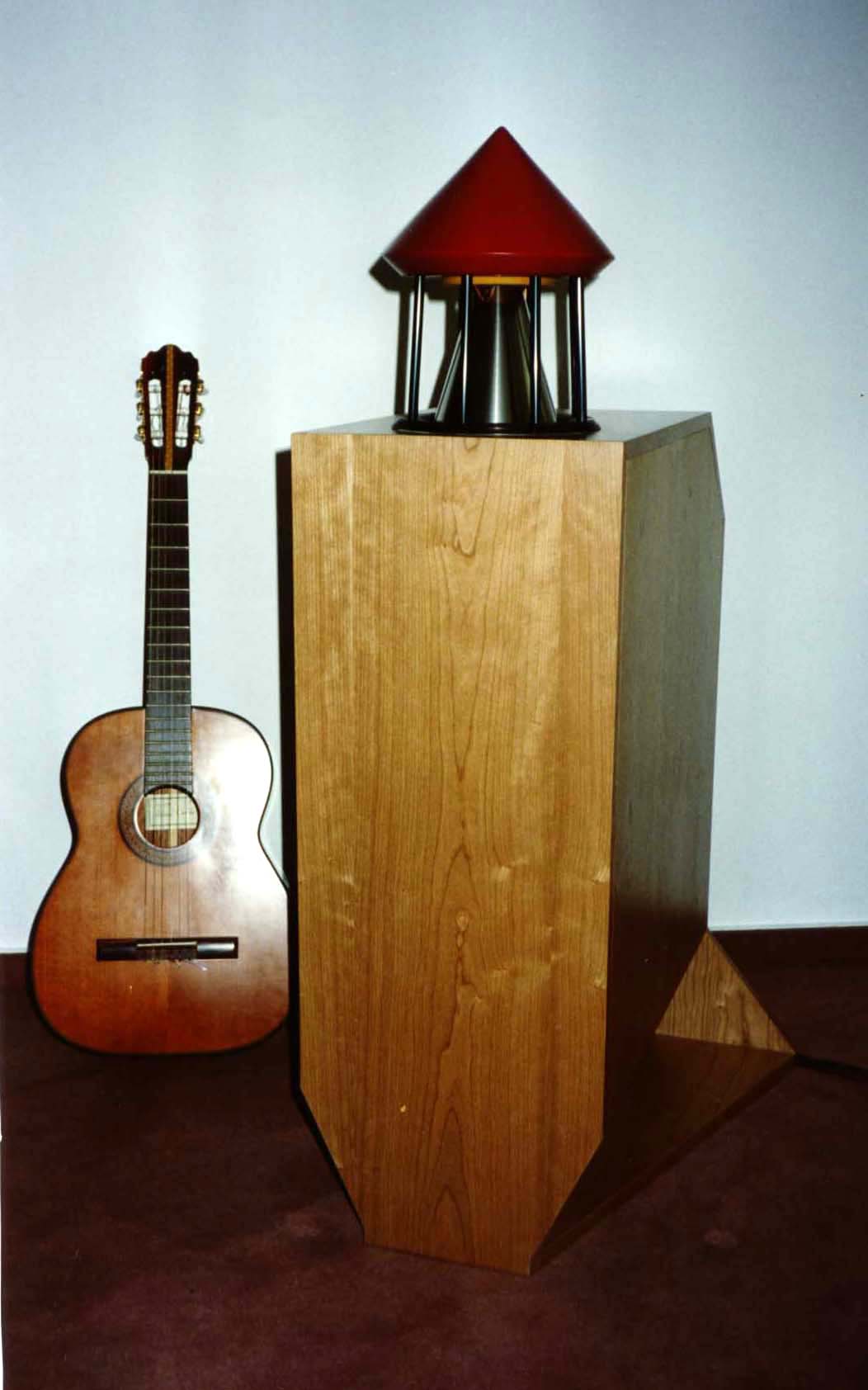

griffon
i made the Lure 1994, since i dreamed about omni without highs.
lure
Thats why i made the double horns look the measurement and impedanz never seen it in living room measurement, Kangling kl.mess
the point is below~ 1,5 kHz the driver played by invers montage, the driver is indirect so you listen the room reflexion, the first wave is important, later reflexion filling up the first, the distance between the driver short as possible here 17 cm~ 2kHz, the first room reflexion of the front driver up to 2 kHz is supported by the near back driver, sorry my english is to small to explain it better, listen is the best way to find out
lure
