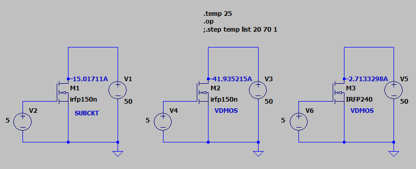

I think there is a problem in the ID / VGS curve
With SUBCKT from infineon I have 15A with 5V VGS and 50V VDS like the datasheet, with the VDMOS i have 41A
I checked with the IRFP240 VDMOS and there it is good, 2.7A in same situation like datasheet

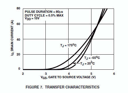

I fitted to the ON-Fairchild 2002 IRF150N Datasheet Fig-7 (attached) which shows 42A at Vgs=5V, which is what you read.

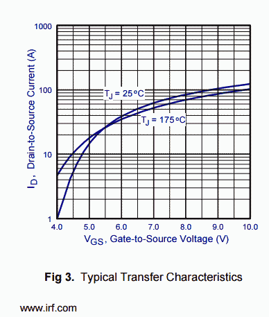

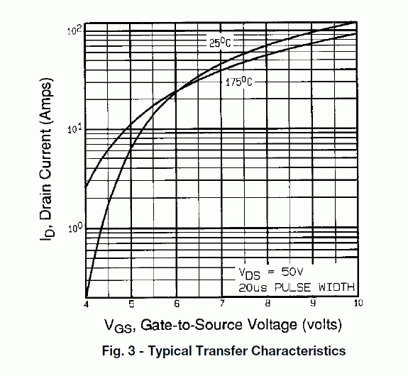

The Infineon-IR IRF150N Datasheet is the same as the IRF150 Datasheet (attached).
This may be an oversight on the behalf of IR by copying the old datasheet for the upgraded IRFP150N. If so use the ON-Semi model as I supplied.
If you want a model to match the IRFP150N that you are using you need to do a test to see which of the two IRFP150N models you need.
BTW attached is your jig with my IRFP150N and now with the Infineon IRFP150. You can see the Id for the IRFP150 is the same as the MODPLEX subcircuit.
Also in the jig I added a convenient way to convert my IRFP150N back to the IRFP150 using the 'ako:' statement below:
.model IRFP150 ako:IRFP150N Kp=22 Rs=30m
Add this to your circuit and you can enable it to select the IRFP150 or the Infineon/MODPLEX IRF150N) for DC conditions (the AC property remains the faster ON-Semi IRFP150N).
BTW I ammended the model code in the attached to better match the datasheets I used.

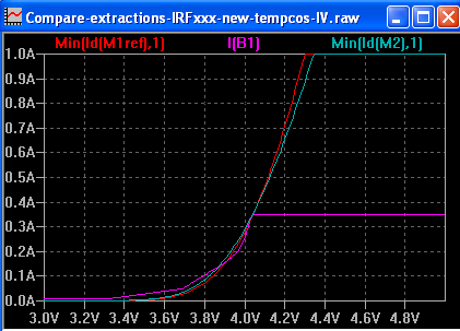

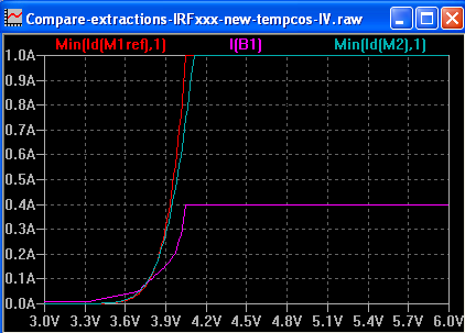

Here's the updated DMOS models for the new temp.co's for LT-XVII. Laterals are in a following post.

UltimateX86,
I think you have opened a can of worms.

Hi UltimateX86,
I tried plotting your points with the IRFP150N model at 40 deg.C.
Setting Vto=3.9 is close enough. See attached plots. Red is the IRFP150N.
You don't have enough points to see if the model is OK at higher current so I suggest you assume my model from the ON-Semi datasheet is correct (unless you find your simulations are quite different from measurements).
I also tried scaling the IRFP150N model area and found a closer fit to your data with an area of 0.15 of the original model. See 2nd attachment.
If scaling is actually necessary to fit your data then either
1) your measured data is not good (maybe not isothermal enough using microsecond pulses like the datasheets), or
2) the device is not an IRFP150N (maybe a fake chip).
