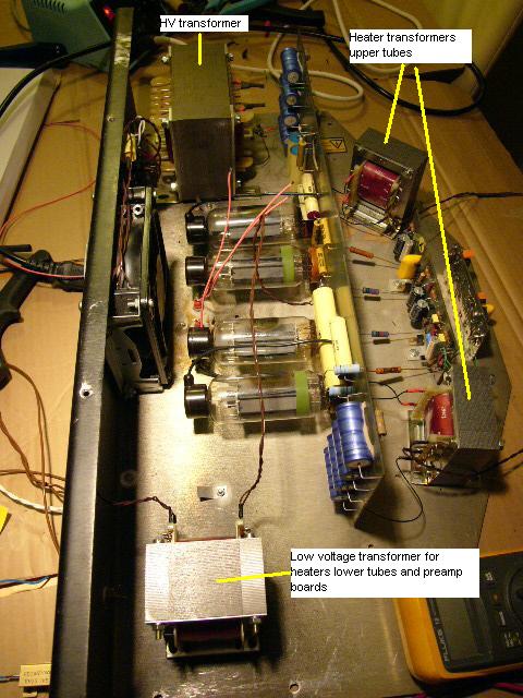

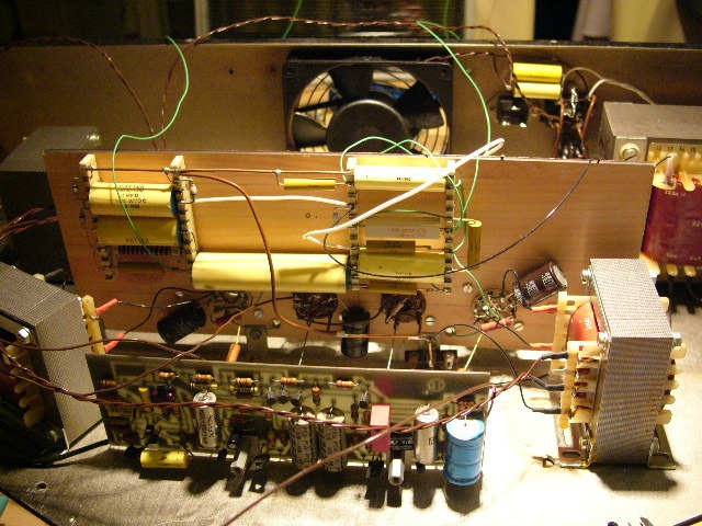

I have rebuild this amp about 17 years ago with PL519 tubes as these are more common here in Europe.
As the transformer is weak i have replaced it with separate transformers like in the Acoustat amps.
Never had any issues since with any transformer.

Yes it becomes a half wave doubler unfortunately, but it was compensated with much more electrolytics. MUCH MORE. Really not necessary, but I happened to have limitless of 450Volt 3300uF laying around. At least a couple of hundreds. :cool: (not all of them used here)

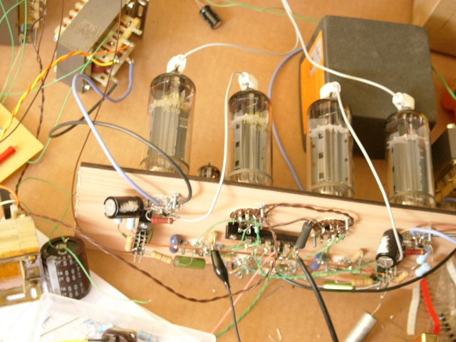

I used a capacitor in series with the fan as it was too noisy for me. Now it runs very quiet, just enough to have some air movement to keep it all "cool".
Plus a solid state relays to be able to remotely switch the HV on/off (stand-by option with heaters in series using a standard 4 pole relays).

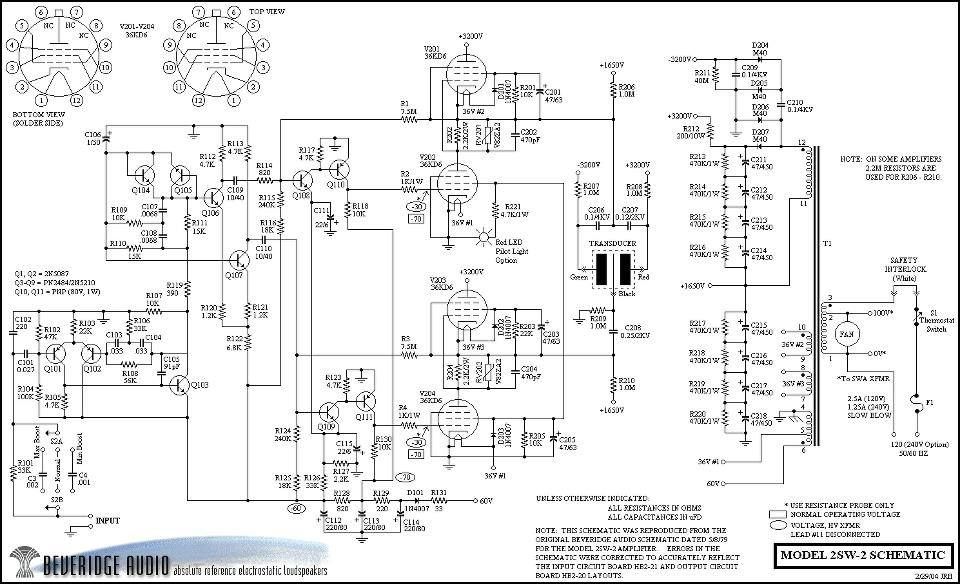

I'm attaching schematics for both the 2SW-1 and 2SW-2. The only difference is right at the input for the 'voicing' control.

I made a big improvement in reliability by moving all electrolytics & silicon to the rear side of the main PC board (away from the heat of the tubes).

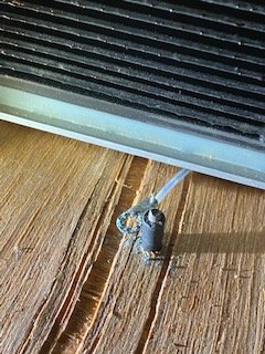

Also the base of the tubes runs way hotter than any other part, don't know why. Almost all tubes that fail will crack around the base like shown in your picture.

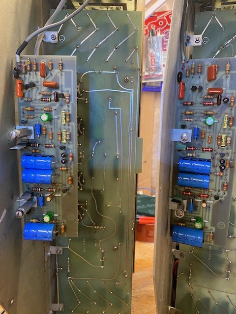

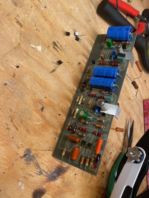

I've moved on and rebuilt both driver input boards. Some bad choices in the past with replacement parts and transistors. Both boards cleaned up and installed.
Next I will move on to removing all the panels vacuuming them and changing the banana jacks on the cabinets. I initially addressed all the panel solder eyelets in cabinets when I could not get consistent measurements - I figured if the panels were done then - no use pursuing further. Replacing those connectors made the difference. This next phase will take a while with life's duties getting in the way.

Does anyone have a clear schematic of the 2sw-1 cross over board?
It looks like the input of the driver board has a 0.027 uf cap at the input with a resistor of 47kohm to come up with about 130hz cut off to the panels on their own.
It looks like the quad OP amp on the cross over board tends to the LF pass and the HF is done discretely with transistors. Can anyone explain the operation I can not read my print it is of low quality.
My understanding is the 2 and 2sw-1 input boards are the same. What I want to accomplish is to drive the 2sw1 without the internal crossover and use an active outboard or passively crossover 1st order the input with a small cap to limit the LF to panel. The .027 seems about right on its own.
