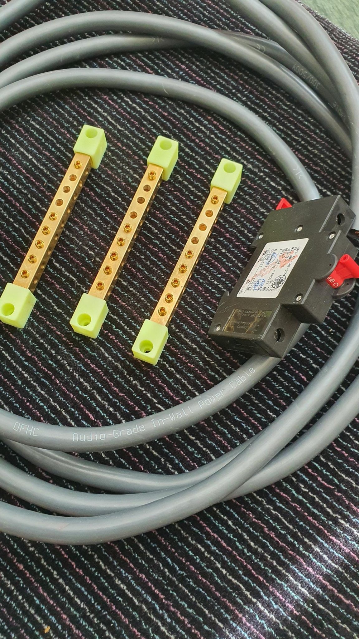

There is, sort of. Silver slows the ingress of copper into gold. You need thicker plating. My bus bars that are 4n copper, plated with 4n copper, then with 4n silver, and 4n gold (no "hard" gold), are still kicking fine, no sign of galvanic corrosion and no leeching. It's been more than 5 years. Same technique Viborg uses in their products.

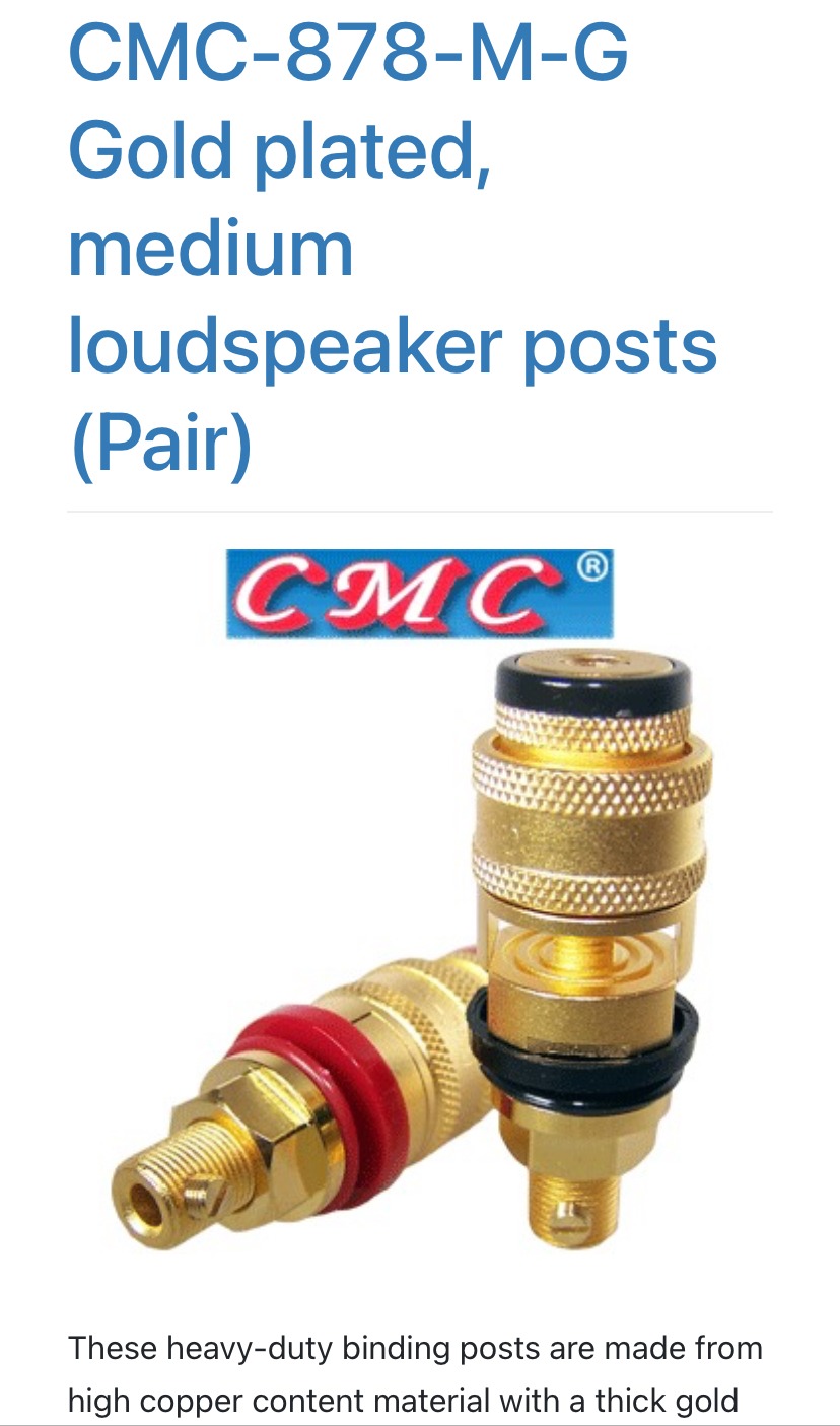

Regarding binding post at more than human cost my warm suggestion goes to CMC-858-MU-G which are very nice and also sound very good to my ears.
Anyway I replaced those with ETI BP-20C which however cost quadruple.
As has already been suggested, Viborg ones are also a very good choice (no tie with any vendor/manufacturer) costing a little less than ETI brand.

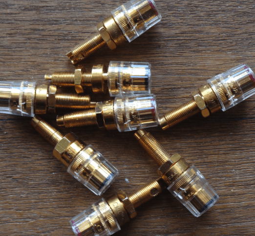

I bought two sets of these from parts connection. My set of posts in my two ACA kits were magnetic. I chose silver to match the internal wire I used.
