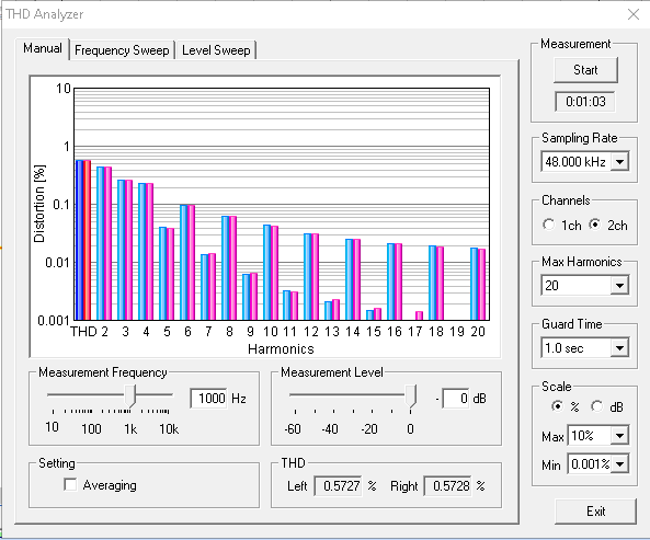

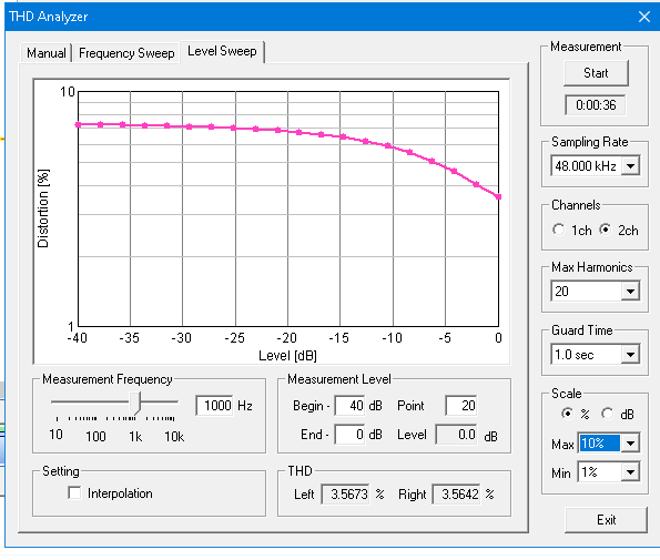

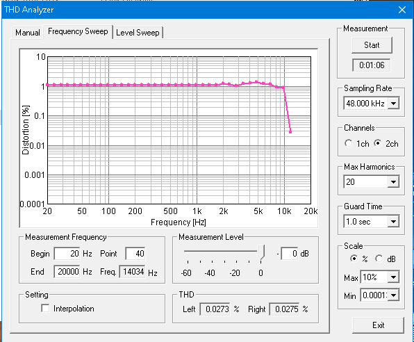

I came across a project in Sigma Studio in which they simulate the operation of a tube amplifier. What attracted me to this project was the ability to control the level of distortion. I made a distortion adjustment using an external potentiometer from 0.005% to 15%.
The result was quite interesting. This project is a good way to test your threshold for sensitivity to distortion.
The design of the project introduces distortions according to this principle:
-When changing frequency, the level of distortion is almost the same for any frequency;
-As the signal level decreases, distortion increases;
-Even harmonics prevail over odd ones.
Project in Sigma Studio.

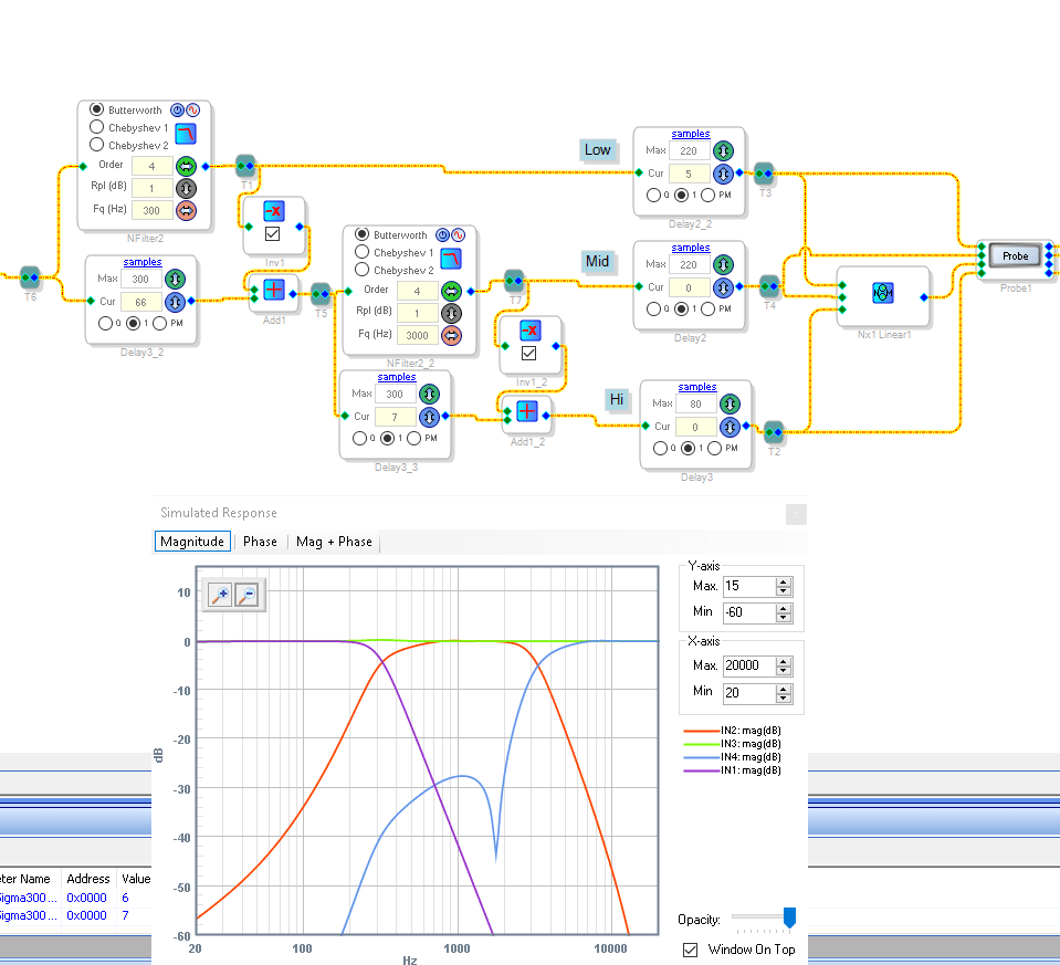

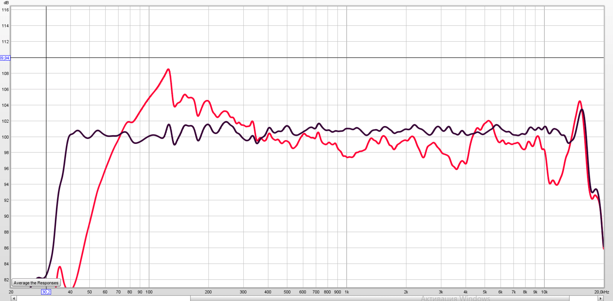

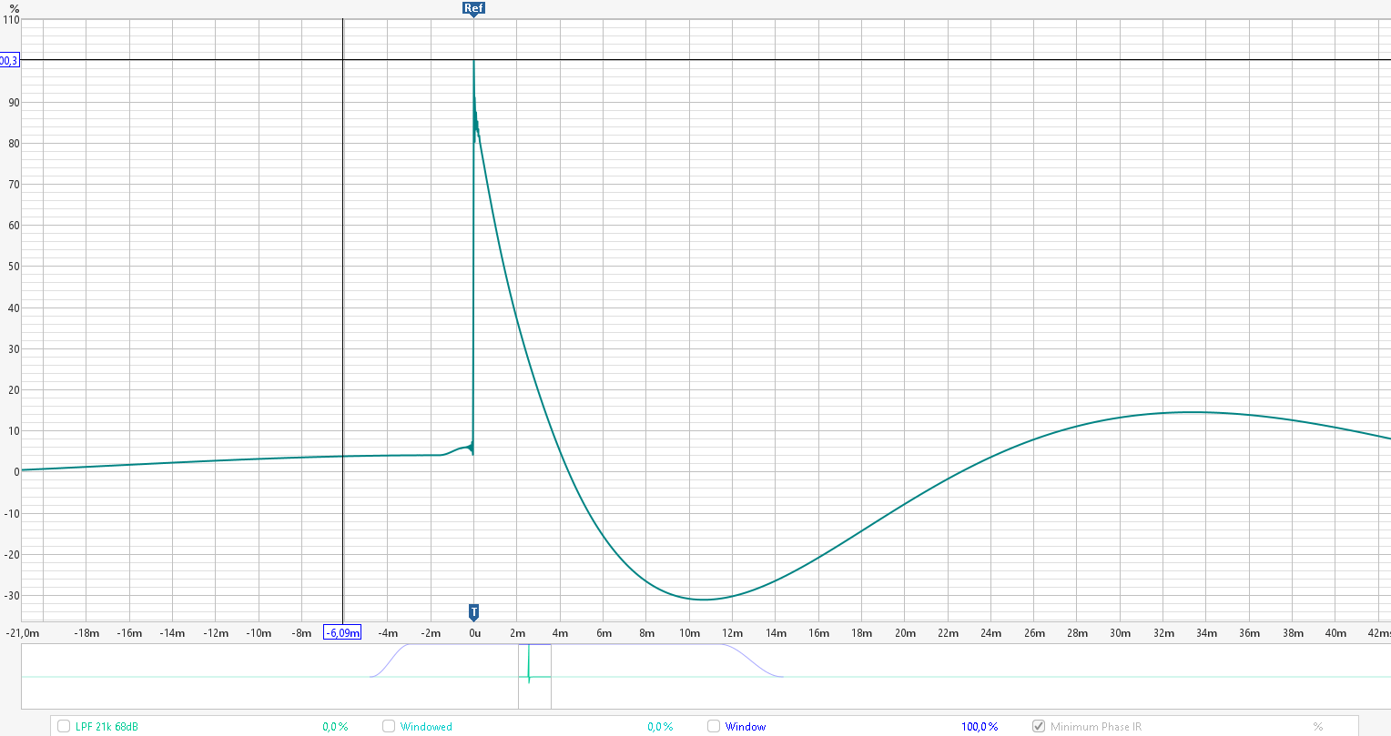

For those who don’t like FIR crossover but want to have an even phase, I put together a subtractive crossover in Sigma Studio.
The frequency response and crossover circuit turned out like this.
And this is the measured step response of the sum of three bands.
Below is a project in Sigma Studio.
