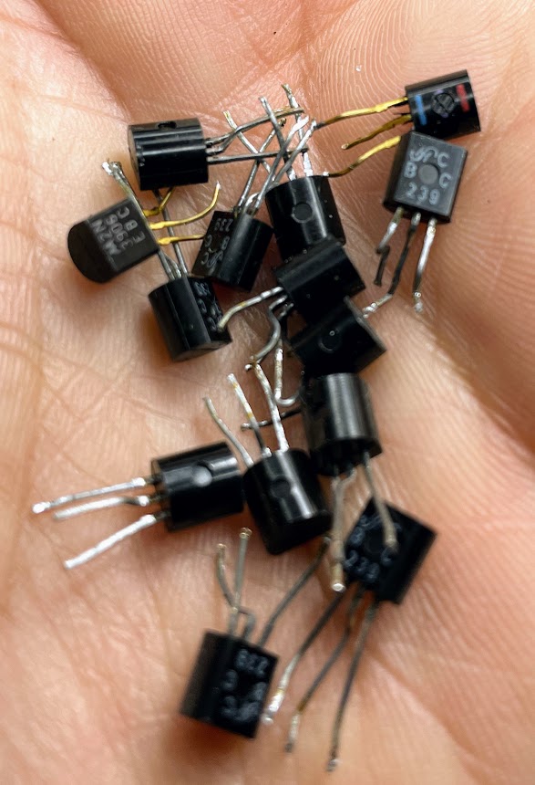

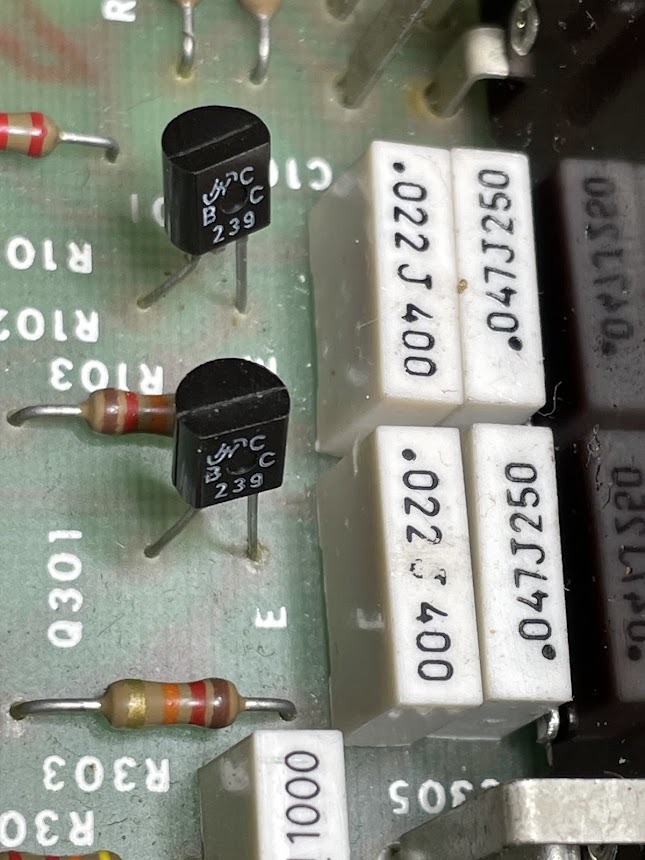

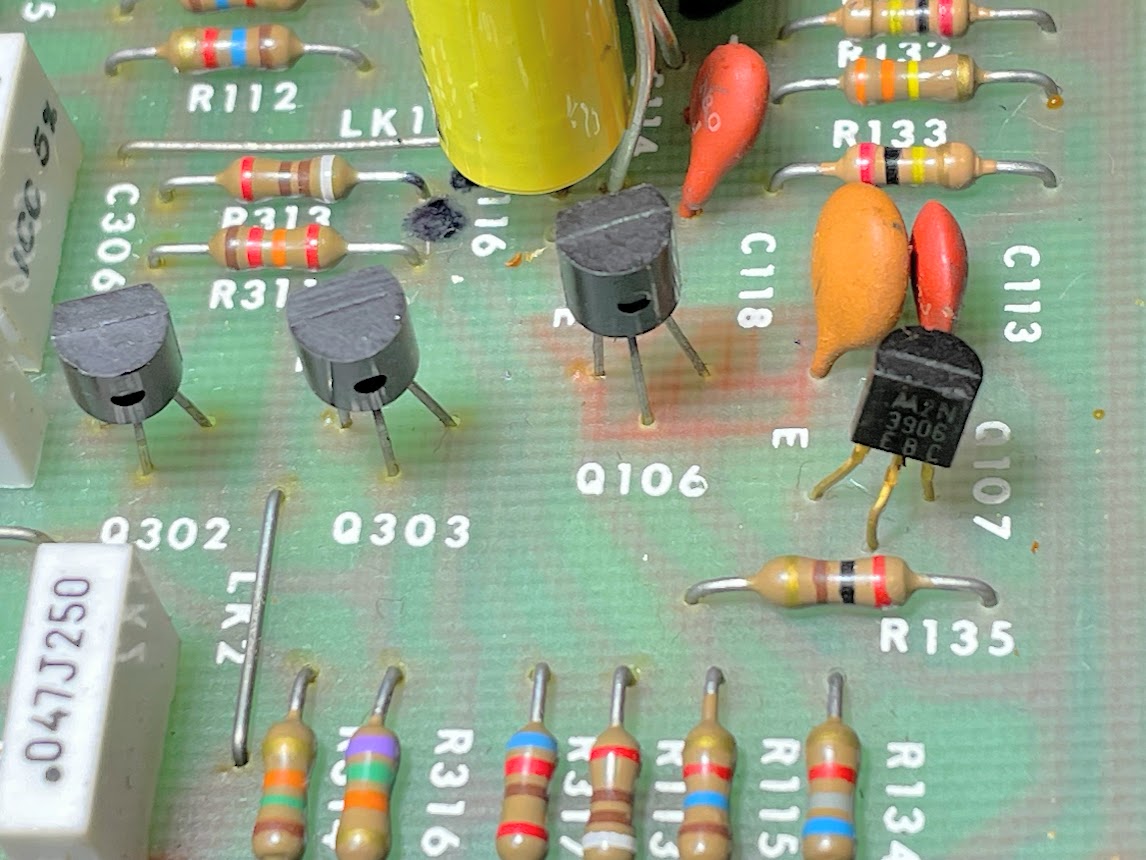

Replace 14 small signal transistors:
12 - BC239, replaced with BC547, available at Mouser.com: NPN
512-BC547CTFR
BC547CTFR
2 - Motorola 2N3906, replace with complimentary pair to BC547, the PNP BC557 - Note pin orientation different than Motorola, turn 180 degrees. These are PNP
512-BC557BTF
BC557BTF

After replacements, I noticed residual power noise, that is why I upgraded the 470 uF cap to 3300 uF, and installed a 2-3 watt 0.47 ohm resistor between the rectifiers and the first cap, had to cut the trace. See picture.
