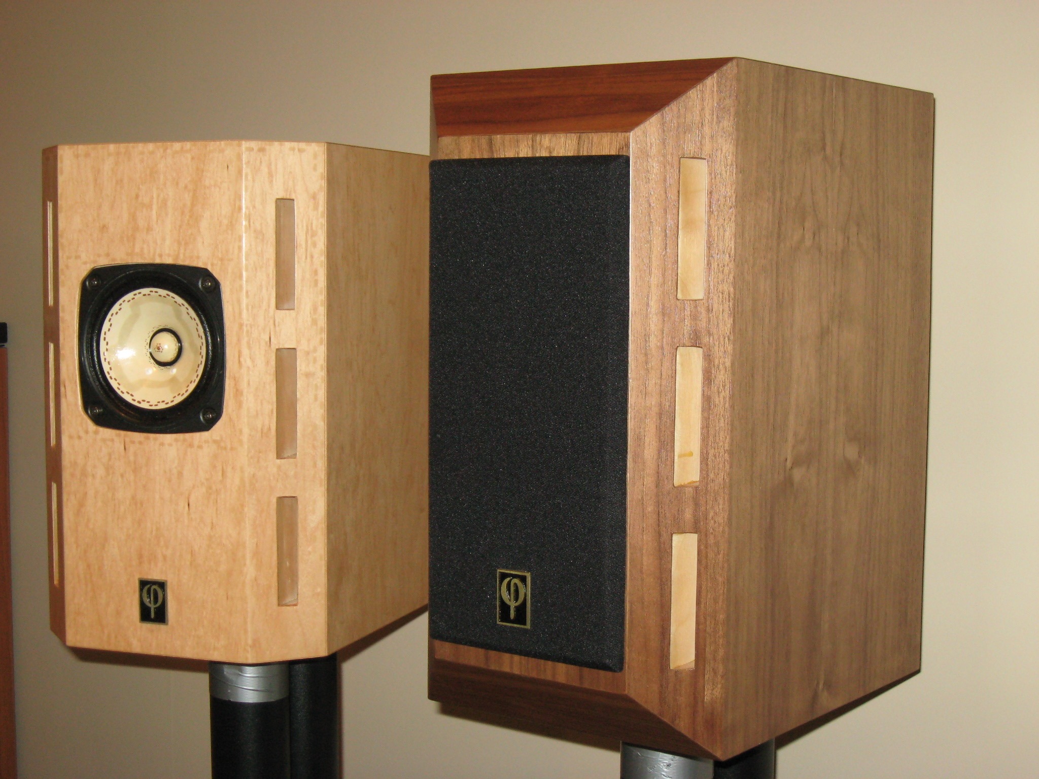

For what it’s worth, I think that builder chose large radius curved edge over 45dg chamfer/bevel to simplify veneering process. For my own numerous builds I was fortunate enough to have access to commercial table saws capable of cutting those large bevels, generally had decent luck with veneering them, and the visibility of exposed edge of paper backing never bothered me that much.

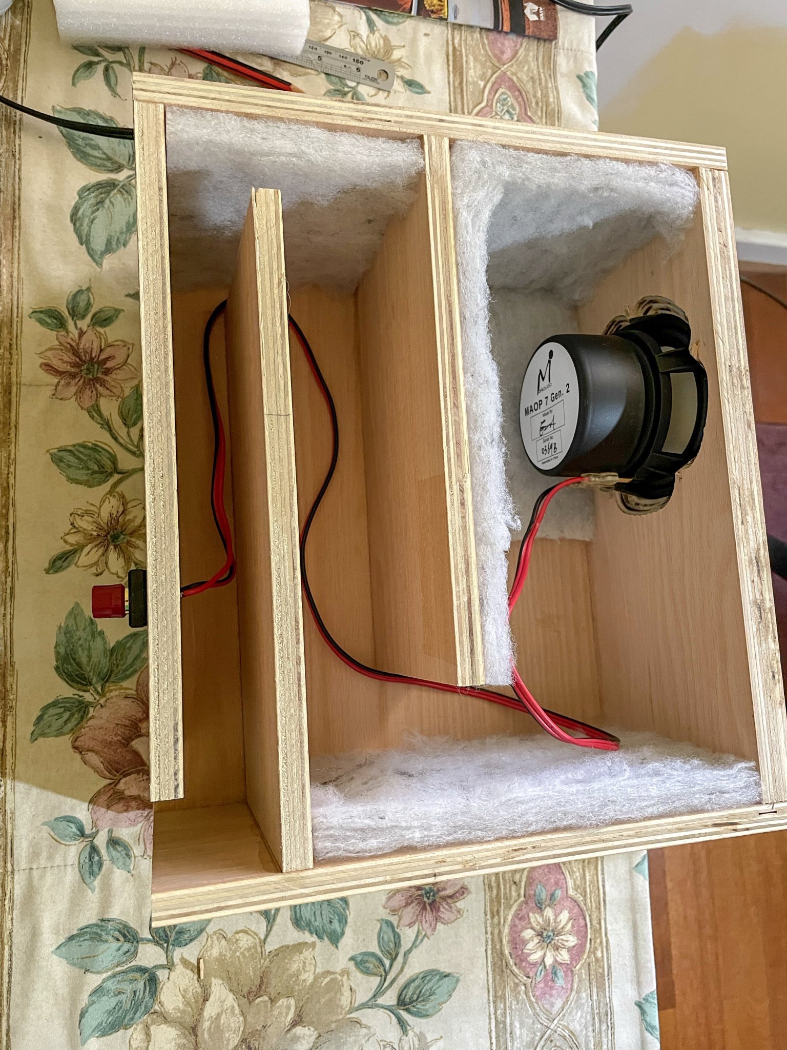

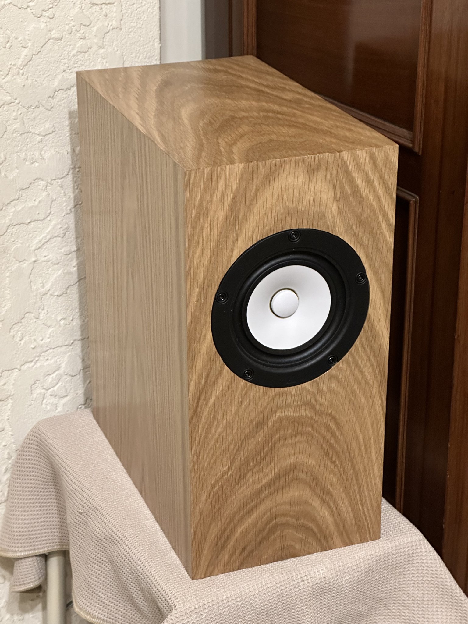

I went with a BabyLab Storm Shadow (link below) for mine, which are rear ported, and used as daily drivers in lounge room - can listen to them all day. Finish is Scandinavian Oil over White Oak veneer.

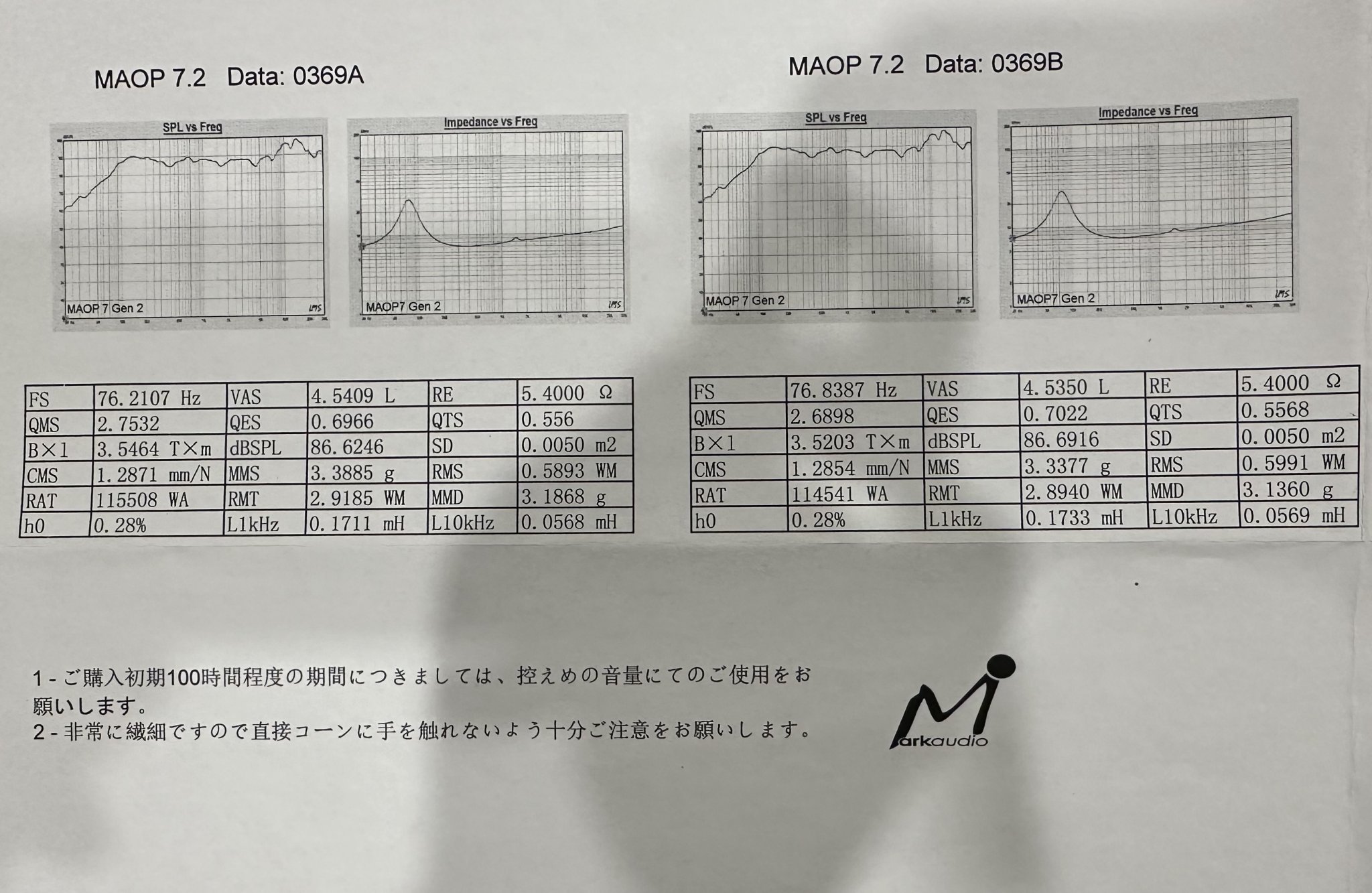

Dave, are these the parameters you’re after?
http://wodendesign.com/downloads/Woden-BabyLabs-241018.pdf
