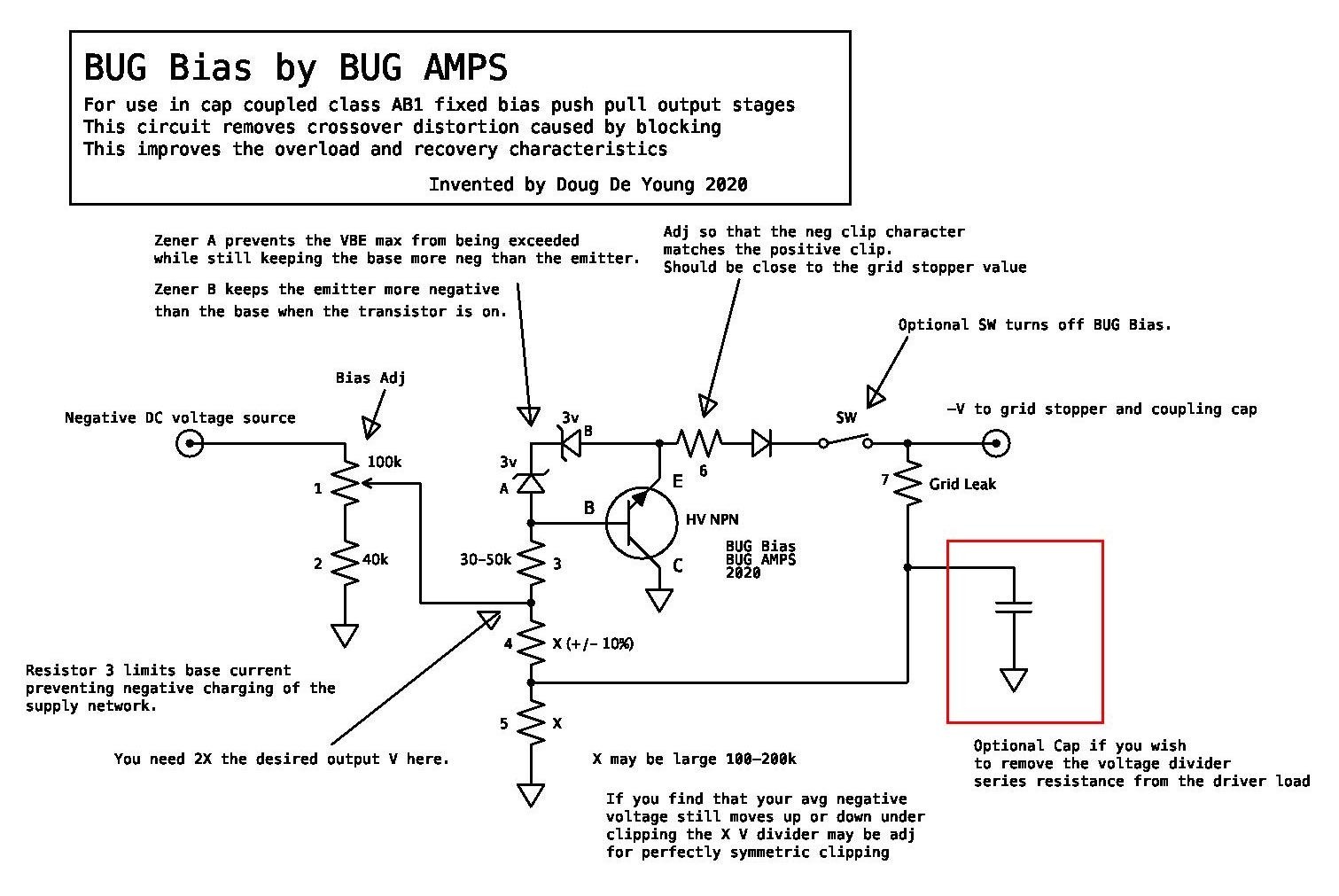

Single ended is different, but fortunately the Bug Bias will prevent the RC from blocking the signal;

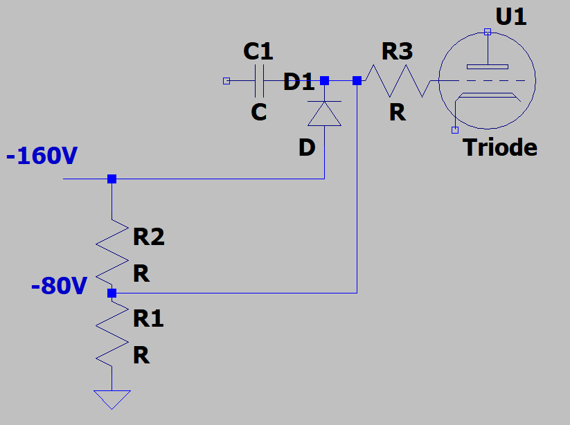

There was the Carver solution, which was based on a video baseline restorer. The grid starts conducting current at some positive signal voltage through the grid resistance, so a reverse diode and series resistor gets added, that is arranged to conduct the opposite current, at the opposite equal negative voltage. A positive offset voltage, from the signal, is needed to do that at the diode, so it conducts at the proper neg. signal voltage. Equal, opposite currents keep the coupling capacitor at zero avg, volts (ideally). Could use a 6AL5 to get a matching diode.
After searching for Carver solution, I meet another old post talking about dc restorer circuit.
https://www.diyaudio.com/community/threads/putting-stock-in-carver.239652/
It seems that the simple circuit should be effective in limiting the negative swing to 2x of bias level. My purpose is to prevent the single ended amp from suffering from a short duration of complete cutoff after large transient signal of low enough frequency.
This circuit looks like standard one that is used in fuel injection where you want to clamp and conduct away the flyback spike every time the fuel injectors close, so it's not a new concept. With that, you set a fixed clamp voltage where you want to clip, but here you have a potential divider to fine tune that voltage.

That circuit looks complicated. There are other ways to reduce or potentially eliminate blocking distortion. I recommend reading Sy's article about the RLD and how the LED bias scheme more or less eliminated it. There are of course circuits that can replace the LEDs if so desired. One of those ways is with a TL431 and a BJT PNP power transistor, more or less as described in the TL431 spec sheet. I've done it and it works quite well.
Here is a link to the RLD article:
https://www.syclotron.com/the-red-light-district/

simple grid choke for fast restore?After searching for Carver solution, I meet another old post talking about dc restorer circuit.

Hi Januaryabc. Thanks for having a look at my circuit. I think a lot of the comments in this thread are high quality. For example the closest analog to my circuit is Bob Carvers circuit that of course predates my own. Also his is for a SE application too! I developed my circuit before I was aware of his and I feel mine is sufficiently different to merit it’s own designation, being for fixed bias and Push Pull applications.I am in my way of designing my singled ended amplifier and come across the topic of blocking distortion. I am in search of the way to mitigate the problem and meet BUGBIAS from YouTube and Facebook. This circuit is proposed by BUG AMP in 2020. If anyone has tried the circuit or would like to make some comment, please share your view on it. Thanks.
There are of course loads of ways of eliminating blocking. Direct coupling a follower, transformer coupling or grid choke are some examples. My solution is somewhat unique in that it does exactly nothing to the circuit unless the output stage is clipped. So it doesn’t add anything to the signal path, for whatever that’s worth to a designer. My solution is also easily disabled for AB comparisons.
If you haven’t already have a look at this quick demonstration where I compare the same circuit with and without Bug Bias enabled.
