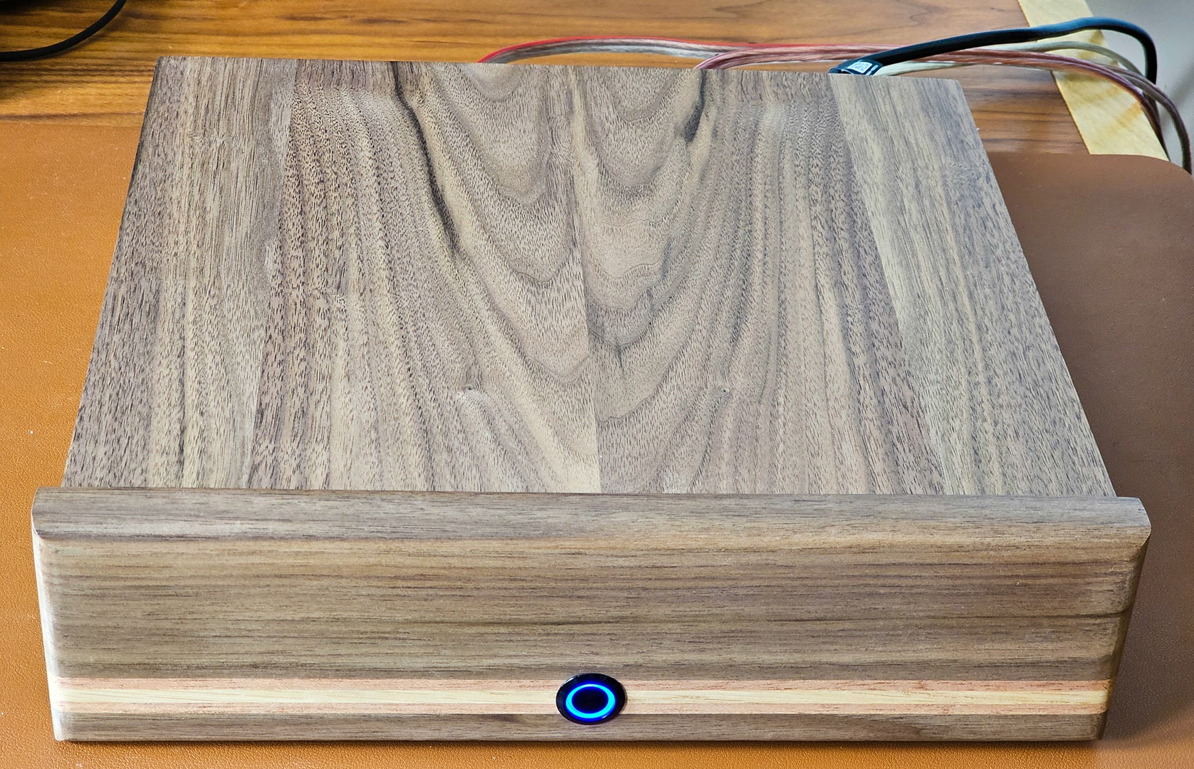

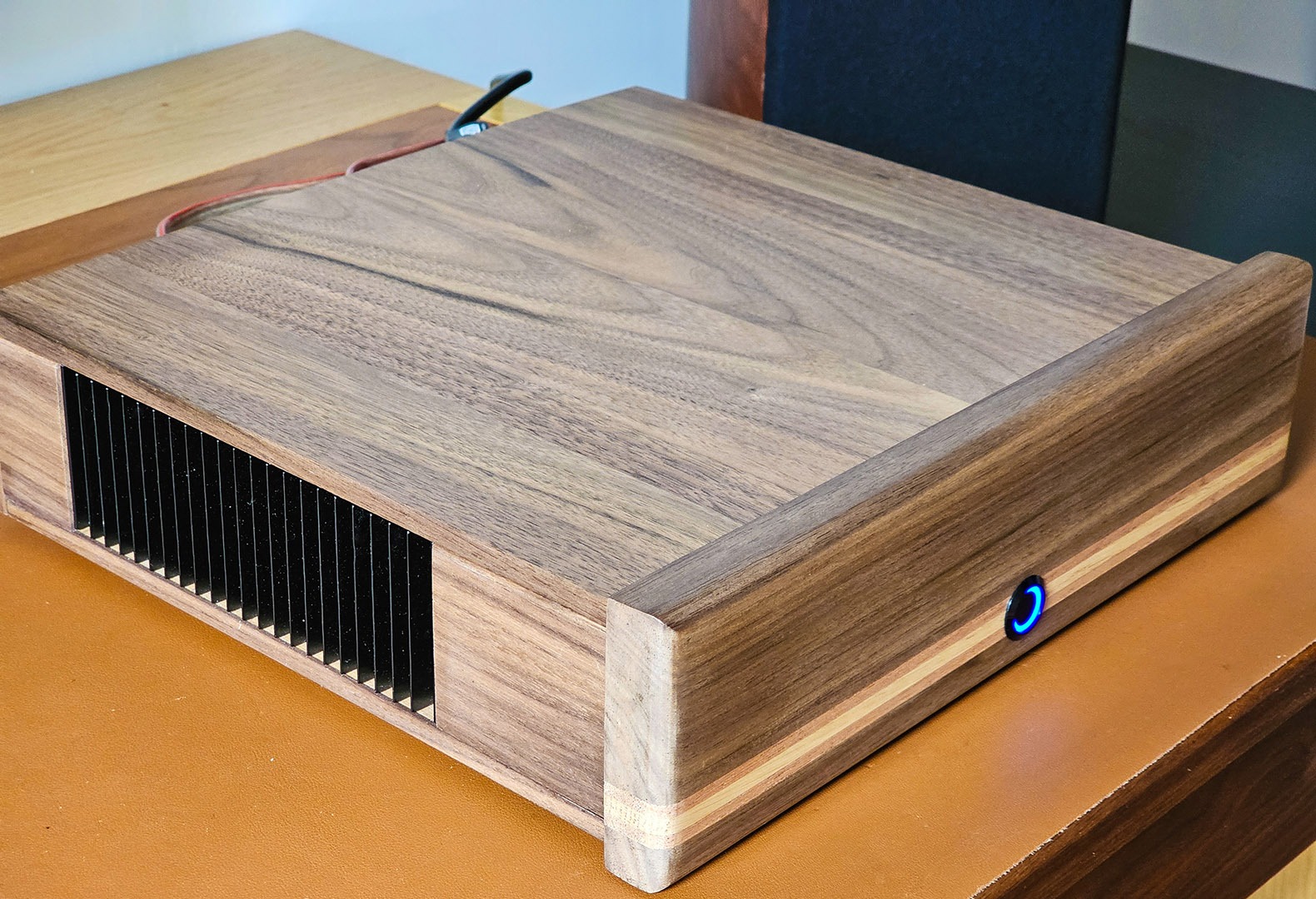

As promised, I made a box for my Circlophone:
I have some woodworking tools and machines at home, so I've built the box myself, using walnut wood with oak and meranti inserts, and plywood for the back and bottom panels. The color is natural, no dye has been used, only water-based polyurethane finish.
Because real wood grows or shrinks depending on humidity, precautions have been taken - for example, the top panel is only fixed in the central part, allowing it to grow on the sides without bowing.

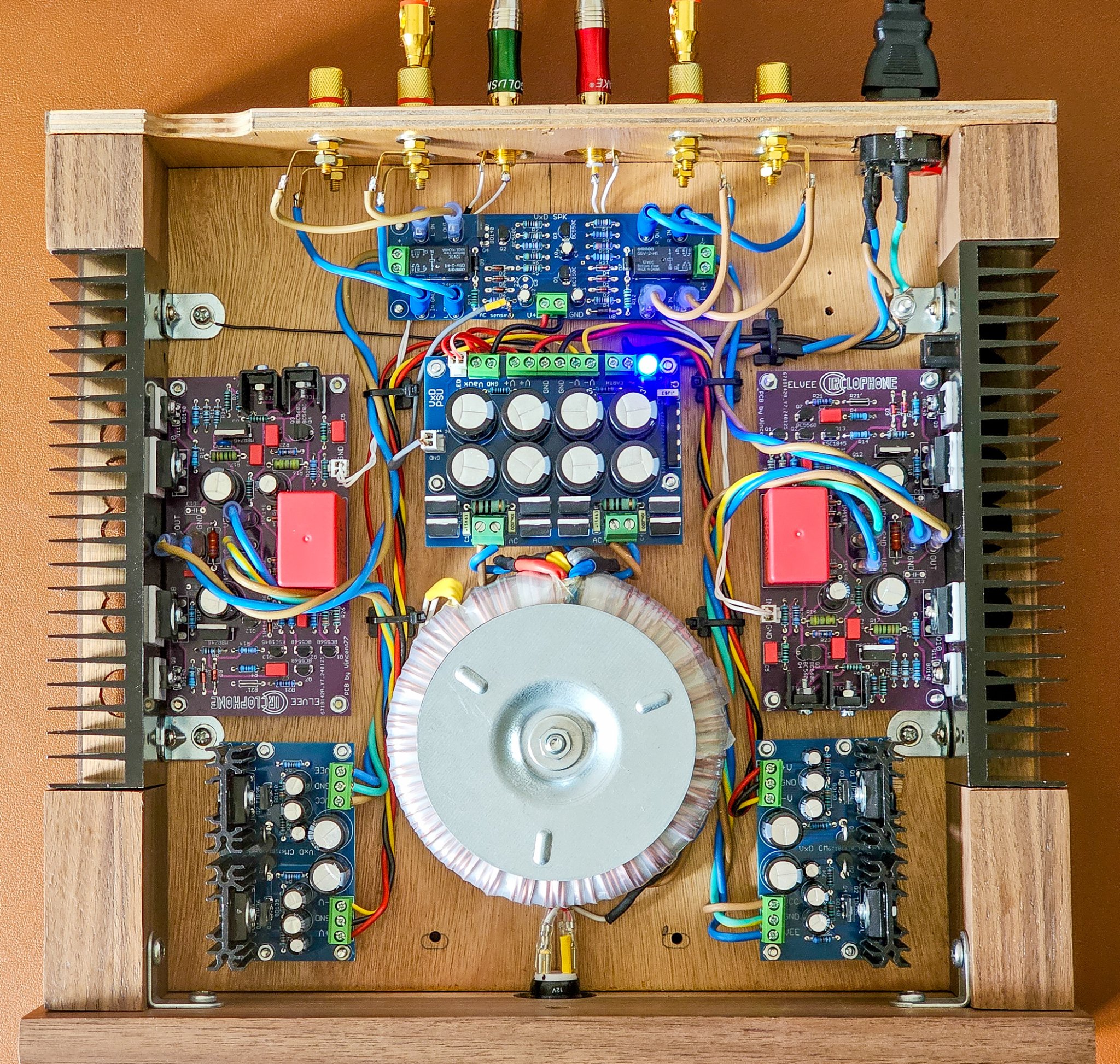

This is how it looks inside:
There are big ventilation holes inside also, under the PCBs, invisible in the photo.
As an evolution to my first test, I have removed the small film capacitors that I had bypassing the local reservoir electrolytic caps. The power supplies are now separated per channel, and is using good quality Panasonic FR capacitors. The power transformer has secondary snubbers tuned with Quasimodo.
These modifications have improved the audio quality - it sounds great now, I'm very pleased with it.
I have added a relay module on the output that does turn-on delay, AC loss detection, DC protection and amp bypass (I'm using the same speakers with two different amplifiers).
I have reduced the power voltage to +/-18V, because my speakers don't need a lot of power. The heatsinks are just warm, +15°C above ambient.
One thing is missing: soft start for the big toroid transformer, I will add it when I have the time.
In conclusion, this is a great sounding project, I recommend it!

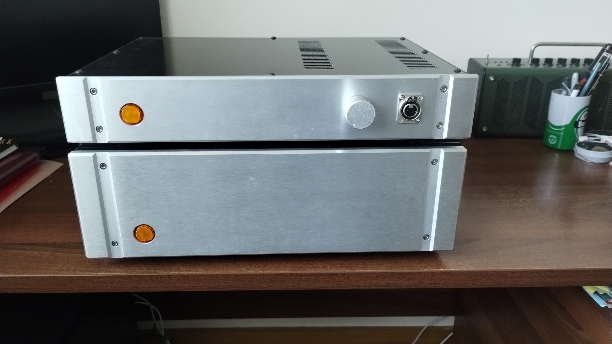

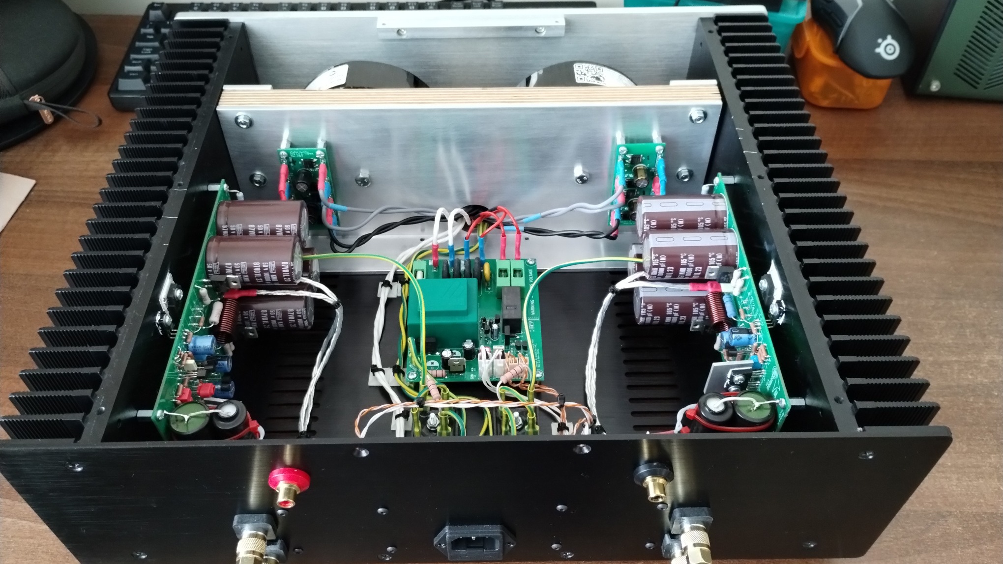

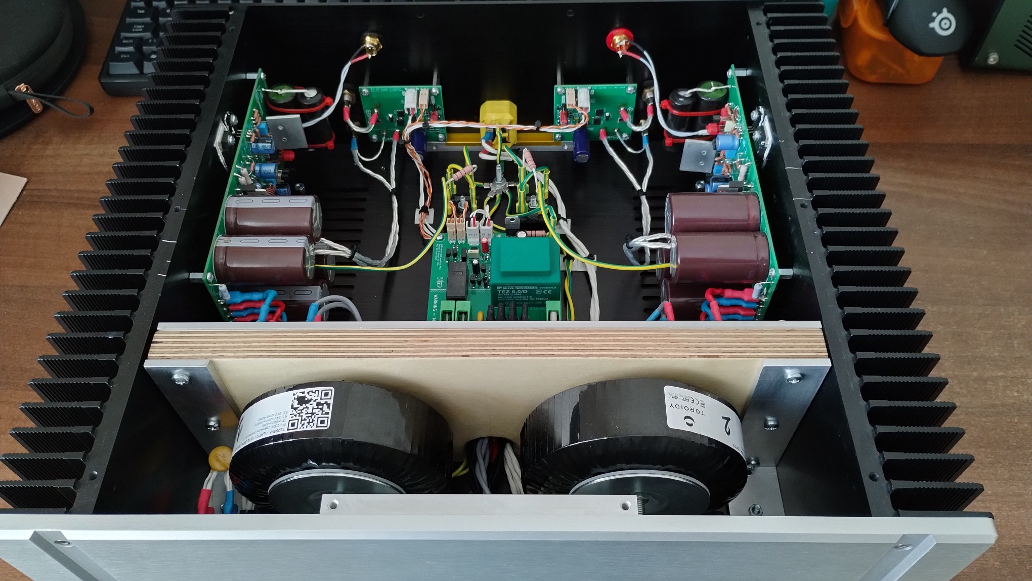

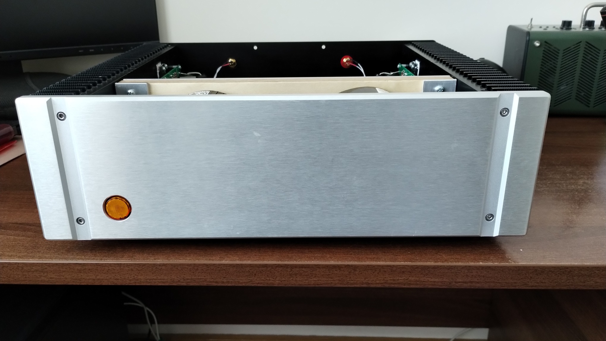

I finished packing the Circlophone into a box as well. It took me around four months. In fact, I have finished and have closed the lid today.
Two DC protection boards are at the back panel. I borrowed the schematic from this thread in the forum: https://www.diyaudio.com/community/threads/rtr-ssr-speaker-protection-gb5.392399/ (big thanks to xrk971 for sharing). The board in the middle is the transformer soft-start module, auxiliary PSU and AC loss detector (to drive the DC protectors).
In the last picture, there is Salas DCG3 (the thread) which will be acting as a preamp for the Circlophone. I built it almost four years ago and nearly forgot about it. It got the branch new and matching enclosure too :)
In general I am satisfied with end result, although some parts were challenging to do. Imporant lesson learned: stop making excuses and get a decend pillar drill - your life will be much easier. This is something to think about for another project (I guess I am making an excuse now ;) )
