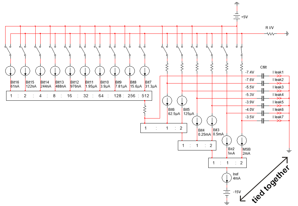

The question is how much of such noise is really generated. Let's see how the outputs work:
(Images from mval)
Now mval argues that the capacitors correct the error of the system and thus once the system is in a stable condition, we can stop the DEM oscillator completely.
I used to have a fat folder with the entiere TDA1541 Schematic at transistor levels - this was from Philips themselves as part of a course for designers about the TDA1541 - the understanding I got was different, however the folder is (sadly) lost to time and my memory ain't what it used to be (hey it never was that anyway), so I will not insist on the absolute rightness of what I did.
I did what I always do, the best I could do, based on the best understanding I had when I did it.

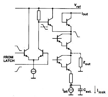

What happens is the signal from the latch (note, it is differential) either turns a transistor on or off.
In on state it will "evacuate" the current of this Bit to +5V (labelled Vref) and the diode connected transistor is reverse biased.
In off state the transistor does not conduct and the diode connected transistor is now forward biased, the bit current flows through a cascode darlington and into another cascode transistor after which we have a resistor and the "DEM" capacitor.
What happens if we disconnect this capacitor? Nothing. As long as the circuit is STABLE.
Now let's switch the bit state from on to off. We are turning OFF a saturated BJT and we are turning on a reverse biased diode. Will the charge being removed from one flow into other and net off exactly? If not, where does that charge go? What completes the AC circuit?

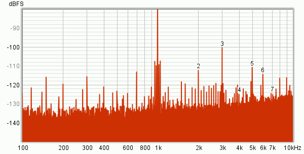

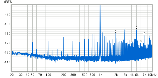

Well, blue is 100kHz (not synchronised to the audio clock I believe) and red is 100Hz. I really don't like what the 100Hz DEM does to the graph. The 100Hz IMD is quite high in level, with the potential for audibility.
It is similar to 100Hz jitter you get from a Clock regulator that isn't actually regulating because it's in dropout and your 100Hz ripple is now providing FM on your master clock. I found it very audible and did not like what I heard.
The fact that machine was sounding "wrong" in fact tipped me off, check on AP2, 100Hz sidebands, but where are they from?

It would be a very interesting test to measure the 'jitter' at the 1541 analog outputs with 50 Hz DEM, 705khz DEM, and some type of DEM sync with BCK (Grundig DEM sync for example, or CD-77 solution).
I did measure Jitter using AP2 on the CD-77. Or more precisely, I failed to measure anything notable, using a CD with a J-Test signal burned on it.

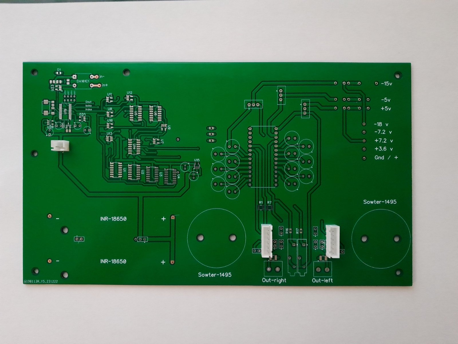

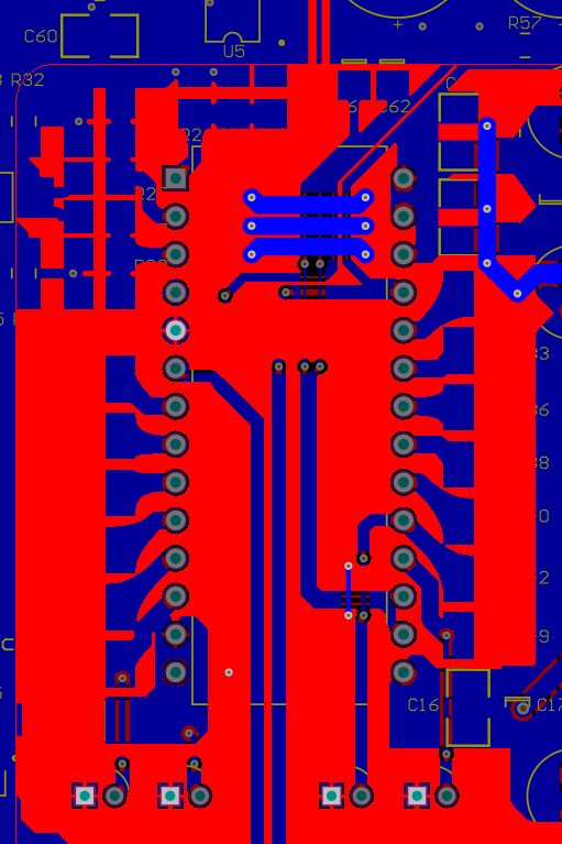

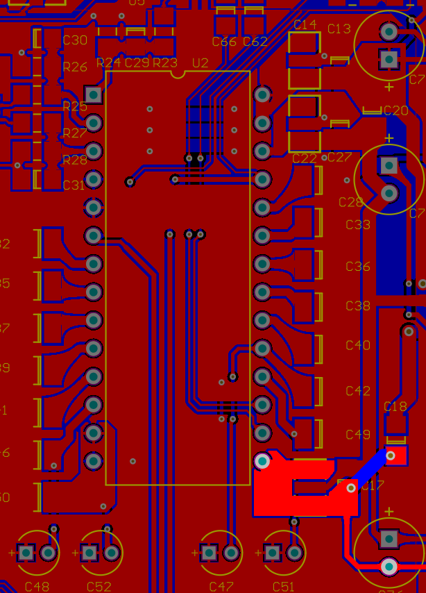

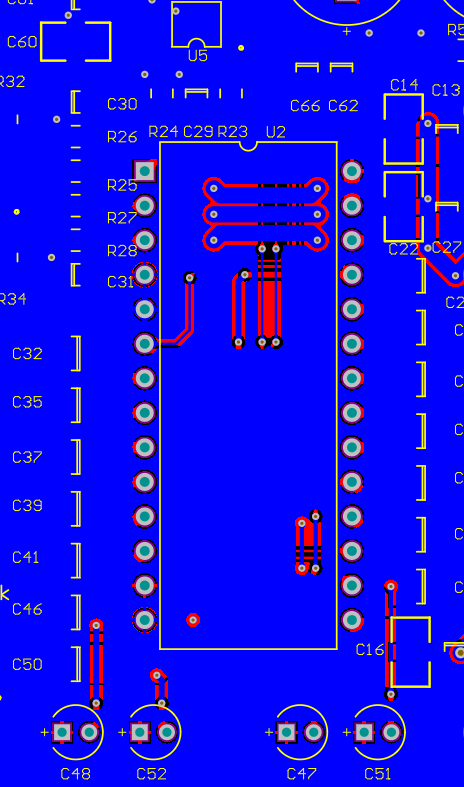

@ThorstenL much appreciated for all the info. I've yet to start my tda1541a adventure, and for sure it will be a 4 layer (SIG+PWR/GND/GND/SIG+PWR) design. But with probably just 2 chips (using 10 is quite expensive, but hey, might sway my mind, honestly fpga programing would take me a lot of time to learn atm). As for separate gnd for DEM, you reckon to just utilize one gnd plane only for it? Where would you connect it with agnd?
I suggest to first look at signal and power flows and make the physical arrangements of the circuit so that there is a natural flow of signal and power.
Also, read H. Ott on designing for low EMI and generally low digital noise.
For CMOS logic it is recommended to have a signal layer between a Vcc and Vss plane. Top and bottom of the PCB should have ground fill with stitching to the actual GND/Vss plane.
DO NOT put anything to "isolate" the power supplies. CMOS logic is push-pull and current loops for charging/discharging the input capacitance are completed via the shortest route, which can be either Vcc or Vss, depending if the edge goes high/low.
DO NOT use audiophile approved bypassing with multiple values, instead find your dominant frequency, pick ONE capacitor with a resonance near the clock fundamental OR third harmonic.
So if our dominant clock is ~ 12MHz, ideally we use capacitors with a 36MHz resonance and put 4 pcs around each smaller (TSSOP14-24), 2pcs for "popcorn logic" and as many as possible for larger (> 24 pins) IC's.
An 0603 form factor 33nF (0.033uF) has ~ 40MHz minimum impedance with 30mOhm minimum impedance, so that would be the "ideal" choice here.
Often just using 0.1uF/0603 will be fine if you use enough. These have 20mOhm minimum at 23MHz and at 40MHz around 100mOhm impedance. If you have 4pcs around a single small logic IC that gives you 5mOhm @ 23MHz & 25mOhm @ 40MHz locally and once we include the inductance and resistance of the power planes (Vss -> normally called "GND" should be considered a "power" and "signal return" Pin.
Stick some distributed large value Os-Con's around the PCB, like 820uF/6.3V.
NOTE, all the above is for all the CMOS Logic, NOT TDA1541. It also means you possibly want more than 4 Layers.
For a 4-Layer stackup I would go with(top to bottom):
1) Signal/GND-Fill (for "slow signals" and component side)
2) Power Plane (Vcc for CMOS)
3) Signal/GND-Fill (for "fast edge signals", source terminated impedance strip lines)
4) Ground Plane (Vss for CMOS)
Once we transition from high Speed CMOS logic into the EC-Logic/TDA1541 domain (or analogue/clock for CMOS based DAC's), use "islands" for the individual power supply and / or signal return planes.
Do not cut or section the actual ground plane, you can use it to
So I would place the DEM Capacitor "gnd" island onto layer 3 and link to "GND" at AGND Pin of TDA1541. The +5V/-5V & -15V would be Islands, as large as sensible.
With one TDA1541 per channel I'd probably use one loop and one AC winding per channel, the power supplies likely "Sziklai" type Shunts (third circuit on this page https://www.tnt-audio.com/clinica/regulators_noise3_e.html) using BCP53 as PNP and Cascoded Current Sources as series element, I usually put a gyrator on the other end that acts likes a very large value virtual inductor.
I would look at the inputs and use some form of limited swing and slowed edge circuit and I would inject a BCK/MCK linked clock into the DEM oscillator (likely HtP circuit) and make a cascaded divider with options of anything from 705.6/768kHz down to 43.066/46.875Hz so you can try each frequency across the range and pick whatever you like.
For DEM capacitors, up to 1uF in Film (Panasonic ECPU etc.) with a PCB Pattern for 1206/1210 with higher update speeds and for electrolytic options I'd likely put a 2920 PCB pattern so I can use low leakage tantalum types in 100uF/25V for very low DEM frequencies.
Decoupling of the TDA1541, FIM Cap's (same as DEM capacitors) close to the IC package, 820uF Os-Con (or lower value for -15V) and then hand over to the shunt regulator.
Now, this is ONLY "what I would do" not "the only way" and how I would I build in some flexibility to make a few PCB's in different configurations for listening tests to compare things like ~50Hz DEM etc.

PS, In my earlier post I asked "the stored charge in the bit switches and associated diodes needs to go somewhere, what completes the AC current loop?"
The answer is, the DEM capacitors to output, via ground and the output to +5V.
It might be beneficial to connect the DEM capacitor common to +5V, never got around to trying that though.
Reactions: 1 users
What about this way to connect DEM capacitors output , and if not why :unsure:
In this case you tie DEM Capacitors to AGND. This is what I have always done.
However, the AC loop the capacitors are closing does not strictly speaking close with AGND, does it?
Remember, current flows in loops and along the path of least resistance.
If on it's way to close the loop, the current encounters a material series impedance, it will cause a voltage to be dropped across that impedance. If the voltage dropped will be in series with anything that acts as reference for anything, we will have a problem.
So it is important to understand what the DEM capacitors actually do. What AC current is flowing and where does the loop start and finish, the loop that these capacitors complete.

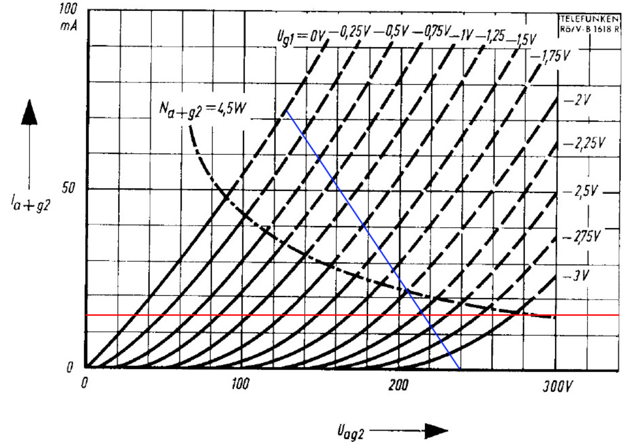

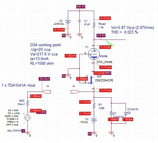

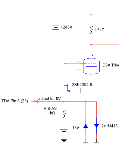

I was looking into impelmenting MVaudiolab's IV stage and I'm having a little trouble understanding the setup:
In his writeup he sets the current at 15mA (described elsewhere), resulting in the following approximate lines (I think)- the 1.5k is determined by the current buffering of the grounded-grid stage:
Is this the correct operating point? How is 2.25V at the d3a cathode enforced by the jfet?
The D3a acts as cascode for the 2SK2394 J-Fet.
The J-fet is operated near Idss which, according to datasheet is 10 - 20mA, so use 15mA as "design center".
With 15mA flowing in the anode resistor (1.5k) it will drop around 22.5V, so the D3a sees 217.5V On the Anode.
The bias of the D3a at ~220V is around 2.6V. With the grid grounded, the Cathode will come to "rest" at ~2.6V.
Realistically, the D3a is a bit bogus here. The J-Fet is the main active device here, it operates in saturated (Pentode style) condition and not in the "triode region". With 40mA/V transconductance the effective input impedance is ~ 25 Ohm.
Using the D3a as actual common cathode amplifier and using a 20 Ohm I/U conversion resistor will probably work very nicely as well.
If using a tube for cascode, a less rare and expensive option or even a high voltage mosfet will likely do as well. When using a Mosfet as cascode, a +48V Supply voltage will be ok.
Even better, I prefer to use a very low noise BJT as Sziklai with a low noise P-Channel Mosfet (say MMBT4404 & BSS84), for a lot of stuff like I/U conversion. Make the output a folded cascode (P-Channel Mosfet), with 1.5k to ground as I/U conversion resistor.
THEN add the correct sallen key lowpass filter with the correct peaking for either SAA7220 or for non-oversampling using a tube that sounds nice as cathode follower. This way something glows and actually impacts the sound and low noise etc. is guaranteed.
Thor
Thanks so much for explaining it Thorsten, that certainly wasn't as obvious as I thought. So in this case R_bias is just zeroing out whatever voltage the jfet settles at?
What you're describing seems consistent with some of his more subjective findings- specifically that the sound isn't impacted as much by the choice of tube in this configuration.
I was originally hoping to mimic this design with a c3g (because that's what I have on hand and they seemed like they could do similar work in that spot). Would transformer I/V make more sense if I wanted to pursue a grounded-grid design that "impacts the sound"?
Alternatively a c3g also sounds like it might work as a gain stage following a passive I/V like what you mentioned.

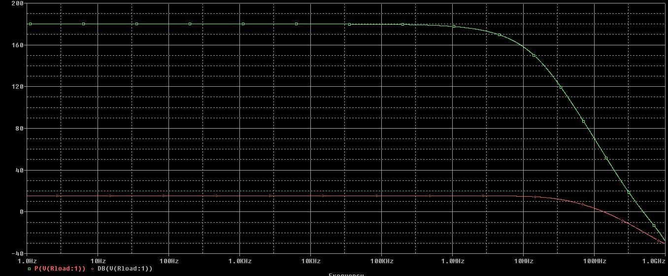

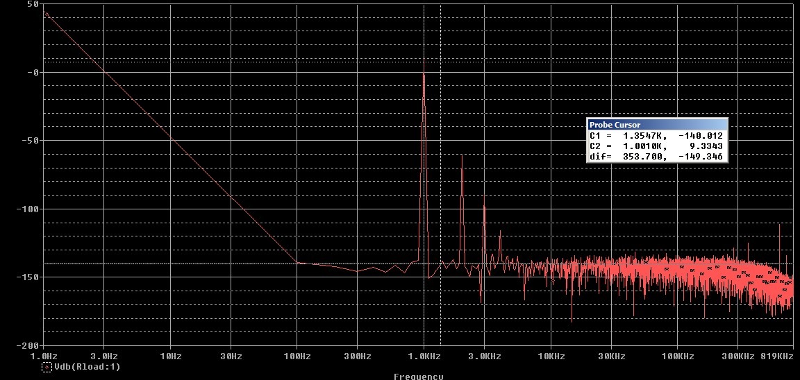

some Spice sims of the circuit (with generic "abstract" Power supply, that is critical because PSs will determinate the noise floor and mask achieved good harmonics resolution):
D3A working point is
-Ug=2V cca.
Va=(219.6V-2V)=217.6V
Ia=13.6mA cca. (including 2mA current inj. for TDA1541A)
RL=1.5K
Vo=5.87 Vp-p (2.07 Vrms)
THD=0.023% (only for that stage, probably with the rest of the circuit will not change a lot)
Phase is INVERTED for +180deg and that should be corrected. One way is to add interstage transformer after already present in the whole circuit, the low impedance buffer...
the potential from PS to Anode of D2A is just about +20V, so the most JFETs buffers in classic configuration can be used. Or even low voltage tubes as ECC86, some nuvistors, etc...
cheers

Things like going differential or using simultaneous mode at low speeds give benefits mainly if the list above is not checked off.
Again, I'm no guru nor do I have the (w)holy truth, just my experience with TDA1541. I have not done any work with in the better part of a decade.
Thor
