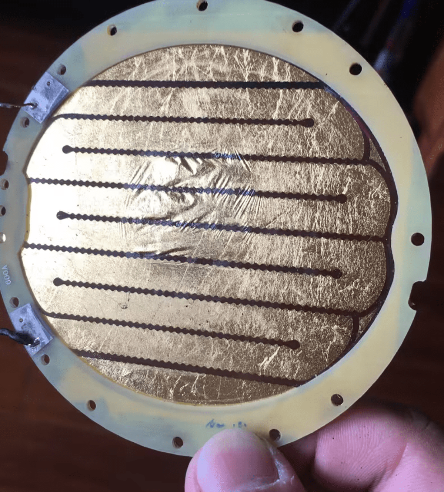

I'm slowly but surely getting into the hobby of making planar drivers. I've done research and I'm confident enough I can have a go at building my first driver. For the time being, I want to stick with building a planar headphone driver, Hifiman style. Having found teardown pictures online, their driver look sort of... amareutishly put together, even in their high end expensive pairs. Here's a picture of the Ananda's driver (500$)
Or the HE-6 (1200$) which employs a thicker membrane that is gold-plated.
Or the HE1000SE (2250$), which uses rather thick traces.
I want to play around with thin, pre-aluminized Mylar preferably, to etch out the traces on the membrane using ferric chloride by masking them out with stencils.

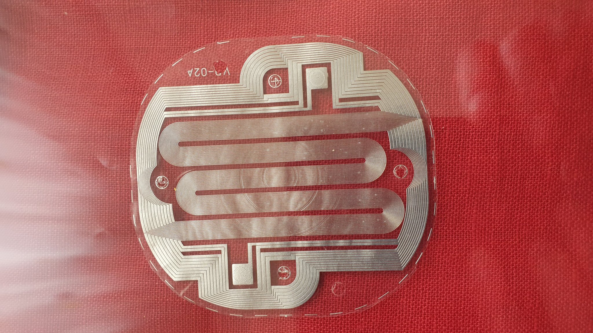

Etching is better with NaOH. I planned to use a photoresist, that is used by DIY printed circuit board making. A good film should be the first step, as on my photo.
I have a pair of perfectly working Technics EAH-820 headphones, and another pair with one side damaged. But never came to the point to finish it. Partly because I have a pair of Peerless PMB 100, also orthodynamic HP.

That is extremely clean, wow! I'll go to Carrefour today and try and find the film that you used!
I have a few questions if you don't mind:
1) What kind of printer did you use to print the stencils you used to photo etch the traces? Toner printer? Inkjet? Specially ordered or just made at home with a competent printer on good transparent film?
2) I'm having a hard time wrapping my head around how to make a photoresisting etching on aluminized plastic foil. Do you spray the entire film with some sort of photosensitive product, lay the stencil on top, and expose it to UV light? It's hard finding informations online for this specific use case. But since you did exactly what I want to do, that's kinda perfect!
I have a scew caliper (micrometer) and measured the original diaphragm. The foil is 15 um, the aluminium traces are 20 um, total 35 um. When measuring, fold 4x, 8x, or even 16x, measure, then divide for better accuracy. The Carrefour foil is 15 um total.
I also have gold leaf, used by picture frame makers and art restaurators, but never tried to apply it to a plain mylar foil. Etching is with Aqua Regia, that is 75% HCl + 25% HNO3, at 90 °C. Or with so-called Lugol solution, that is I2 + KI + H2O 1:1:5, speed is 1 um/min. I is iodine, I think. Never tried it either, it comes from the literature.

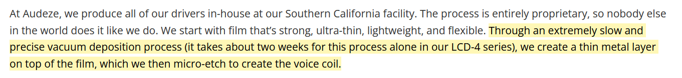

I know for a fact that Audeze uses vaccuum deposit to coat their drivers.
I also have found out that Hifiman, on its highest-end headphones (Susvara, 6K$), uses 'OS Film', that is 0.5 micron mylar and gold leaf.
If you look at the foil itself, you can kind of see that it's been brushed on and burnished by hand, not by a machine! I've done a fair amount of silver leaf gilding and this looks EXACTLY like it. I'm thinking they basically just gild the mylar and then etch it with chemicals.
So it makes me wonder whether 'amounts' are important here. A gold leaf is on average 0.15 microns. That would bring the entire thickness to 0.65microns, hence the insane resolution this pair of headphones have.
To further my point, I would argue that's it's precisely why the traces are so thick and cover the entirety of the membrane: to make up for the fact that the metal itself is extremely, extremely thin. It's a big trace so micro-cracks won't break continuity I would guess.
