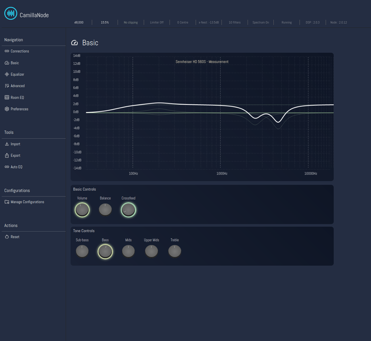

Long story short, I was looking for alternative UI to control CamillaDSP as a simple equalizer for various headphones I use during the day, and started an investigation to find out what are my options. That investigation turned into a small project to develop an interface that works as a basic PEQ with AutoEQ integration, called CamillaNode, which is available on GitHub for anyone interested.
CamillaNode can run on the same device that runs CamillaDSP, or you can run it from your other PC/Mac/Linux machine to control the DSP running on another machine.

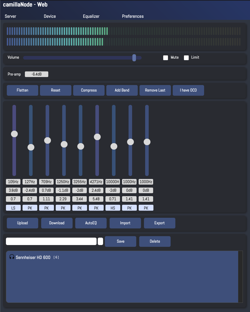

I have very recently added also a web version, which can be used directly from the web without installing any apps

As I said, no information is stored on the web and all configurations and settings are stored in the browser you use.
- Make sure CamillaDSP is configured with -a 0.0.0.0 option. That links the built-in websocket server to the external IP of your SBC. By external IP I mean external to the SBC, still on your LAN and not exposed to internet.
- Simply navigate to http://ntxrx.com and enter the local IP address of the computer running CamillaDSP and the websocket port number and click save
For the Web version, you might lose the ability to make changes as you said however your music will continue to play, and your devices will function normally even if your internet connection is interrupted. If you want you can download the webpages and run it on your computer as well, there is no specific reason why it needs to be on the internet. Alternatively, you can use the node.js version as well of course which will have no reliance on internet to work and will offer a bit more control.

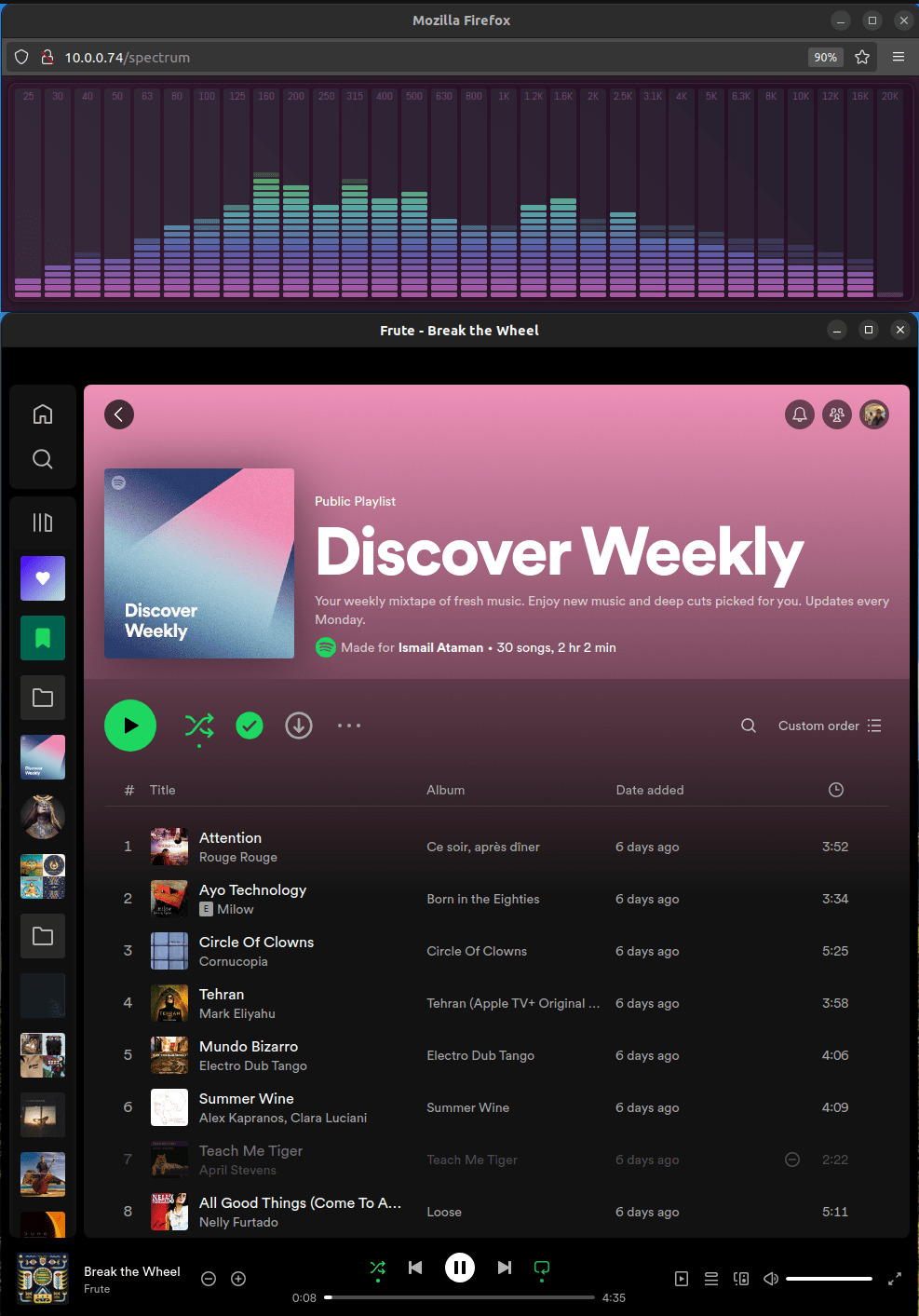

- A 30 band spectrum analyzer, heavily inspired by CamillaDSP Monitor

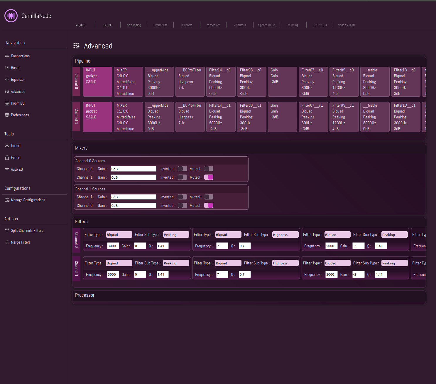

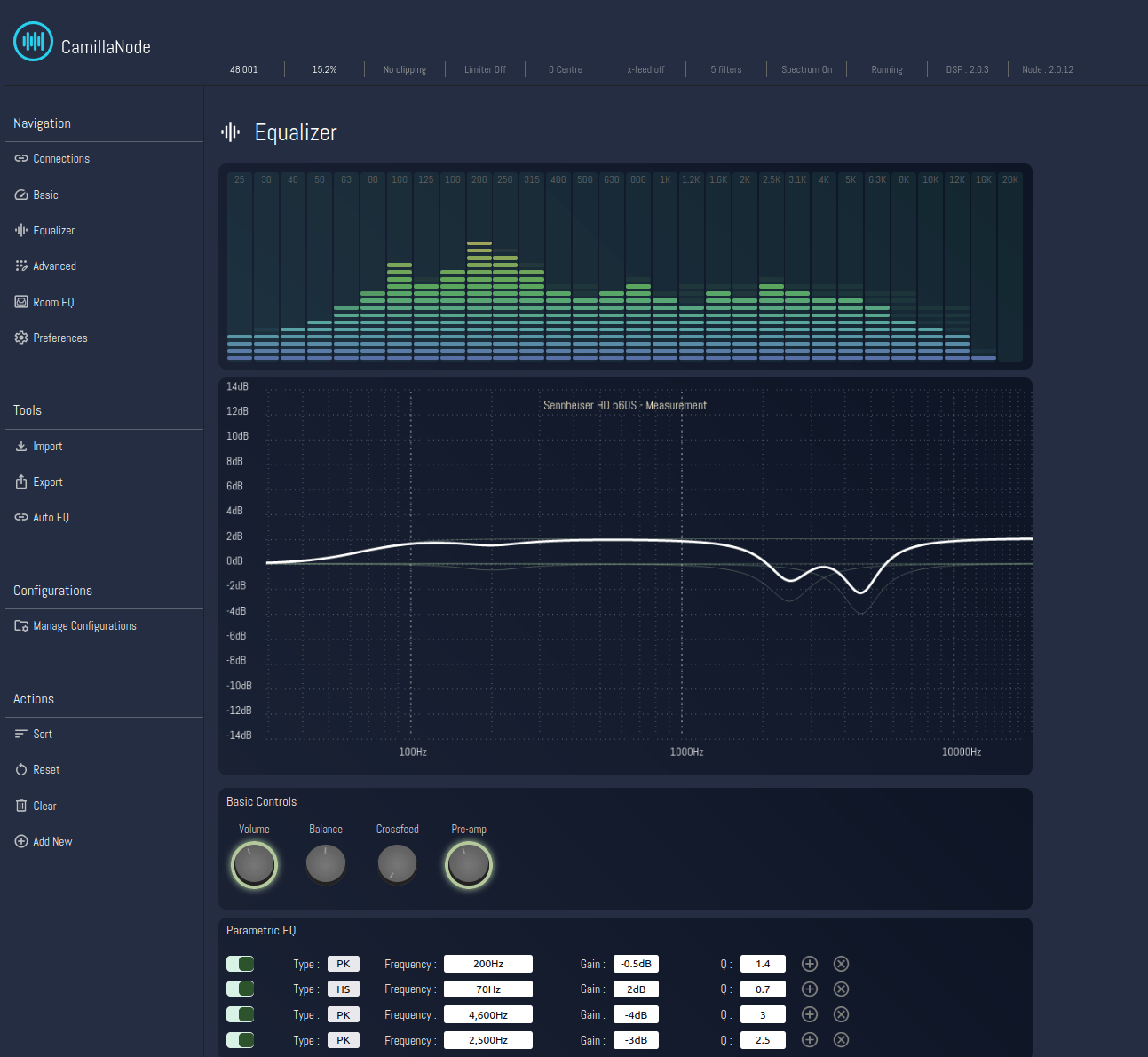

- Separate EQ for Left and Right is full functional and (hopefully) bug free now. If you can switch to multi channel EQ from a single channel setup, the app splits the filters to both channels for them to be adjusted separately.
- Advanced tab shows all the details of your configuration, and allows for direct manipulation of parameters as you wish.
- Added a floating spectrum analyzer feature - if you double click on the analyzer on Equalizer tab, a small window pops-up with the analyzer on it, which you keep on your screen for your own entertainment.
