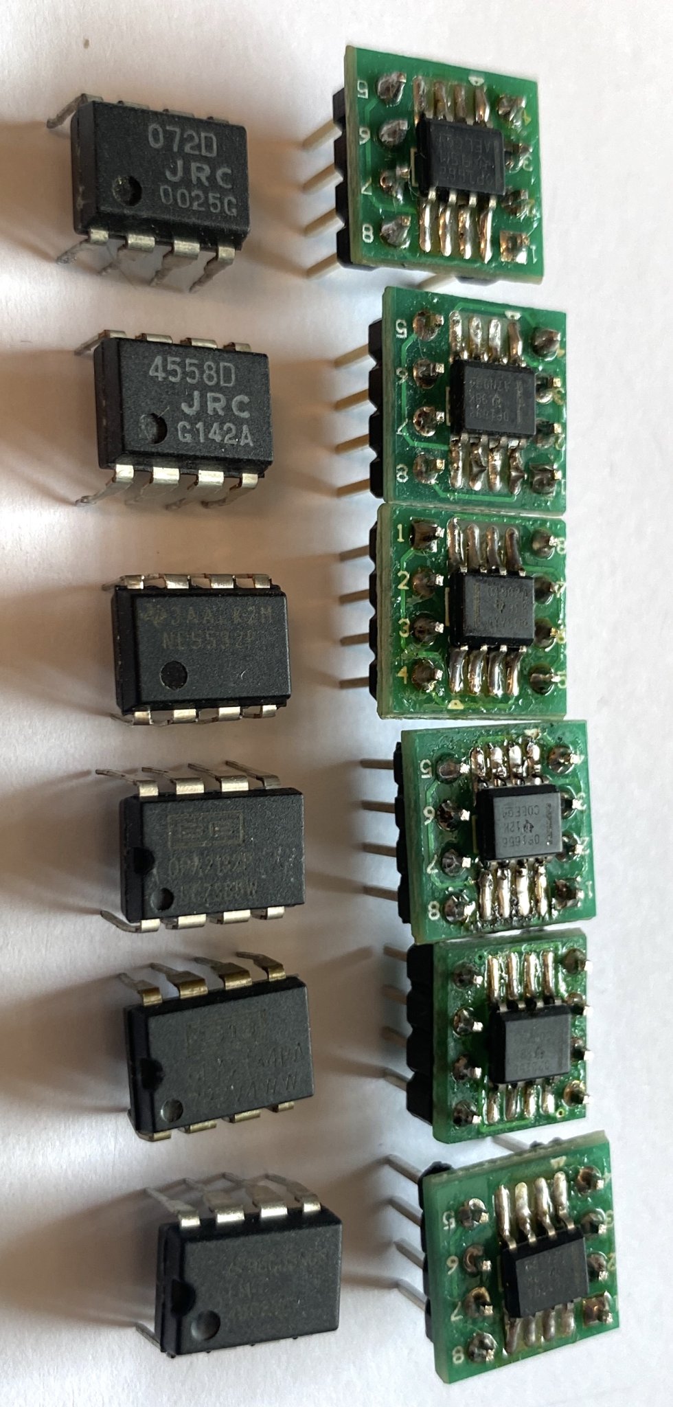

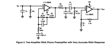

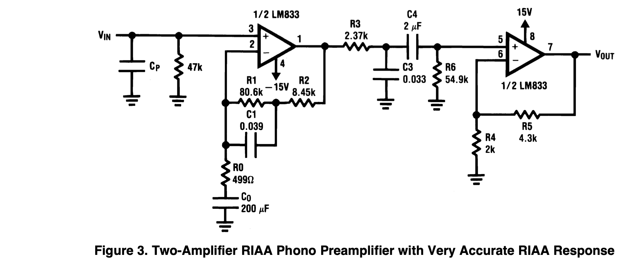

Here is my attempt to try a few op amps.
I built a prototype on a breadboard using the circuit in the second picture.
I tried the following 12 op amps (first picture).

The noisiest op amps is JRC 072. All others are similar. OPA 1612 is the quietest.
Noisewise, with any of the op amps the prototype is quieter than the cartridge (AT-MONO3/SP) + vinyl.
Sonically can't make significant distinction, but OPA 1612 might sound best.
Thank you to all that made suggestions.

moving coil
The gain is much too low for a moving coil cartridge, or is it a high output moving coil cartridge?
Edit: it is, and it is meant for playing shellac rather than vinyl: https://www.audio-technica.com/en-us/at-mono3-sp
Edit 2: 78's are usually not RIAA corrected, but have a correction that depends on the record manufacturer. Are you sure you need a RIAA amplifier rather than an amplifier with switchable correction time constants?
According to the link in post #58, it is meant specifically for shellac records. Records from the 1980's and 1990's are made of vinyl rather than shellac and require a much smaller stylus (microgroove). You could damage your records when you play them with a much too large stylus.
