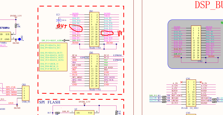

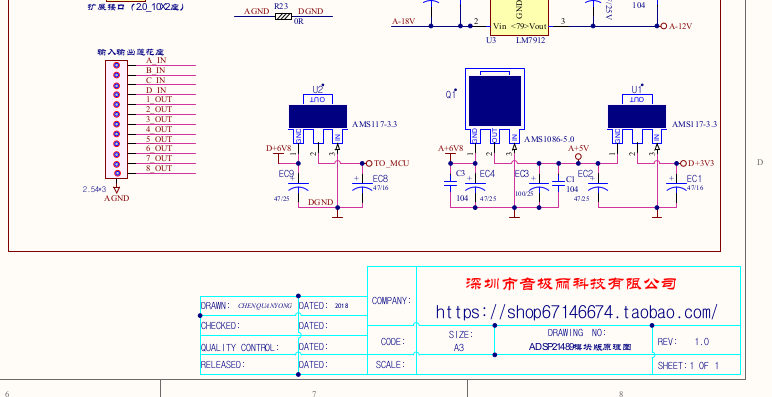

I found shop address also in schematics:
https://shop67146674.taobao.com/
About SPDIF
What I found in one of text files:
IN I/J(S/PDIF) A17(S/PDIF)
OUT9/10(S/PDIF) A12
So it seems both in and out are working out of the box when it comes to firmware

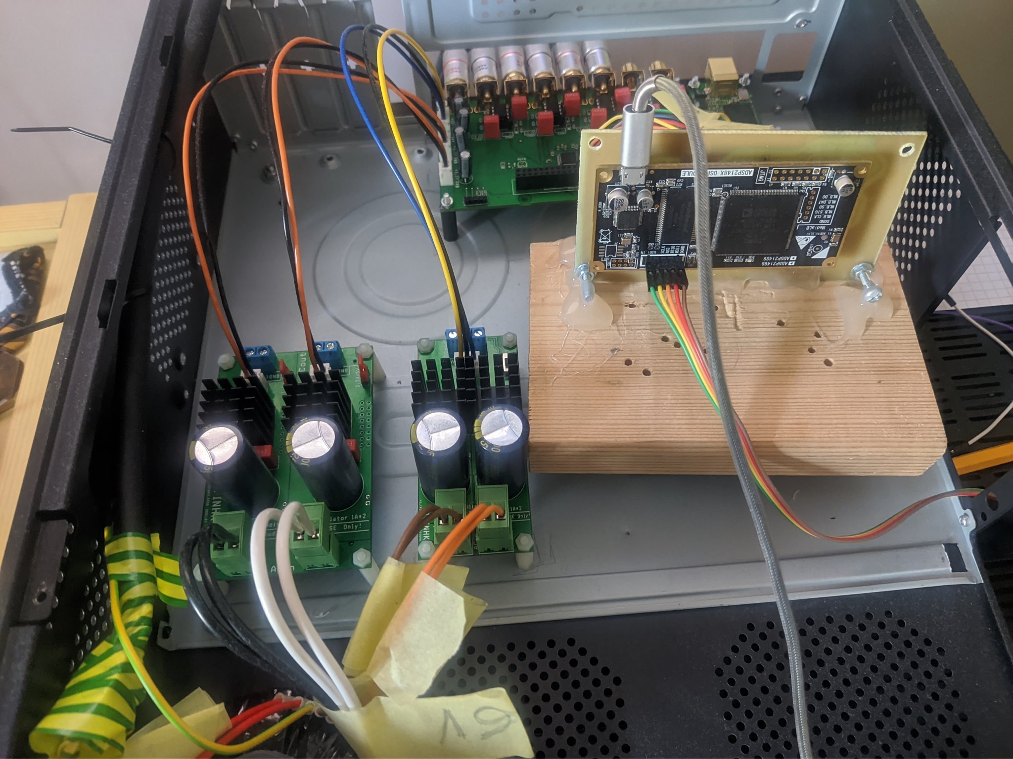

I am using just DSP board without their Motherboard or DAC/ADC, I use my own inputs and outputs via I2S
I have it connected with CM6632A XMOS (In slave mode) and https://www.diyinhk.com/shop/audio-...84khz-32bit-es9016-pcm-dxd-dsd-audio-dac.html
For more flexibility and comfort I want to add bluetooth input, rotary encoder (input select and volume control of dac via i2c registers - more like mute function acutally, oled or lcd screen) So experience is as it is finished product I had raspberryPi hooked up as input with various distros like volumio, moode audio etc.
Was really easy to set up, had most of functionality.. except one - resampling of bluetooth and it seems impossible to be done on ALSA so also on most popular audio streaming distros - cannot feed SHARC DSP board with 44.1k, need to be 96k (on vendor firmware)
So I ordered ESP32 will play with it.. other option for me is Qualcomm bluetooth CSRA6620(or similar) + programmer (this one have resampling done in hardware)
and think best option - Enable ASRC on DSP board
SHARC also have FIR accelerator.. not sure its enabled by default, think it needs special version of algo in SigmaStudio
About SPDIF
OUT9/10(S/PDIF) A12

5) I like your setup. Quite nice. I have more to do as mine is getting strapped to an L bracket strapped to a self-made plate amp. I'll have 3 power supplies (already checked the power supply for this board and the Arylic Up2Stream Pro v3 can take the inrush of current by the power supply for the amplifier units. The power supply for the amplifier units is a 48V DC, 800W continuous, which the drivers added together doubling their RMS is within the continuous rating of the power supply. But that takes up that, then the shelf of power supplies and the Arylic. Then the DSP on the shelf. Then the amplifier units with a large heatsink on the other side of the plate for those (TPA3255 amplifiers for now). The Arylic allows for connecting by bluetooth, but streams the stuff from the internet, so less delay issues from bluetooth. But since the Arylic acts as the preamp for the system (including use of a remote for volume control), that solves a fair amount of my issues. But, the problem of Arylic is the sample rate. So it should pass through the analog signal, but the digital signal will go over SPDIF.
I considered doing the RPI4, but then changed directions. Instead the RPI4 I bought will now be used as a signal generator for display calibration (I have the i1pro2 and i1Display Pro).
