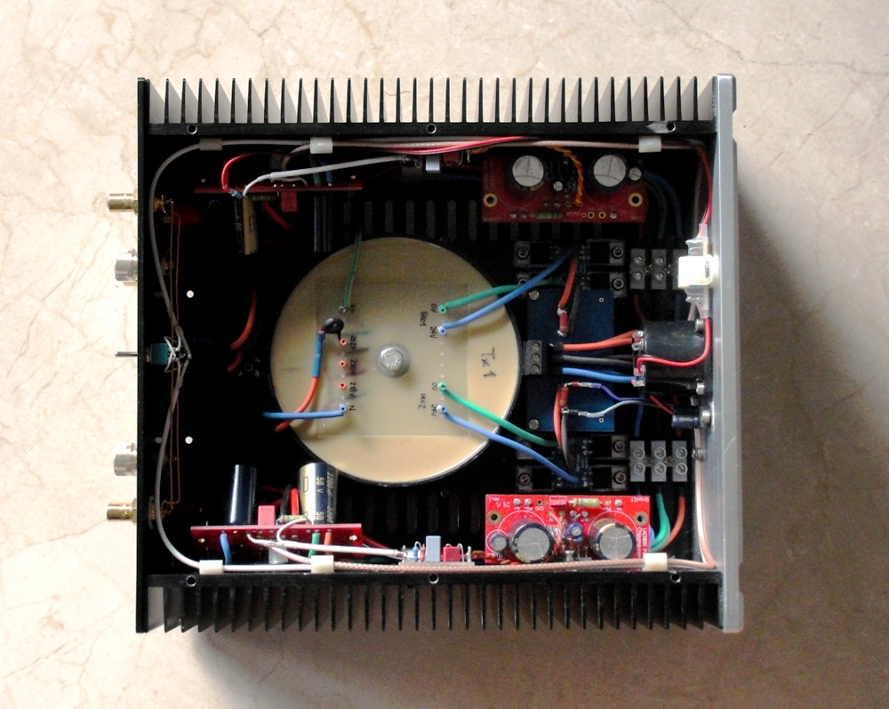

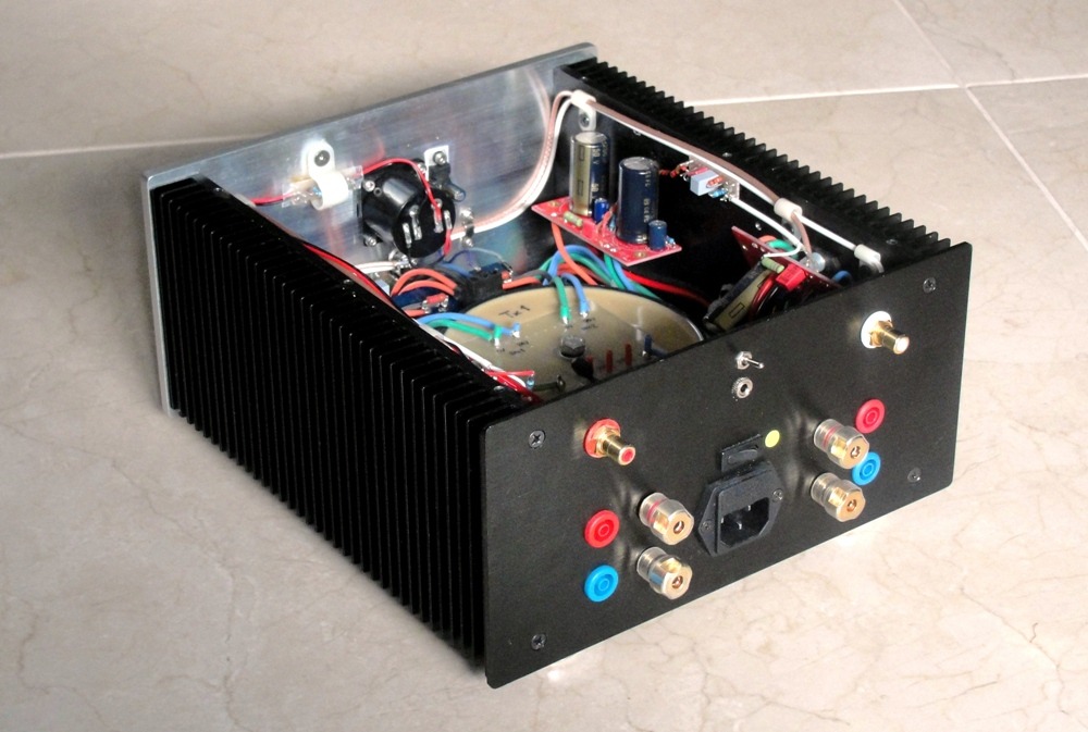

My bad. The transformer is a custom with 2x 22-0-22VAC windings. If designed correctly there is not any difference to shout about between that and two seperate transformers (costing up to half as much again). Yes the IC amplifiers each have their own power supply. better power handling and less noisy rails as well as better channel seperation are all advantages here....

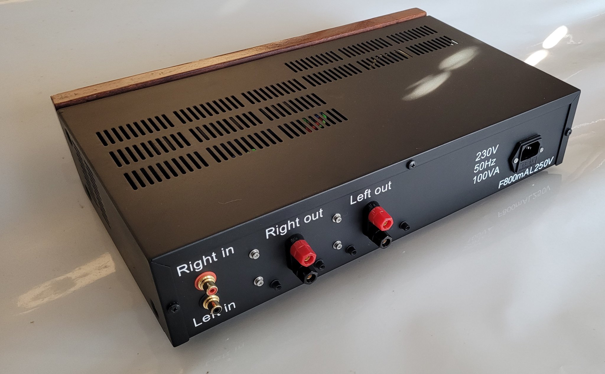

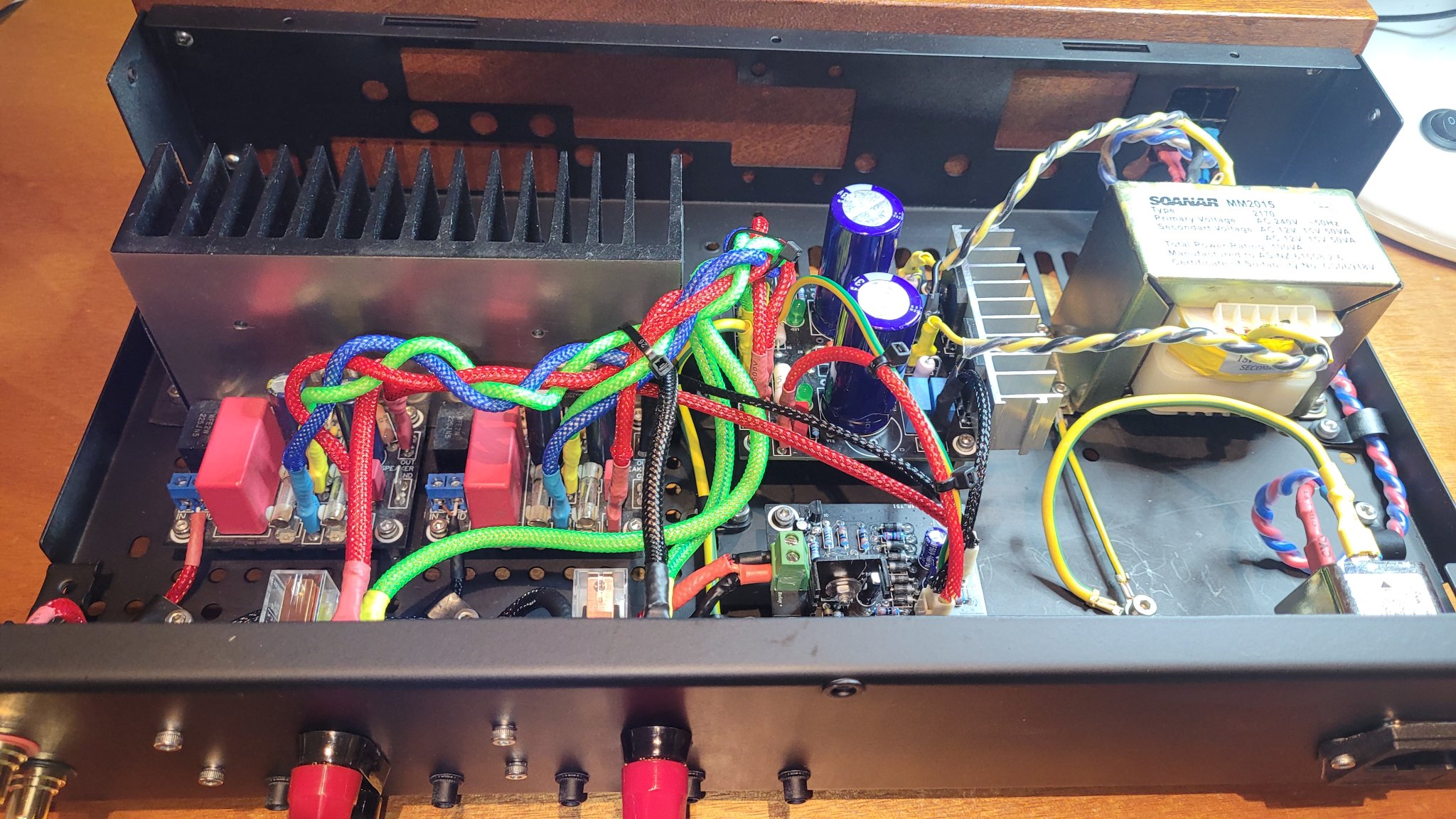

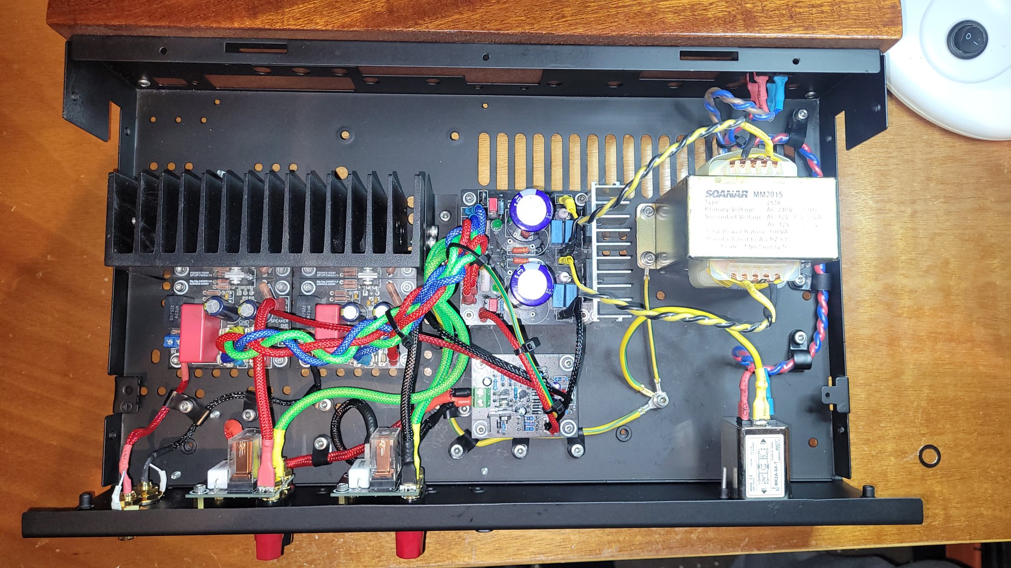

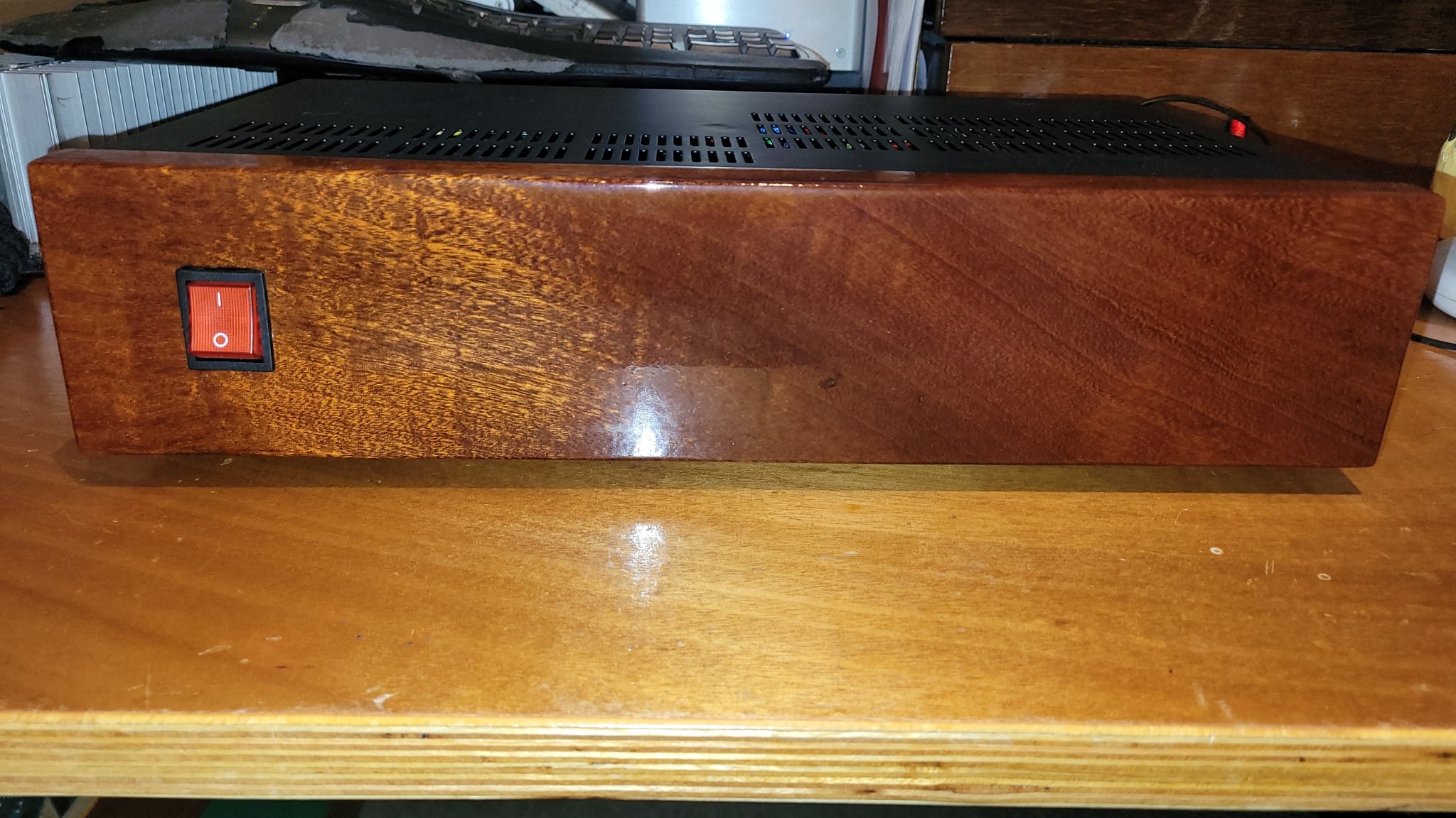

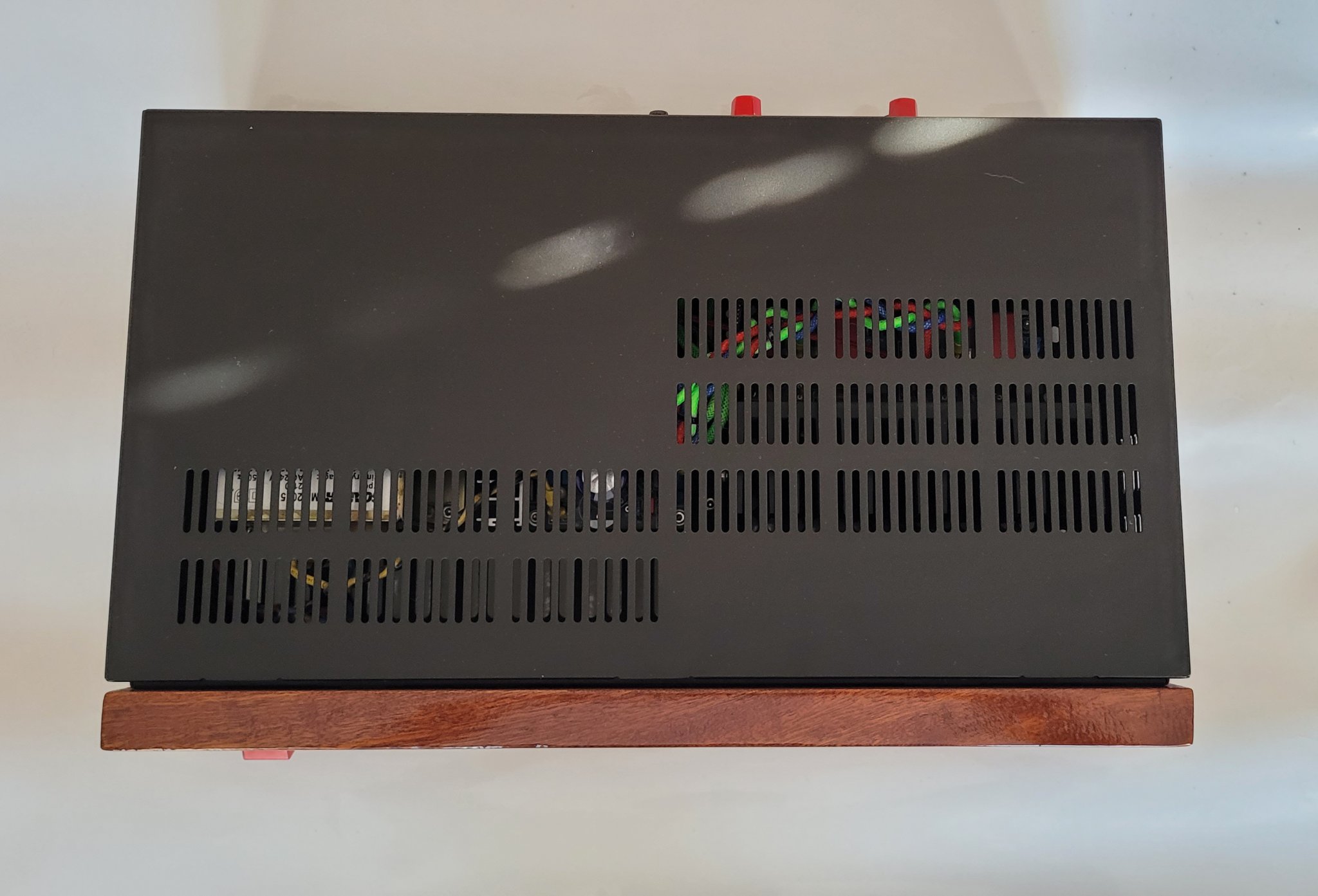

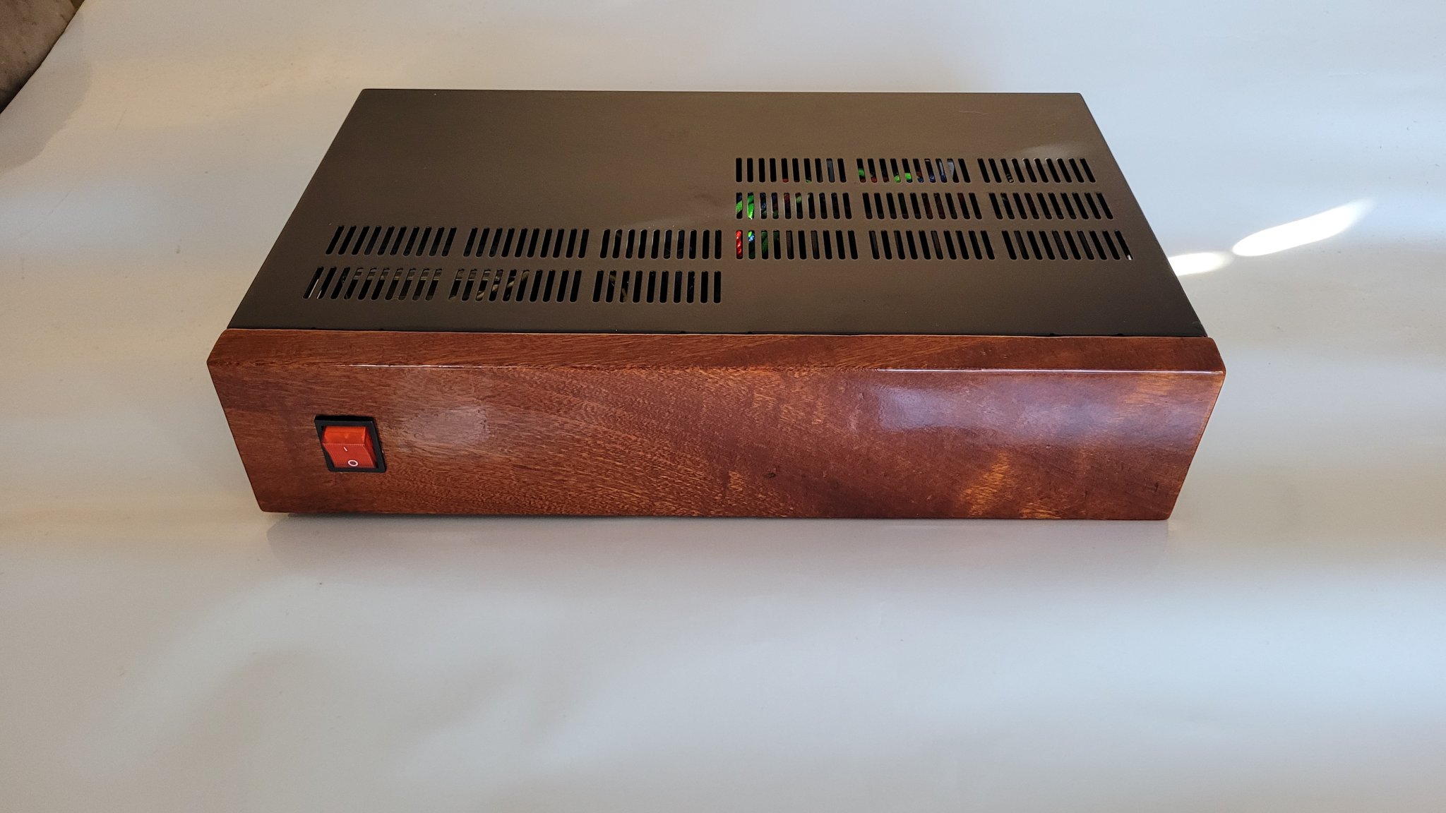

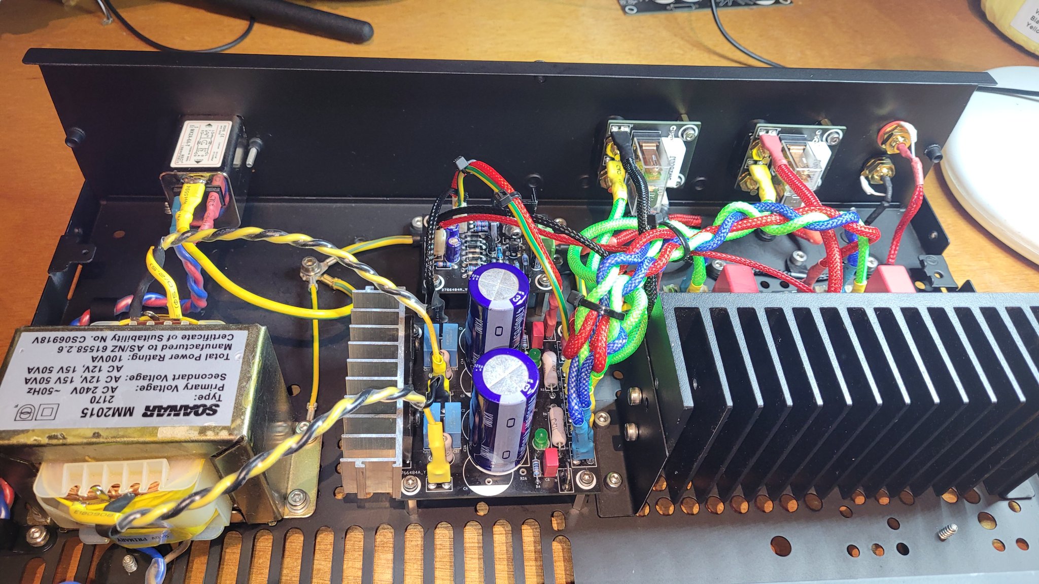

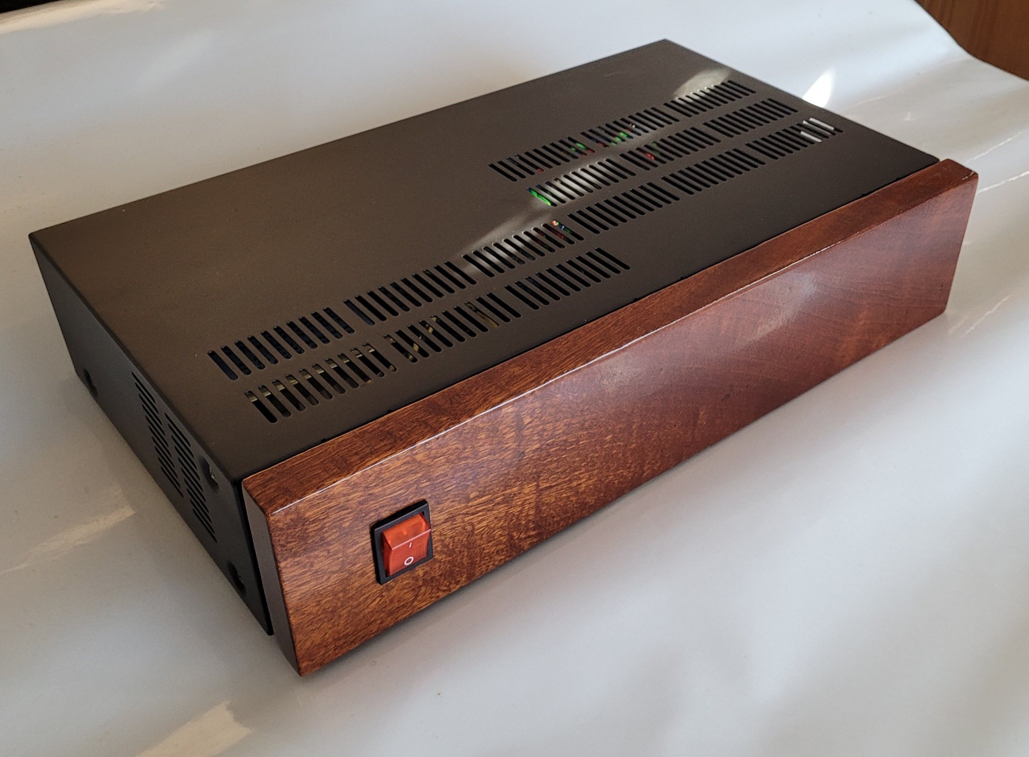

G'day Guys,
Here is one I made for a friend of mine earlier in the year.
LM1875 chips on home brew boards.
Home brew speaker protection based on Rod Elliot P33.
100VA transformer with 2x 15vac secondaries.
Lots of recycled wire and the power switch from a Wega 3 Group coffee machine.
Recycled PA amp chassis albeit with a fresh back panel I folded up from an old dishwasher.
Recycled Mahogany for the front panel with many coats of various danish oils and clear coat.
Reactions: 13 users
I've found that coffee machines are a very good source for power switches and wire as everything is heavy duty.
Typically the power switches are rated at 15A at 230V.
The wire tends to be fat and 600V rated. I just salvaged some mains wire from inside the flex cable power cord on a coffee machine: 3core x2.5mm2.
This stuff is wonderful. Italian mains wire is much much better than the stuff available to me locally. The 2.5mm stuff is much more flexible and easy to work with than the 18awg stuff I can get from the local Jaycar. Much easier to twist etc. And free!
Also by the time you salvage a whole machine worth, there is often many colours not just brown, blue and green/yellow, and multiple gauges.
Dress everything up with some cheap PTFE braid off of ali express and you got some nice looking stuff.

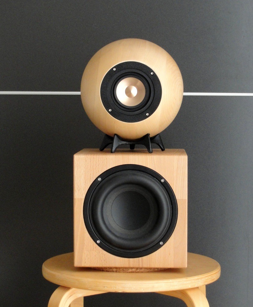

4 channel LM3886 with original BrianGT boards.
Case, transformer, etc. were left-over from another prototype.
Drives a pair of Alpair 6 (Gen 1) Sphere + closed-box woofers.
Crossover is just 1st order LP for the woofer.
Patrick

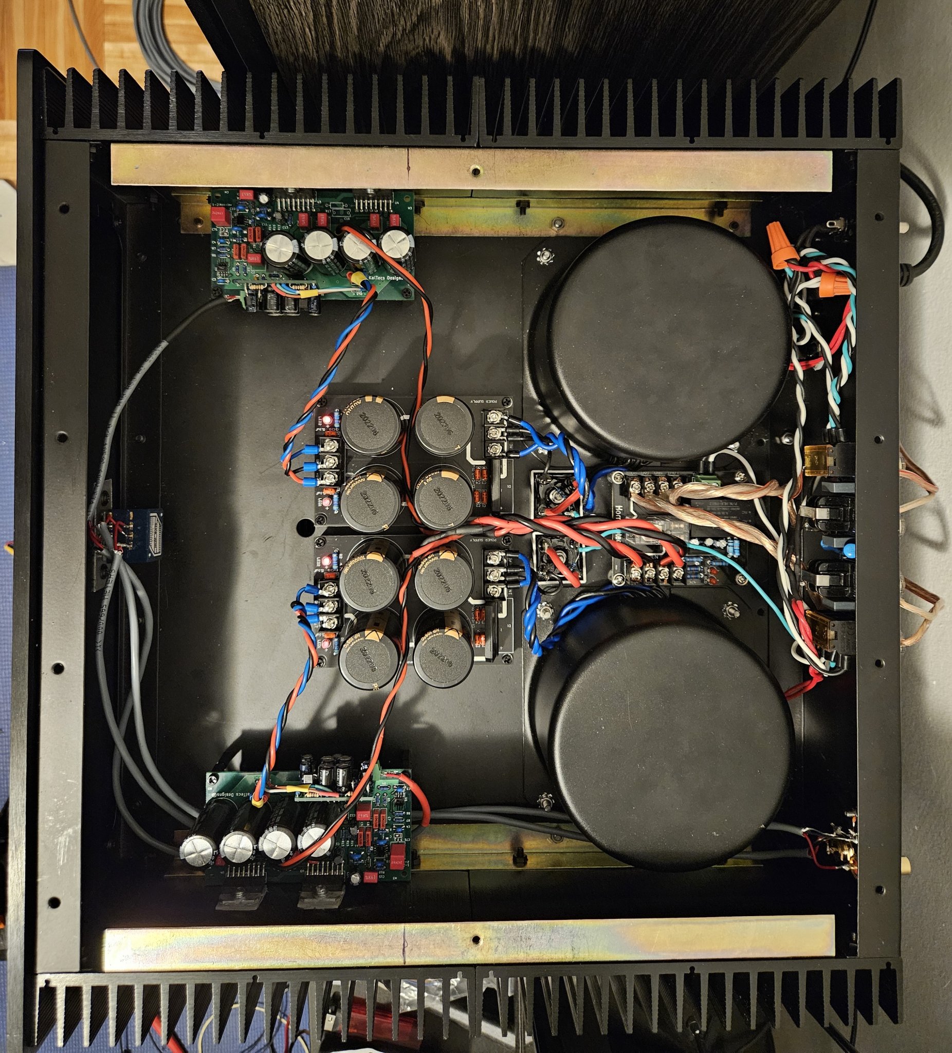

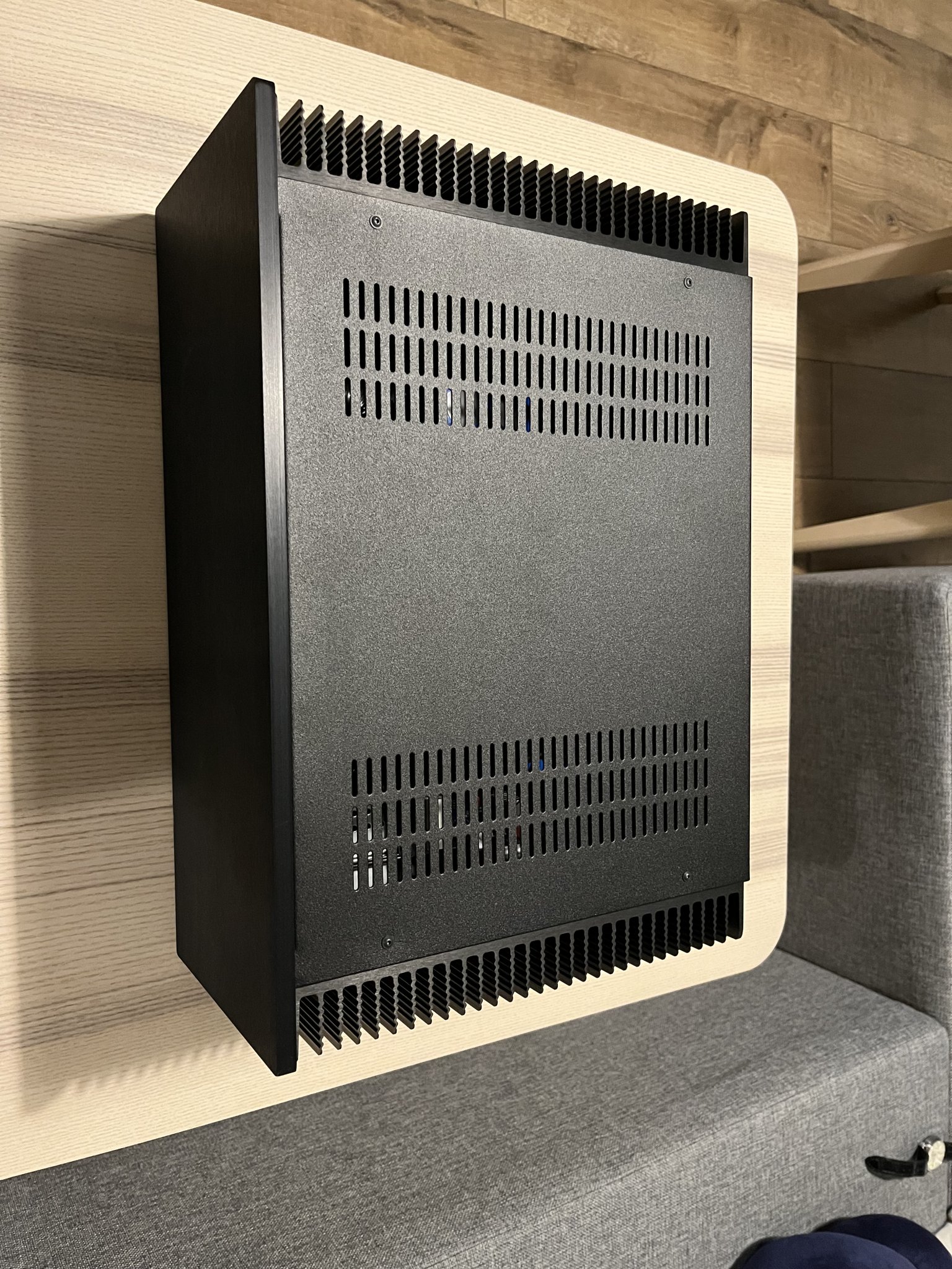

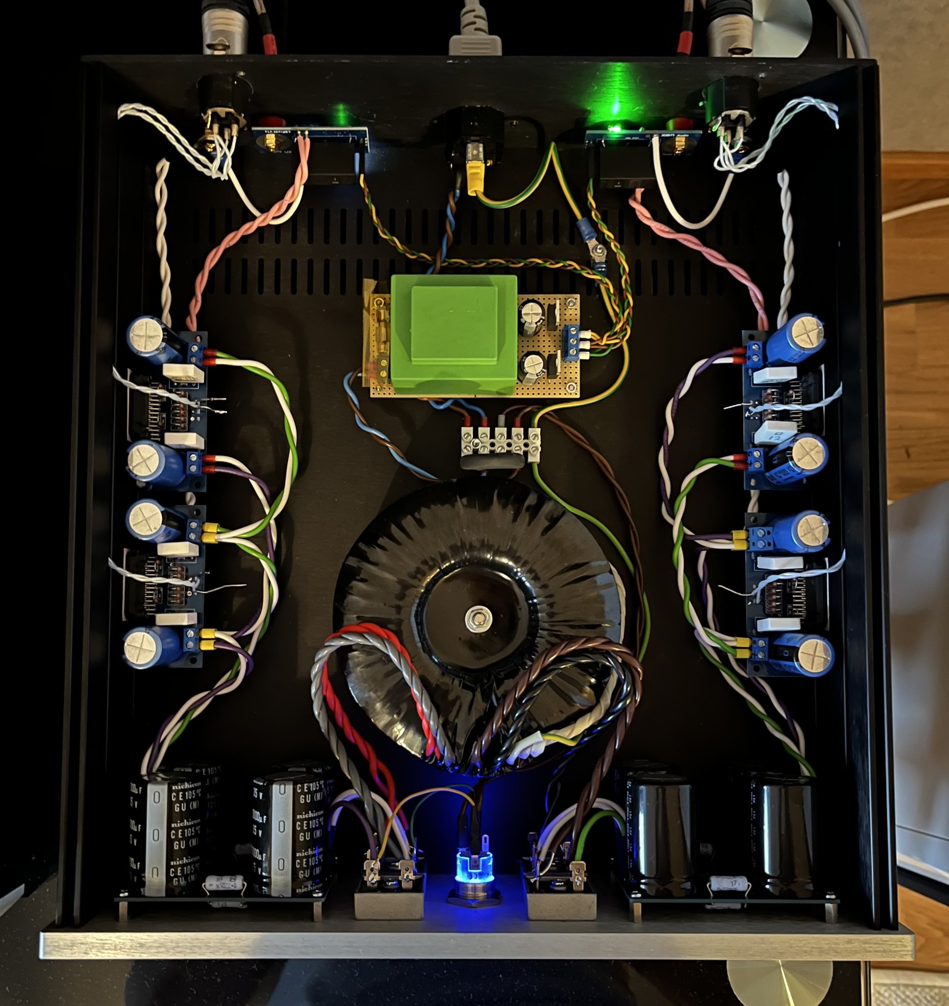

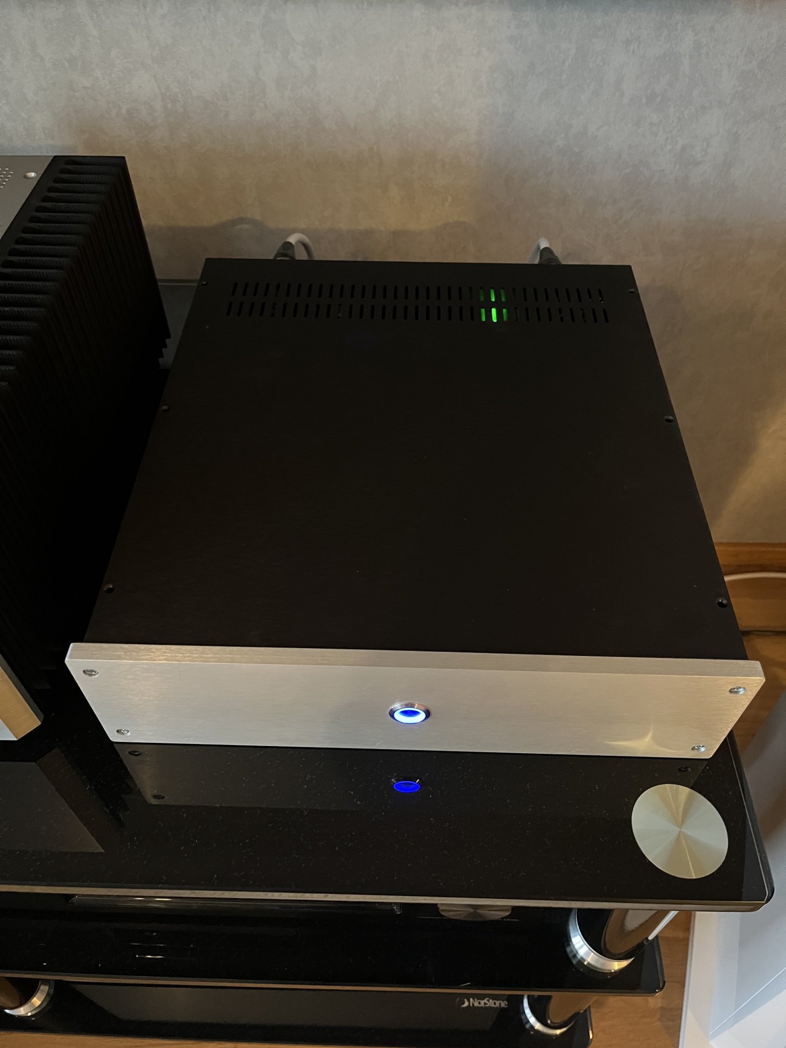

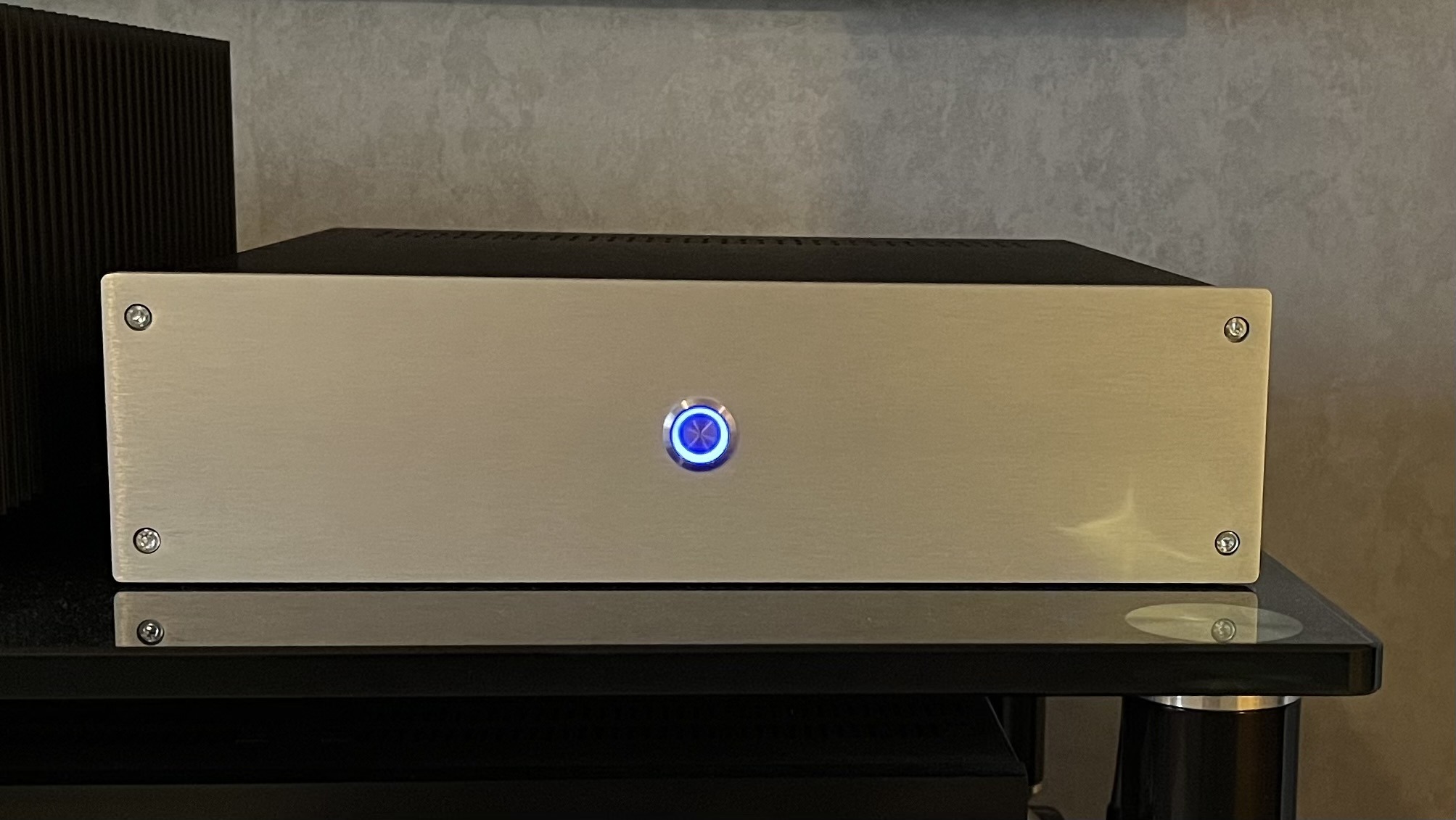

About two years ago I made a ”Summer Amp” in close collaboration with Patrick.
  • 2 x LM4780 per channel in bridged parallel mode
  • fully balanced
  • XEN LM4780 PCBs
  • +/-20V rails with CRC for each channel
  • 400VA Toroidy trafo
  • XEN speaker protection fed from aux supply
Runs cool even with just the small side panels as sinks with my listening levels and speakers. Thanks Patrick for this great amp! 😁

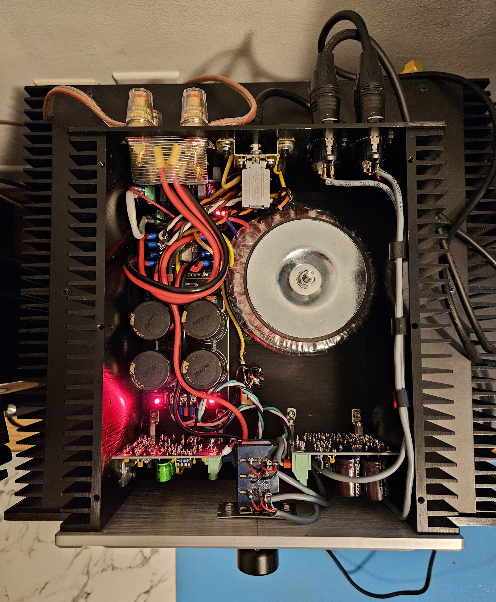

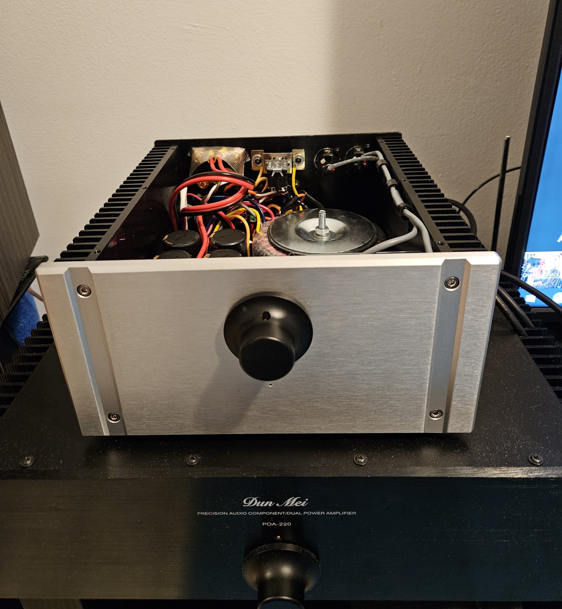

  • fully balanced
  • XEN LM4780 PCBs
Beautifully laid out and excellent wiring!
I don't see anything wrong with the enclosure . But I personally prefer black boxes and leave the fancy for inside..

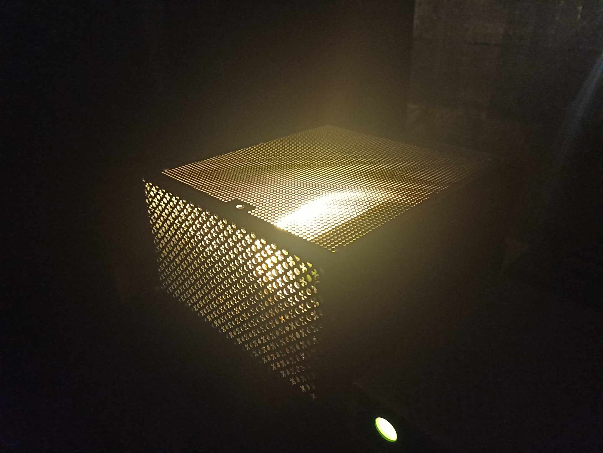

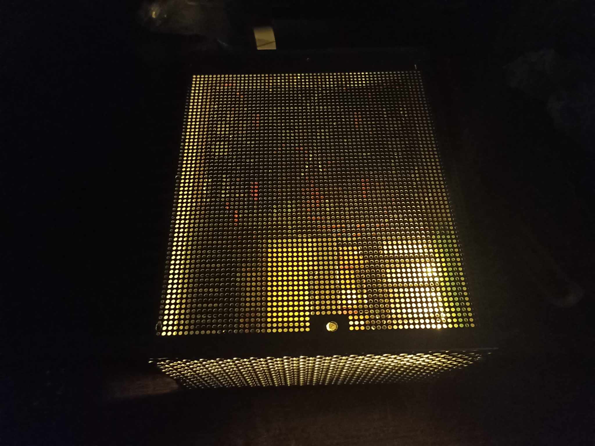

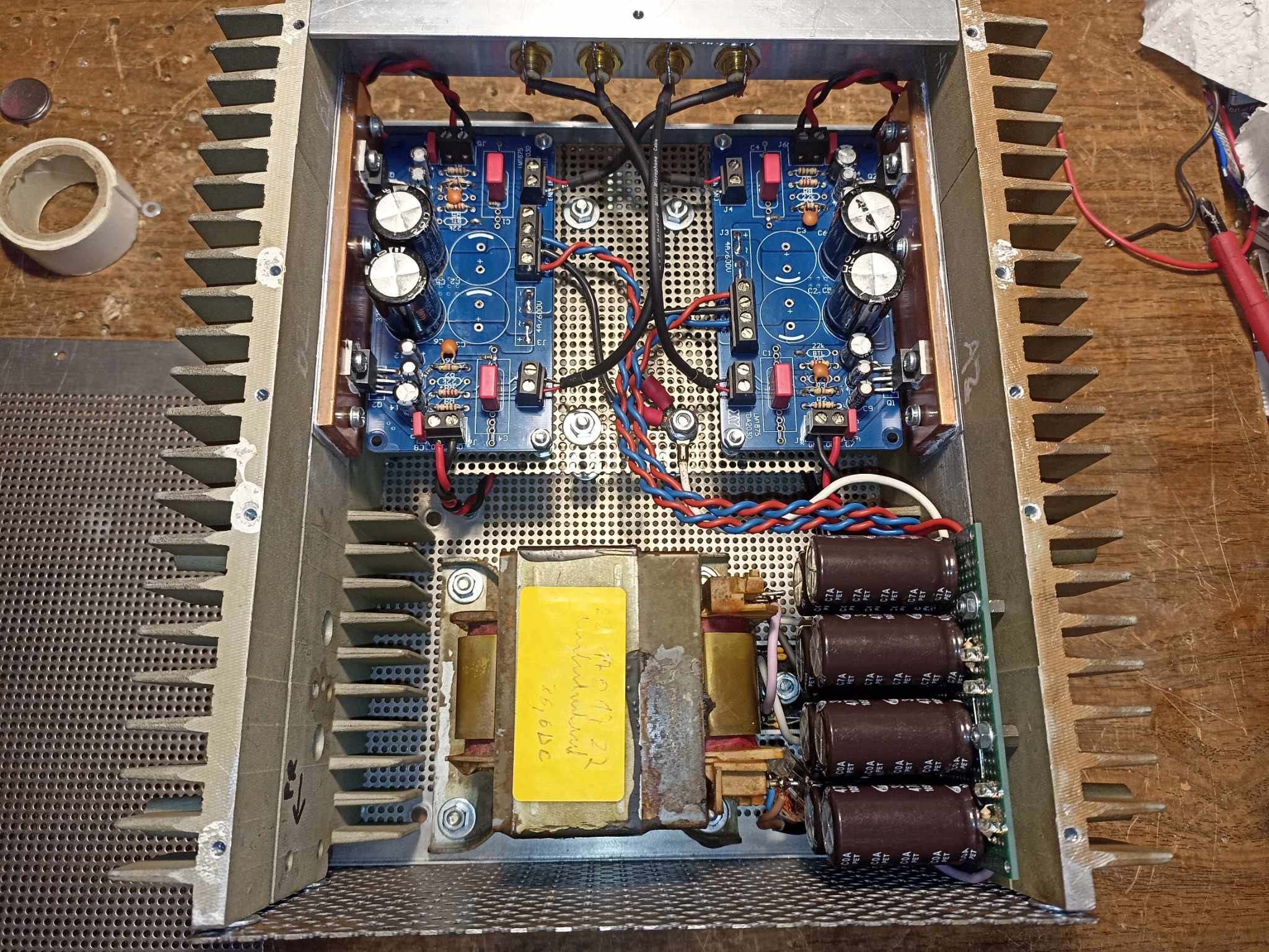

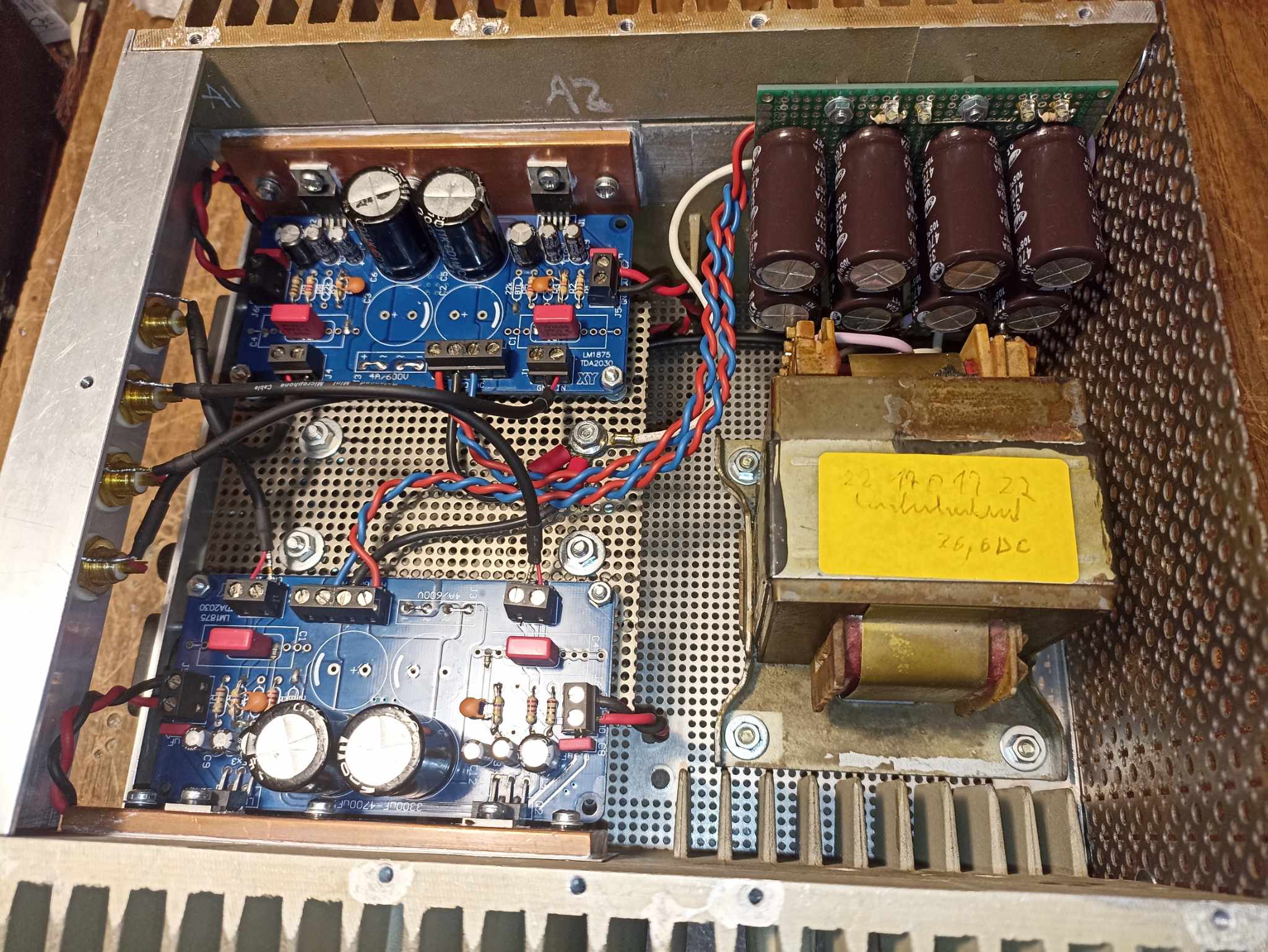

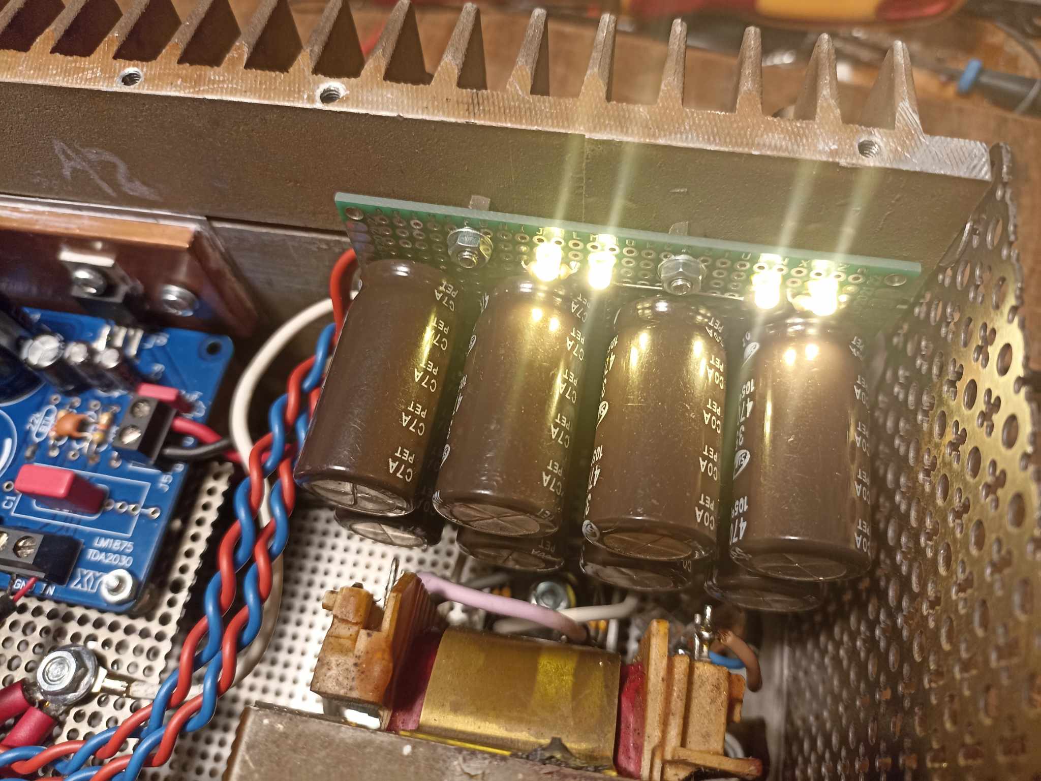

4x LM1875 amplifier, modified XY boards (quite a lot of mods, should have made my own at this point :unsure:).
Enclosure made from very old heatsinks, and random metals. Transformer is also reused from some old plastic age music centre.
Power supply about 27 Volts per rail without load. There is no power switch or volume control. It is intended to use with other amps in multiway system, with one switch for all of them, and volume control in filter stages, or at player.
