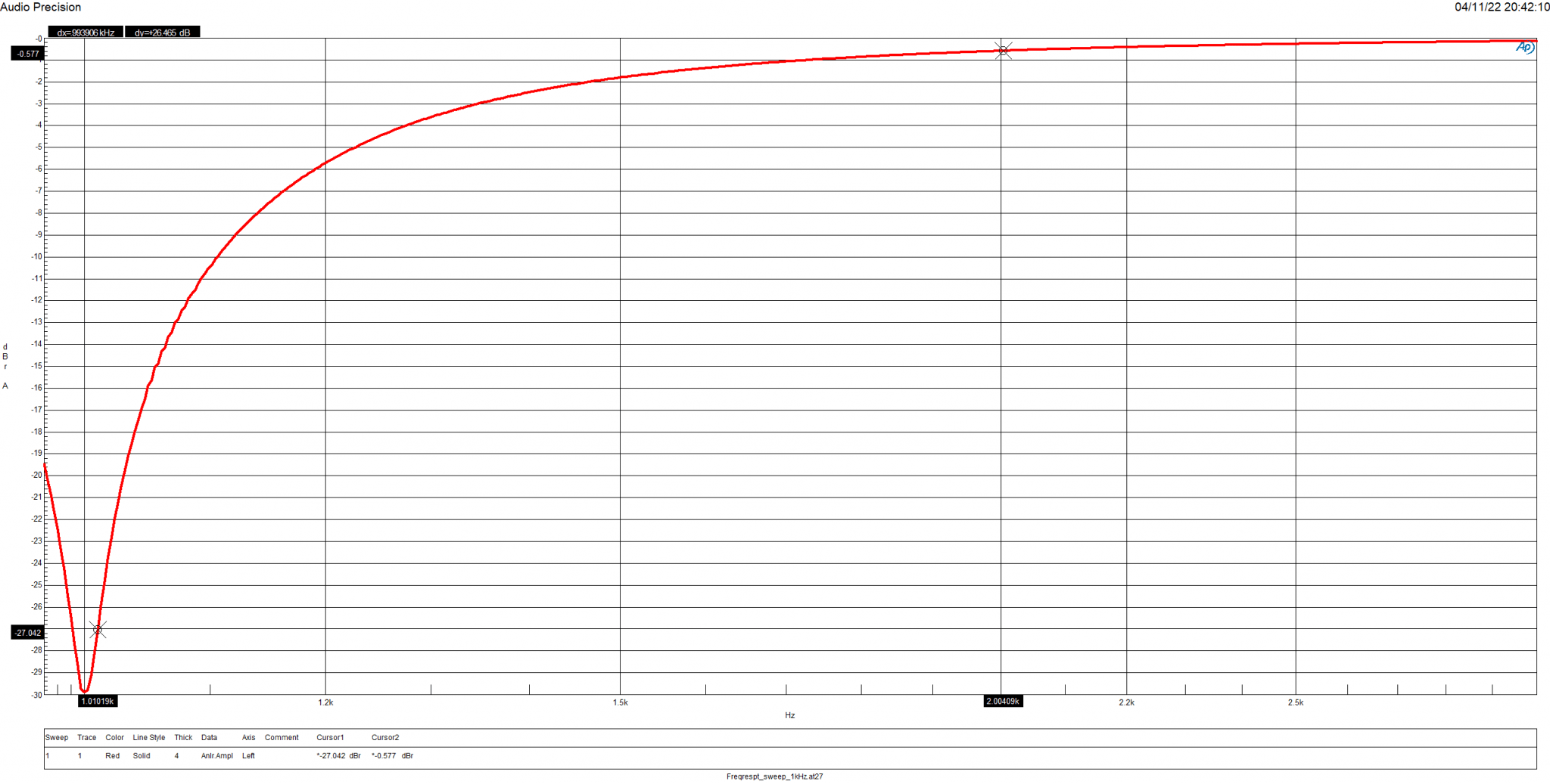

The second and biggest half of Cosmos APU is the 1/10kHz active notch filter with -30db ratio(Q about 50) at the fundamental frequency and nearly 0db at 2nd and 3rd harmonics i.e. you can simply divide by 30(or subtract 30db) the THD/THD+N result to get a normal value. Also, with REW or Arta, you can use a calibration file to normalize the notch's frequency response and observe FFT results directly. The max balanced input level is 10Vrms, it is also clamped but by the active clamp with opamp's rail voltage-1V, hence, 10ohm 0603 again may be burned like a fuse. The residual harmonics of the distortions are <-150db@1kHz or <-130db@10kHz, that's probably isn't too spectacular but still better than APx555. The residual THD+N, practically achieved one, -132db@1kHz@10Vrms(DAC+LPF approach), calculations based one is -134db but I can't confirm that so far because of can't find a perfect-zero-noise sine for that ;) It is clear that APU is kinda a microscope for your ADC, even any laptop audio input with APU gets the ability to measure a tiny noise of DACs or LDOs, and distortion levels are perhaps lower than AP SYS2722 or even Cosmos ADC.

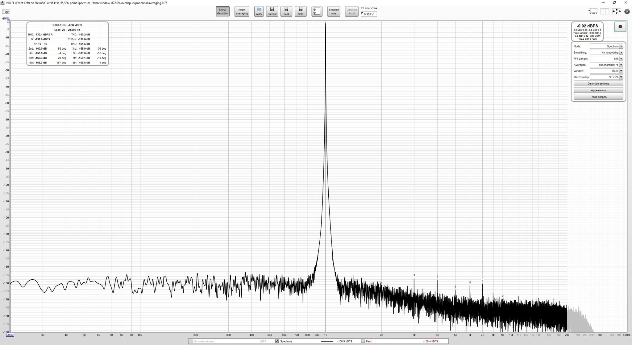

REW with the calibration file DAC+LPF->CosmosAPU->CosmosADC

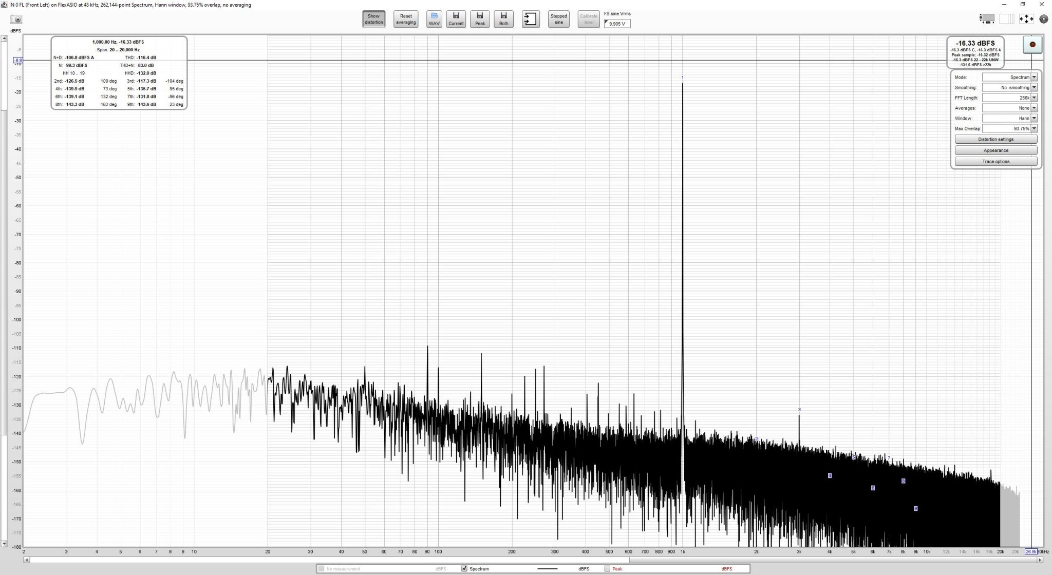

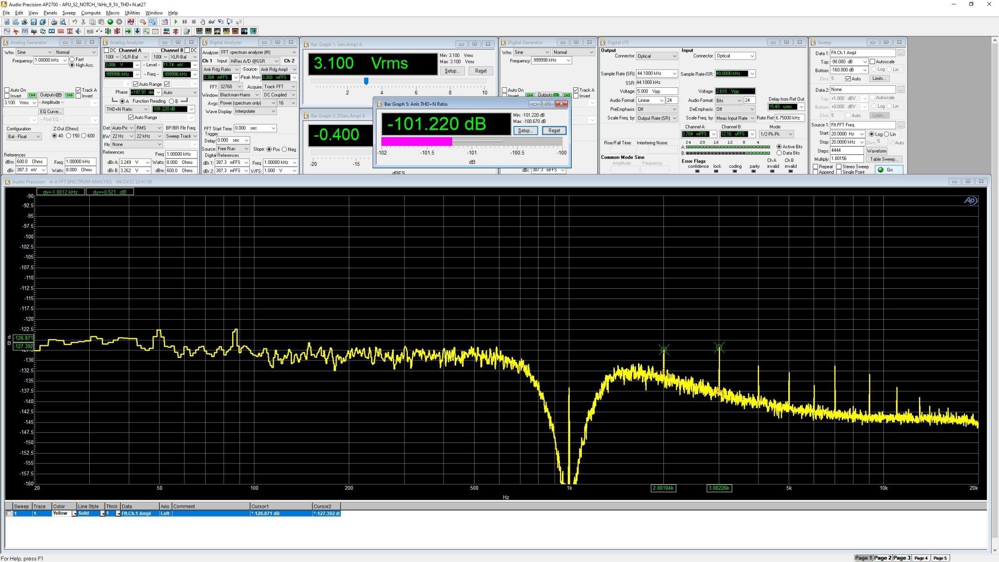

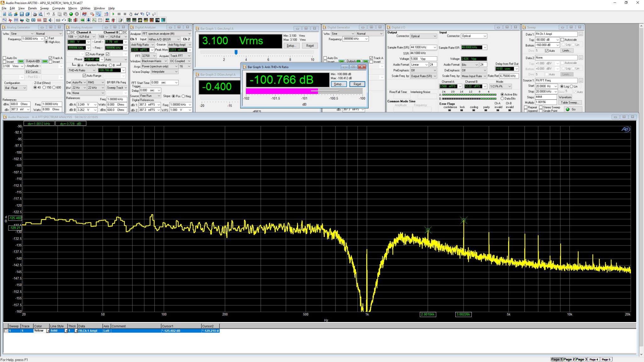

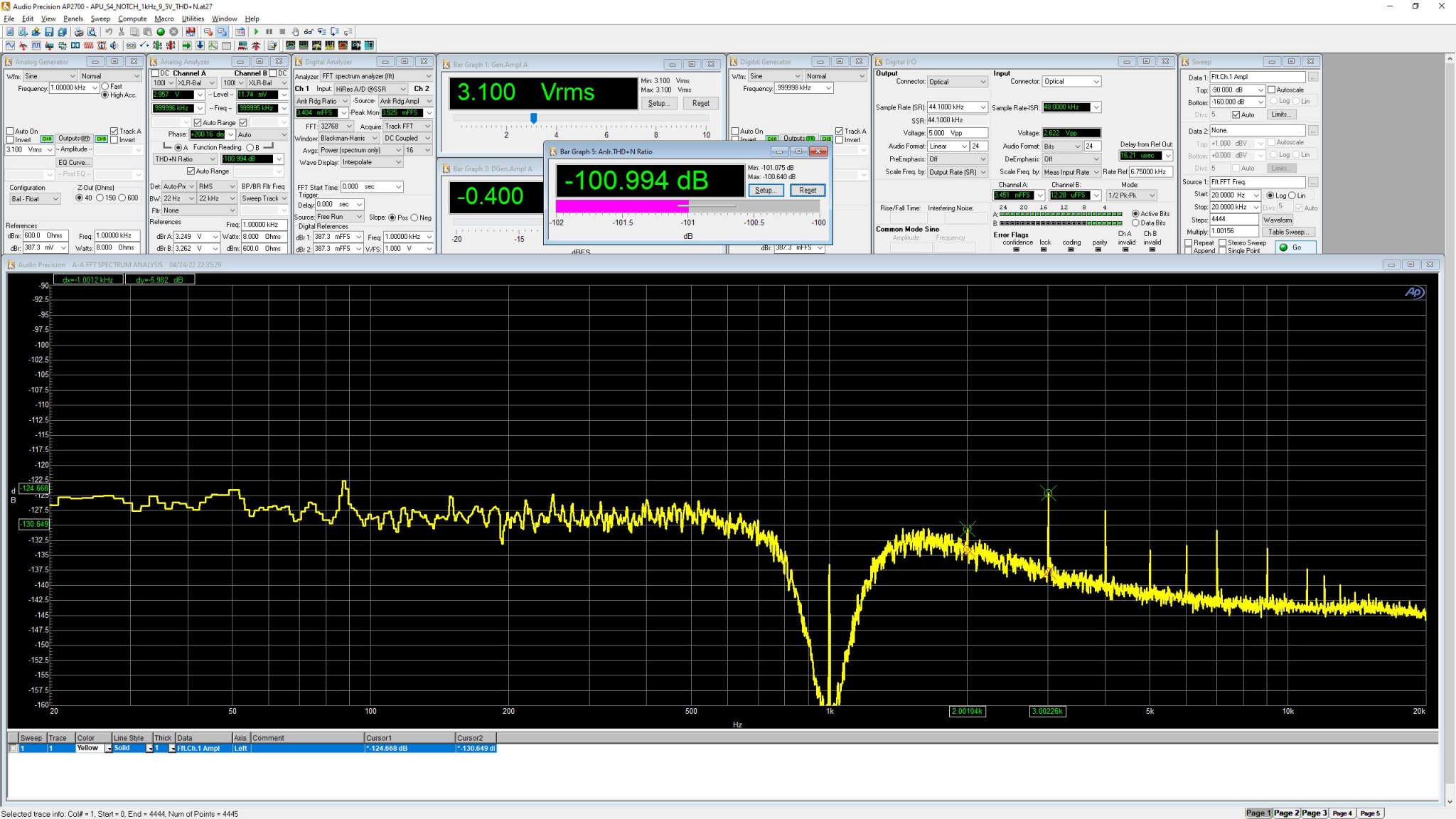

The residual THD+N of 5 preproduction samples, -101db of reading need to subtract 30db i.e. THD+N -131db@9.5Vrms the same about harmonics -127db means -157db
APU Notch frequency responses:

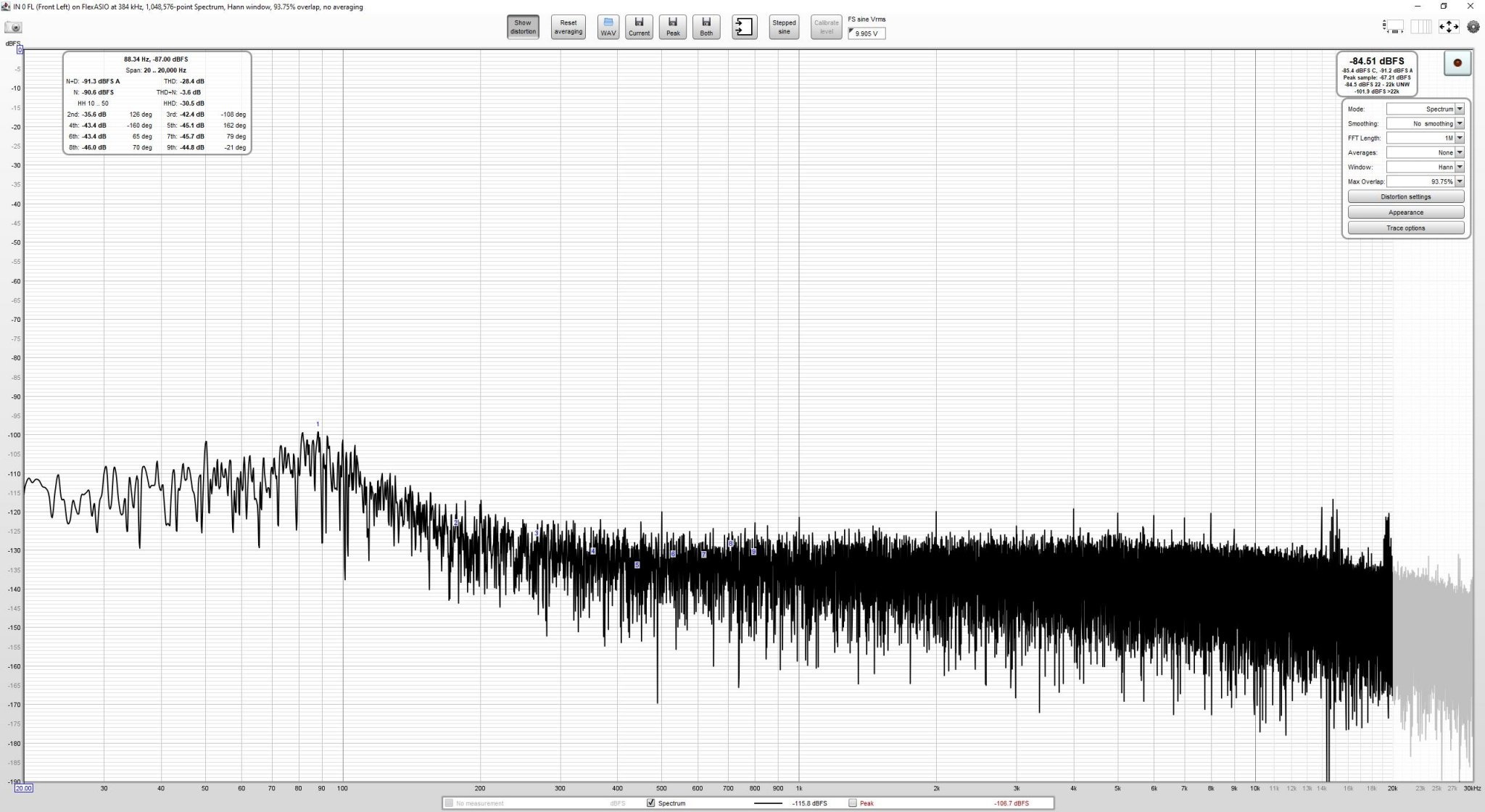

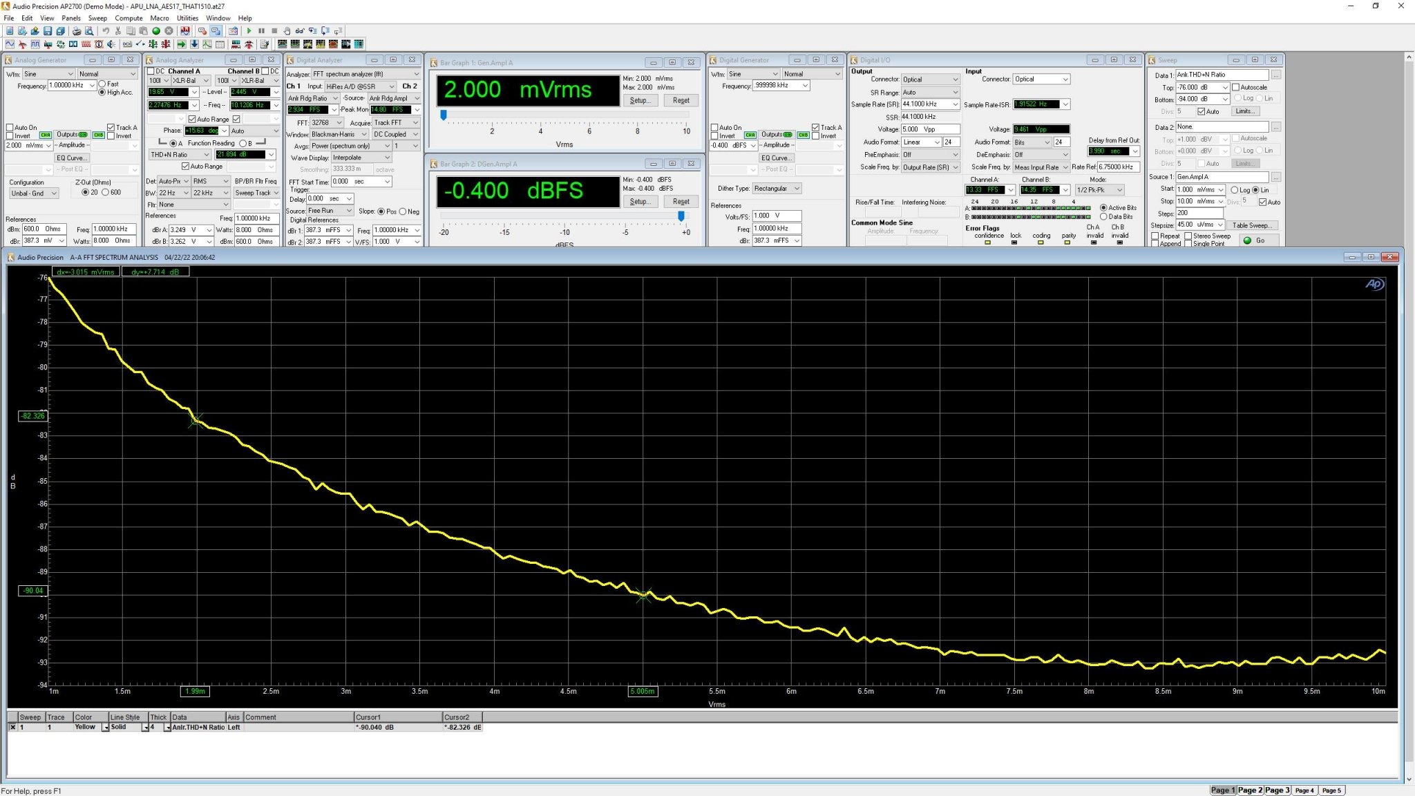

AES17 Dynamic Range test performs at -60dbfs level by measuring the THD+N A-weighted. That plot shows the residual THD+N (A) of the LNA at 1-10mV level sweep. 2mV corresponds 2V 0dbfs DAC like CS43131, and -82db needs to subtract 60db to get AES17 DR = 142db. A typical high-performance DAC with 5Vrms 0dbfs could be measured down to 150db and so on.
The residual noise of 5 preproduction samples(the S2 using SSM2019 instead of THAT1510), the reading need to divide by 1000 due to 60db of LNA i.e. a uV is actually nV.
The gain of Cosmos APU preamp is +60db(1000x times), hence the scale units are nVrms(A). After the APU unit turns On, you can see 5s of settling,

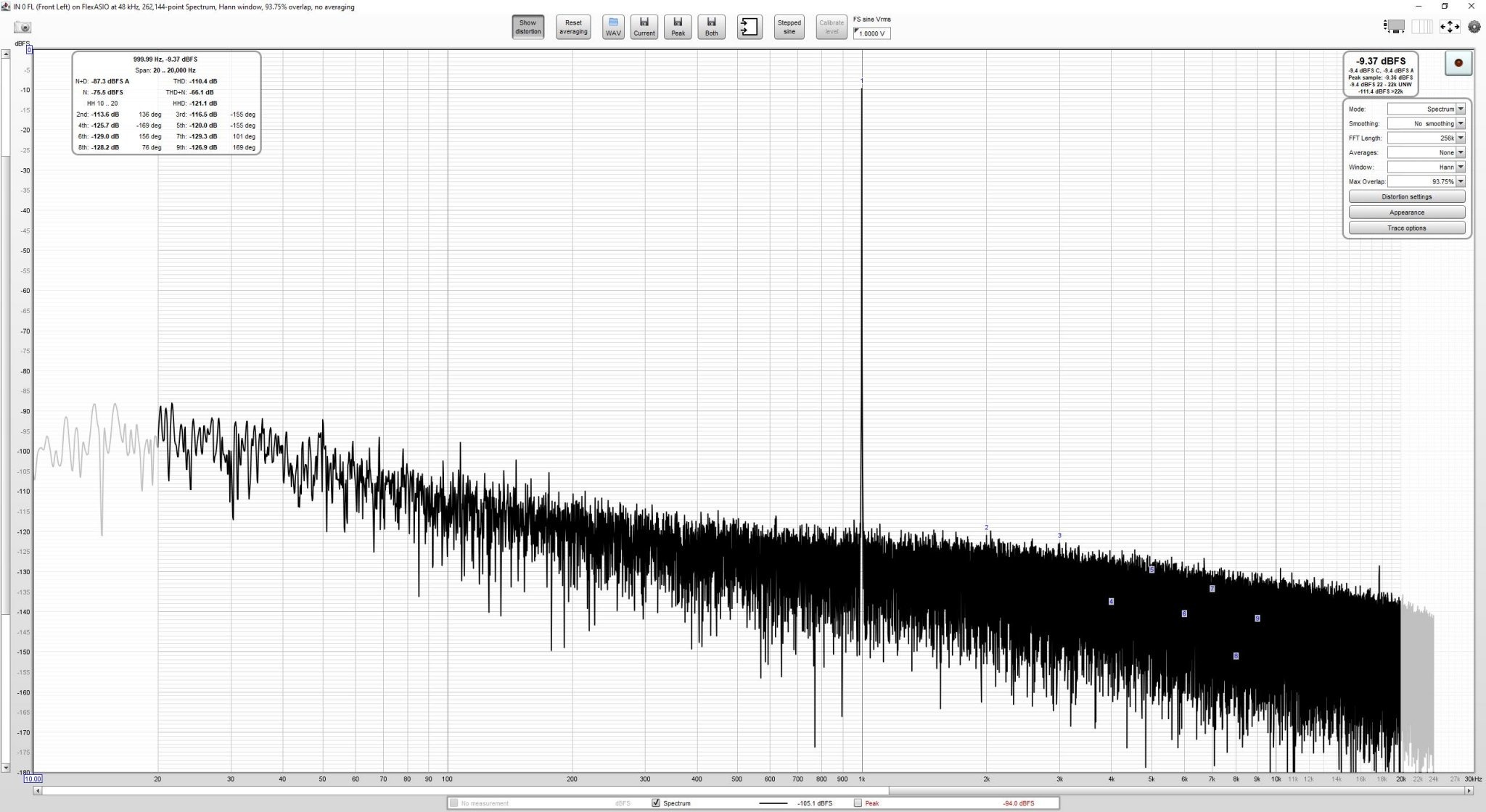

from 6s the input noise reaches 130nV, about 9s 48V power was turned On, and after 1s reached 142nS. Hence, APU's phantom power adds just 12nV to the preamp noise, that's a nearly ideal result as I think ;) The test was performed with a shorted preamp's inputs(In+ to In-) and biased to the GND by 2x6.8kOhm resistor as a dummy condenser mic.
and the spectrum 20Hz-130kHz of the same test, units need to divide by 1000 as well, so uV becomes nV. This is a good illustration to killing the myth that SMPS is always dirty ;) Cosmos APU contains no linear voltage regulators at all, only SMPS with Fswitching > 1MHz.

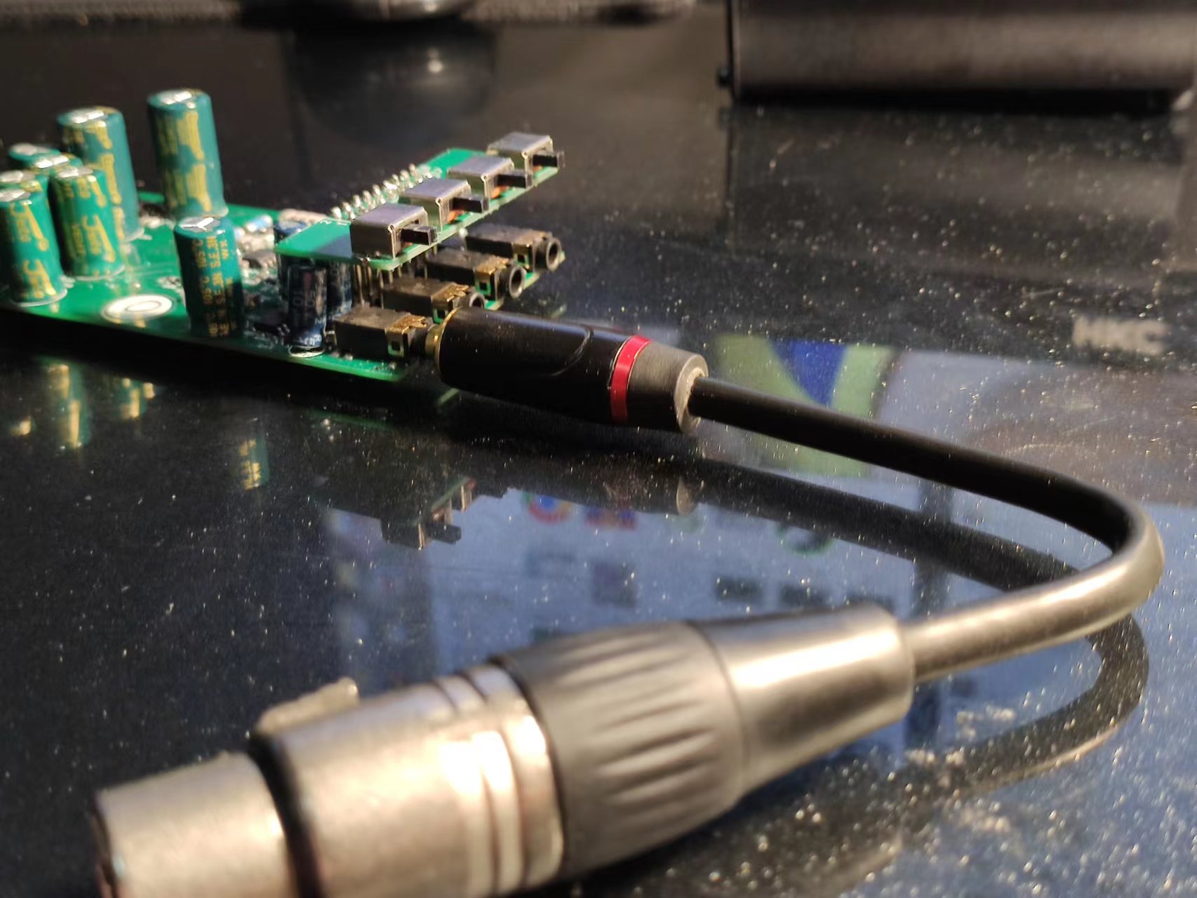

FWIW I would order the version in the case. The illustration looks well executed. I believe you are using minijacks (3.5mm) and I understand that the small form factor really leaves few choices. Getting well made shielded 3.5mm cables is not easy but you are better located to solve that issue as well. I would pay a premium for a collection of 3.5mm to various audio connection cables.

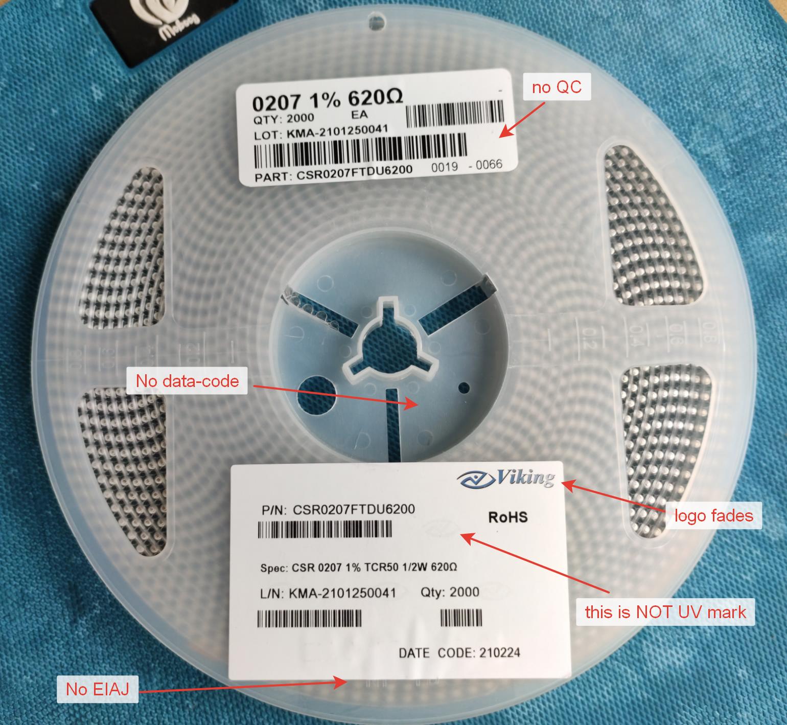

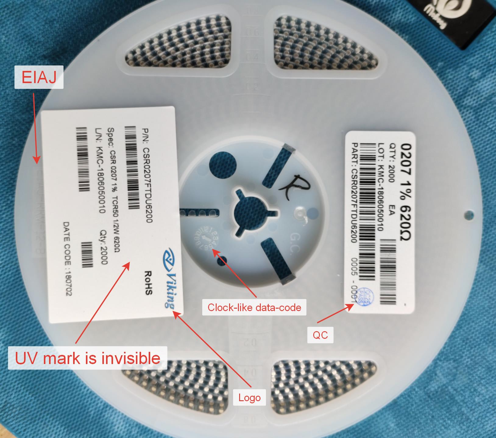

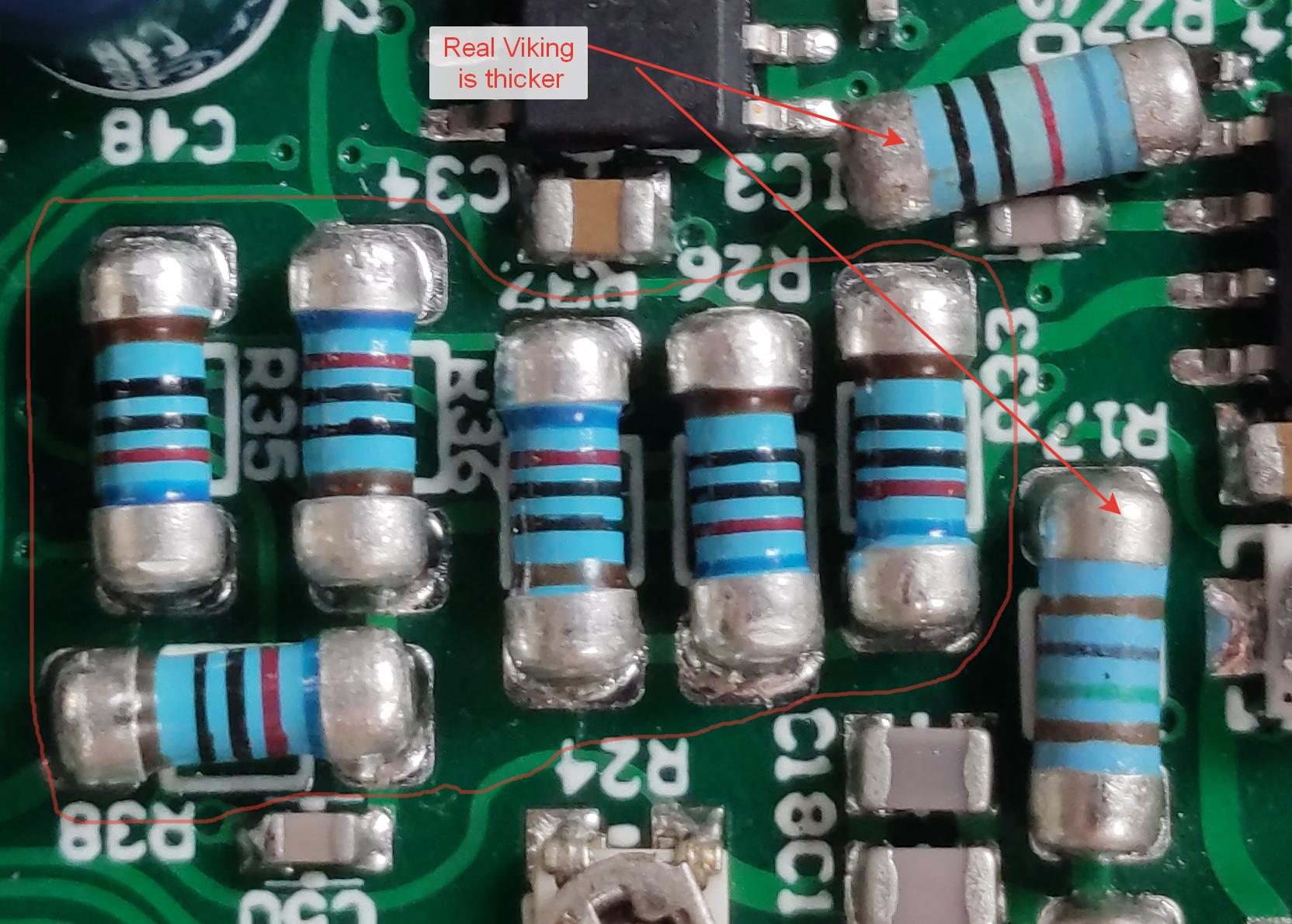

hah, it seems I bought 6000pcs fake Viking 0207 MELF resistors, but fortunately, I have 2000pcs original from the distributor )) Look isn't exactly the same as the original, the reel is also not exactly the same, no QC stamp, UV marks are different. Even 1% 620ohm Viking has resistance difference within 1ohm, at least neighbors in the reel's cells, fake has 3x time worse. Well, I hope I'll find some good MELF to replace Viking then because they have a lead time up to the end of Jul(or Jun, I'm not sure).
Joined 2004
Interesting. Digikey has no stock on Viking. For 1% they do have options but you will need to qualify them if they are of interest. Mouser also has some in stock. Vishay seems to be the most popular. Mouser lists tolerances to .01% but that may be wishful thinking in practice.
Let us know if we can help from this side of the "pond".
Well, I did test the alternative MELF 0207 from Chinese supplier NYS .25%. I tested that in the differential stage only, the most critical notch filter resistors are Viking. The H3 is about -155db i.e. about the same as Viking. We sent 6000pcs NYS 0207 to the SMD production, they promise to finish that in 2 days(Monday).
