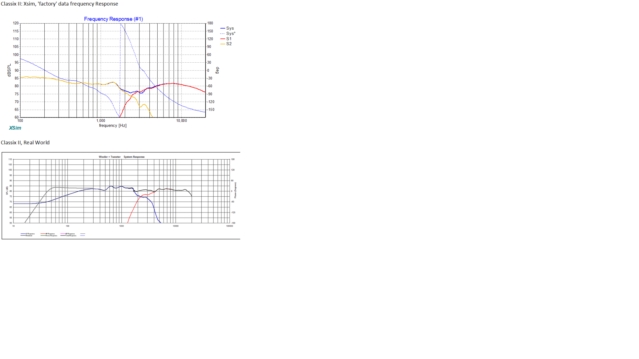

I am posting the XO network I designed and a couple of the graphs.
I would really appreciate your feedback and suggestions on how to improve or to learn what errors I made.
I did try this with 3 different tweeters and 5 different drivers. This particular combo gave me the best graph with the simplest XO and lowest part count - thus the cheapest option. Other combinations produced better looking graphs, but the XO network and part count put the project into the $350 to $800 range! I am budgeting about $300 for components (including drivers).

It is a beginning, build listen or test, and tune until you are happy.
Within your constraints on costs it should work. The level between 1.5KHz to 4KHz looks like a little more work could be beneficial. Maybe a bit more inductance on the woofer, but see my comment below.
The woofer impedance rises quite quickly so some would add a zobel, and re jig the L and C which may make for a better match to a 2nd order response slope if it needs it.
The tweeter response looks good, but are you in fact stressing the tweeter as the LF roll off doesn't seem to kick in until 2k or thereabouts?
As the response of the raw woofer looks ok, and it has a phase plug maybe you could re model it with the crossover aligned around a crossover frequency of 2.5 - 3.0Khz. Maybe that would save some pennies on a smaller capacitor and inductor in the tweeter circuit.
Measurements always help and speed up the final tuning, but you can make something that sounds good to your ears with a little time and effort.

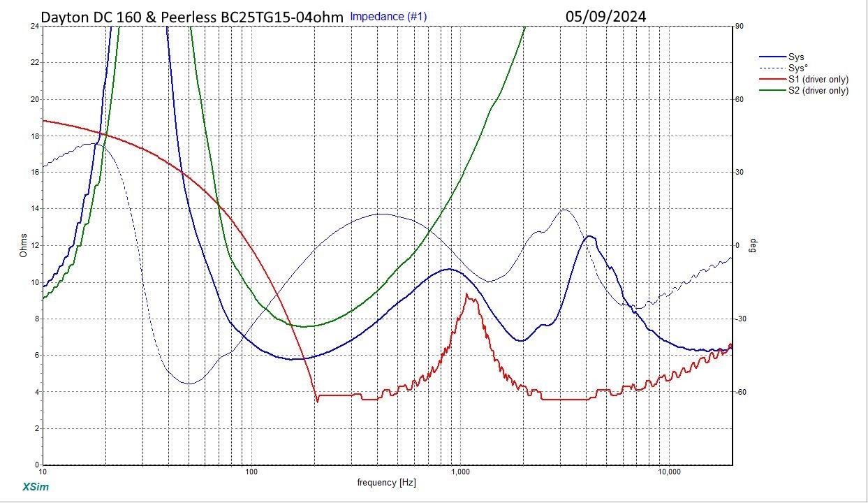

The impedance of a speaker which is '8 ohm nominal' will vary quite a bit and sometimes an '8 ohm' speaker - particularly a commercial one - will be anything but. I've been using' 6 ohm' speakers for years with our old Yamaha receiver, no problems at all. All of the designs I mentioned are 8 ohm nominal and that's an honest, correct description.I have not purchased any drivers or components. This is just a "on paper" experiment. I just recently learned that I can use a 4 ohm tweeter with a 8 ohm driver. So now I will try some other combinations once I understand what I have created so far.

Then you can cut the tweeter instead. You are not wanting a flat response, see here - https://www.diyaudio.com/community/...overs-without-measurement.189847/post-2587232I have another work up with a driver/tweeter pair that are closer in sensitivity but the complexity of the crossover puts the costs into the US$500 range.
Thank Geoff, that's what I was thinking. I was not sure about the bypass cap on the woofer, I can take that one off to save some $ and complexity. I think I might have been watching too much GR Research...Just looking at your XO diagram, I'm assuming the very small caps on the 7.5 tweeter cap and 10.5 woofer cap are expensive 'by pass caps' to improve the sound? If so, I wouldn't bother with the one on the woofer, I don't think you would get much benefit.

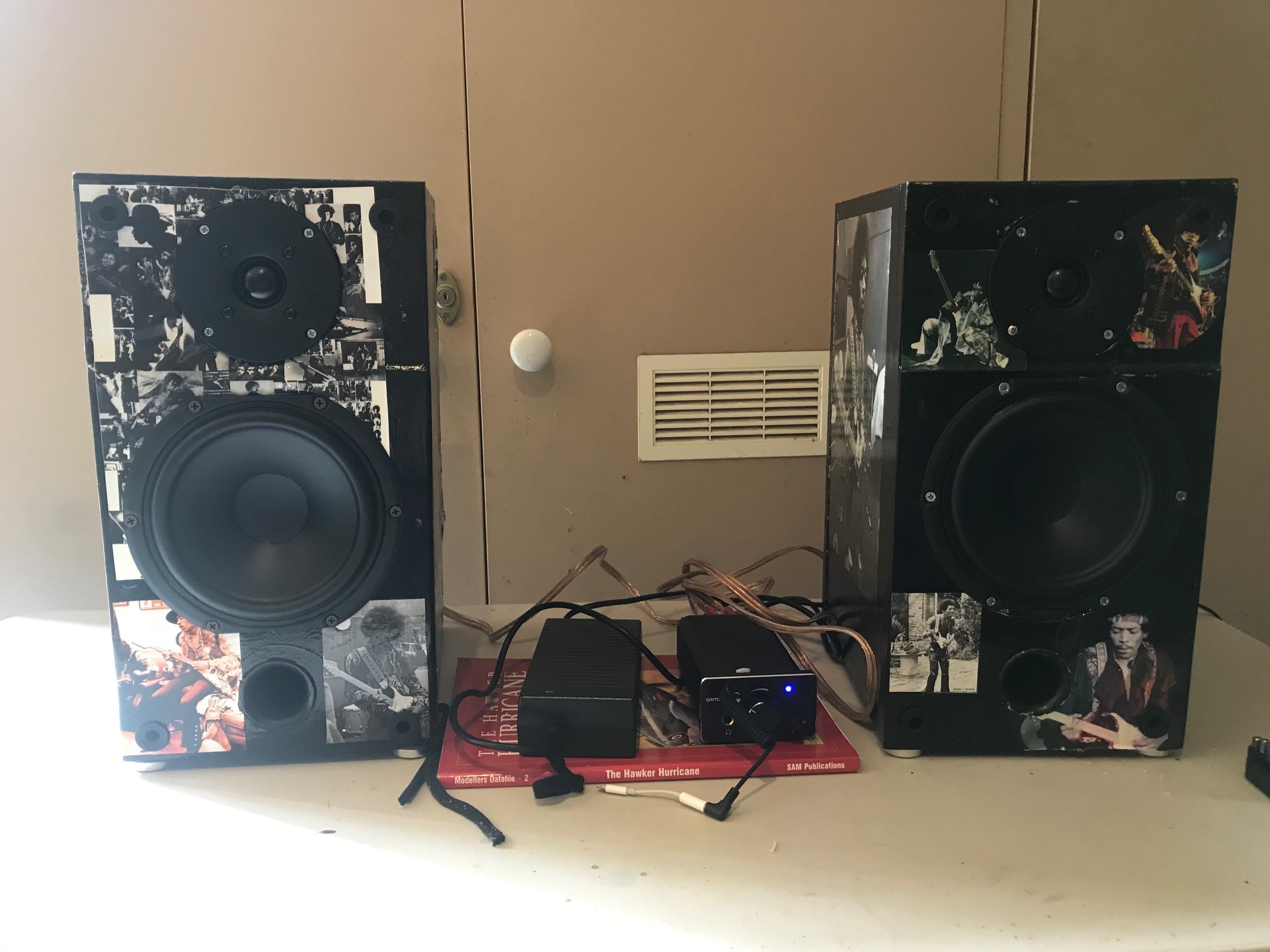

You should put the port in the location suggested by the designer, but sound-wise I don't think it matters unless your speakers are going very close to a wall, in which case the port should be at the front.
In smaller bookshelf speakers (see att.), there may not be space on the baffle, so rear ported in that case. The cabinets are home made, but the speakers sound good. They both use the Vifa BC25TG-04 tweeter.

Yes, the application for these speakers, if they work out, will be closer to the wall. The geometry of our tv room does not leave a lot of room to pull out the speakers more than a few inches. Small space with an odd shape.unless your speakers are going very close to a wall,
BTW: I like the Jimi speakers, I like your case art.

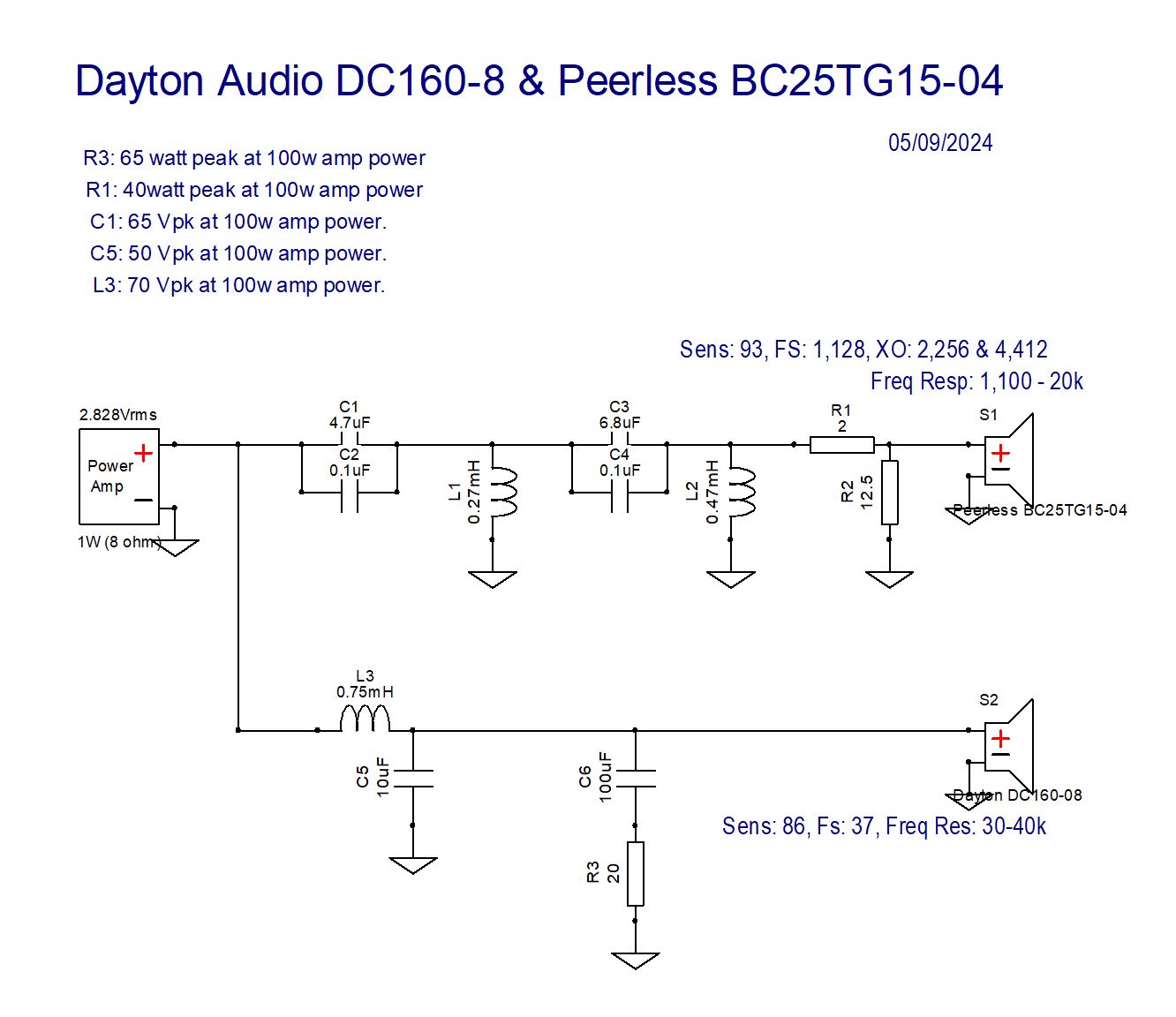

Thanks to suggestions by the community and especially from GeoffMillar, I am going for a version of the Classix II using the Dayton DC160-08 (8 ohm) woofer and the Peerless (Tymphany) BC25TG15-04 (4 ohm). I was able to adapt the crossover suggested in the Parts Express kit to work with my project.
I’m calling them “The Dappers,” (a play on Dayton and Peerless). I am going with what I’m considering the “budget” option with crossover components: Jantzen, Solen, Audyn, and some Dayton polypropylene capacitors and Jantzen 15 & 18 gauge inductors. Not sure about the resistors yet.
I need some suggestions on resistors. I don’t know if I need 10, 12, or 20 watt resistors. From the research I have been doing, it seems the “sand cast” resistors are frowned upon for sonic reasons.
I have been considering Dayton Audio Precision 20 watt, 1% Audio Grade Resistors but am open to suggestions.

I'm curious as to why you want to change the crossover if you're using the same drivers - the PE kit uses Paul's crossover as designed and any changes might adversely affect the sound. Depends what you're looking to achieve, but I wouldn't change it.
I wouldn't rely on the sim too much and attach a graph comparison to show why. It shows the Classix II response as measured i.e. real world, v Xsim using the same parts values: the top one is the sim, so you can see the differences.
I've always used 10w resistors, no problem. I've either used Metal Oxide or Superes resistors (about A $2 each) but I've sometimes used the Dayton Audio Grade which seem fine but might be 'sand cast junk'. Much as I enjoy GR Research videos, I take some opinions with a bucket of salt.
I use Dayton PMPC and Jantzen 'Cross Cap' capacitors and think they're fine. A 6 microfarad Cross Cap costs about A$10, but something like a 'superior Z Cap' is four times that and I don't see the value.

I was changing the crossovers to get my "simulation" to smooth out. But I see in the graphs that the theoretical modeling and the real world results are different and I understand that. So, I will pair down the crossover I designed to more closely match the original Classix II. (My cabinets will have slightly more volume, but by the time I get some bracing in, and the new baffle, it might be closer to the original Classix design).
As for resistors, I will change to 10watt. I did some reading last night and have a better idea what the resistors are doing (mainly that they are not "protecting" the drivers, but attenuating the levels).
It seems that many YouTube builders just use the "sand cast" (Parts Express) resistors, but I'm interested in using the next (mid) level components when affordable.
