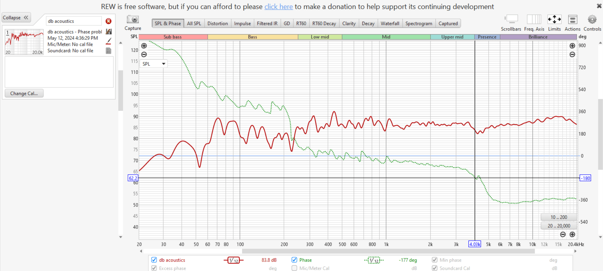

Not sure whether this helps, but this what I see when I open it in REW. Screen capture provides some setting information. I am a bit confused by what I am seeing.

I would recommend reversing tweeter phase and remeasuring, if you have got it right as is there should now be a big dip in the XO region, if not there are other phase contributors to consider and you might just want to measure the phase response of the tweeter by itself to understand what it is contributing. (No XO, just a protection capacitor in series to keep DC and LF out of the tweeter.)
As an additional thought measure the phase and amplitude response of the XO into resistive loads and check that it is what you expect. I used LR 12dB passive networks in an older iteration of my system and don't remember this as being typical.

The Twitter is already reversed when I measured since the 2nd order LR as I said before shift the phase for 180 degree, which require polarity switch on one driver.

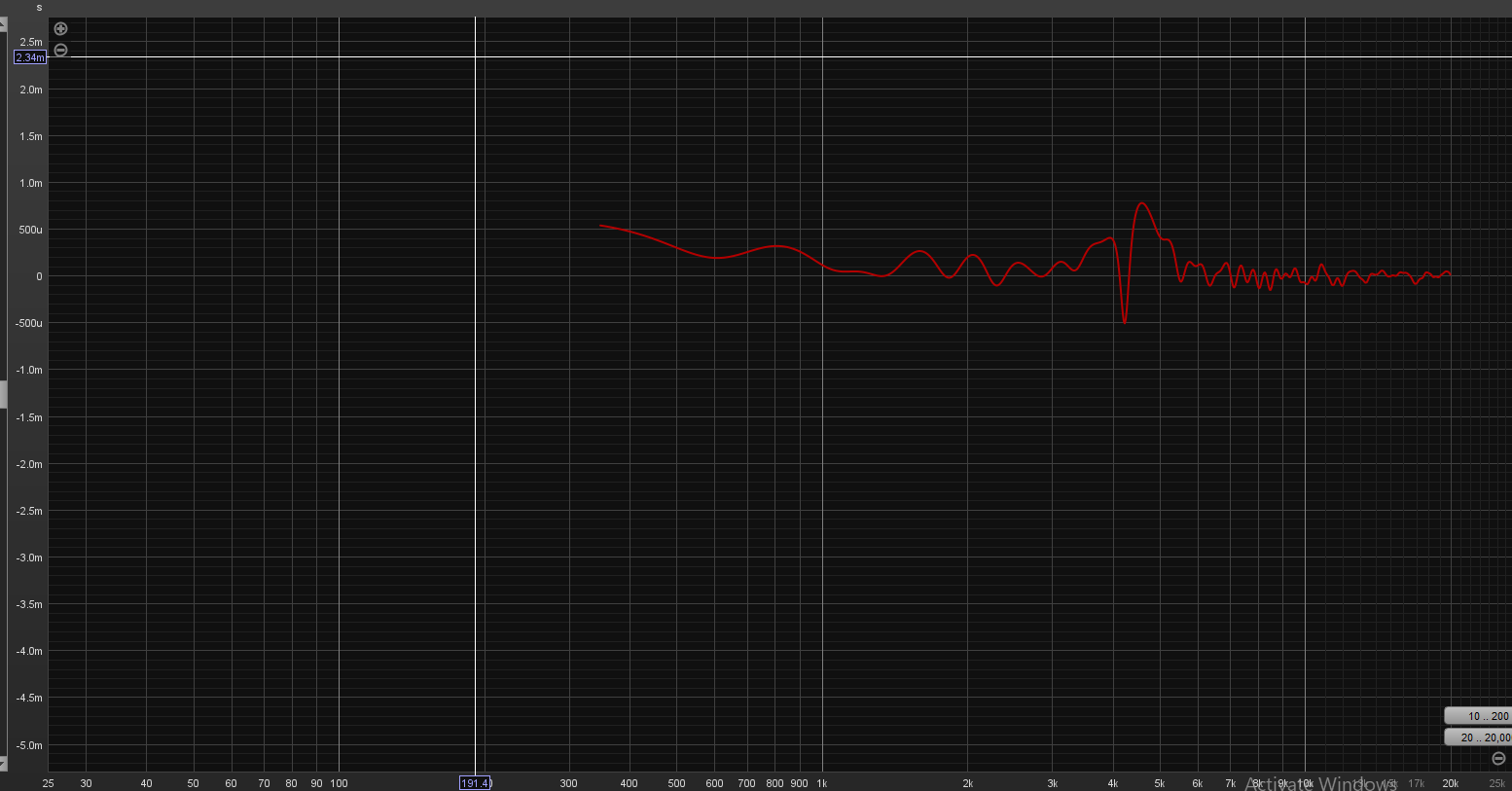

I see your window is ~100 msec, but looking at your impulse response you have significant reflections between 2.5 and 20 msec. If we window it down to 2.5 msec the dip at 4.25k Hz looks deeper. I'd disregard info < 1000 Hz due to reflections. Measuring with the tweeter inverted (relative to what you have already presented) may be useful, but I think your XO slopes look shallow (post 19) and we would see a wider null if polarity were the issue. Your XO looks looks like a normal 2nd order with some extra stuff I'm not sure what it's doing (attachment, post 1).
If you were able to do some ground plane measurements in an open space (and tilt the speaker to keep the mic on-axis) (both system level, and individual drivers only) for measurements with fewer reflections, I wonder if some of this unusual behavior we see would evaporate.

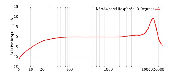

Hey, maybe you already know but in case you don't, the DBX RTA-M has a big HF peak on-axis, and is made to be used pointed at the ceiling, I guess.
See: https://www.reddit.com/r/livesound/comments/i5ao5o
So point the speaker at the mic, but point the mic 70-90 deg off from the speaker.
Response (on-axis) is something like this, according to the link...
I had one for a bit and after I heard about this I clamped it in place near a USB dayton mic with a cal file (made a fixture to hold them quite close) and the delta I saw was similar to the above, I saw the DBX as +9.5 dB @ 14.5 kHz.

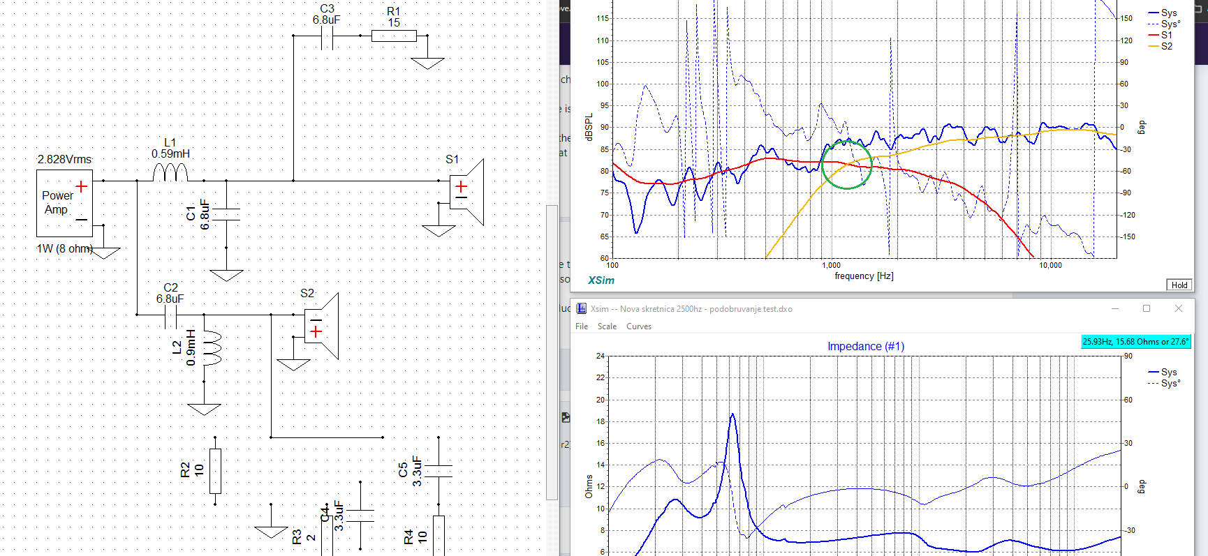

This is what XSim is telling me:

There seems to be a big overlap between the drivers before they roll off, not sure if this is intended.
Just as a hint, usually the impedance has a peak at the crossover frequency.
Also the caps c4 and c5 (and r2!) don't do anything but reduce the impedance at the top end. Does this have any purpose?

You should match the crossover frequency of both drivers. In your graph it seems the woofer has 4 kHz crossover frequency with some slight downward slope before.Should I make steeper slope there?
And the tweeter has about 1200 Hz crossover frequency, just as you state.
You should be able to create one common x-over frequency for both drivers.
You need an effective series element to attenuate signal by parallel elements. But you only have a cap tha thas near 0 ohm impedance at high frequencies.btw, the c4 and c5 (and r2) are there so I can hit the desired 2.5khz crossover + to attenuate the twitter since it's more sensitive and producing more SPL.
Yes!!A lot preferably.
With the last screenshot I was just demonstrating what those set of components do in my design since you asked. If you notice I've disconnected them to show that they're needed so I can have the XO at 2.5K.Does this have any purpose?
I second the recommendation to look at a lot of other crossover designs. The crossover components you have added should not be necessary and reflect a very low load impedance back to the amplifier at high frequencies. You can use a fixed (or adjustable) LPAD to pad down the tweeter output and that may also result in more consistent crossover behavior due to a relatively constant load impedance on the crossover over frequency and attenuation.
Ok, so It's better to have slightly higher impedance then to have lower impedance. Is that right? How that reflects to the freq. response, & is it possible to harm the amp in some way?very low load impedance back to the amplifier at high frequencies
no, that's not generally true.Ok, so It's better to have slightly higher impedance then to have lower impedance.
but it's bad to uselessly burn amplifier power (which your crossover does).
it may be beneficial to keep the impedance constant, in case of high output impedance amplifiers (generally tube amps).
However that isn't the case and that's not the reason it was asked.It's logically that the impedance should be constant
Could I ask how it is that your individual responses are smoothed and your combined one is not?
