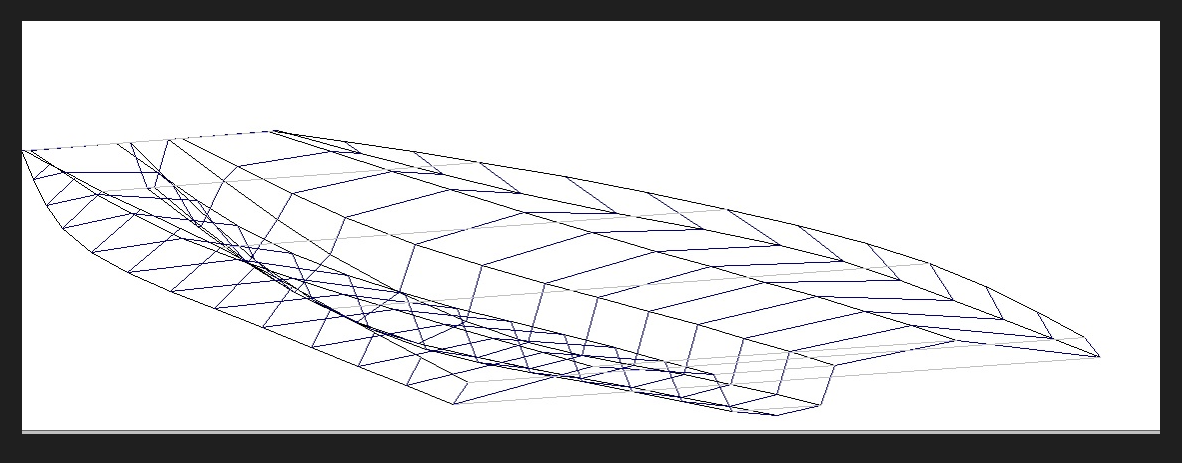

Here is a hull that will be built in hexcel. This is a WIG bay runner concept. This one is being designed to run about 2' over the chop and the aim is to make zero contact with water

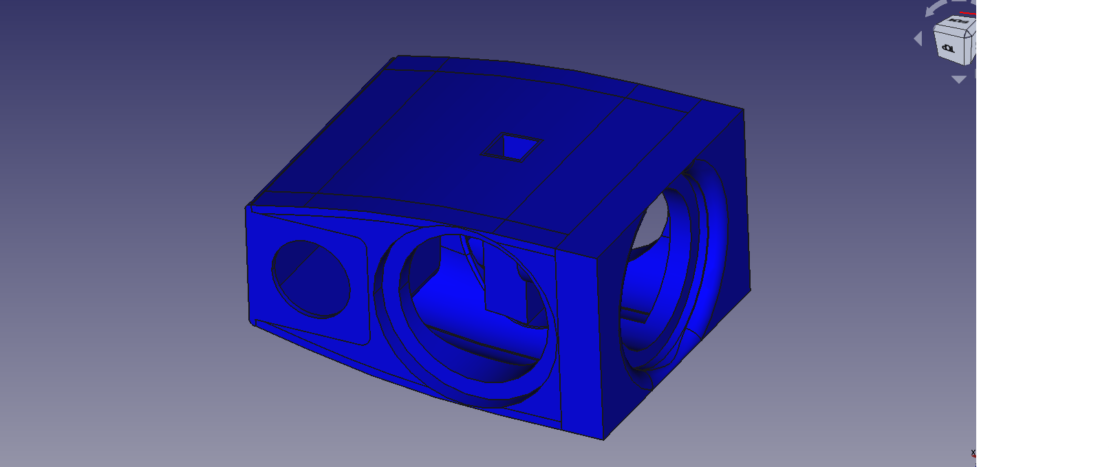

Hmmm, at a point of indecision. It looks like the CH2 in the FFA001 H/B modules is limiting the design of the complete system including the stereo speakers, with its PSU restricting things to 8R. Instead of two H/B boards, this would be a better place for a regular FFA001 to run the stereo and FFA002 to run the DVC on the subs. In this config, either of the two modules would be happy to provide equal power in 4 or 8R on any channel
The H/B modules would better suit active speakers with a 4 or 8R lows and 8R highs

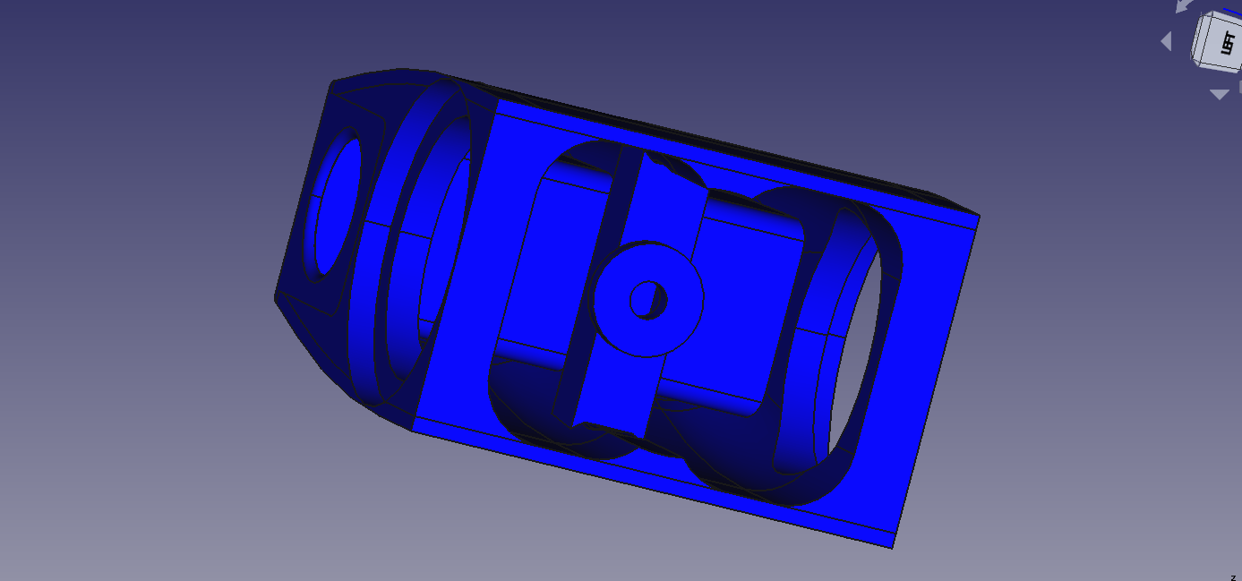

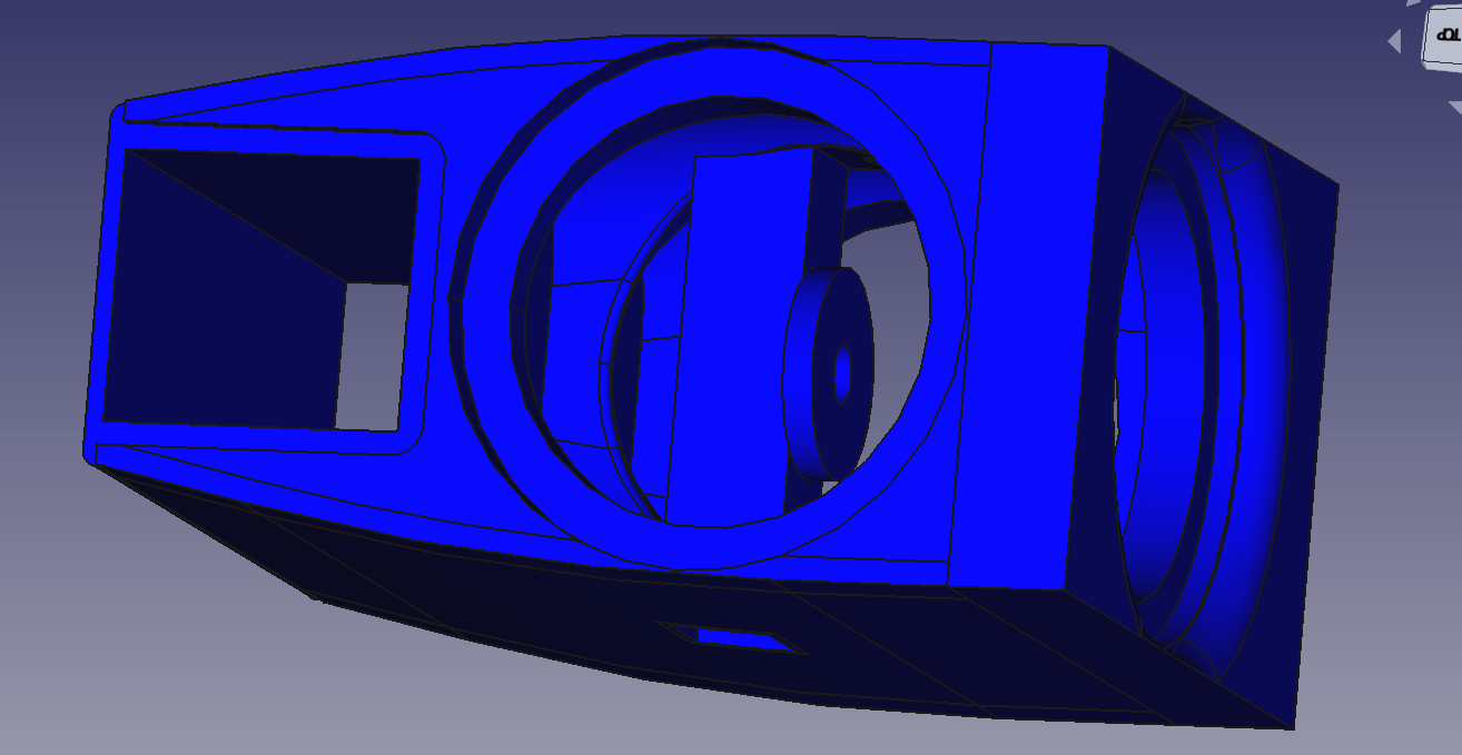

Pulled out the amps from storage and all the different modules will fit inside the already drawn box beam so no more modifications needed

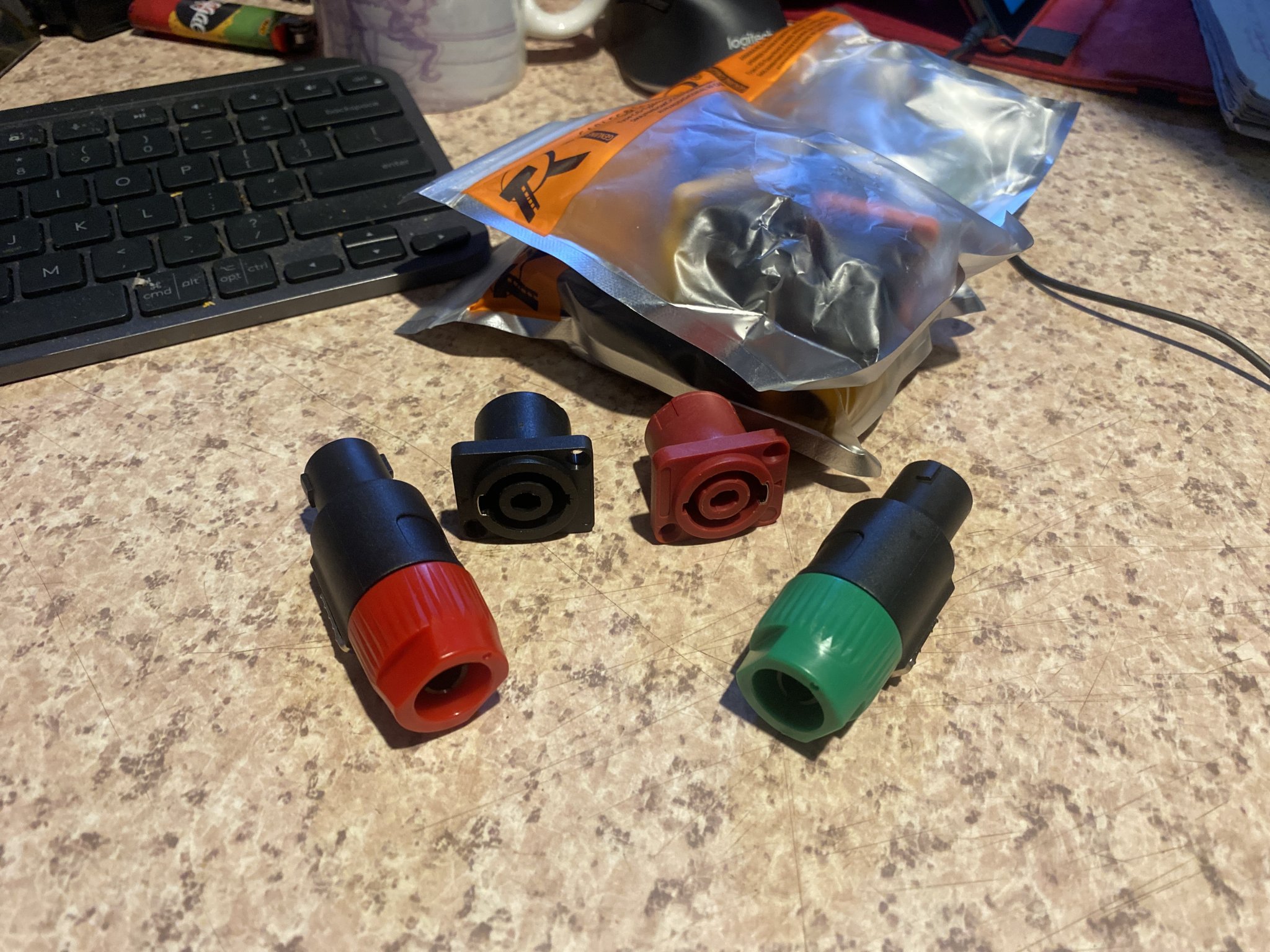

What will be the best connectors for sending speaker outs to the stereo pair from this cab. Speakons look massive and not interested in protruding type posts.
Does anyone know of a smaller heavy-duty system then Speakons?

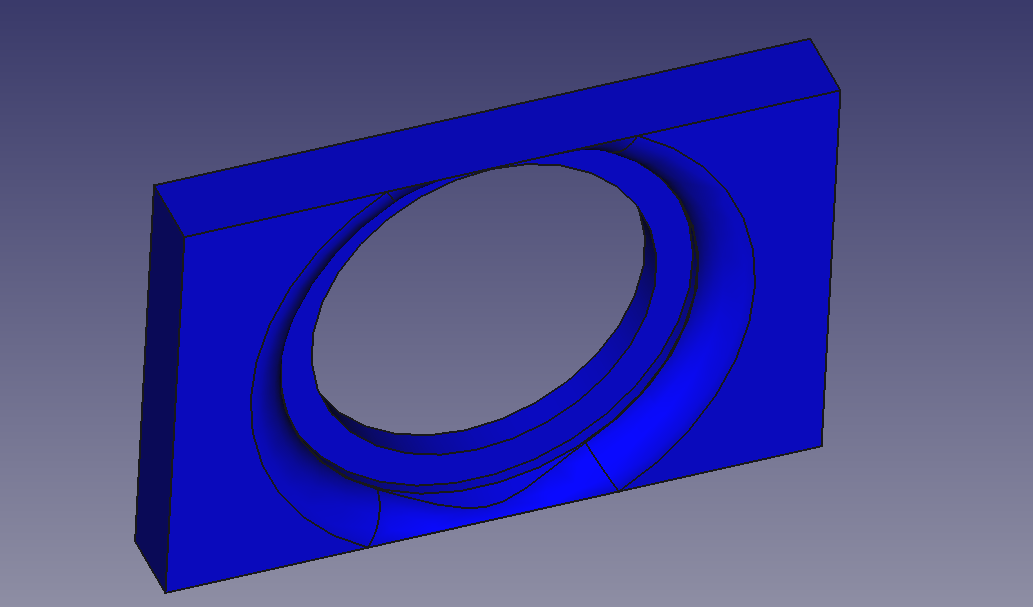

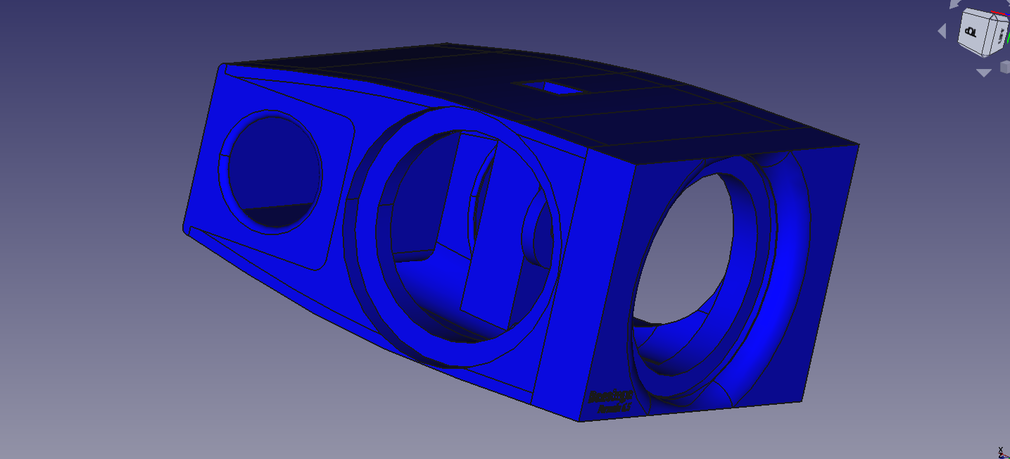

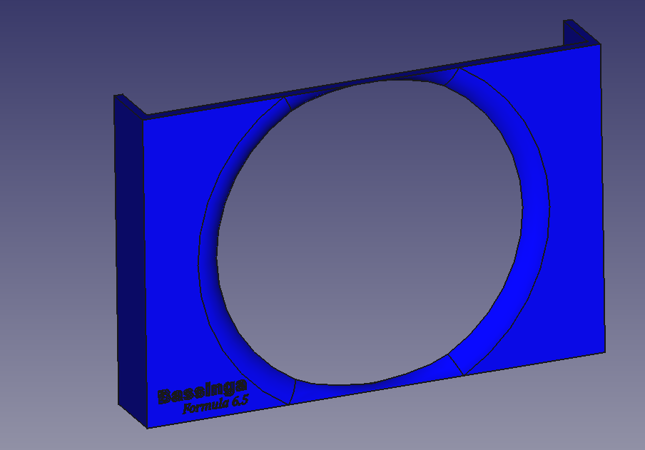

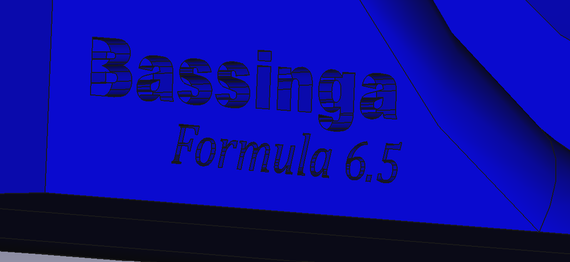

Ok, so all the design work of building up this virtual cab is complete. I managed to design in the badges today. It takes a couple of hours to learn how to do this the first time in FreeCAD
The text forms a 4mm pit into the surface designed to take a resin goop coloured with gold tint pigment. The baffle face trim is carbon fibre with structural cubic cell core
Next step is to pull off each part and either CNC or print followed by assembly which involves epoxying all the bits together and structural skins

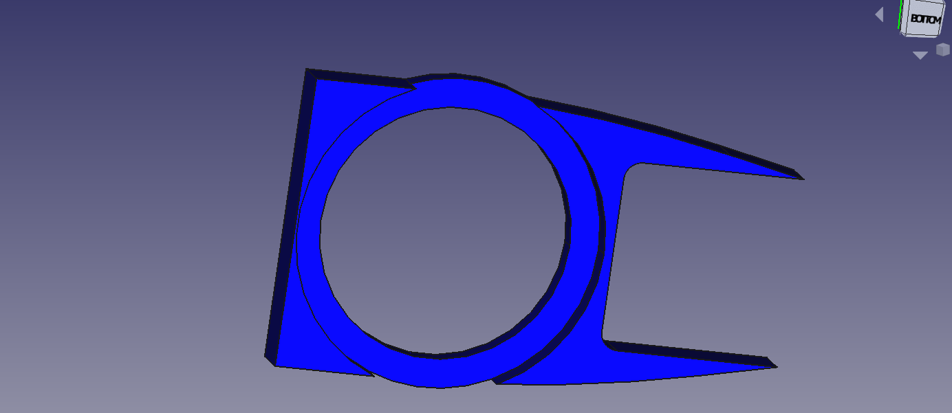

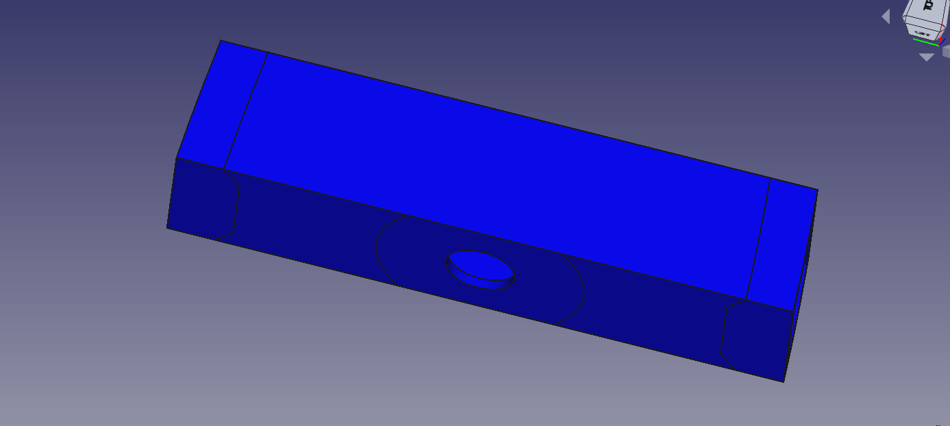

Starting at the main baffle, the first part to come off is the face trim. This can be 3D printed, CNC'ed or handcrafted. The file is currently available as a .stl and can be exported to other formats too
The specified colour is a carbon blackish grey, whatever is available in that shade. Can be made out of any preferred material, but a print will be easiest. Printed part is to be wet sanded with 400 wet/dry style paper and water can be used. Can be finished in clear poly with UV resistance
Alloy can be anodised, powder coated or painted
Wood should be done with my recommended water break free system and finished with UV resistant clear poly
Covering with a fabric finish will not need the prep work except for a lil bit of wet sanding with 240 paper
This part is fitted to the cab with epoxy

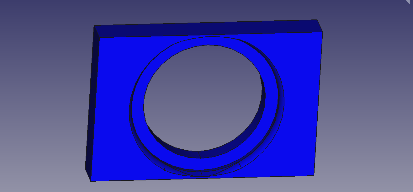

This is an alternative to using the baffle face trim. This is the full main baffle and should be CNC'ed out of bamboo board. This can be stained and a UV resistant clear poly should be used. Fabric or paint are alternative finishes. This is available in .step format. The badge can be lasered in from a separate file
Following is the side baffle, this part is repeated on the other side, so two pieces required. This is made of bamboo board and CNC is best, can be handcrafted. This one is 28mm thick. This can be finished with already mentioned systems for the main baffle face. The side baffle is exported to .step

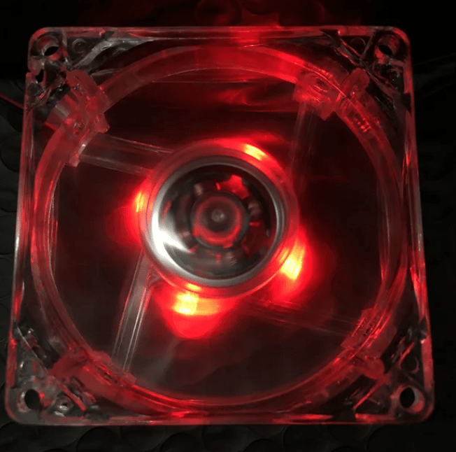

Next up will run off the box beam covers for the electronics section. I'll leave them undrilled for now, as those red jet fans do no specify hole sizes and such. Have to wait for them to arrive to measure

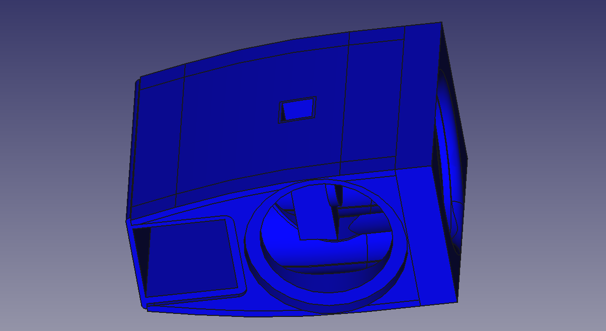

Almost done with the individual parts. This is the heat pipe/box beam thingy. Now this build has, props, radiators, motor, ECU and an exhaust......built as a powered vessel seems apt. I need to pickup a bit of 40x40mm alloy box from local Steerite outlet, they will do by the metre price and I have an account there for my marine craft builds. The heat pipe can be formed with CNC or handcraft

Also need to draw in the mounts on the back panel for the I/O. Tossing up between the DSP board vs the analog 2.1 filter board, I have both on hand for this project. As well, really hating the bulk on the Speakons. There must be a nicer system
