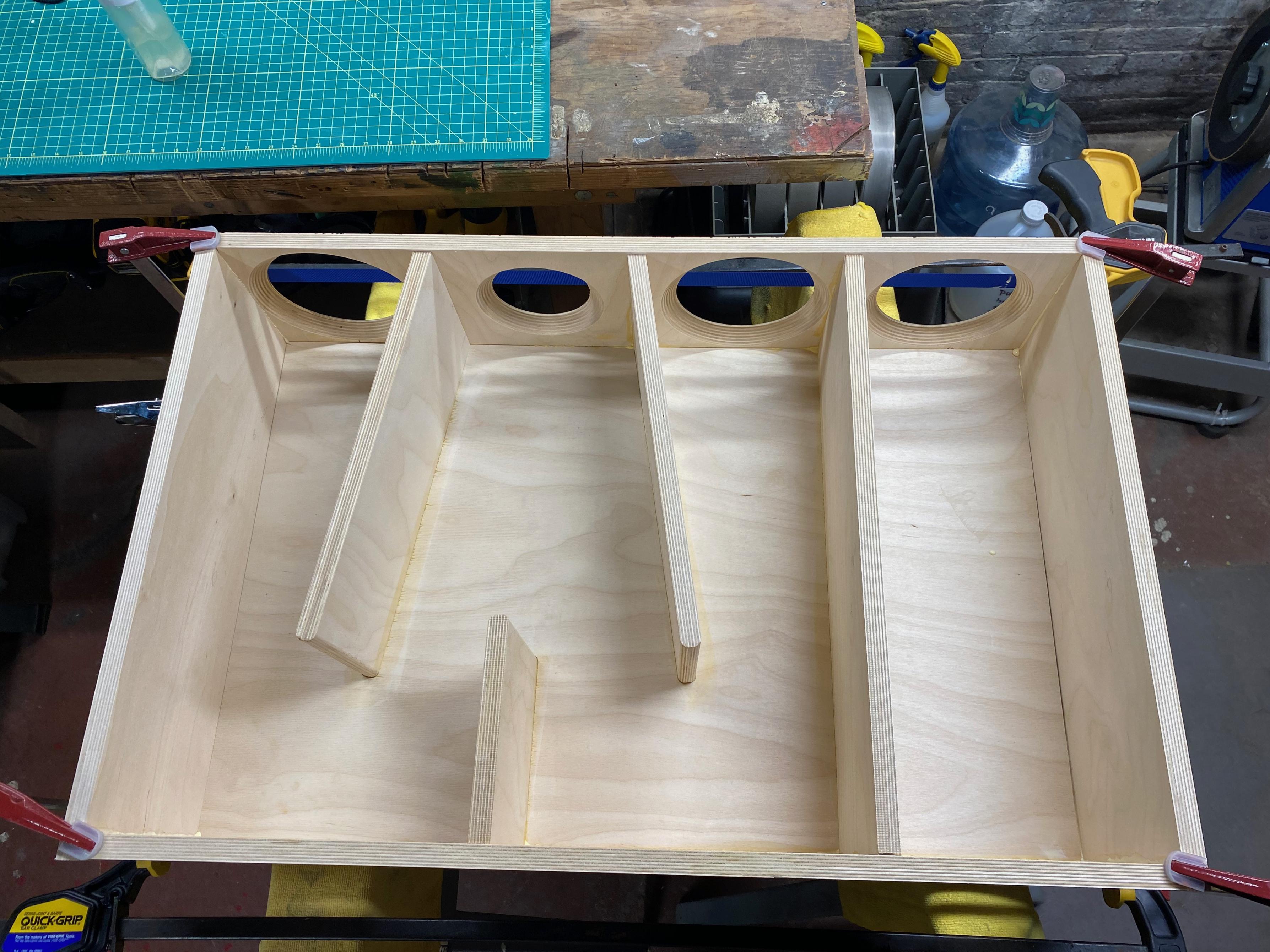

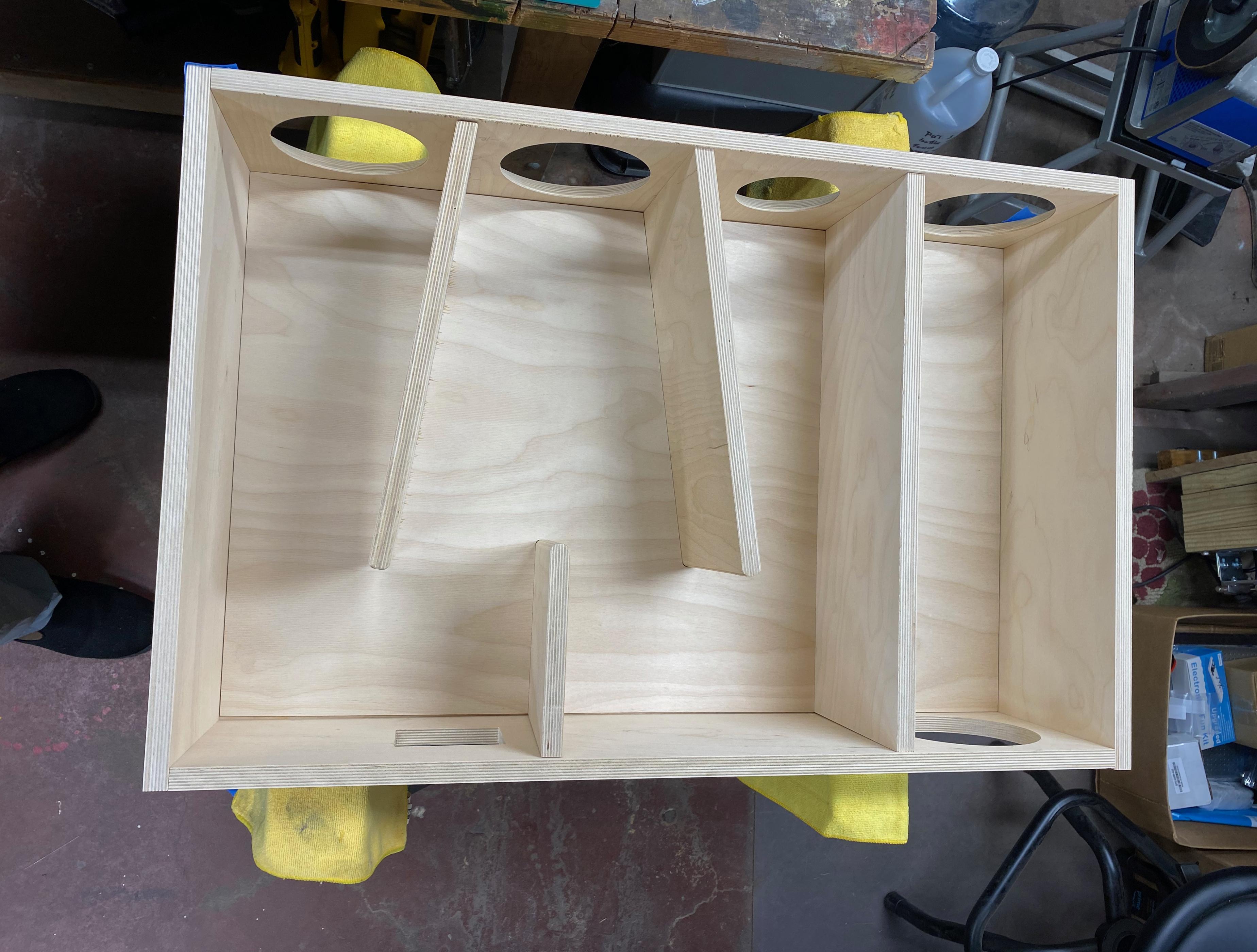

Major league rookie mistake - advice needed!
Well, I finally got away from work and back to the fun of building speakers, and first thing i do, I glue the inner baffle on backwards. It’s glued in pretty tight, attached to no less than 6 other boards. And it’s backwards. I went to some trouble to make sure to get the baffle beveled properly and then I glued it in with the bevels on the outside. Jeez. Luckily, I guess, this is the inner baffle and there is an outer baffle to which the speakers will be attached.
Advice needed. What is best remedy? I can think of 3 options:
1. Ignore it and just proceed finishing the speakers.
2. Get a router bit and chamfer the remaining wood the other direction, then fill in the gap with Bondo and try to re-create the proper bevel.
3. Cut the baffle out and get another one.
Any other options and recommendations?

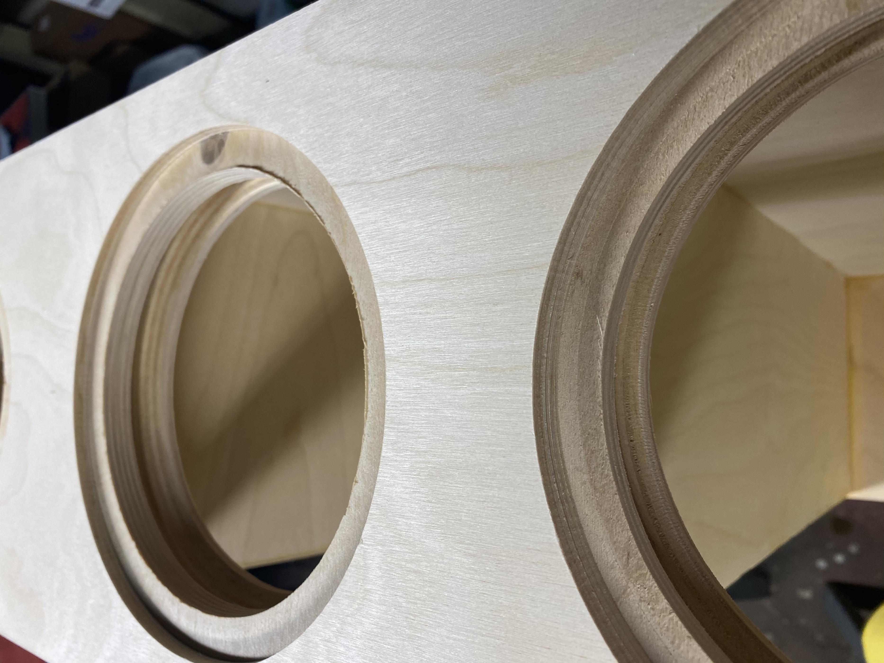

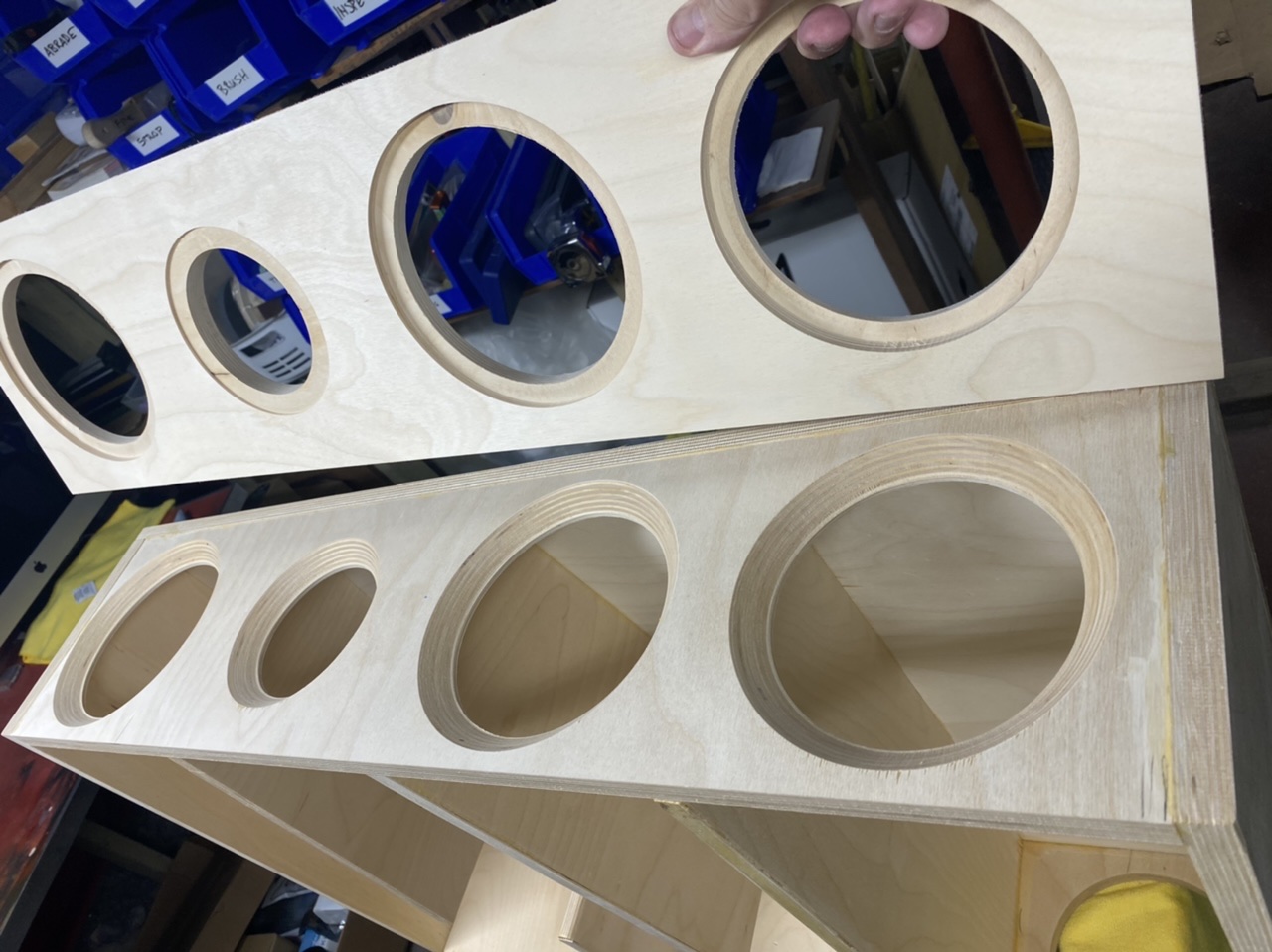

It shouldn't be a problem, I would consider opening it out to a plain cutout. The original purpose of the chamfer isn't so much about reflections, even though it looks that way. It's more about giving the strength of a thick baffle without crowding the rear of the cone.
If it were me: cut it out and make another one. I would probably remove the bulk of the material with a jigsaw, then use a router with some guides/jigs to clean up the glued parts.
I can think of a few other ways of solving the problem but they are all more work than that.
It doesn't really matter. According to Curt Campbell the inner baffle is probably not needed due to the stiffness of the 18mm BB ply. I can certainly make you a new baffle if you want to replace it. If looking at it thru the speaker cutouts bothers you, you could simply remove the bevel on the holes with a jigsaw. The bevels are there to give the drivers breathing room. Removing them would preserve this.
No one will ever see this mistake once you finish the speakers. And of course we will never say a word of this to anyone.
To reiterate. It won't matter. Personally, I would just trim the bevels off with a jigsaw, and install the other baffle correctly.
Bob

If that baffle is not coming out easily, you may have to remove it (with a router) and get a new baffle from Bob. Those bevels on the backside are lovely thou.
