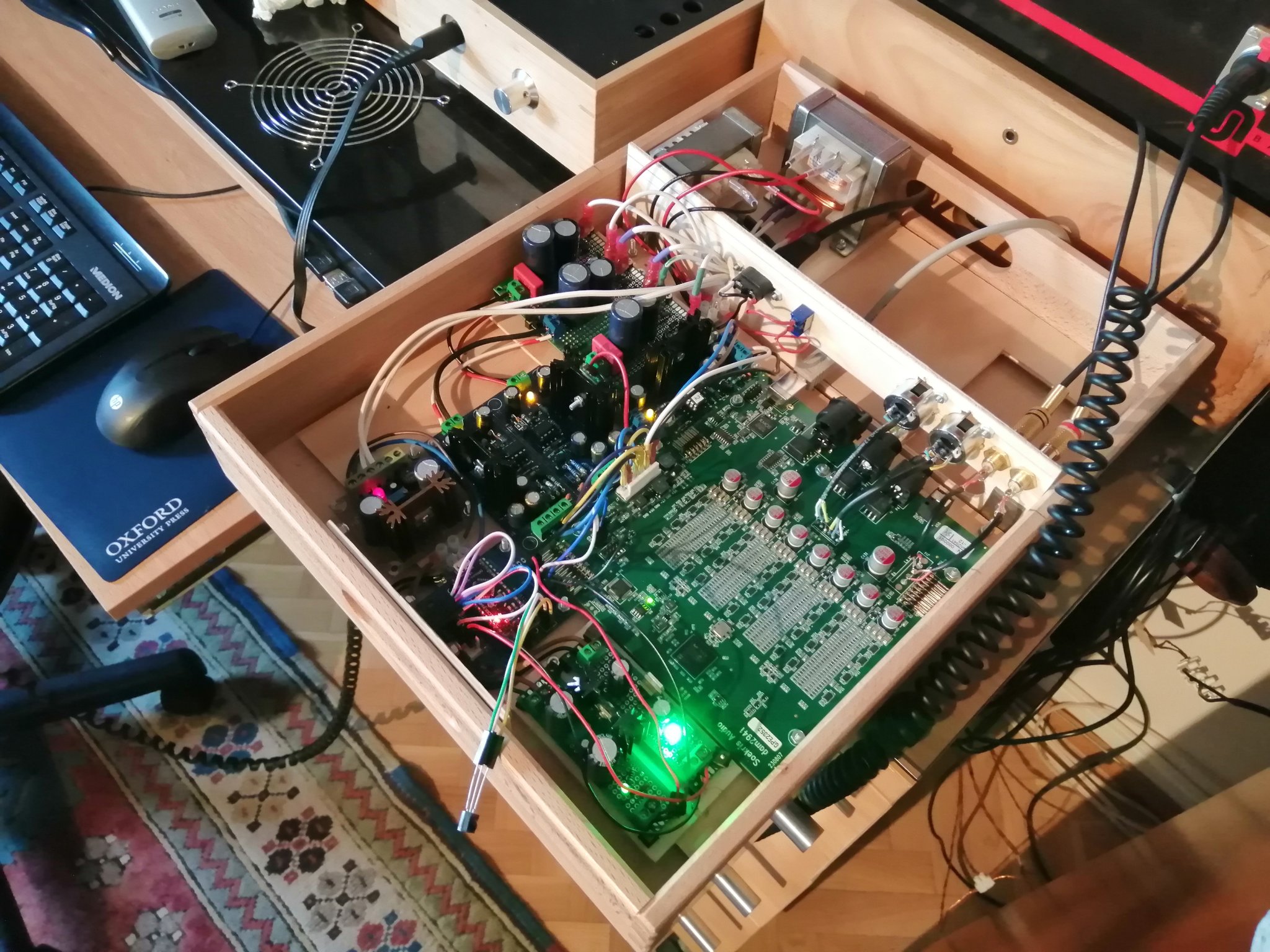

Hello, two weeks ago I assembled my recently acquired dam2941 board. It is in breadboard state as you can see and it has worked flawlesly from the beginning. I have tried different sources (optical, RCA, USB, even I2S with a Raspberry Pi) Always without problems and with exceptional sound (surprisingly good with the Raspberry via Volumio).
I take this opportunity to thank all the members of the forum. Without them this would not have been possible, especially to members DimDim and Euro21 for his version of ArDAM Lite, and of course to Soren for his creation.
But, recently I'm having a serious problem. After running for a few minutes after turn on, the sound suddenly stops. Sometimes it sounds again after a moment for a while to mute again. If I change the source it tries to sound for a second and then stops again. If I press next track, the same behaviour. This with all avalaible sources. The DAM board led is solid, not blinking at any time, and the screen indicates that it is locked, but there is no sound. So I am totally stuck at the moment.
Does anyone have any idea what the problem could be?

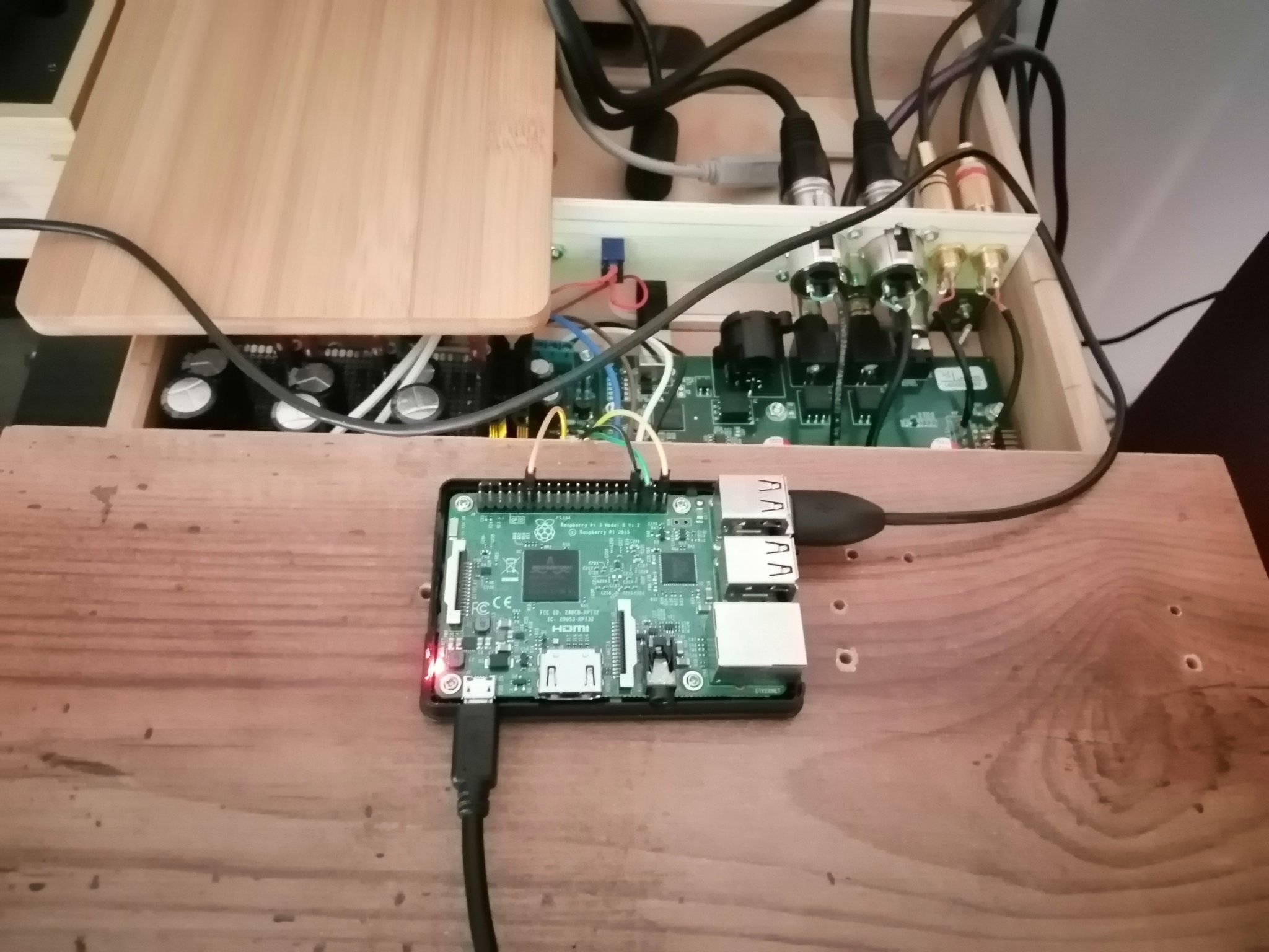

UPDATE
I think I now know who was to blame for the DAM malfunction that was driving me crazy. And of course it was ME.
In order to test the Raspberry I had to place the wood that you see in the pictures. That board was somehow resting on the cables of the ArDAM lite to the Tx and Rx in the DAM board. I noticed that, although the arduino program was set to -3dB on the turn on, it always changed to 0dB (the DAM default setting) after a while and that didn't have to happen. Hence the randomness of the behavior.
Maxi
