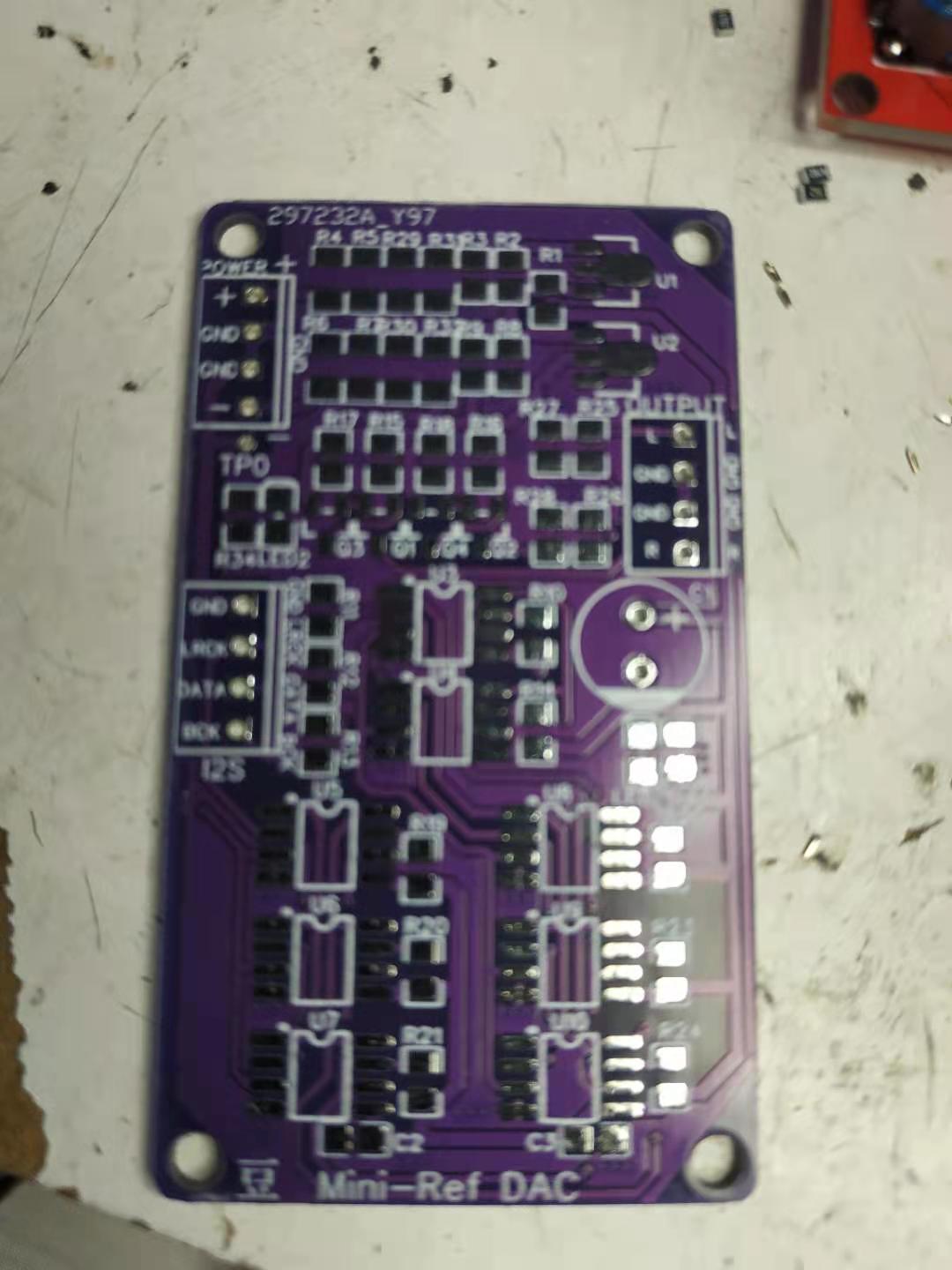

Jim - it will indeed work with TDA1387 for an entry level solution. In fact, I have the PCB for that on my desk as it turned up this morning :
Plain paralleled TDA1387 (more than two I mean) will give out too much current but on this board I plan to try a passive current attenuator to reduce the 8 chips (+/-4mA) here down to +/-1mA. Who knows if it'll sound OK but I figured its worth a try at least.
1mA input gives out 1.5V, so a typical +/-1mA DAC will give out 1VRMS from the I/V stage. Yes it will work with PCM58, that board is already in layout. I'll post a screenshot here when its done.

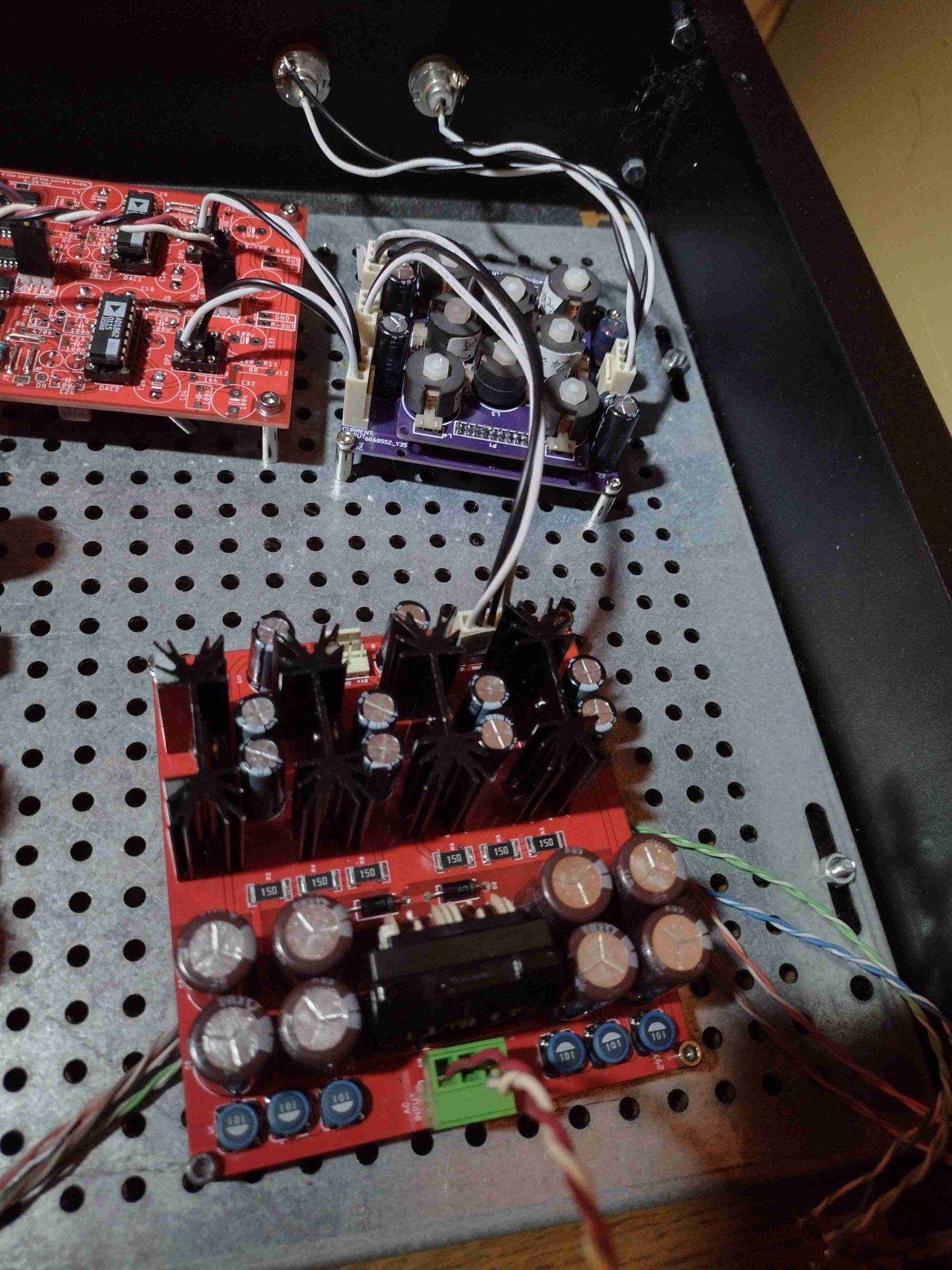

I received an early Dark LED I/V and have been listening to it for a few days as the I/V stage for a miro AD1862 DAC. I have one word for it - WOW. In my setup, it sounds better than my previous best, which was using Sparkos opamps for the I/V stage. The instruments are clearer and have more detail. It is very easy to pick out each instrument. It is like a smearing has been removed. The improvement is a whole step better. What came to my mind is the experience I had when I first listened to my Mapleknoll Cleo II air-bearing turntable. Compared to a conventional turntable, I was hearing less background noise and each instrument was clearer and more distinct...kind of jaw dropping. Unfortunately, I no longer have room for a turntable and had to remove it (I guess I should sell it???). I now rely on a good DAC.
Is this the best sounding I/V? I do not know. I only know what I have heard in my system. If you think you might want to try it, I will show what I did to implement this Dark LED I/V.

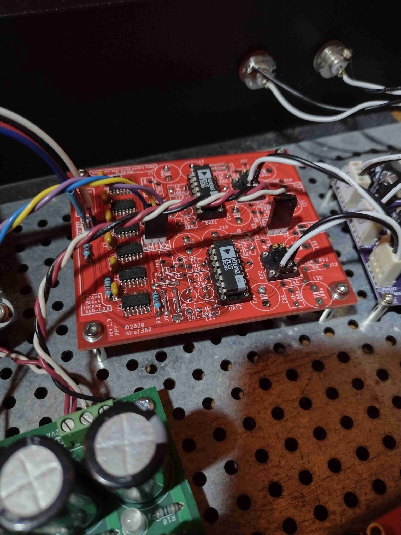

First photo shows the boards just sitting in the enclosure for the evaluation. The next photo shows that I made up another Miro AD1862 DAC pcb so that I would leave my first board intact. Notice there are about half the parts, and I placed the parts on the underside. If you want to add this I/V to your existing DAC, you need to lift the end of the feedback resistors and feedback capacitor (if you have one) that connects to pin 2 of the opamp (the inverting input of the opamp) and remove the opamps, of course.
In the next photo, you can see I put in 8-pin DIP sockets as if opamps would go there. Instead, I soldered the output wires to left over 4-pin sockets (I accidentally ordered several 2X4 sockets just to find out there were 4 pins total!) and plugged the 4 pin sockets into the 8-pin sockets. The I-out wire (white) is plugged into pin 2, and the ground wire (black) is plugged into pin 3. Those wires go to the I-out inputs on the Dark LED I/V board.

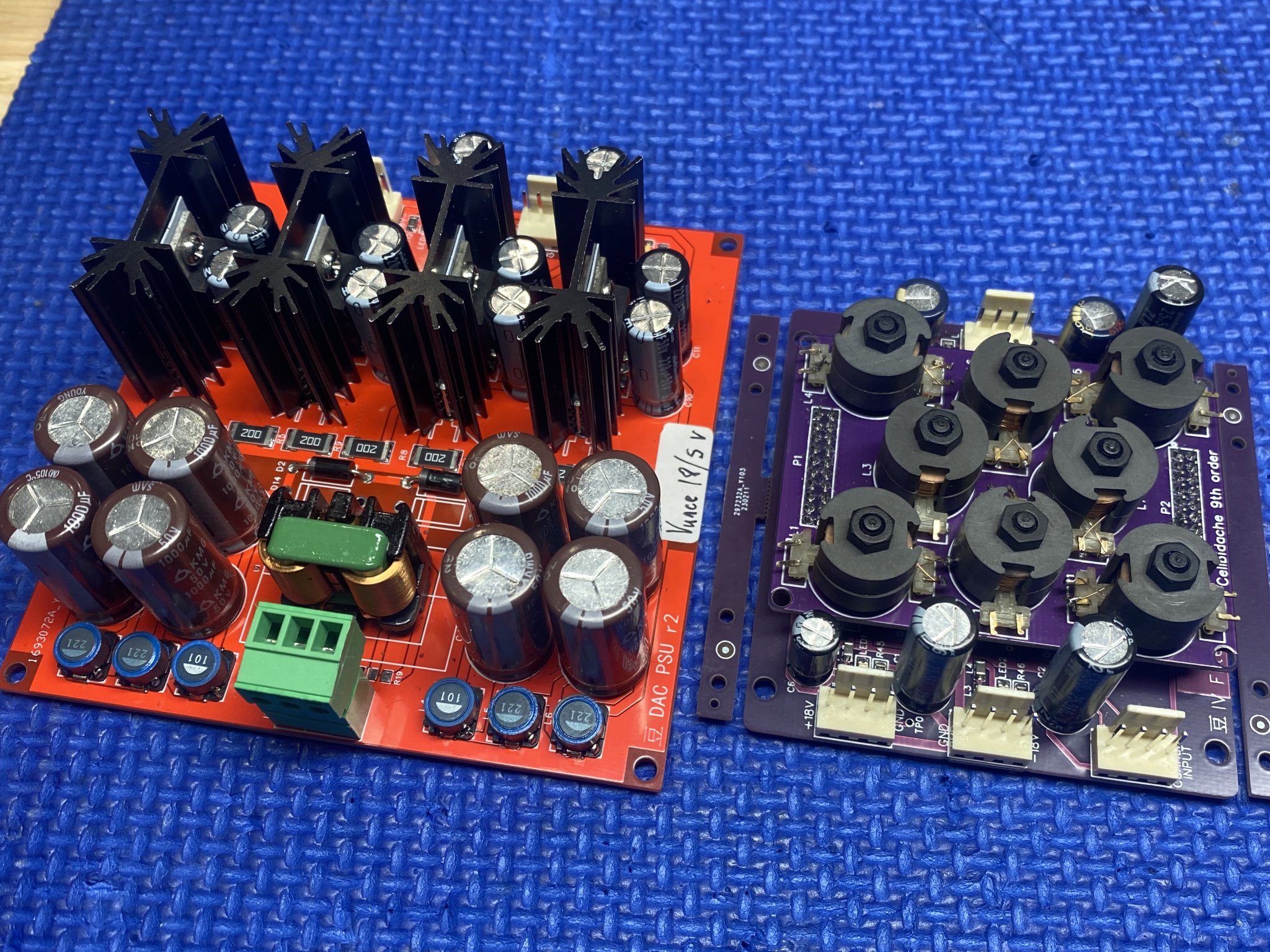

The next photo shows the I/V board outputs to the RCA jacks and the +/- 18 VDC power inputs from the PS. I also purchased a PS from abraxalito for the +/- 18 VDC because his PS only needed one 18 VAC input. It uses half-wave rectification to output the needed +/- 18 VDC. That way I could use just one transformer, the one miro recommended in post 6025. of his thread. It has two pairs of 12 VAC and two pairs of 9 VAC. I will put the 9 VAC in series to get the 18 VAC. That transformer just arrived and I will replace my present transformer when I drill 20 holes to mount five pcb's. I wish others would use the 10 mm hole spacing of the diyaudio enclosures :)
Until then I am using that temporary AC wall wart transformer for the 18 VAC supply. My other PS board is miro's PS1 which supplies the +/- 5 VDC and the +/- 12 VDC to the DAC board and the I2S board (one I ordered from Aliexpress)
Hope this helps.

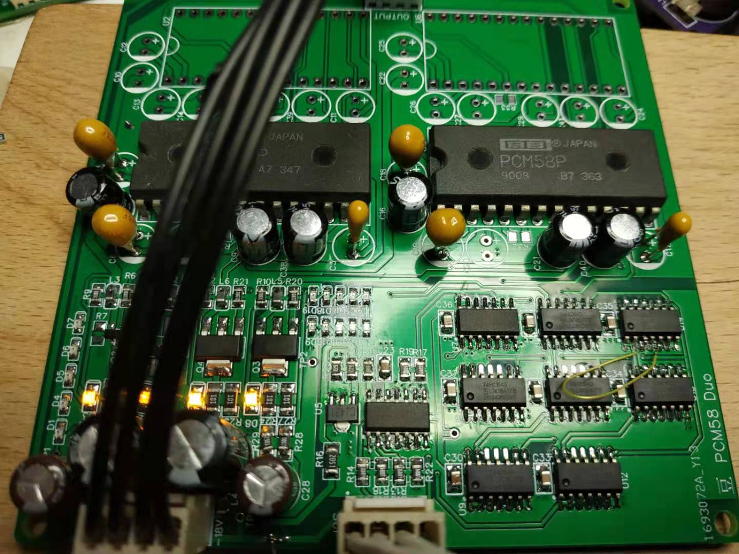

Here's the assembled board - only 3 TDA1387s are needed to be fitted to drive the I/V stage to maximum output :
One yellow wire on this as I messed up the I2S to RJ decoding. To be fixed on the next rev. Either 2 or 4 PCM58s may be fitted.

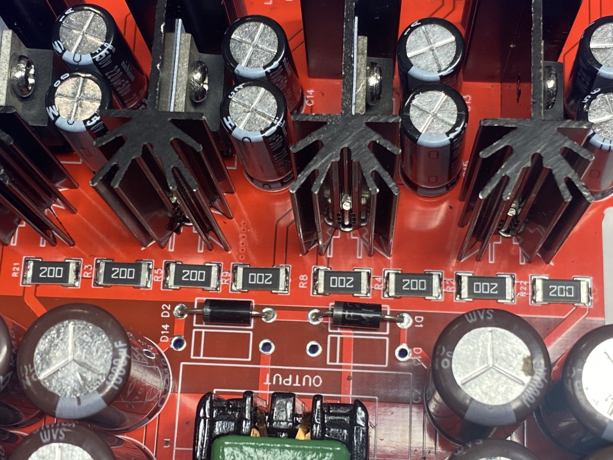

I received my goodies today! The boards look great, very neat and clean soldering. And M3 fastener friendly.
:cheers:
But, will the psu work correctly when a few resistors are not oriented in the same direction??
