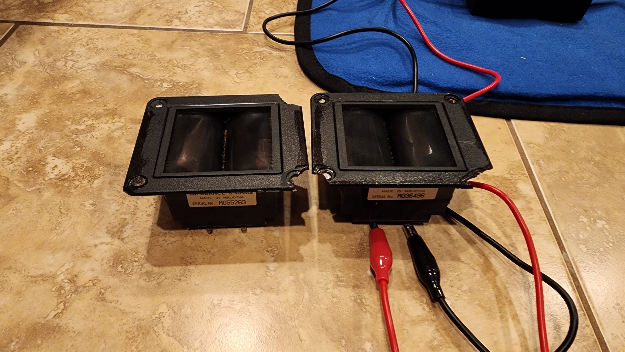

7kHz. Yes, very shallow works.BTW, I also purchased a large number of those Foster ribbons. What is the lowest frequency you would cross with a third order? have you tried loading it with a waveguide?

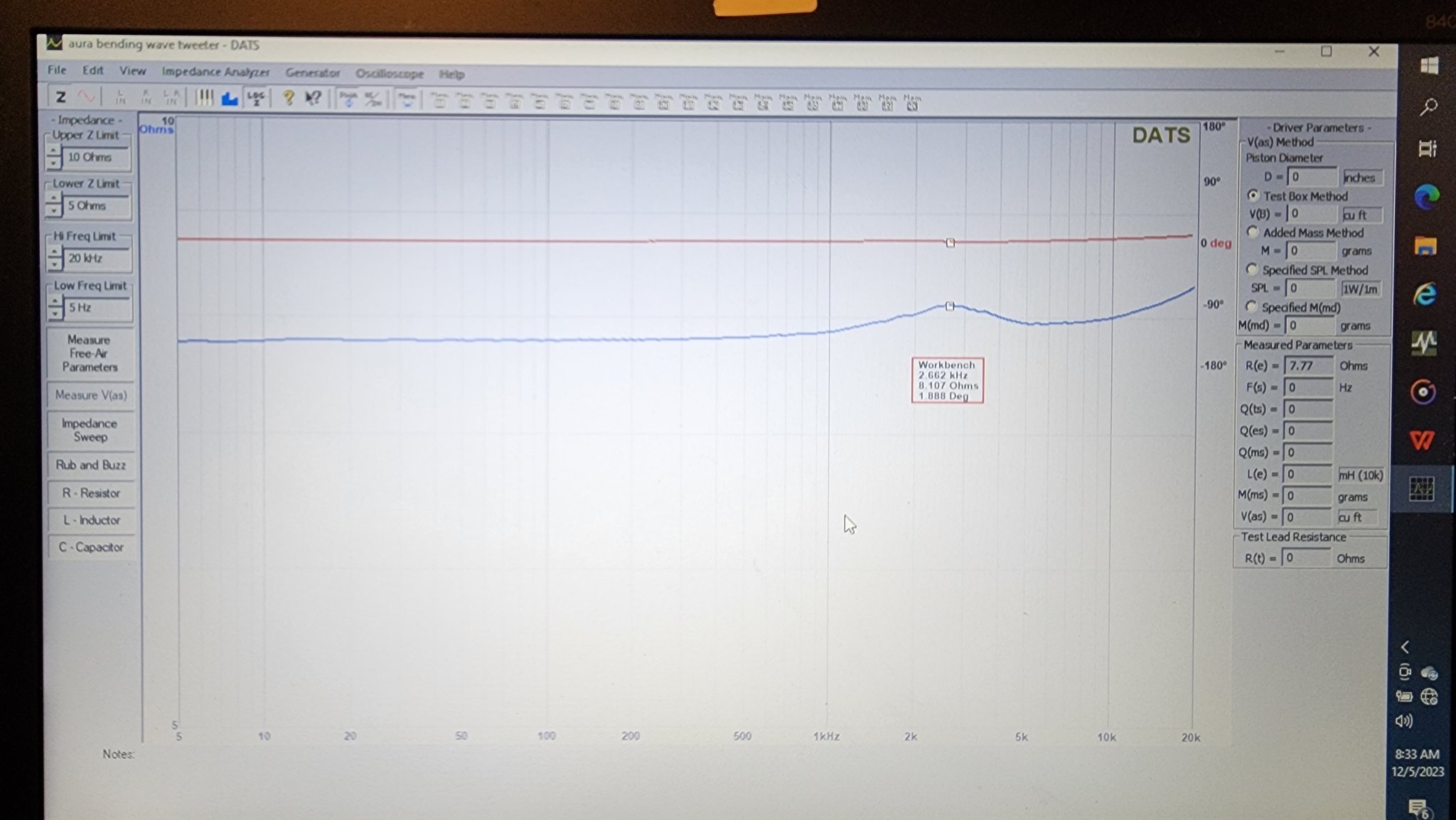

Found this old post from my former self:
https://www.diyaudio.com/community/threads/tweeter-resonant-frequency-missing.103407/
Concluded some tweeters are sufficiently damped (if voice coils not seized) that resonance does not appear.
Definitely a posibility. I measured few, they all look consistent. And sound good.Found this old post from my former self:

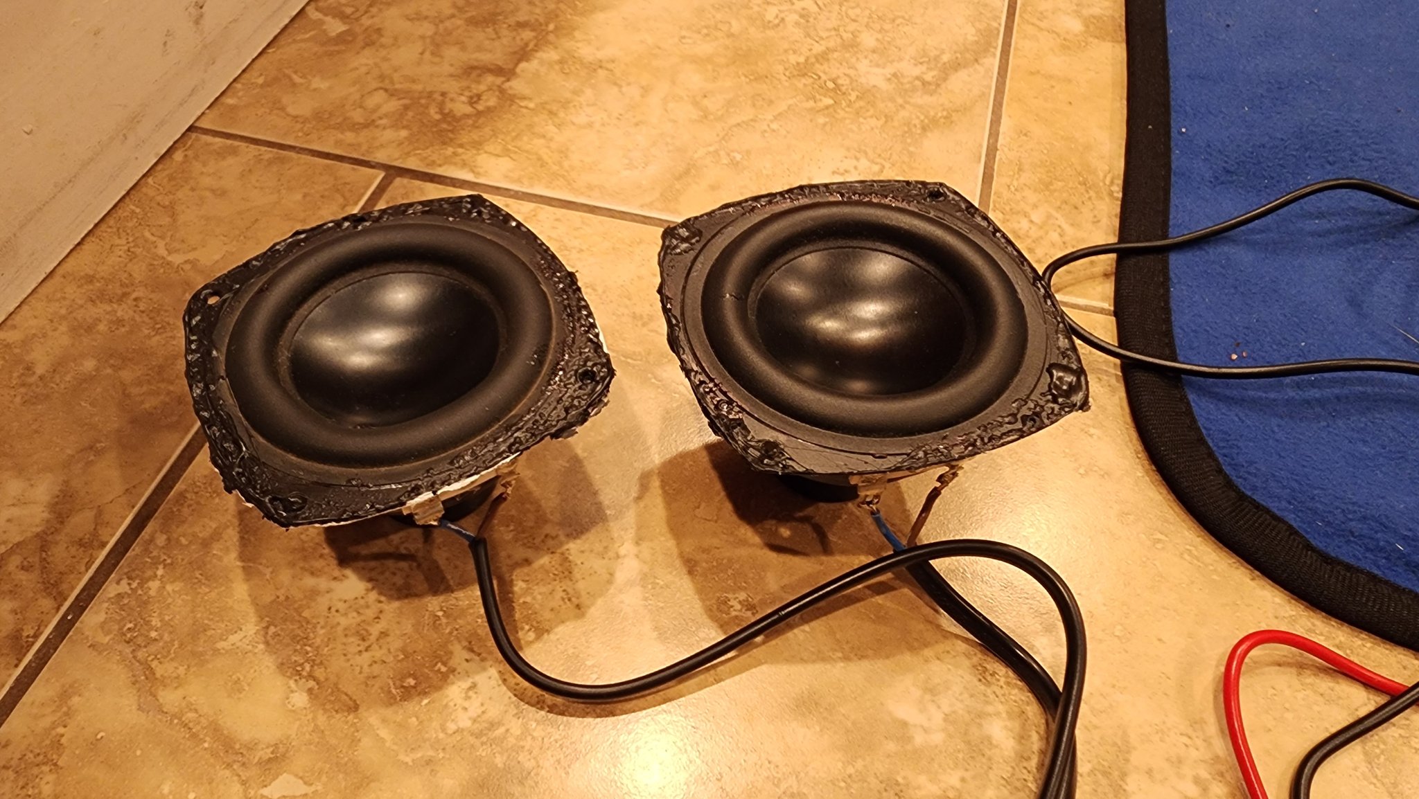

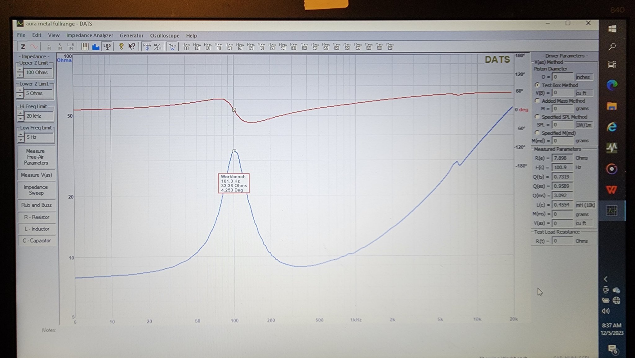

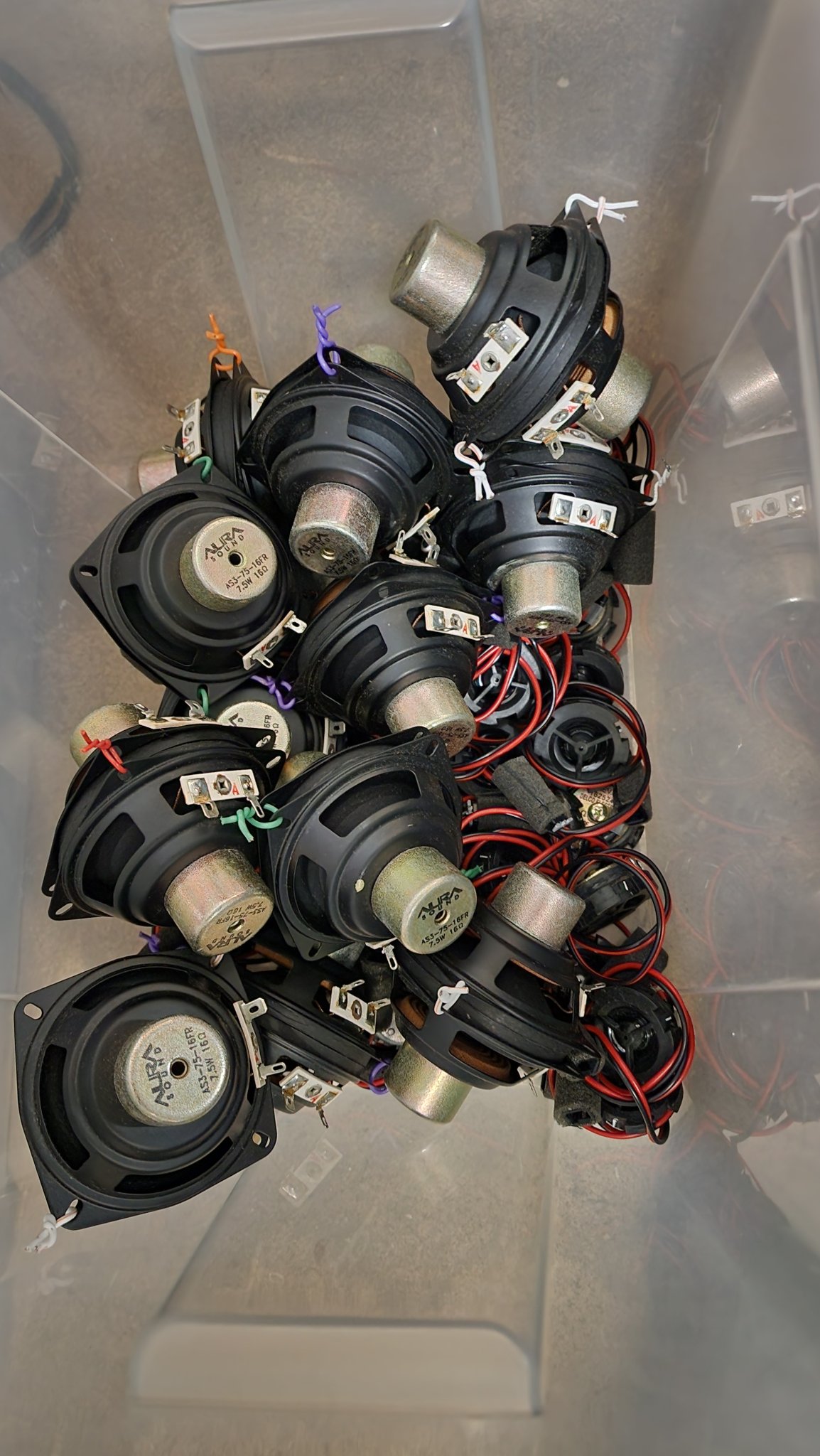

Here we have a pair of aura metal fullranges, ns3-193-8a1. It can put out plenty bass for such small driver. Fs 100Hz. It goes high, have not bother measuring it. However, as metal cone, it has bunch of breakups. One particular sharp at 7kHz.

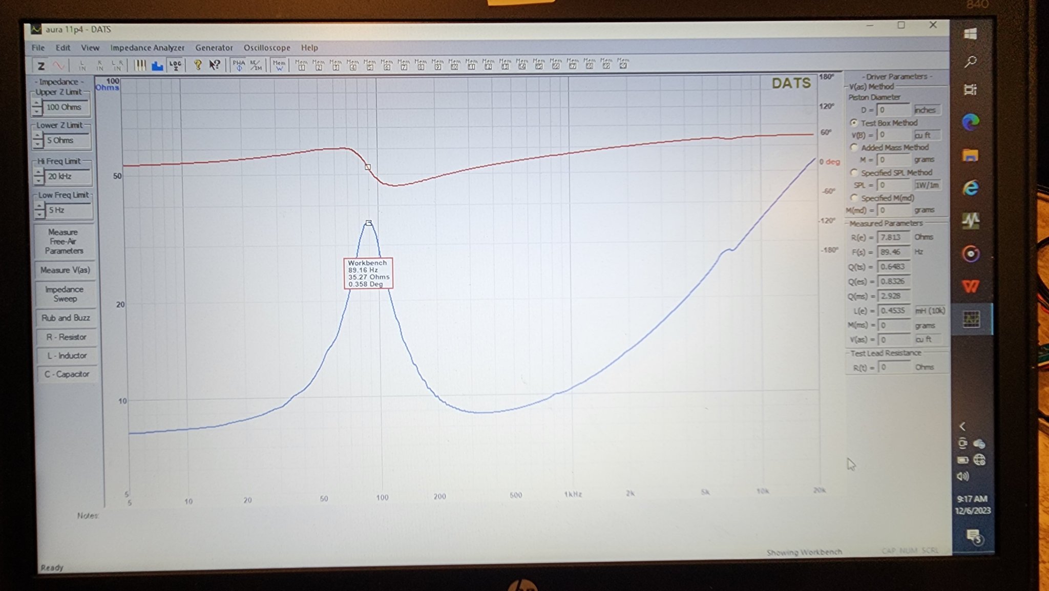

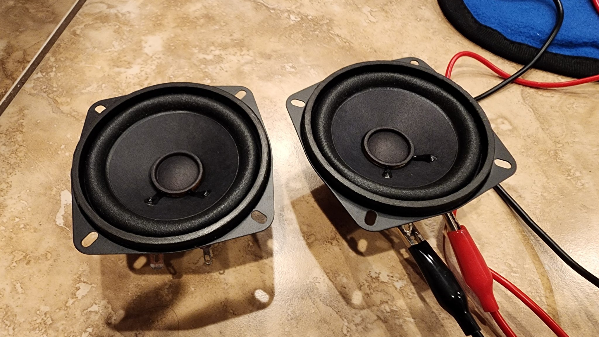

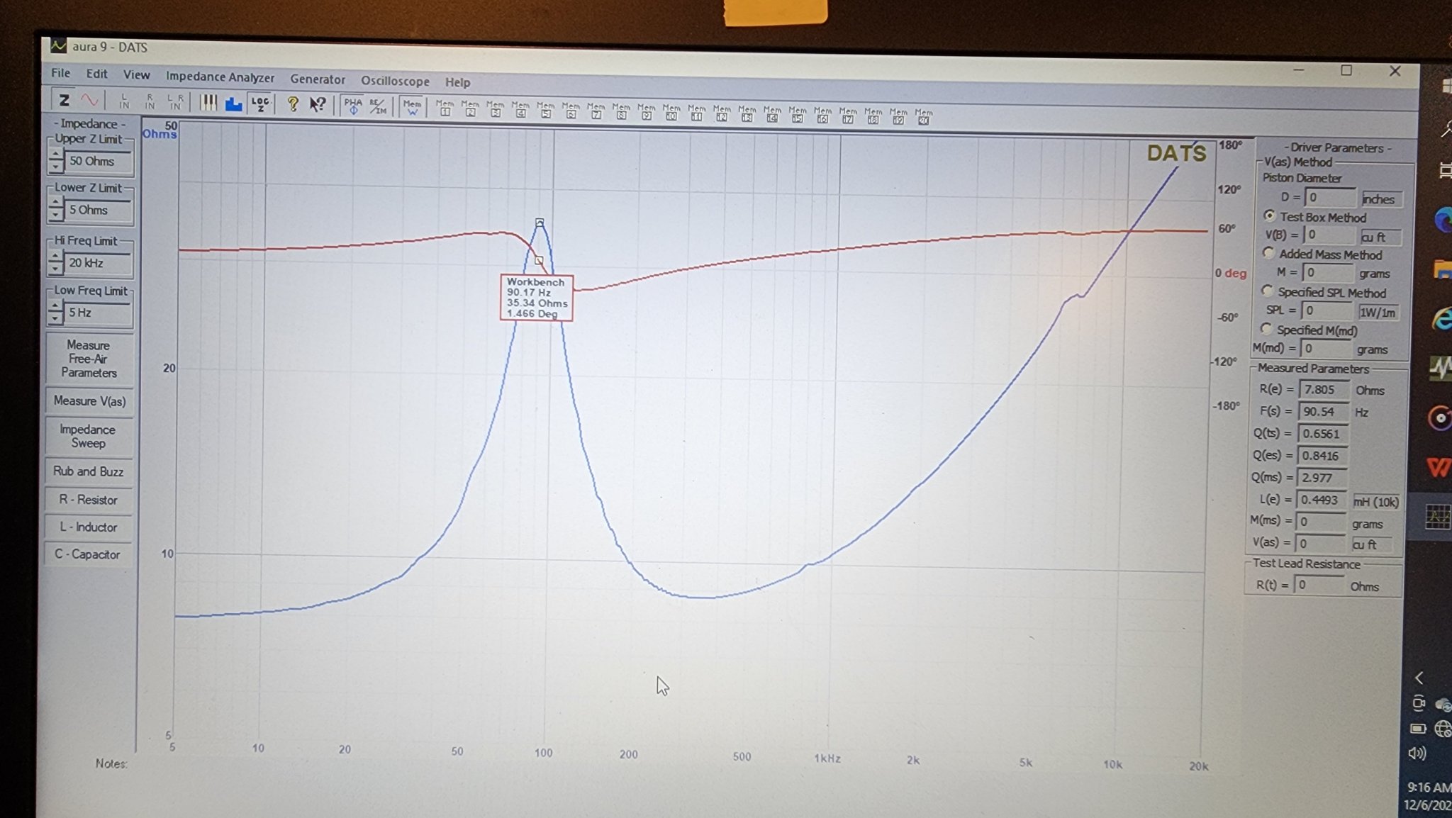

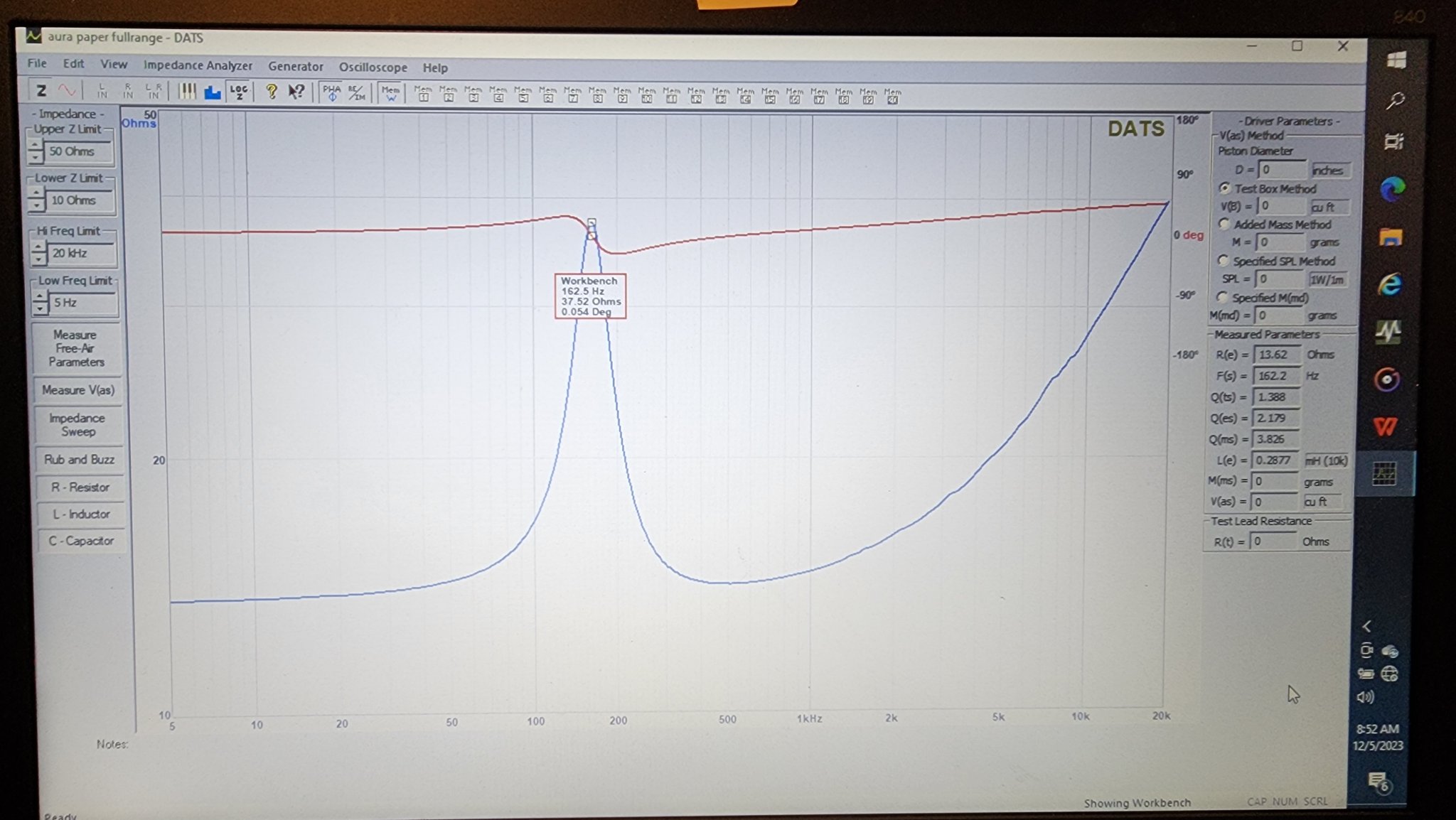

Next we have another small fullrange, paper cone, aura as3-75-16fr. Does not go as deep, Fs only 160Hz, and does not go past 10kHz, so basically its mid. But it does not have any severe breakups. Its specified as 16 ohm.

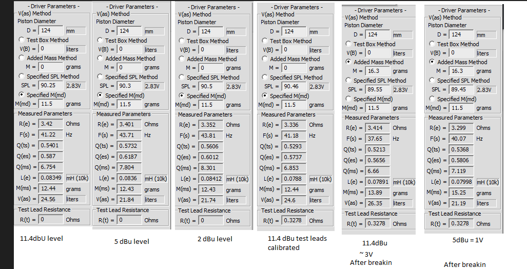

You can also change the test level Go to generator mode (menu item) where you can increase / decrease sweep level (dBu). Max is 11.4 I think before clipping occurs:
I can't recall actual voltage and given any current limiting of USB, DATS doesn't accurately measure T/S in terms of matching "higher voltage" T/S factory measurements from the likes of SB Acoustics. Or it could be user error. This is an SB17NBAC35-4:

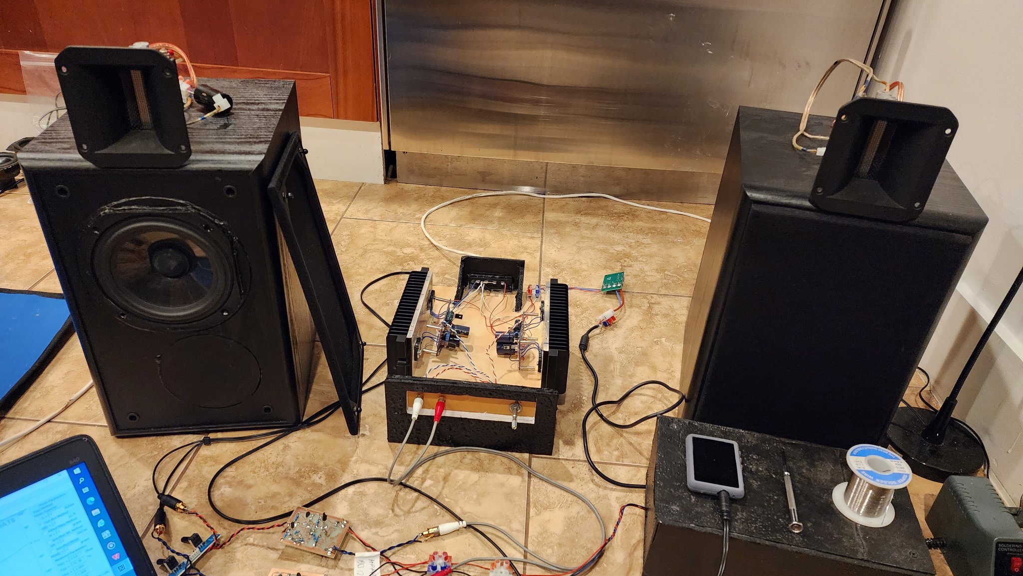

Later, verify impedance of all 3way and 4way speakers i built if it does not dip too low. Most of the time i make 8 or 16 ohm speakers, just to be classA amp friendly and low distortion load. Even classAB amps benefit from higher impedance load. Its a mistake to have low impedance dip i try to avoid. DATS should be able to verify my builds.

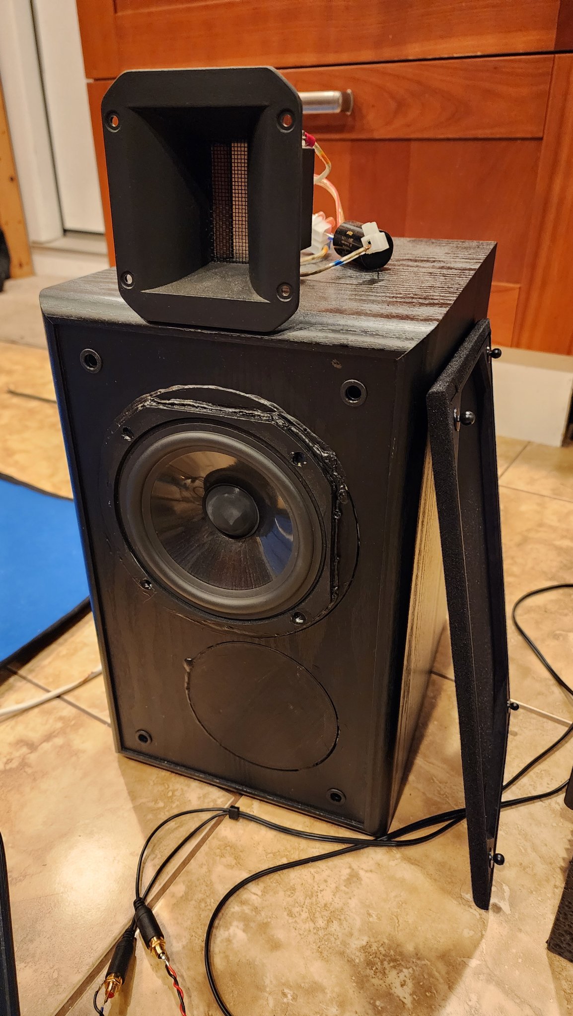

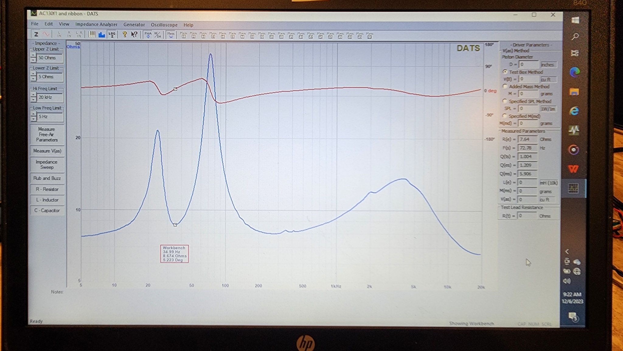

Measured my test bookshelf. Its 2way with Aurum Cantus AC130F1, plus ribbon tweeter. I optimized cap to ribbon, to have smooth transition in crossover point. But i never measured low fr extension. No unechoic room here. I used commercial parts express box of unknown volume, but it has bassreflex in the back. So i was curious where it tunes. Looks like 35Hz. It produces nice deep clean lows, but AC130 is no woofer. Wonderful midrange. Great for testing sound of amps and preamps. With sub, this would be great system.
Remember to short the leads for calibration. This will deduct roughly 0.3ohms from the measurement allowing for dats test lead impedance for more accurate results. You'll see this value bottom right under T/s parameters
I've found the impedance sweep quite accurate abd very useful to see nuances such as port resonance standing wave or other reflection / noise issues
Yes added mass requires accurate weight which I applied. As you'll see I tried 3 of the different options to do Vas measurement and they all ended up similar values. Delta compliance was the only one not verified and that may be bestGreat info, thanks. I will experiment with test levels.
