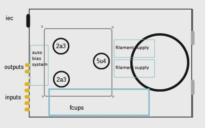

The only way to really hear the sound though is to go spud. And what better place to do that than right at the beginning - the linestage. Many will say that the linestage contributes more than the amplifier, so...
UX4 sockets: this would allow 10/10Y/VT25, 26, 45, 71A, 2A3, 801A/VT62, 300B, 101D, 205D if we can design in enough control to supply the variety of filament, and B+ voltages needed. Used spud we'd have a friendly gain structure of between 9 and 18db. Most have lowish anode impedance; no transformer needed as in the range ideally suited for preamp duty. So...OTL it is!
With adjustable CCS for the anode we can control the anode current. Easy done.
Since this is an all-out attempt to hear the real DHT, and all of it, we don't want un-necessary caps in the signal path. So let's go fixed bias, thus avoiding the cathode bypass cap. To make this easy we have our ABS module feeding the grid which can be set with one resistor for the desired operating point.
Power supply: to stay with the theme lets use a DH rectifier tube.
We don't want ANY electrolytic caps blowing smog into our sonic landscape so we will let the all film-cap FCUPS module provide the P:USH power we need. This has the added advantage of supplying the bias voltage needed by the ABS and bonus: jumper setting for virtual battery or virtual choke operation. And it is super quiet.
The filament supply also needs to be quiet, be a brick wall to the signal (DHT, remember?) and be adjustable: DIYHFS filament supply just happens to be on our shelf.
Transformer noise will be an issue so let's order a potted (3mm steel) torroid which has the advantage of radiating EMF axially thus avoiding noise in the chassis. Our goal is to do this all on one chassis. We'll mount tx forward, to keep it away from the signal end of the chassis.
We'll need one pair of 2.2uf/250v coupling caps for output and 1 pair 0.1uf on the input grid.
Chassis will be the Projekt Box, also at hand.
Layout will look something like the attached.
Here we go!

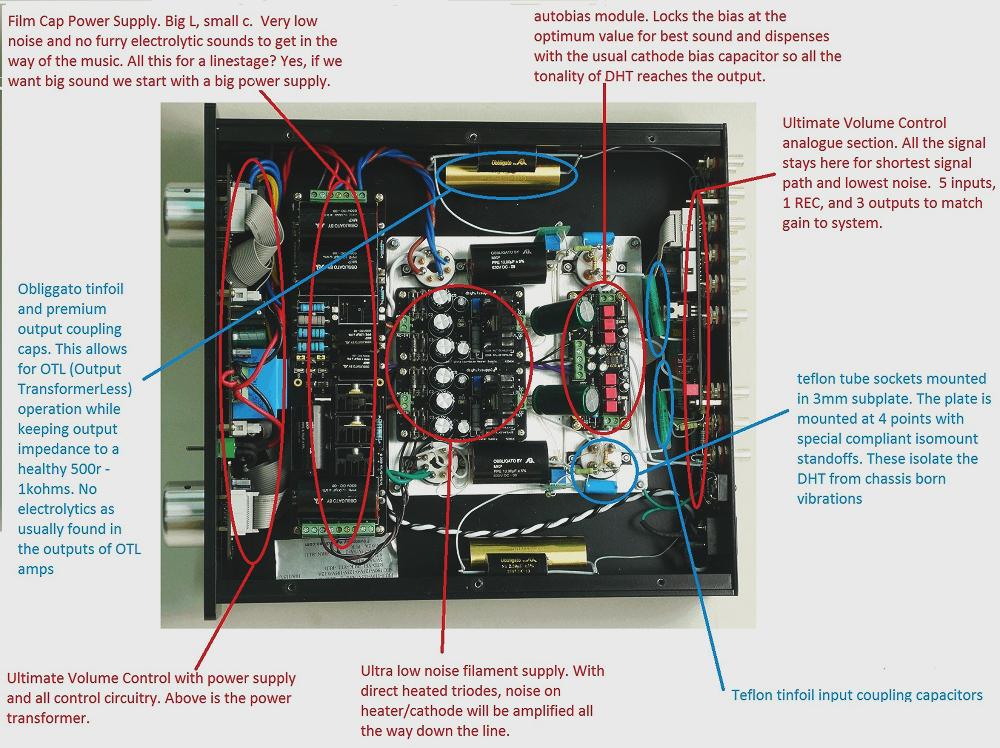

We're pretty well there. The current design will grow one more tube, a 6AS7. This will allow us to expand the range of DHT that can be used without major circuit changes. As seen here we can change 2A3 and 45 on the fly.
Microphonics was a big problem early on but this has been solved using floppy tube socket mounting and selectable output gain, 12, 3 and -6db gain, as well as a few other tricks. I think most tubes can be used. The first build could only use a pair of NOS 45's we have. With all others it was the Gong Show. All the new manufacture 2a3/45's have much larger glass bodies than NOS and support the filament with spring tension and so ring like Big Ben at noon. The Shuguang 2A3 were the worst - looks like pen springs used. But now we are able to use every tube we've tried - about 8 different types including Shuguang, TJ, and NOS types.
Also selectable ouput gain means linestage gain can be matched to speaker efficiency.
You can see we've made good use of the Technology Bites Series of modules we sell.
Noise was solved using a very low noise filament supply implementation.
We've used the ABS (auto bias system) to safely exploit the benefits of fixed bias. This allows getting rid of the cathode capacitor and using a single low value, high quality resistor on the cathode. At the linestage level, these design touches are very noticeable, more so than down the signal chain.
The FCUPS (Film Cap Universal Power Supply) supplies the DHT B+ which also uses a CCS for the anode load. This might seem like overkill for a linestage but if we want a big sound we need big tubes and big power supply. The FCUPS does everything the original Tram regulated power supply did -- and more. The DIYHFS theme song is: No Electrolytics! so we use film caps as much as possible.
The for sale version of the Tram2 will have an option for the UVC (Universal Remote Control) with 126 steps and 6 inputs (if we can find enough space on the back panel).

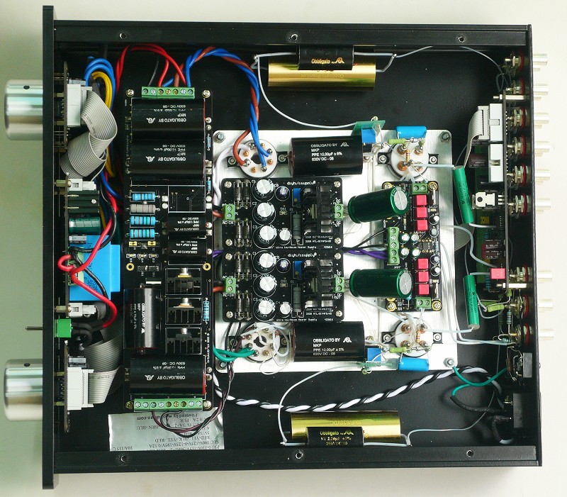

Bottom View
The concept couldn't be more simple: Use direct heated triodes for linestage duty. Put some signal on the grid, heat the cathode, add B+ to the anode and voila! What could be easier? Works for DHT amplifiers, and parts count is low.But put a DHT into a linestage where signal levels are in the mv range and we crash into noise, microphonics, noise, possible impedance issues and more noise.
Noise can come from power transformer, filament supply, B+, poor grounding, bad layout, not to mention proximity to outside sources of noise.
The Tram 2 starts with good layout. We wanted a single chassis solution together with power transformer. So transformer at the front, triodes at the back close to input/output connections. Tube rectifier and 6AS7 closest to the transformer.
B+ is supplied from the ultra low noise film cap power supply module and the cathode supply comes from our filament supply module with added capacitance.
Microphonics must be the middle name of the triode family. We already encounter this in amplifier position, but in a linestage -- talk to your triodes and maybe your speaker talks to you! All slight to jarring level vibrations will mess up the clarity of the sound. Everything around us resonates and thus vibrates.
The Tram 2 mounts the triodes on the 3mm tube subplate which is in turn mounted to the chassis with compliant isomount standoffs. Knuckle rap on the chassis doesn't transfer so we've done well.
The other factor is system gain. High sensitivity amplifiers and speakers will feedback through the tubes and exacerbate microphonics. So we have provisioned 3 outputs: +6db, -3db and -12db. The user needs to select in system but in general: amplifiers with input sensitivity of 2 to 6v would match +6db outputs; 0.7v - 2v amps: -3db outputs; below 0.7v amps: -12db outputs.
Of course this impacts on impedance so it requires finesse. The Tram 2 can comfortably handle amplifier loads down to 2k ohms.
Result: through our in-house Crescendo speaker system, 98db/w (100db/2.83v/1m in room) we get no hum, just a little tube rush.
We'd originally planned to use a choke to load the anode of the triode but that would push us to a 2 chassis linestage and potentially more noise pickup. So we instead used a 6AS7 together with CCS to load the anode. Result is very low output impedance and very high anode load. The effect is as a super mu follower.
