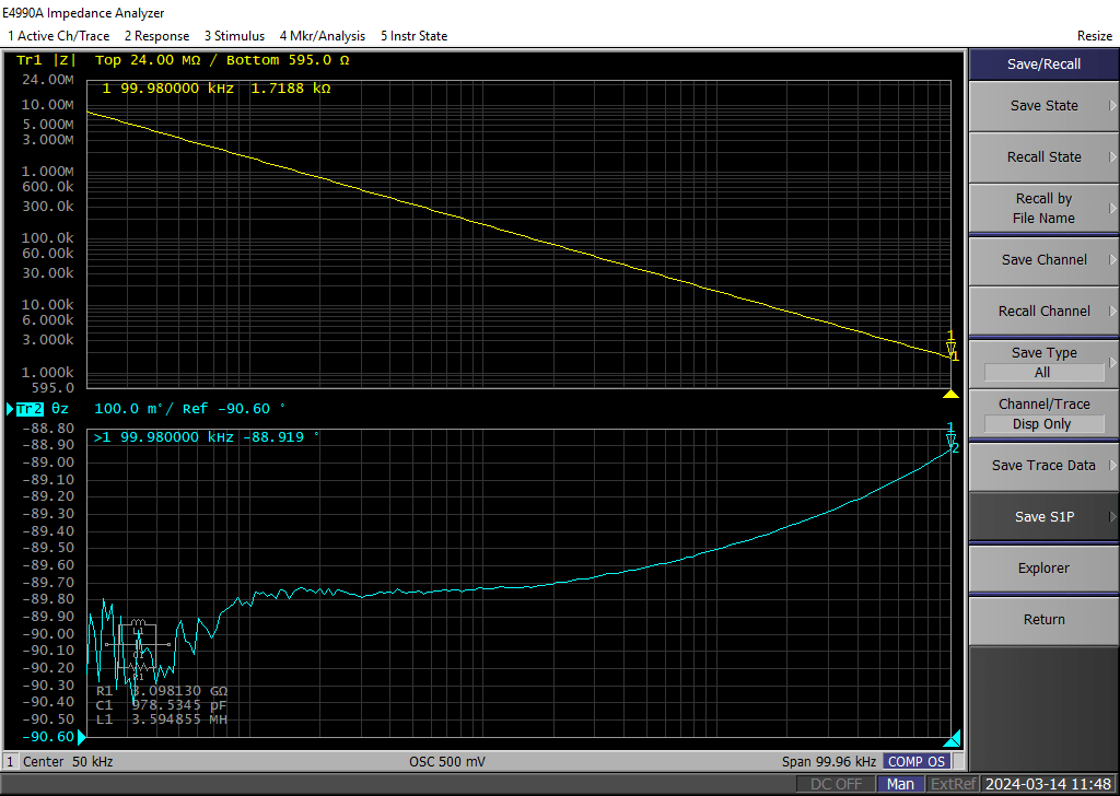

100u ceramic + 100n film that's all I had at hand.100n ceramic + 10u-100u electrolytic?
The problem seems to be less extrem with a NE5534 instead of the TL071. Since the NE5534 has about 20dB more PSRR it might have to do with the supply rails.
But wouldn't the problem be always there then, regardless of the pot position? 🤔
Well, turns out the caps I've been using aren't that bad. At least that's what the impedance analyzer tells me. (Being an electrical engineering student at a well equipped university has it's benefits.) 😅Could the phase shift caused by the treble capacitor be the culprit? After all it's in the feedback network and might turn the negative feedback into positive feedback that doesn't get attenuated enough depending on the pots position. Are high quality caps important for this circuit? 🤔

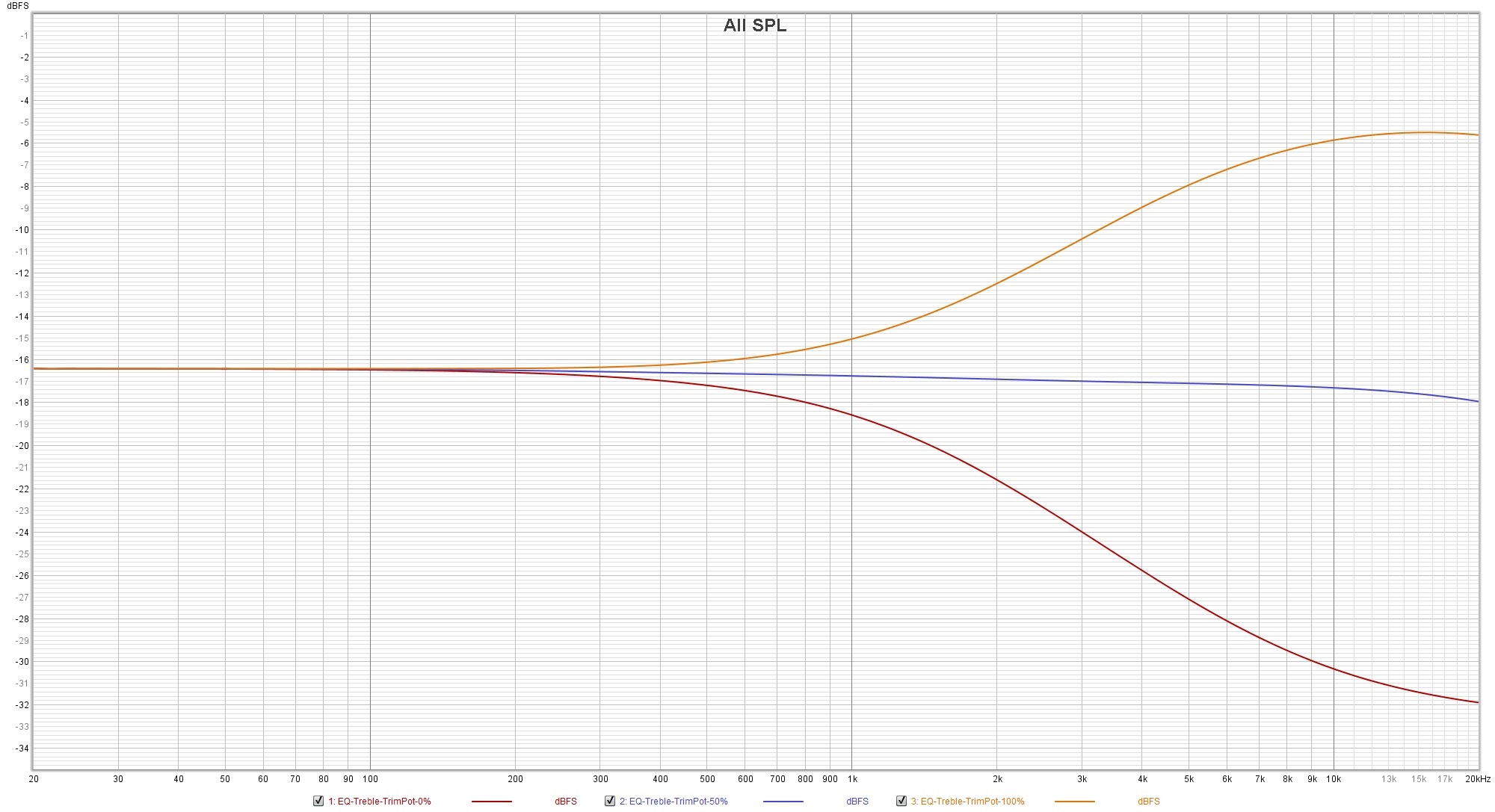

Progress! Getting rid of the oscillation requires a combination of measures:
Power filtering is always important but can be challenging on a breadboard.
Using a "better" opamp certainly won't hurt and a NE5534 is by no means high tech, nor particularly expensive.
For now I'll leave it at this point. Maybe I'll add a test with the digipot at some point, but that shouldn't make a big difference.
tl;dr -> The Baxandall circuit may be "tried and tested", but implementing it isn't as trivial as it might seem at first glance.
- Clean and stable power rails.
- An opamp that isn't too sensitive to noisy supplies (high PSRR).
- Adding a capacitor from the opamp's output to its inverting input does help but it essentially creates a low pass filter.

To bring this topic to an end: There must have been a problem with my breadboard setup that caused the opamp to oscillate.
Also, the usually quoted version of the Baxandall EQ seems to be prone to causing issues with (especially JFET type) opamps.
(There's a nicely written section about this in "Small Signal Audio Design" by Douglas Self.)
With appropriately sized components the implementation of a digital potentiometer works perfectly fine.
