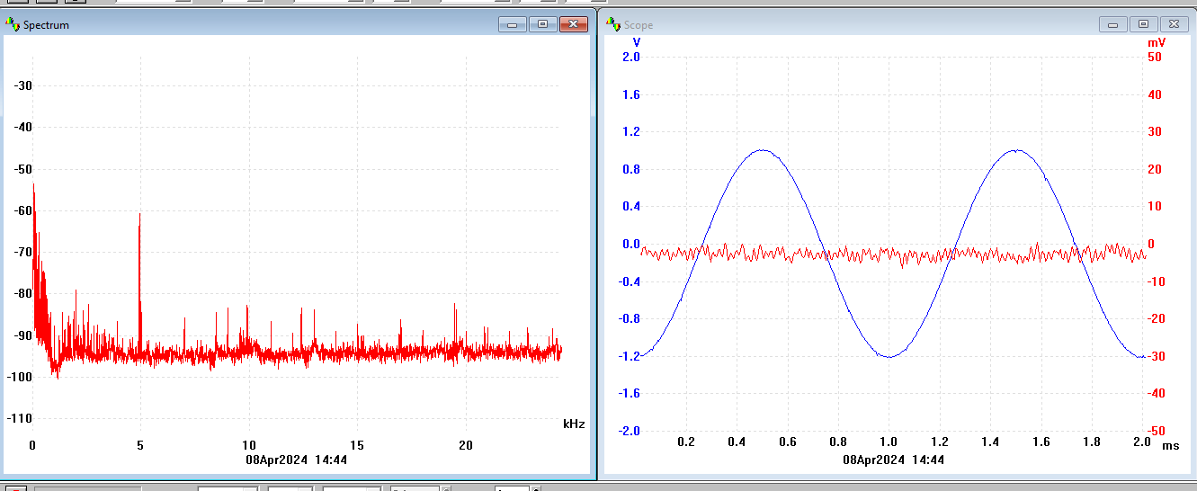

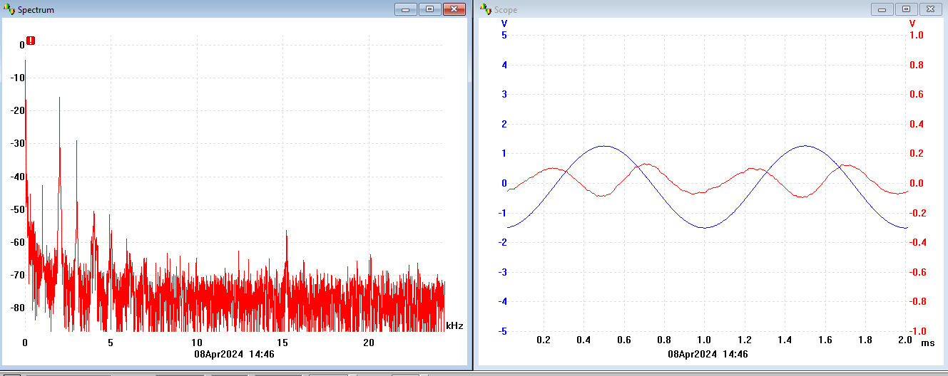

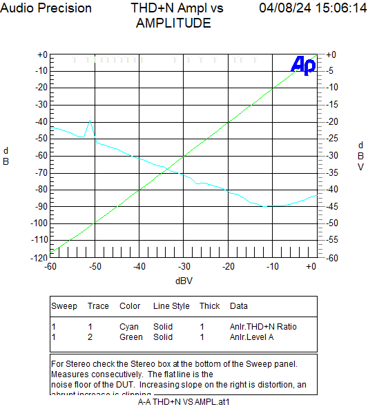

And these are of the General Radio 1560-P62 preamp

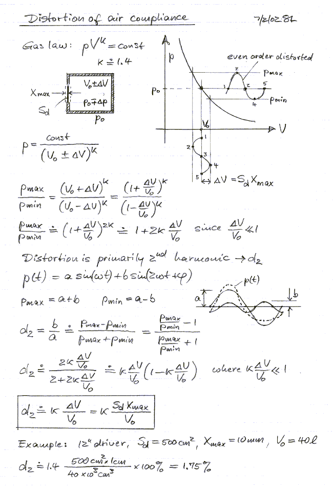

It helps to look into the mechanisms of distortion and what distortions are disturbing to the listening experience.
In the scheme of things THD is not the worst.
To my ears IMD2 / Amplitude Modulation and the resulting side bands pushed up into the voice range Hz are the most irritating to me.
Nonlinearity in the low Hz causes intermodulation of higher frequencies.
Electricity (current) through the voice coil generates a magnetic field. That field interacts with the magnetic field of the magnet structure. That magnetic field interaction applies a Force to the cone of the driver causing it to move. The force applied to the cone depends on the position of the VC in the magnet gap. the father the VC is away from the neutral position in the gap the more the Force modulates.
Low Hz Hysteresis also causes IMD2
Similar also for for both nonlinearity of the cone suspension and modulation of effective cone area at the limits of VC position.
All these distortion mechanisms show up in IMD2 side bands which can be measured in current distortion across a resistor in series with the driver under test.

In my view with H2 and H3 levels around 1% or less, sample -to-sample consistency will be a dominant factor. The assumption here seems to be all samples are equal. That is not the case, even with high end stuff such as Purify.
The trend, however, is recognizable; de details should i.m.o. be taken with a grain of salt.
Measurement consistency of an electro-mechanical device is another hurdle. In my experience raising the ambient temperature 5 degrees C .will already produce a different outcome.
Reactions: 1 user
Joined 2005
@DualTriode
Great. You documented -70dB down for H2 and -80dB down for H3.
Please let me know your measurements conditions- drive level, mic distance, mic, measurement chain. So that I may attempt to replicate such findings. So that when I measure another (unpublished driver) I may actually have a comparison point.
Suppose my measurement chain can only resolve -50dB down, I may be biased to say "-50dB.. hmm, hat's all you need. That's the magic number" And all if all my drivers seem measure in at -50dB down eg. A2000's ACM192 mic:

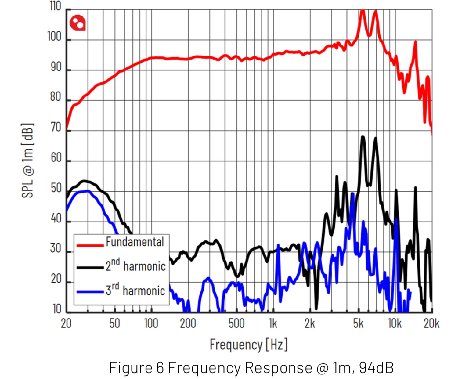

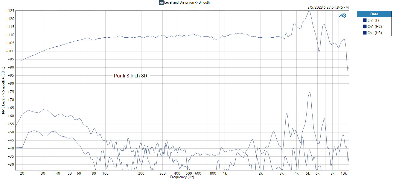

Okay,
25 degrees C, Pressure near sea level, APx555 analyzer, APx1701 transducer test interface (amplifier), AP500 software + acoustic package. 2.83Vrms output to the speaker and the microphone was placed about 250mm from the dust cap. The speaker was installed in a sealed enclosure about 28L.
The microphone was placed "near field" to minimize room effects.
