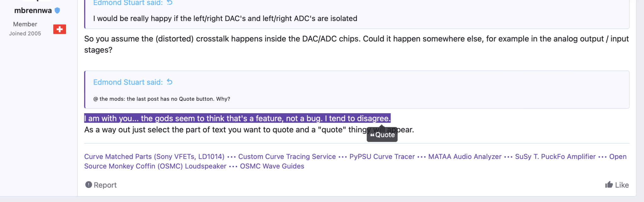

@ the mods: the last post has no Quote button. Why?
I am with you... the gods seem to think that's a feature, not a bug. I tend to disagree.
As a way out just select the part of text you want to quote and a "quote" thingy will appear.

Probably because the moderators don't want you to hit the quote button and quote the last post in its entirety. You can always select the text you want to quote. Then a little Quote bubble shows up. Click that and you get to have your quote. Like this:
