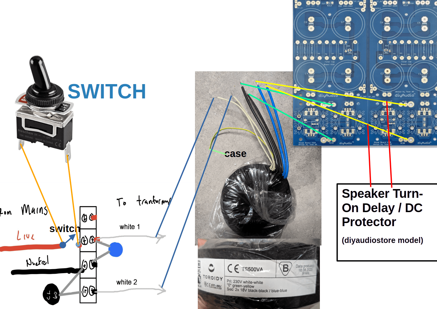

Hi, I will soon start assembling my Aleph J.
  • Is the switch in a correct position ?
  • Are the 18V outputs of the transformer in the right place on the PSU? Can the 2 black wires be interchanged? Blues too?
  • Is the speaker protector circuit properly connected?
Joined 2014
1) The switch is good.
2) the secondaries look good. I assume one secondary is black-black, the other secondary is blue blue. You generally want to wire them in phase with one another.
Set a multimeter to ohms. if the circuit is closed (you get an ohm reading) between two wires, then you have the wires for one secondary. If you get an open reading, then you have the wrong two wires.
Typically you have four wires in a row. Say Black1-Black2 Blue3-Blue4. Black 1 would be the start of one seconary, blue 3 would be the start of the second. This will help you get them in phase. The way you have the lines drawn should put them in phase.
3) I do not know about the DC delay as I like to live my life in fear. The two lines would read around 18vac with a voltmeter.
