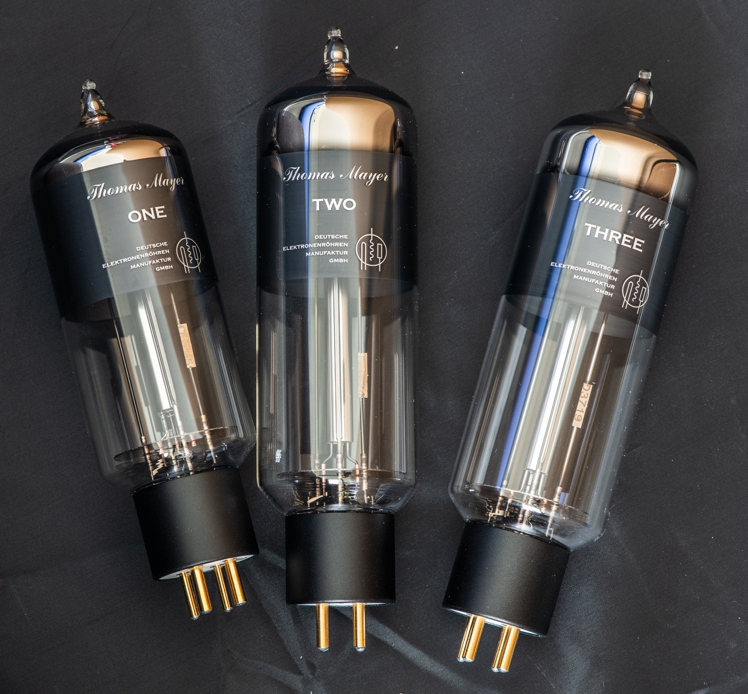

Thomas Mayer has just released 3 new tubes, One, Two and Three with cylindrical plates. He makes a case for these sounding better.
I've read this opinion before, e.g. from directdriver -
"I find round plate small signal triodes offer the most pleasing sound, e.g. Tungsol 6SN7 with round plates. So I try to use 6J5 or 27, 37, 56, 76, 6P5 whenever possible at a much cheaper price. I always go for cylindrical over flat plate so two 6J5s instead of one 6SN7."
I also use 27, 37, 56, 76 as small signal tubes so no argument there. But I can think of many superb tubes like 10Y with flat anodes.
So what's the truth in this?

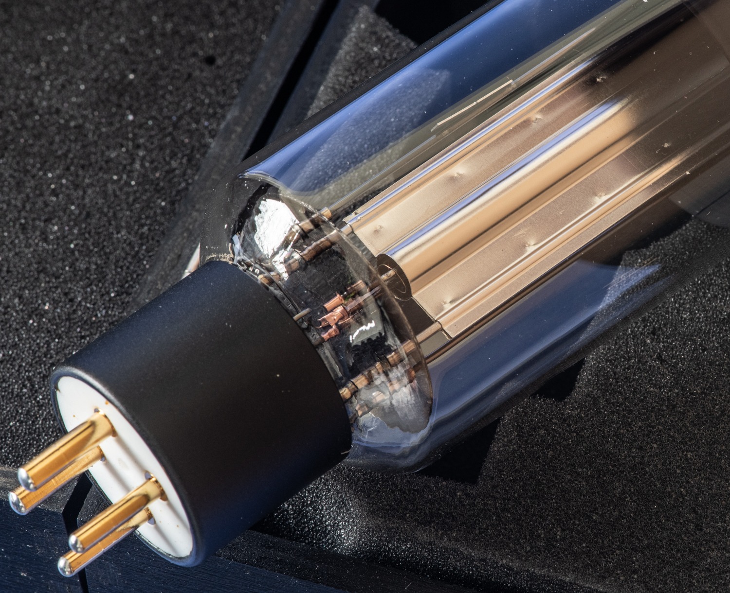

From Thomas Mayer
"They have a single filament string in the center of the tube which is surrounded by a cylindrical spiral as grid and everything is surrounded by a cylindrical anode (plate). The anode has some added side wings for heat dissipation.This arrangement results in exceptional linearity and unsurpassed sound quality which make them the tubes of choice for the Intrepid series. These new tubes will be on demo at the Munich High End. Come to Hall 2, F06"

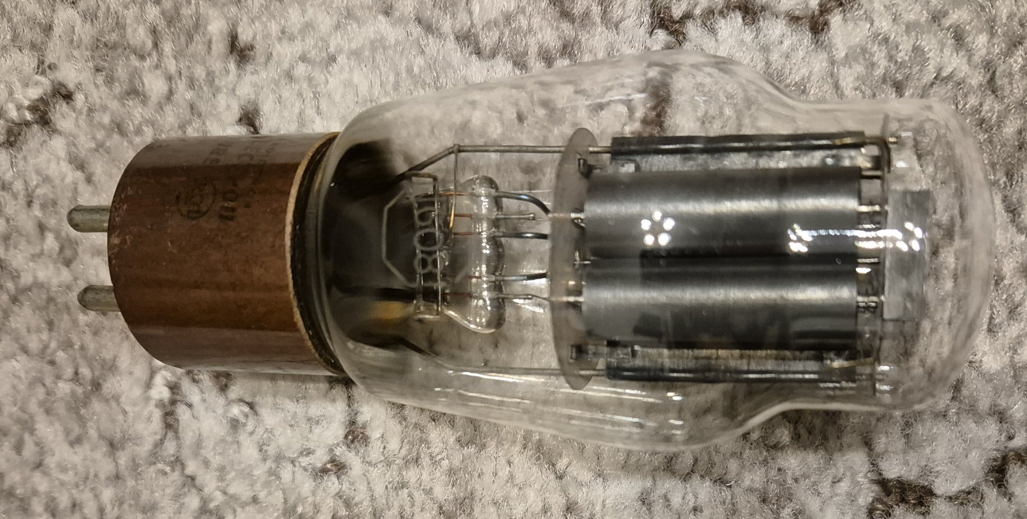

Most tubes have flat cathodes and box shaped anodes, with the long side of the anode equidistant from the cathode, and the grid wires are wound around the posts that fix the anode plates. The boxy structure creates a lot of parallel surfaces and the grid wiring is accurately positioned in that space. But thinking about it, the grid wiring is oval in section, so that could be the reason frame grid tubes are sought after.
If you have a round tube, to achieve the same accuracy it would have to be a cathode tube that is centralised perfectly in the anode, and how is the grid wiring going to be done so the winding posts do not impact the symmetry of the inside of the anode tube?
A lot of diodes have cylindrical anodes, so perhaps the grid wires are the complicating factor?
My feeling is that if there was a benefit in some way with cylindrical anodes that could have been used to gain a competitive advantage in the golden age of tubes, then there would be more examples.
