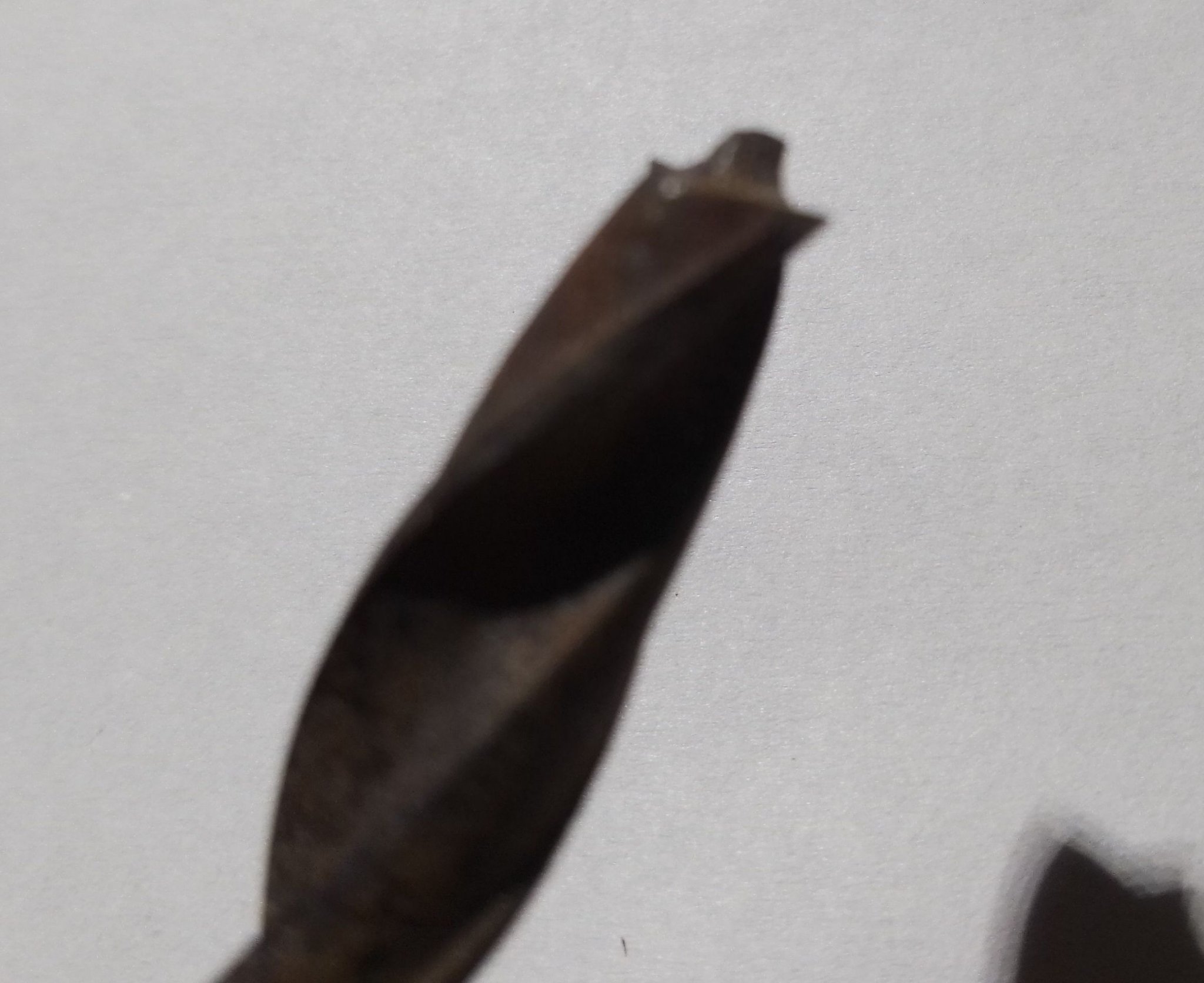

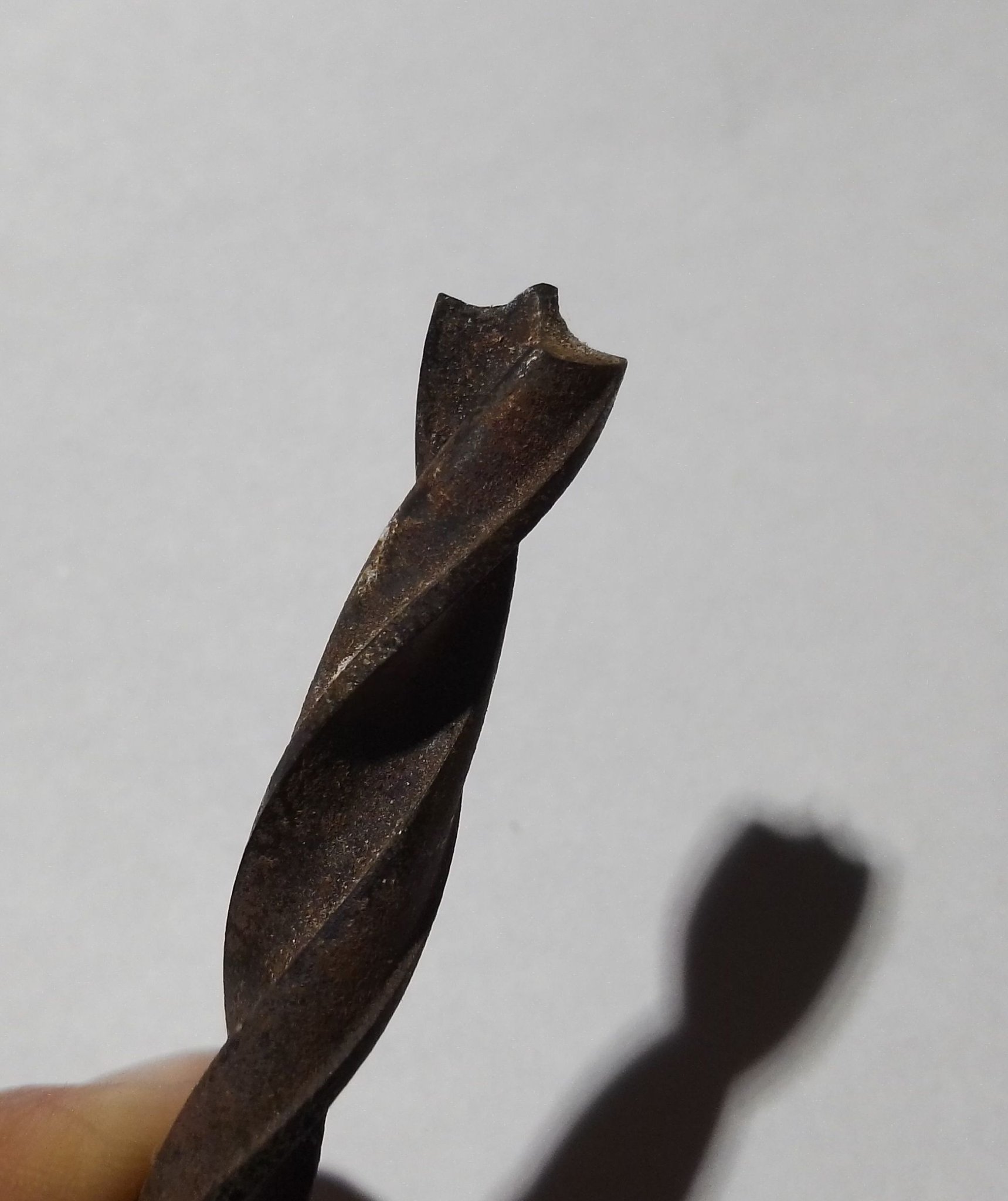

THAT.View attachment 1303118 If you sharpen your drills like this you shouldn't have any problems drilling thin alloy.

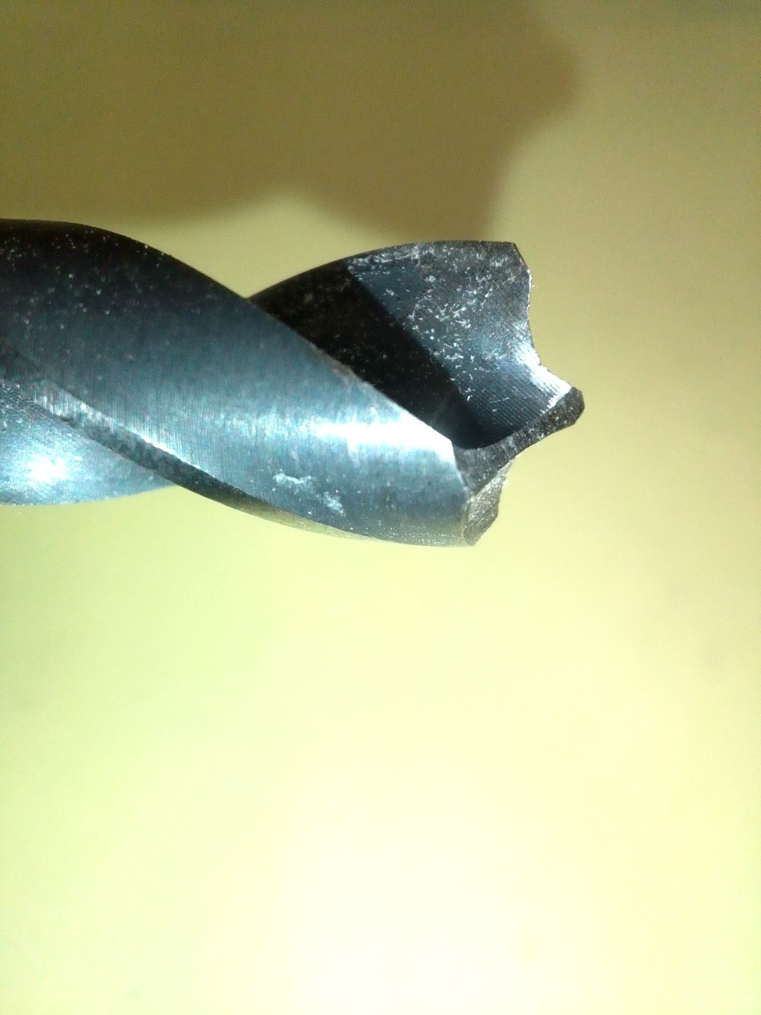

This is my own version.
Some details to make it work even better:
1) wing tips are in the same plane as the center "guide" tip.
2) wing tips are so sharp and pointy that they can draw blood if scratching skin, not kidding.
3) every cutting surface must be kept sharp
4) you can easily sharpen any drill bit (not too small, this one is 10mm) like this with firm hands, a Dremel wheel and practice.
5) with the dimensions I suggest tips actually cut *a disk" out of aluminum shert metal.
Too late now but can post an example tomorrow.
Look at the wing tip angle.

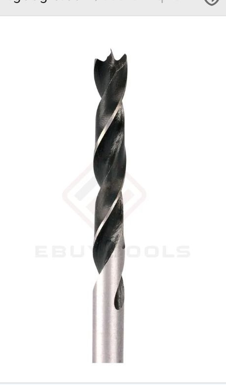

There are commercially made wood drills, but they are a bit "optimistic" because wood is soft after all and even if you use harder wood it disintegrates into "dust" or very small chips, while d*mn Aluminum is plastic and will give you very long sharf.
Cast and some extruded aluminum gives out small chips which is fine, but laminated sheet not only creates long sharf but also sticks to cutting tool, specially drill tips.
The angle I show, found experimentally, deals with that.
This is the "brad point" drill bit you mention.
Looks similar but the cutting angle is too steep, it tends to "stick" to Aluminum.
It bites too aggressively into somewhat "plastic" aluminum.

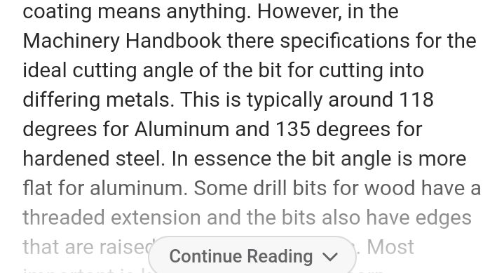

there are many alu alloys, some are much easier to machine than others. The extruded alu is usually ok. Drill bits for alu are different from steel. The top angle is much flatter. Cutting speed is much higher in alu. If the alu show a soft buttery edge it is not a really machineable material. Cobalt alloy based drill bits give some relief.
