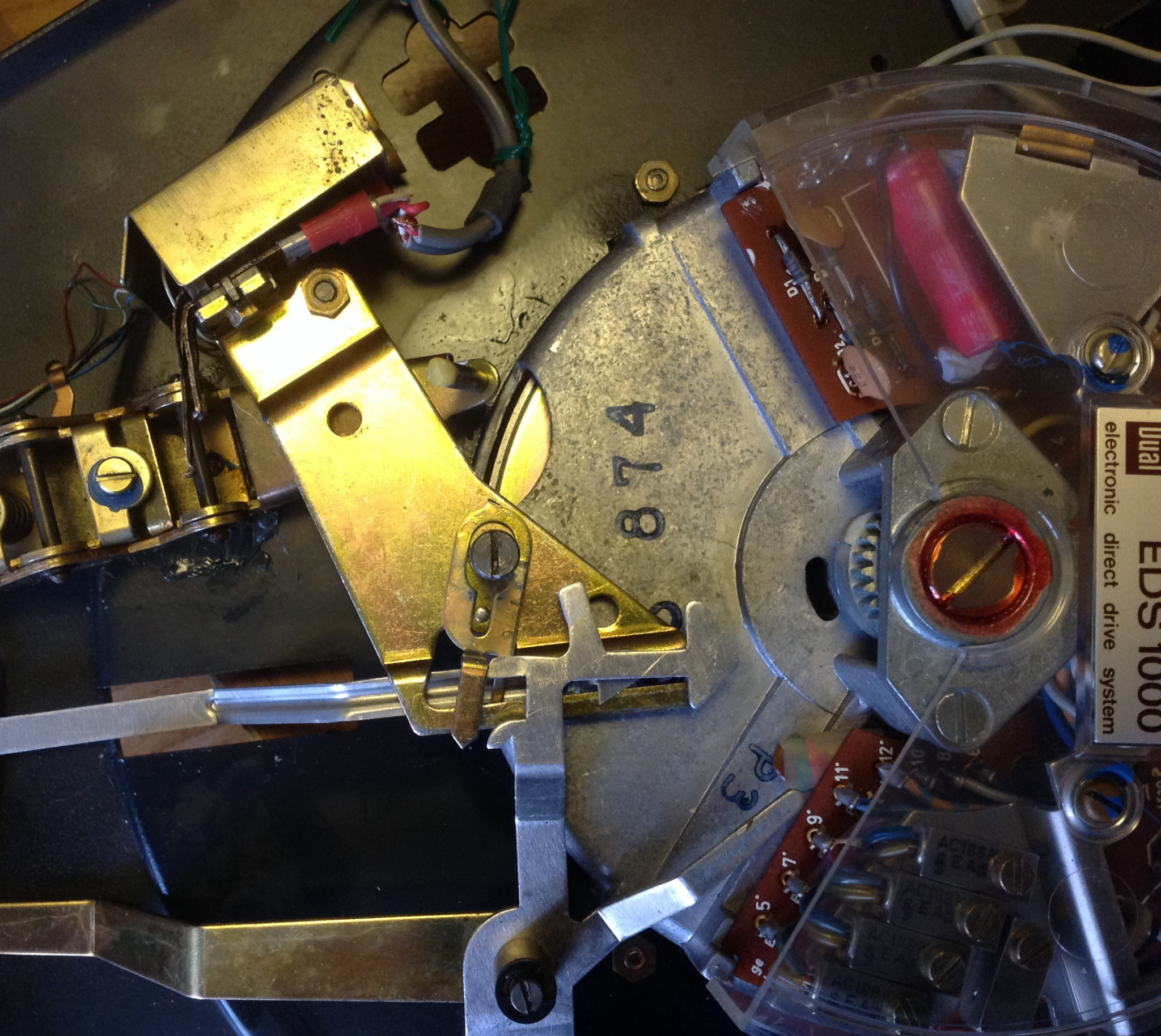

Servicing a Dual 701 turntable and detached the Cam wheel the wrong way.
Now I got these two small parts (#146 Pawl and #145 Tension spring)
And have no idea how to fit these. Service manual doesn't give any help, so do we have a Dual expert here?
I think it must be close to this, but where to attach the spring?
Any help appriciated

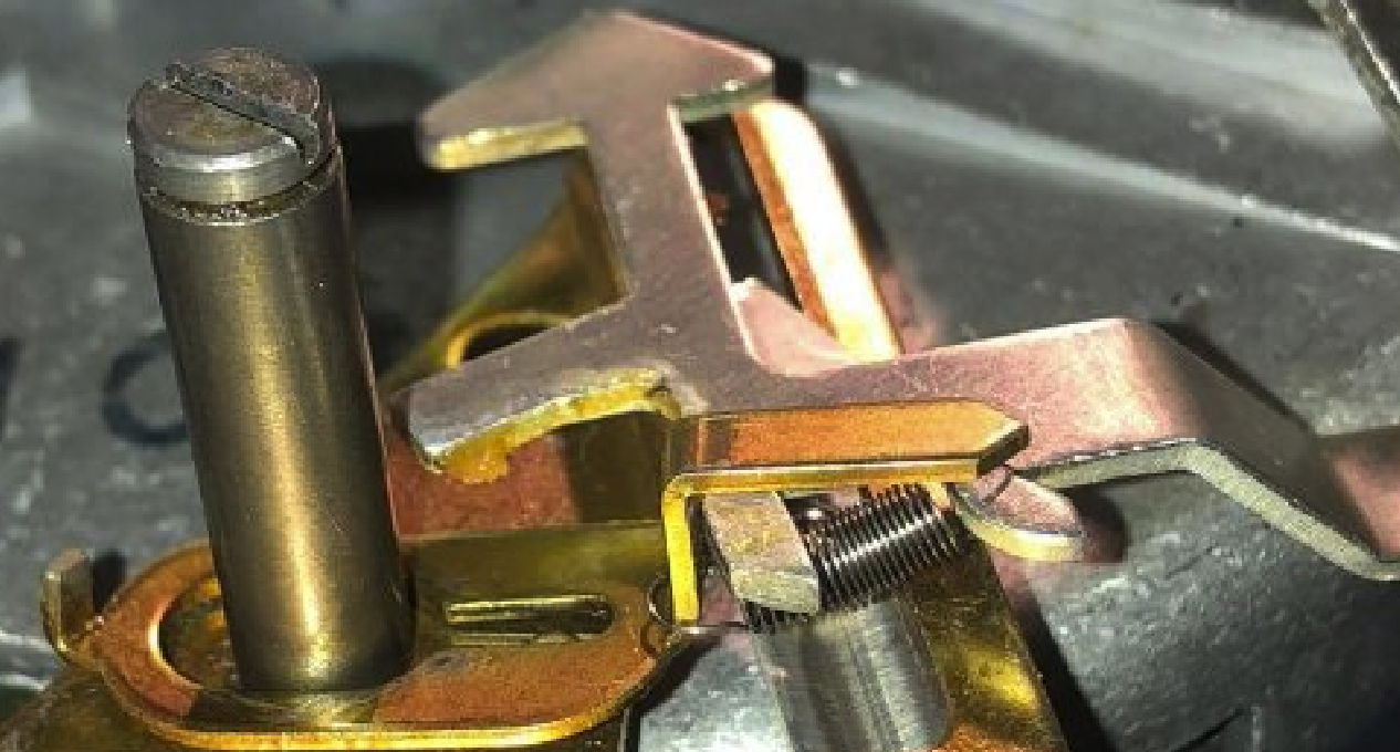

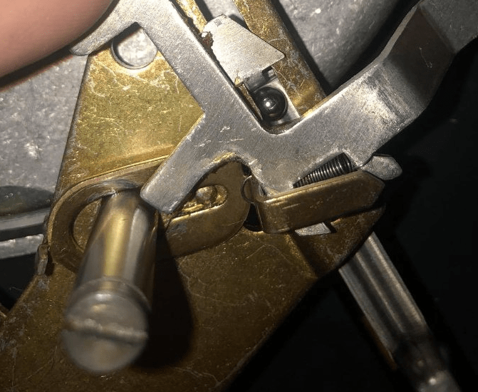

Can the following image help you in any way?
Edit to add: may be you can't see the spring, but it looks like that small part needs to be inserted upside down compared to your pic.
