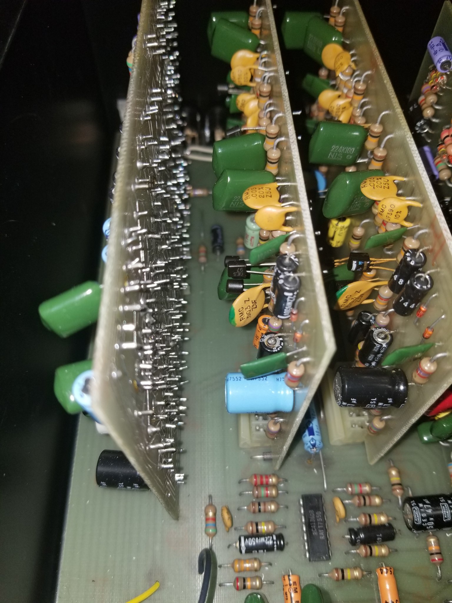

OK, some good news.
(1) I opened up the box and used some Deoxit on the switches, they work perfectly now.

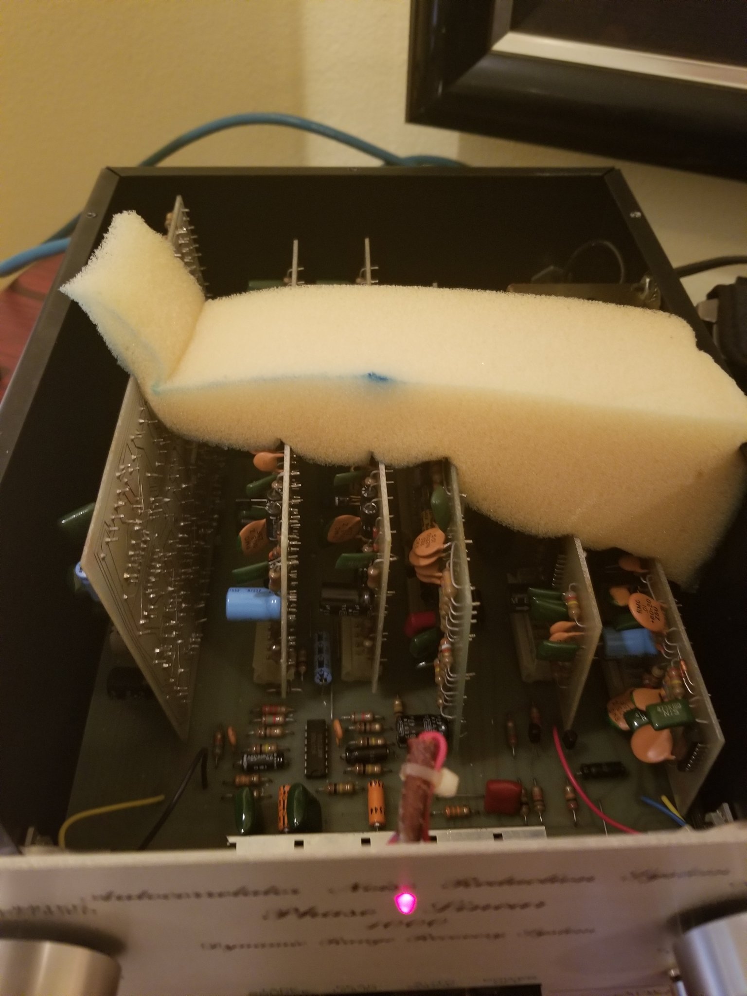

(2) As I was in it, I saw it is made up of a mother board with some plug in boards. The boards use old style -ie: large- plastic plug in connectors. The boards are kept in place with a sculpted foam block. I take it the factory was aware of the rather fragile nature of the connectors.
(3) The leftmost board, looking from the front, handles the expander. If I wiggle it the left channel comes and goes. So, I pulled it out and cleaned out the connector (which looked clean), it did't make much of a difference, so I think the issue is on the other side of the mother board.

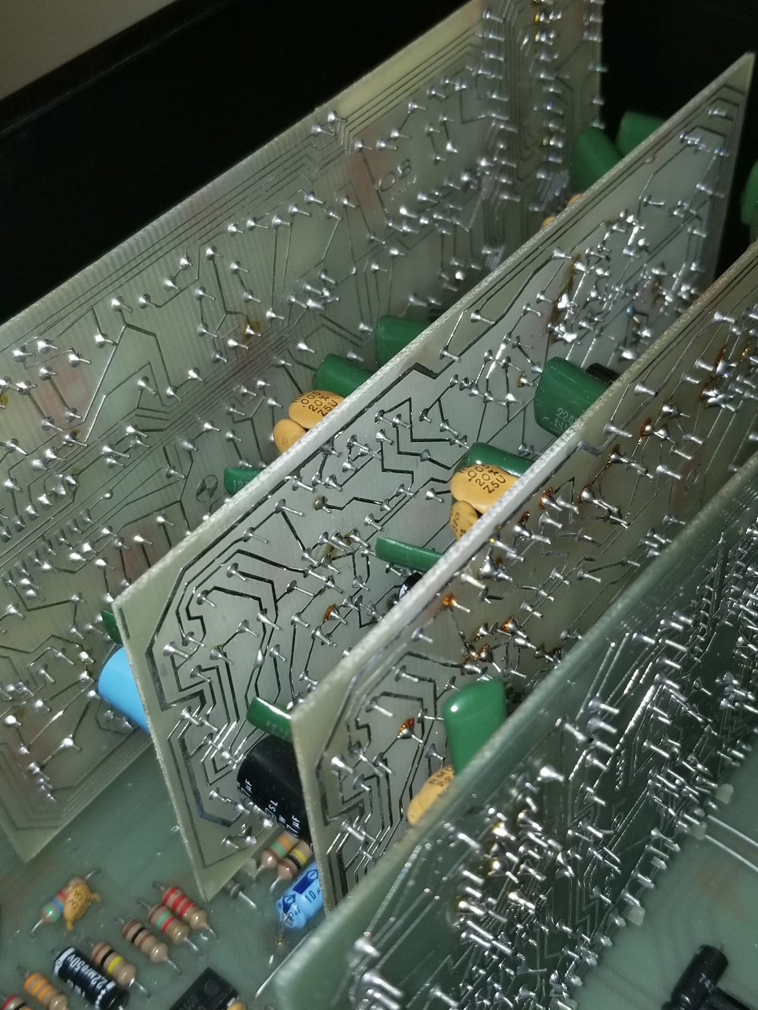

(4) The next two boards are the correlator boards... #2 is right and # 3 is left. I sent pictures to my guy and he replied "caps are really early Nippon Chemi-con and low density fiber circuit boards, Problem with those is low trace adhesion. Luxmand had that problem on early 70s stuff". He ought to know, he's a Luxman guru...
(5) Anyhow the interior is amazingly in good shape. So, I sort of played with the foam block to apply some sideways pressure on the expander board and closed it up. I'll take to my guy when he gets free time. I really don't want to mess with this thing. And it works.

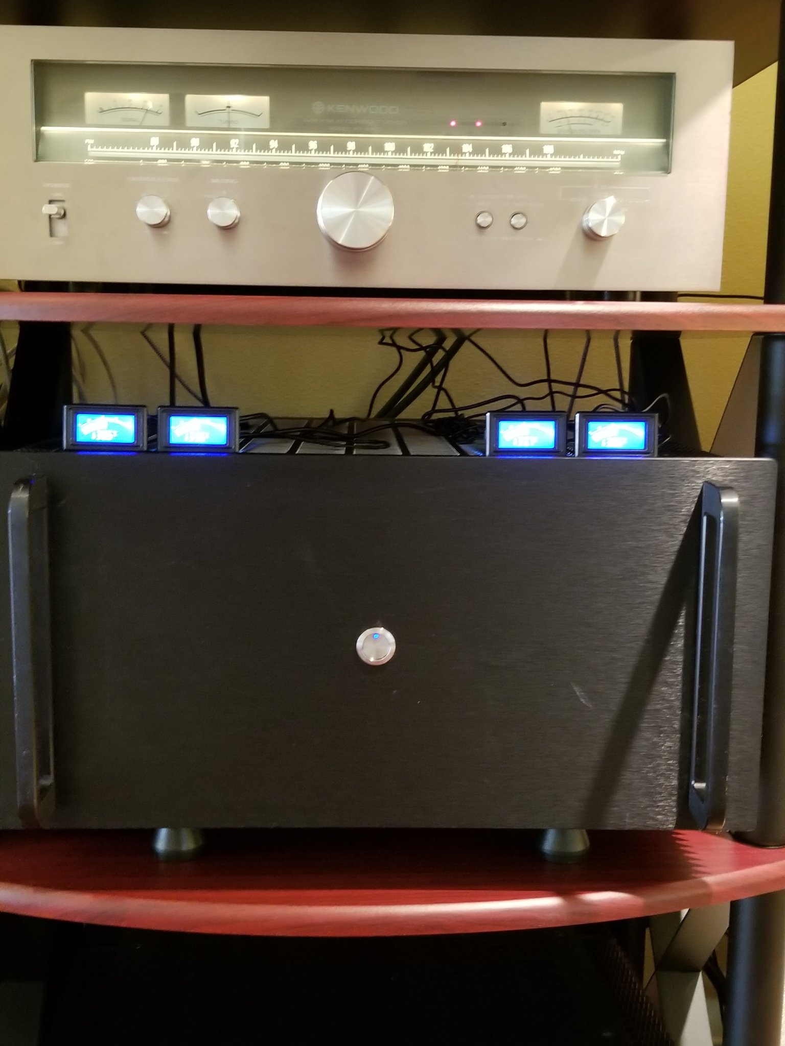

Here's the porno. The left most picture is how I left the foam so it puts some force sideways on the leftmost board.
