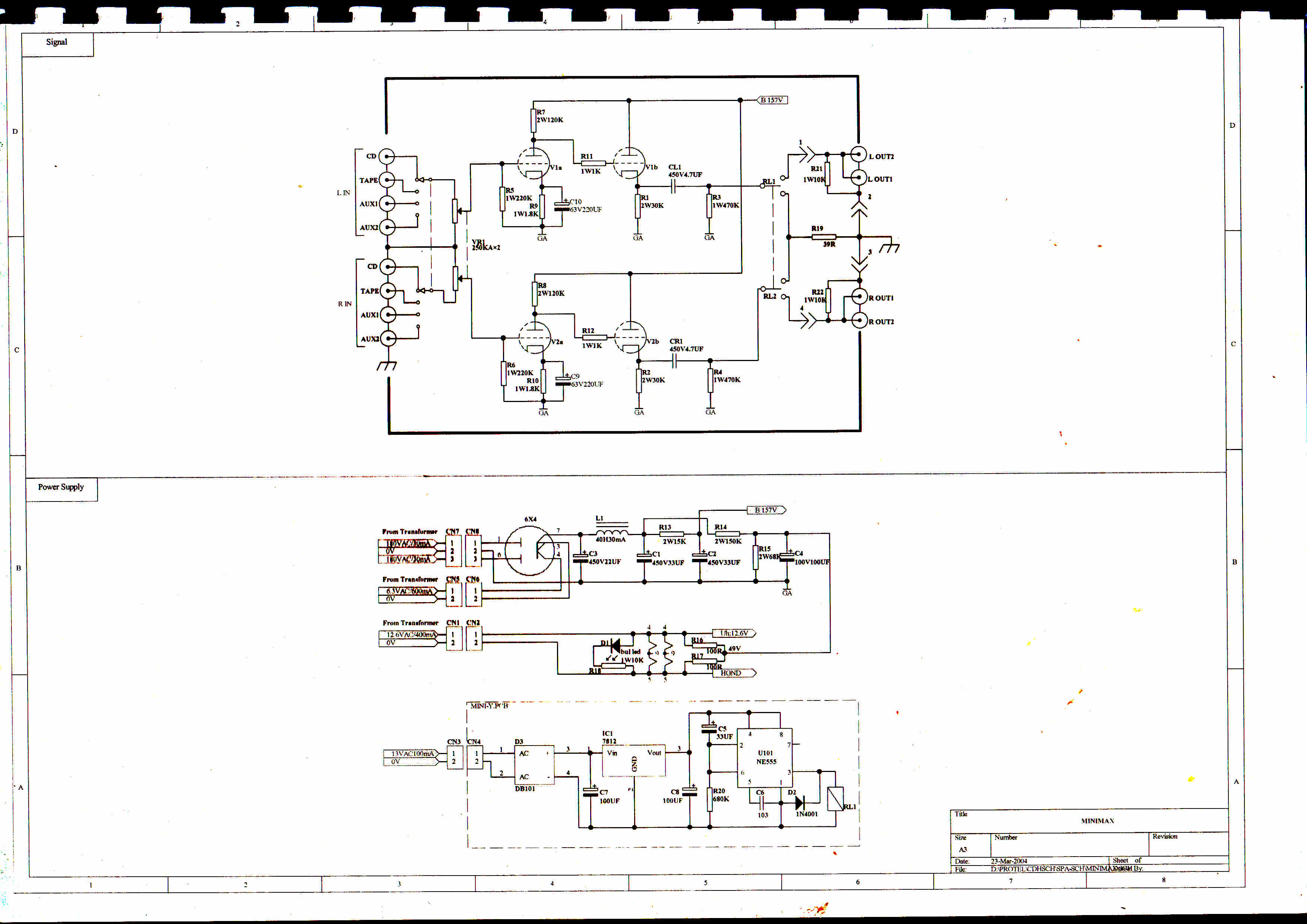

Hi Duncan. I have someone repairing or for me, who can repair it. It's just that a new mains transformer is needed, several of the wires are disconnected, and it's got a soft start circuit that is a bit different, and not the most easy to get at and see.
So it works be very useful and easier to confirm the transformer my repairer worked out we need wound, and work out the circuit. Trying to make his life as easy as possible.

Thats pretty simple and a light load for a mains transformer ,any thing else like the soft start is after the power supply or additional to it .
Is the soft start faulty or disconnected ?
Thats the only part that might need a circuit diagram as there isn't a standard one unless you buy a module on eBay etc.

Both correct actually.
Duncan has posted the max capability of the EZ90.
The Minimax requires 180-0-180 at around 20/30 mA though it will only consume around 6mA for the two '83's.
The problem is in the filament supply for the EZ90. In their infinite wisdom the transformer winding for the filament uses the same fine gauge wire as the HT winding, and has consequently burnt out. I expect this to happen on all of these preamps so be warned.
What's worse is that when it burns out it can then short onto the mains primary and then blows the leakage trip on your mains supply.
If you don't have an earth leakage trip then this could result in a fire. Hmm, very poor design.

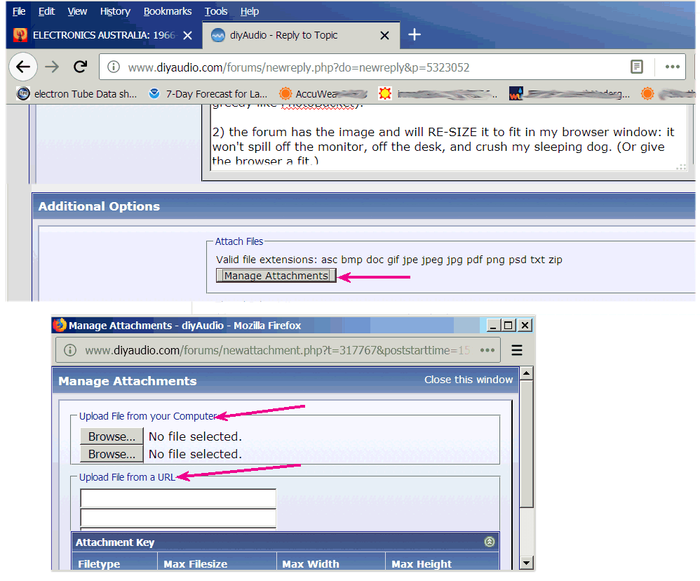

I have Linux and all I do if transferring an image from a webpage to a post is to-
Select all -hold and transfer .

How does one just paste a jpeg onto a thread? ...
JPEG is a poor (fuzzy) choice for line-drawings.
Hi. Found a schematic.
Just for the record for anyone in the future, Duncan, a slight correction to your figures.
The EZ supply 180-0-180. 6.3V @ 0.6A for the filament.
