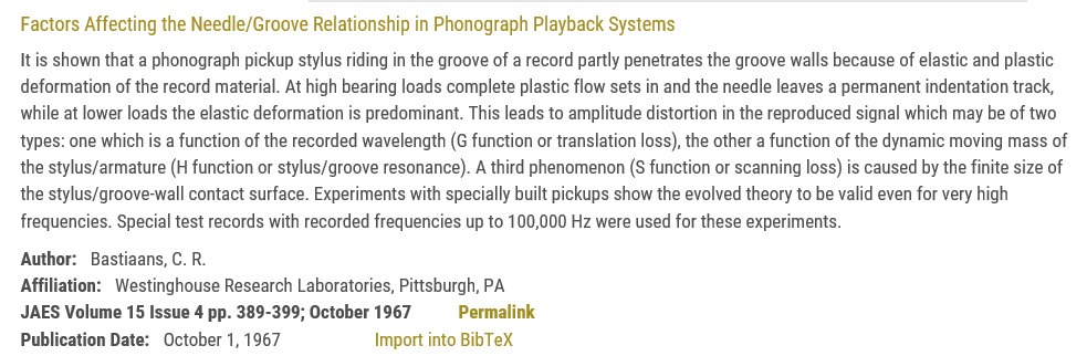

Bastiaans states in the intro: "At high bearing loads complete plastic flow sets in and the needle leaves a permanent indentation track, while at lower loads the elastic deformation is predominant."

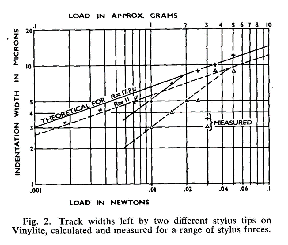

From Bastiaans: An important detail is that the "slight permanent indentation" seen is made using a spherical stylus with a relatively small contact patch, which applies a much more concentrated force than a line contact stylus like Shibata.
The Shibata was developed just because of the wear observed from elliptical styli when developing CD4, in the years just before 1970. In order for an elliptical to track CD4 45khz, exceedingly high VTF was needed, and wear was too high. Shibata improved that a lot, and today several line contacts have equal or even greater contact patch compared to Shibata.
A MicroLine tracking at 2g, for instance. It's contact patch is much larger, as is the radius of the same patch. (Or even at lower VTF, like T4P standard 1,25g.)

Permanent deformation
Bastiaans applied a very thin soap film to the groove wall, played a record and inspected after playing the wideness of the trace where because of permanent deformation caused by plastic flow the soap was scraped from the groove wall. With a 17.8u and a 11u round tip, above 2gram stylus force, theory and practice where perfectly in line and confirming the indentation., a formidable mathematic prestation.
Below 2 gram stylus force the deformation slope did suddenly deviate from the prediction maybe because of a surfboard effect according to a suggestion from Walton.
With a 17.8u diamond and 2 g force, stylus pressure becomes 4.8e4 psi, where the yield point of vinyl is 1.4e4 psi, so permanent deformation because of entering the plastic state was to be expected.
With a Shibata or Line Contact Stylus, the pressure or force per square inch becomes much smaller, so most likely with these more modern styli, deformation will be much less with 2 gram force.

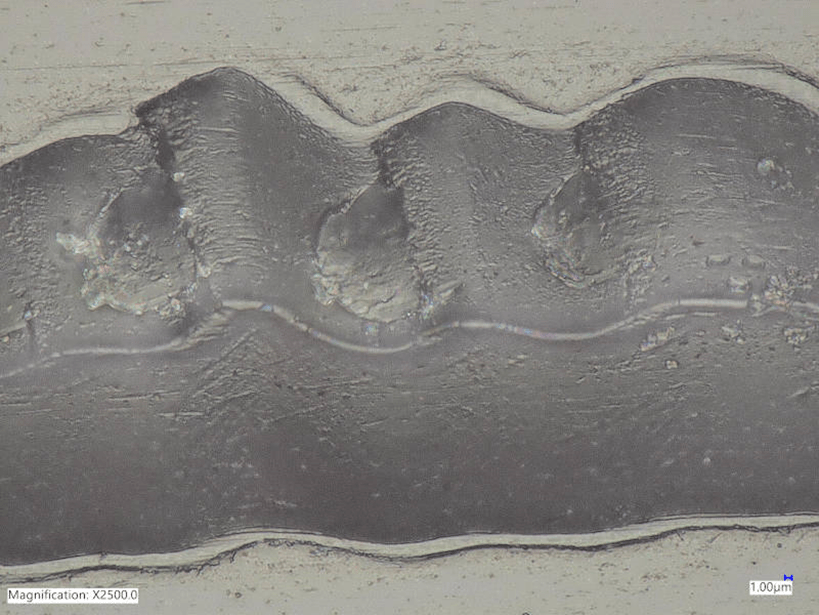

Mis-tracking
The earlier mentioned effect of mis-tracking, or stylus loosing contact with the groove, will be followed by a hard landing back into the groove.
According to F=m*a, the pressure on the vinyl because of the huge acceleration force may exceed the vinyl’s yield point, resulting in permanent deformation.
An excellent example is given in the photographic image below, taken with a Keyence VHX-7000 microscope, from a brand new LP played after multiple playings with a Grado Cart with a tracking force of 1.5gram. Stylus shape unknown, but looking at the indent’s shape, most likely a round tip.
The LP in question was Pink Floyd's Time from Dark Side of the Moon
Permanent damage caused by mistracking

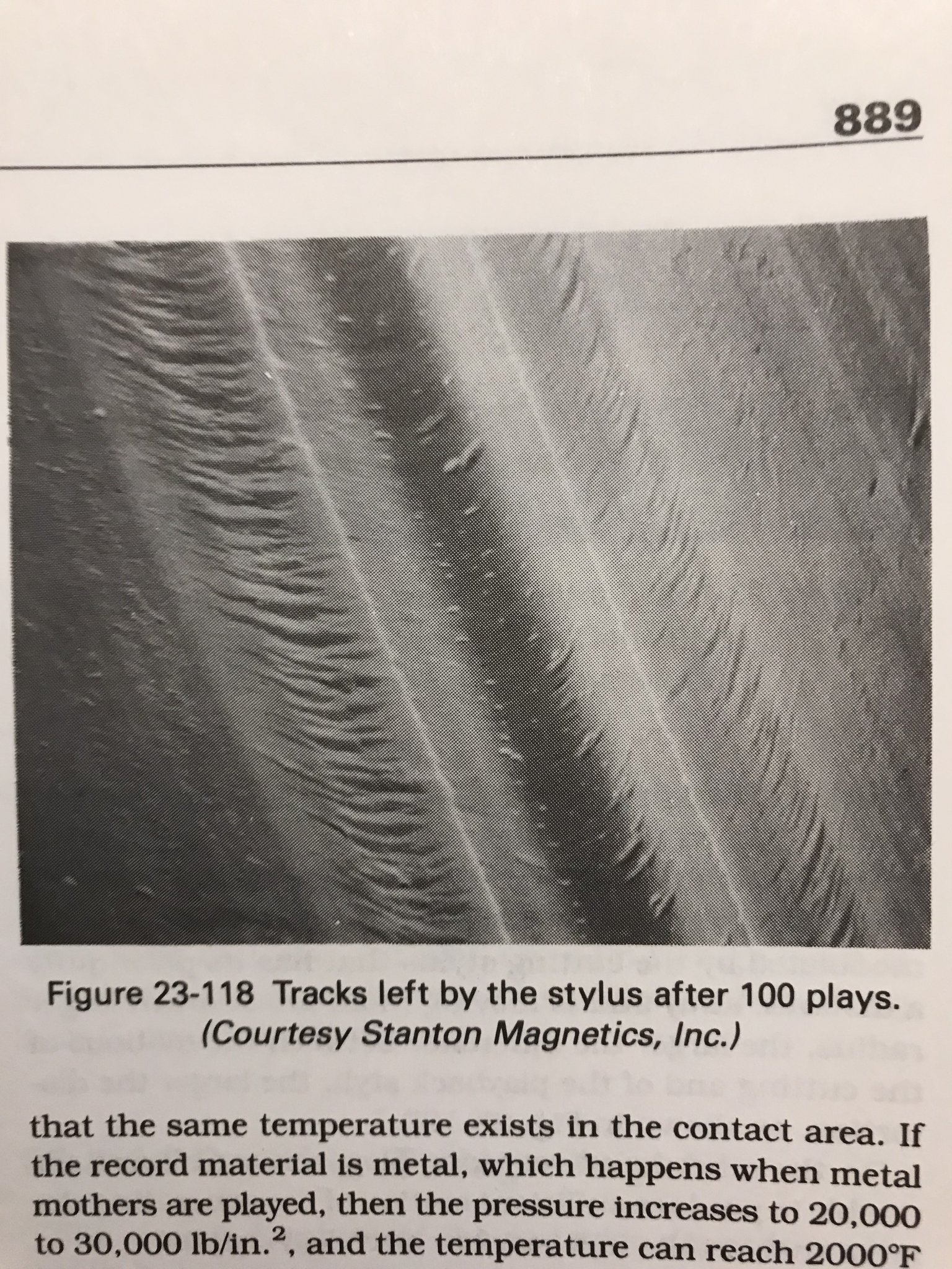

I'll scan the photo of 100 wet plays of a vinyl record, where heating isn't allowed, and post it here tomorrow. The damage is quite dramatic, and the explanation that melting isn't allowed in wet play seems reasonable. (Fig 23-118 mentioned above).
The issue of friction is more difficult. Because diamond's thermal conductivity is much better than that of vinyl we might expect heating from friction to be greater in the diamond than in the vinyl surface. But I'm not convinced that friction is nearly as significant for our purposes as pressure, whose effect is essentially all in the vinyl.
Still wary of analogies on our human scale.
Much thanks, and all good fortune,
Chris
