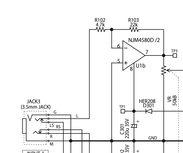

Hi paczeltf,
I have both the TU-8150 and TU-8800VK. I had used both to drive my Sennheisier HD-650.
The op-amp in the 8150 can be removed as the feedback resistor will act as a signal path to the grid of the 12AX7 driver tube. I had removed the op-amp since day 1 and used it to drive my HD-650 as a desktop amp in my study. More then enough power to drive the headphones as my source is a DAC with full 2V output and low impedance. For purists, one can connect the input directly to the grid of the 12AX7 but I don't want to sabotage my amp.
The 8800 has a much better bass likely due to the bigger transformer (I did upgraded to Lundhal transformers and the output tubes are still 6v6s in UL mode).
Overall I am happy with the 8150 as a headphone amp. 6V6 is a magical tube, with sonic characters very similar to low power DHTs.
I post the cropped section of the schematic of the 8150 showing the op-amp section to illustrate my point. I think this is fair use and should not violate copyright.

Joined 2018
This thread raised my interest in this amp again. I have ordered one of the remaining units from Victor. I will build it without the OPAMP stage except for the smoothing capacitors that can be used in the DC heater, as I do not need the 2x additional gain from the RCA input.

As I wrote earlier in this thread, I would order one of the remaining amps from Victor. I have built it since then and also redesigned even more than the TU-8200, but I thought I would not add any comments here because it is discontinued. Now that it came up again as a recommended product, I am afraid I need to add my concerns. With all respect to Elekit, the simplification of the circuit in this low budget amp went a bit too far, some of which has serious, even potentially lethal consequences.
The unit has an IEC C type power socket, which has no ground pin. It is fine with plastic 12V walmarts, but certainly not with a mains powered tube amp with metal case, which has almost 300V all over inside. Other than that, the unit does not have a real fuse, just a PTC. PTCs should not be used as primary circuit breakers in mains operated units. This amp does not meet even the basic safety standards, and should not be operated without additional grounding.
The power supply for the OPAMP is derived from the DC heater of the preamp tube, and is rather noisy. This stage has about 1.6x gain from the line input. If your source can provide more than the standard 2V, then it can easily overload that stage. Turning down the volume does not help as the clipping happens before the volume pot. I build my unit without this stage in the first place, the input signal goes to the potmeter directly.
The 12AX7 is not meant to be a driver tube for power pentodes, especially not with 0.75 mA bias current. I was not surprised to hear that even though solo instruments sounded great, the sound became congested with complex music passages, even at low volume. I redesigned this part with 12AT7/ECC81, which now has a much healthier 3.5 mA bias current with a slight loss in gain. It still has enough gain from the line input.
The channel separation is rather poor at lower frequencies, because the simple RC filter being used for power supply hum suppression in the driver stage is shared between the two channels. (The TU-8200 has two separate FET filtered stages for the same purpose.)
The caps in the power supply are somewhat undersized especially with 50Hz AC voltage, similarly to the TU-8200.
I could work around most problems except for the safety issues, which would require cutting and drilling. The unit is now sitting on my bookshelf as a nice decoration with a pair of 6V6GTs from 1944 installed. I kept listening to my modded TU-8200.
