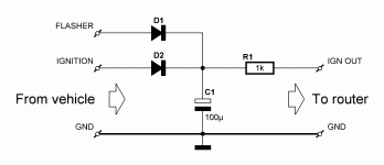

Mystery solved?
I remember asking the same question as the OP did, a couple of years ago. At that time I mailed the Swedish branch of Elector, "Allt om Elektronik", and its editor replied to me that the software used for schematics was sPlan from Abacom. I looked at sPlan briefly, but continued using Eagle at that time.
Now I have a different need, where clarity and readability has top priority. So this time I bought sPlan, and maybe it isn't as automated as modern EDA software, but it produces beautiful schematics. Mind though that the default symbol set needs a bit of tweaking before it mimics the Elektor set.
If anyone is interested, maybe we could collaborate on a "Elector symbol set for sPlan"? (sPlan of course supports custom symbol sets.)
I purchased this software way back then since the schematics were very close to the ones produced by Elektor.
I did not use it much since the version I have does not allow me to export to Eagle or any other software.
Thanks for sharing your findings!
