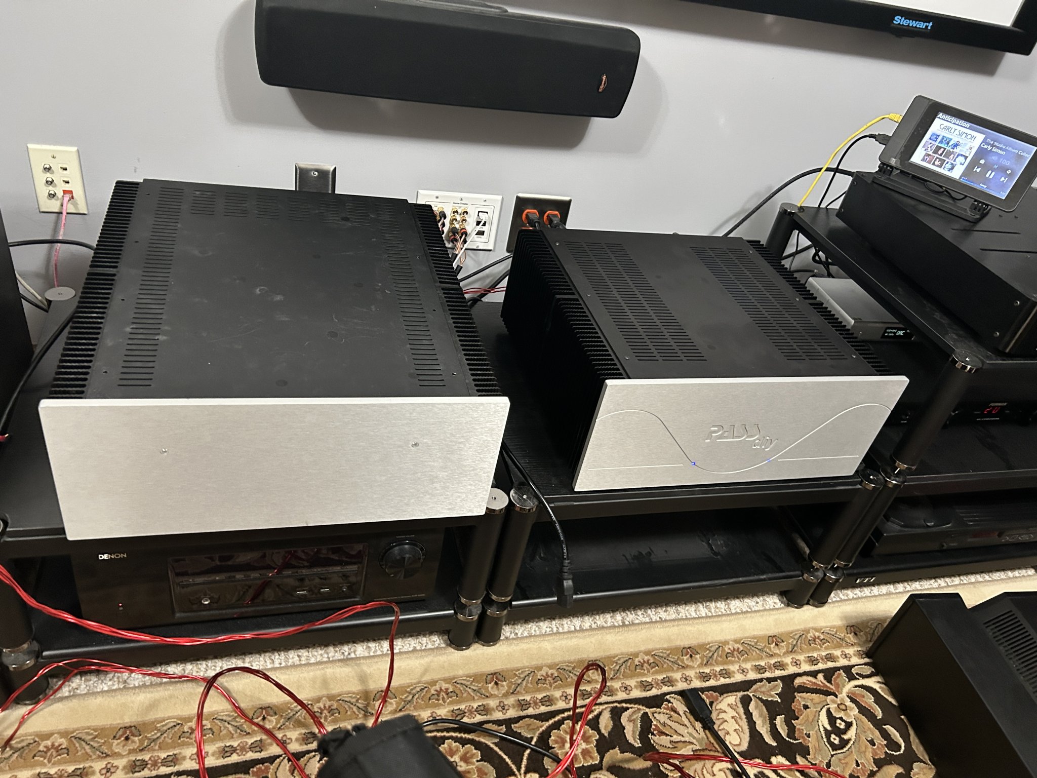

Couple of questions if someone can take the time to respond I'd be grateful!
1 - Has anyone done a listening test of this F5M against the Aleph-J? What are your thoughts? Differences?
This... to me... is about the hardest question EVER to answer, but I will try.
All the usual caveats apply... different ears (my tin ear), brains, SPEAKERS, rest of gear, audio memory sucks, etc. etc. etc.
I literally have the F5m (different PSU, which to me might make a difference) and a variant of the Aleph J sitting next to each other at the moment.
F5m was built with parts directly from the kit minus the PSU.
AJ is the upcoming AJzm for the store built exactly with the parts that will be included with the kit, but at a slightly elevated bias over "stock".
F5m had been in the system since ... about two days after it was launched give or take. A month or more?
AJzm has been in the system for two days and is verified to be working "as expected".
Months and months ago, I compared the AJzm to a "stock" built Aleph J using the current boards in the store, and I could not tell them apart.
To ME the Aleph reminds me more of ZMs Babel J2 (I know you didn't ask that but...) There's just something about it that makes the vast majority of type of music I listen to (classic Rock from the 60's and 70's probably really badly digitally mastered from the early CD era and/or remastered again to keep up with the loudness wars) sound welcoming and inviting and non-stressful. Non-fatiguing seems to get used a lot. I think that's apt. I also listen to a lot of metal and grunge from the 80s and 90s. Does it shine with some of the foo foo recordings as much as other amplifiers (like the F5m), IMO? No. It has a way of 'taking the edge off'. I have a particular song I use from Alisson Krauss where if I cringe, I know something likely won't work for me. She sounds like an angel. Some may want to have ultimate fidelity... and on systems that purportedly have ultimate fidelity, I cringe. Will I talk about imaging and dynamics, no. To me, using 3 sets of speakers for comparisons in a couple systems ... that's largely room and speaker dependent.
To ME, the F5m may just be the best bang for the buck I've ever built. I think I even posted earlier that it has "no right" to sound as good as it does. It's fantastic! It has a tad more detail, and better bass control with my 4R speakers (I think). To me... somehow it pulls that off while still being non-fatiguing. I really, really like it.
Is one "better" than the other. I truly and honestly don't think so. If I needed to jam all the time with 4R speakers... I might lean F5m. I like to jam, and I like my big nasty 4R speakers. Thankfully my neighbors like my music too most of the time.
Right now... I'm only on my second cup of coffee trying not to wake up wifey, and I've got a little Van the man moving through the AJzm. Lovely, lovely stuff.
I hope that helps... again... I sit in the same room with people and disagree with what's heard / perceived... so... :2c:
Build whatever you have the itch for... that's my solution. :joker:
Edited to add - Pic... added. F5m left (4U / 500 b/c it was sitting around and I wanted to run higher dissipation). AJzm right in the new super cool PASSdiy 4U deluxe chassis from Modushop. Yes... it's dusty... I've been moving a few things around... which is pretty typical. :rofl:
Reactions: 4 users
