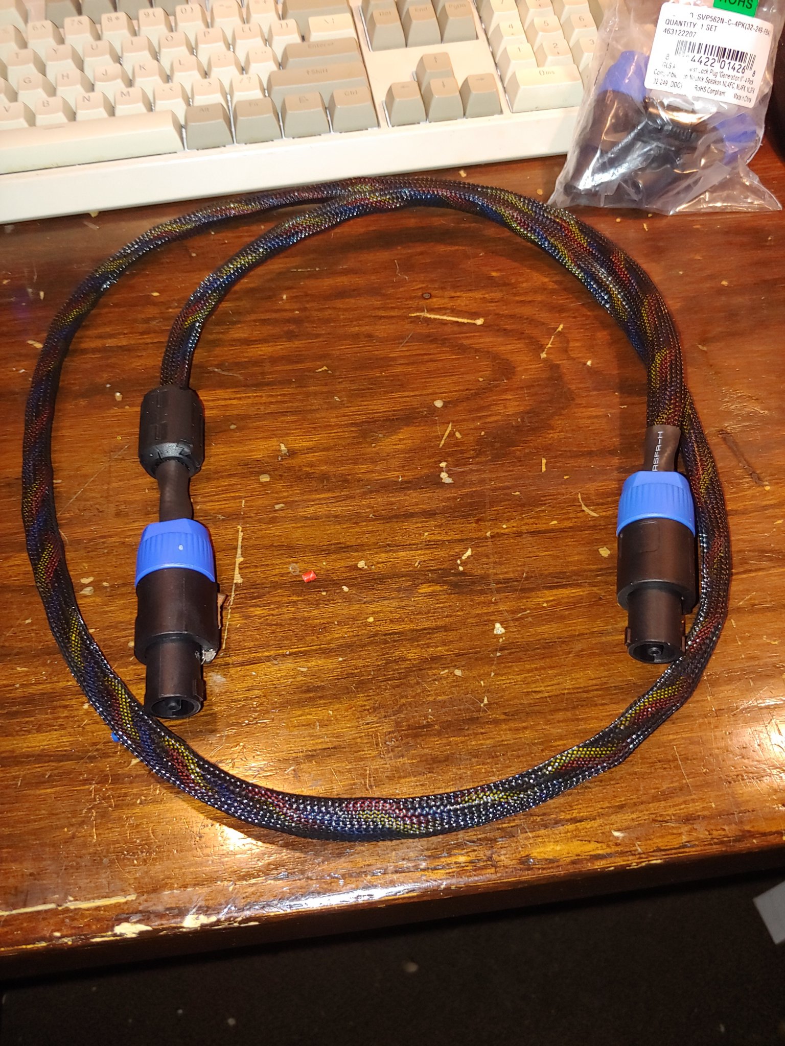

I built a 4 conductor cable with speakon connectors, then I checked it to make sure I had continuity on all four poles. then I installed the speakon chassis connectors in the PSU and the Amp chassis. In every single case I was only able to confirm continuity in 3 of the 4 poles. I was literally tearing my hair out for 2 days trying to figure it out. 10 different speakon connectors - all failed. I wasn't going to risk using them so I went for the hard wired approach. I have an additional order of some more speakon chassis connectors arriving this week which I will also test. There may have been a manufacturing defect in the ones I had previously purchased. I have been working with electronics for over 25 years and building audio gear for over 20 years and I don't put mains electricity into anything until I have satisfied myself that there is proper and safe continuity across the entire application. Especially for the earthing side of the circuit. We may be fearless amp builders but we are not reckless.
There a lot of SpeakOn fakes, are those original? Check the packaging, newer have a hologram on them.
I never ever had any defective Neutrik connector.
Maybe you can post the exact model you have got?

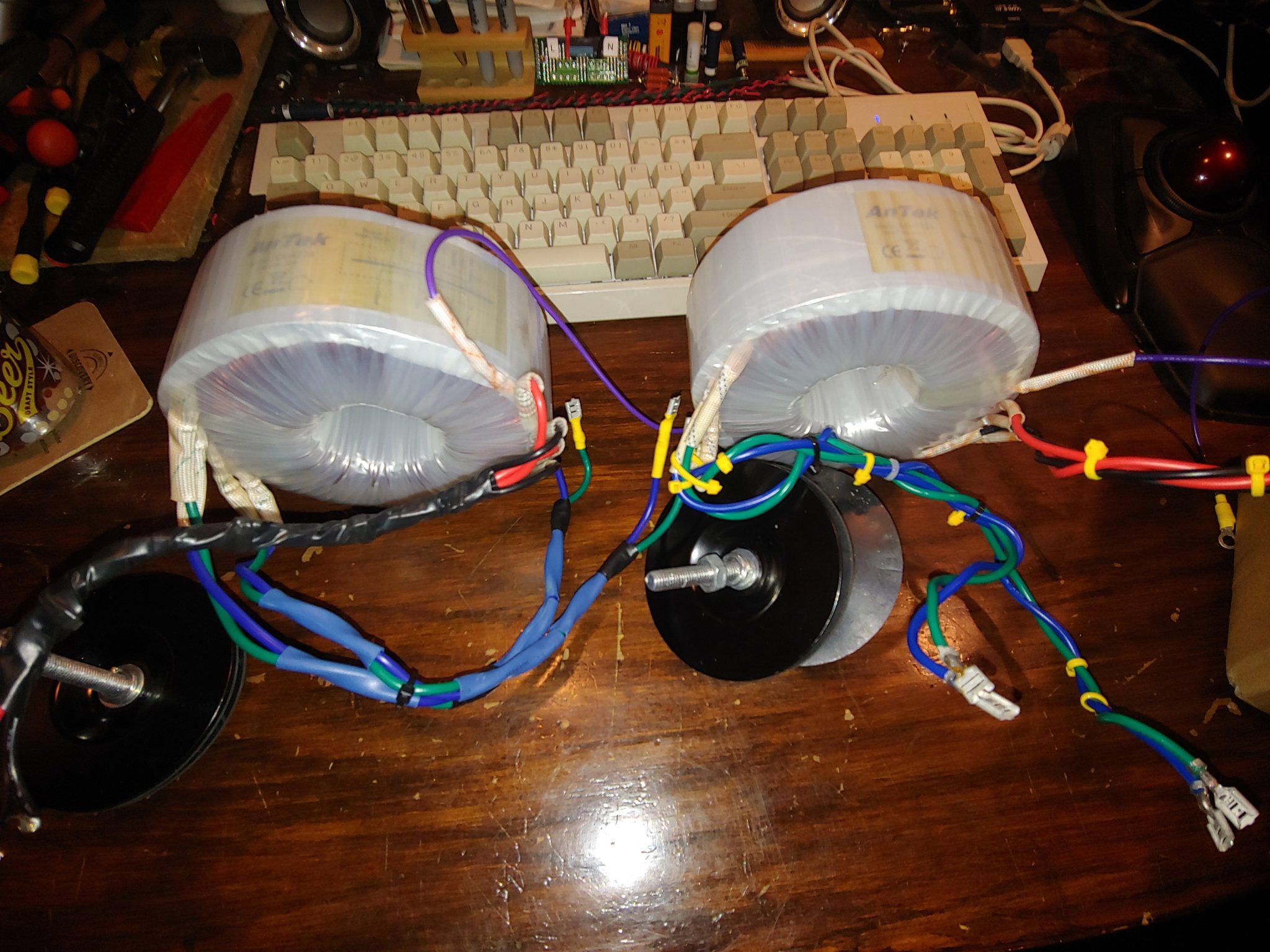

I was browsing through some Aleph J and Aleph 30 build threads on DIYaudio and I came across this: W12 dual transformer, dual secondary PSU from R Thatcher. So of course I've gone and purchased one. I am still game to try and get the PSU back inside the main chassis of my F5 turbo. The boards should be here in a few days. Here is a link to the DIYaudio thread where I read about it. Here is a link to the build guide for the PSU itself (it's a PDF download).

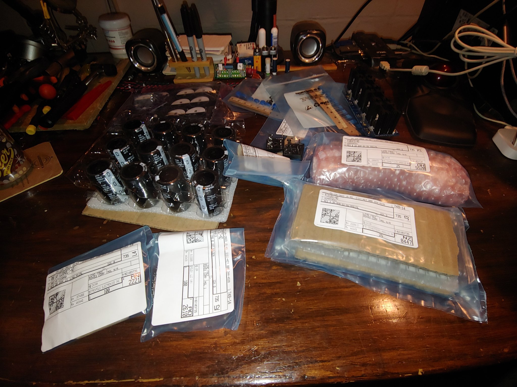

It will take me a couple of weeks to get all the parts needed (mostly the big caps) but then I'm going to build the PSU back into the 5u Chassis and see how we do. I'll keep the external PSU in reserve in case I can't get it to work.......

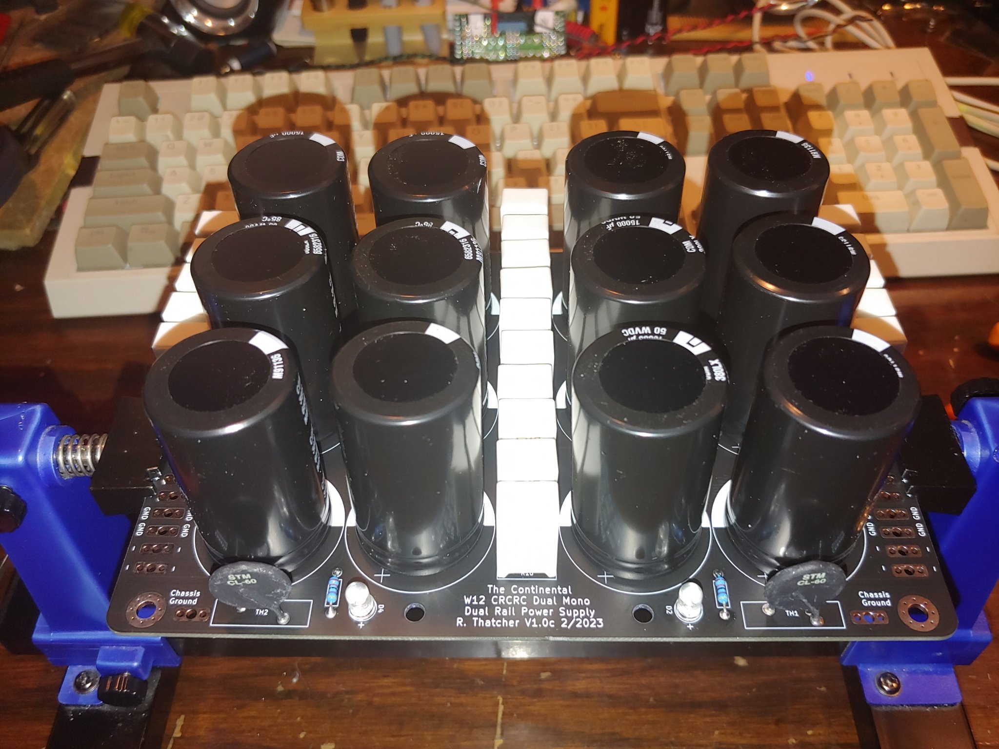

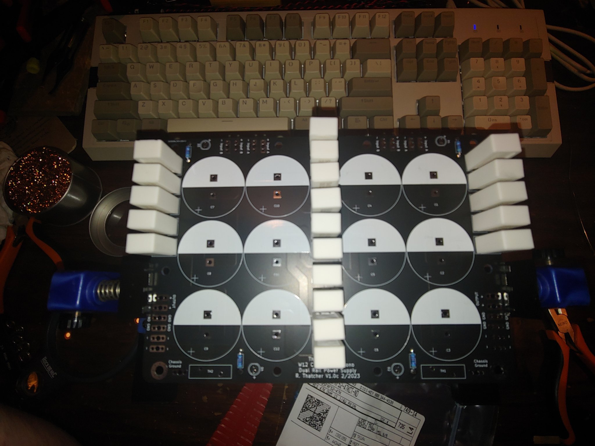

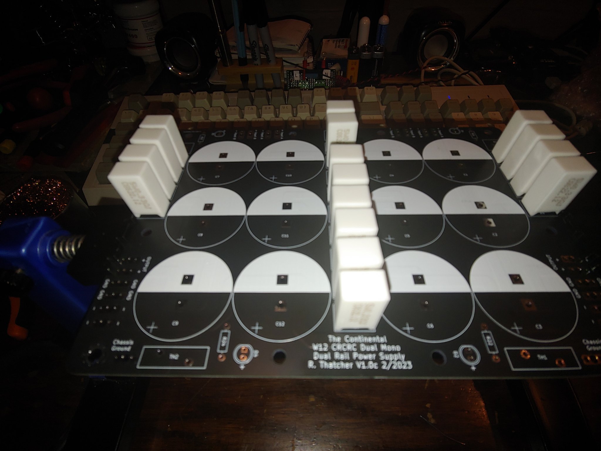

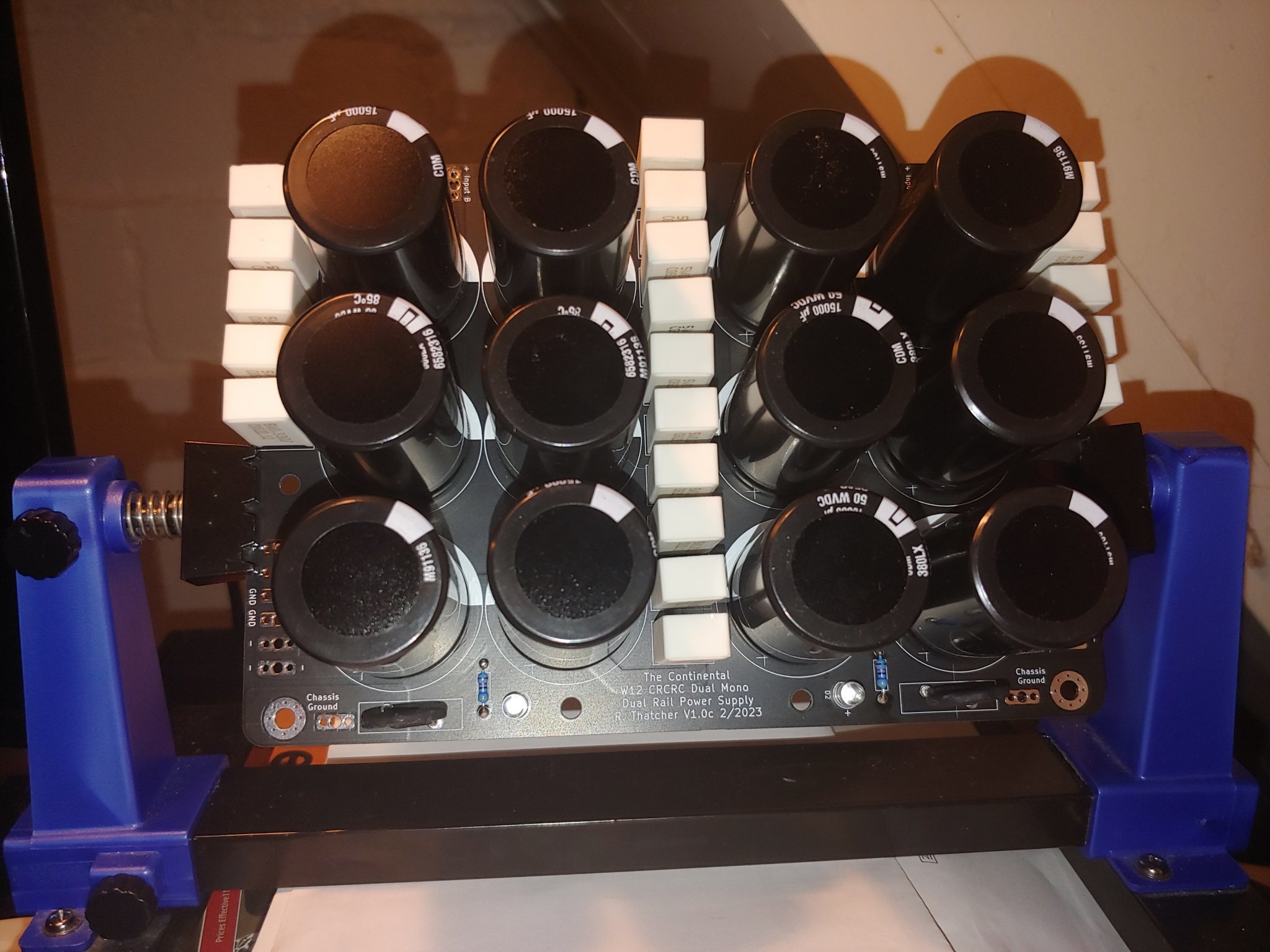

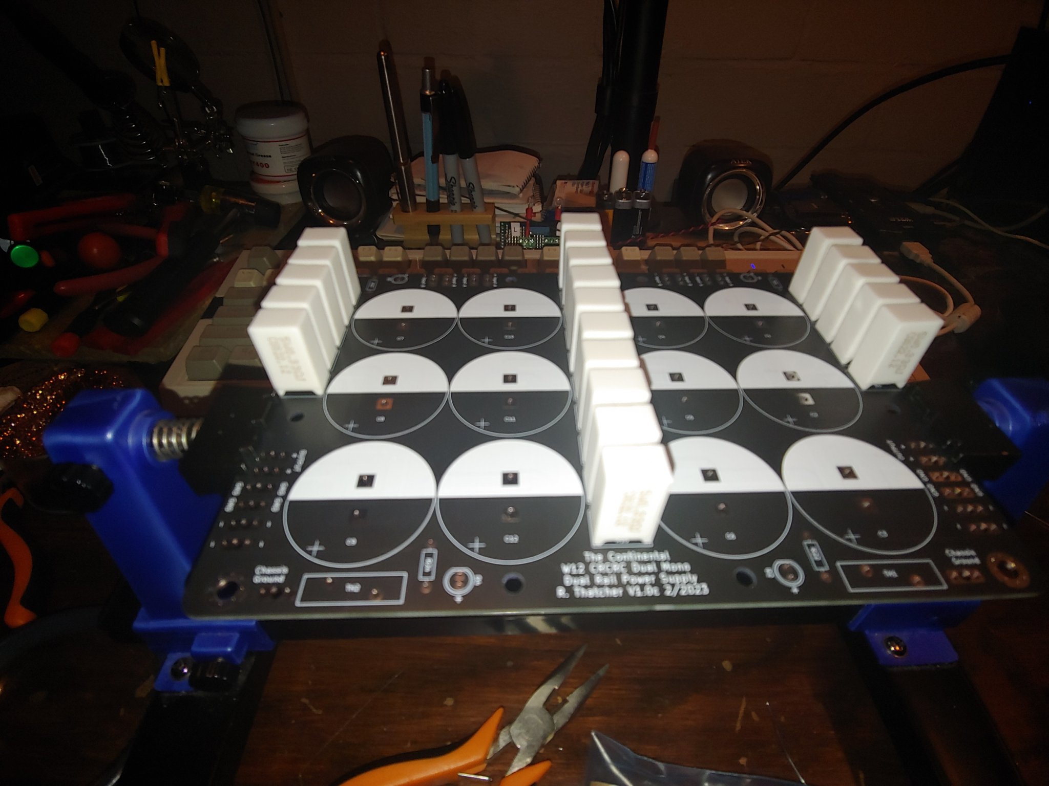

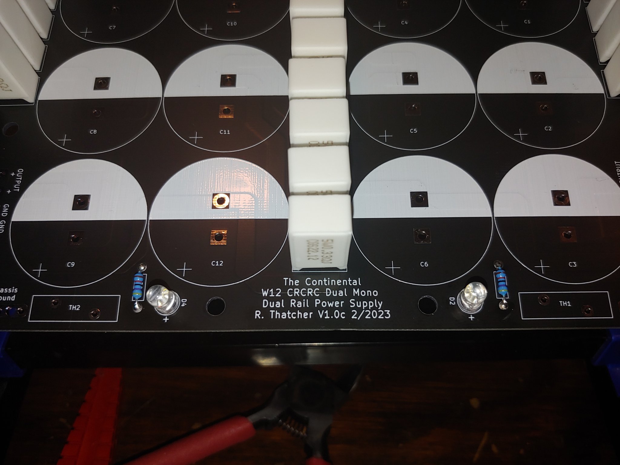

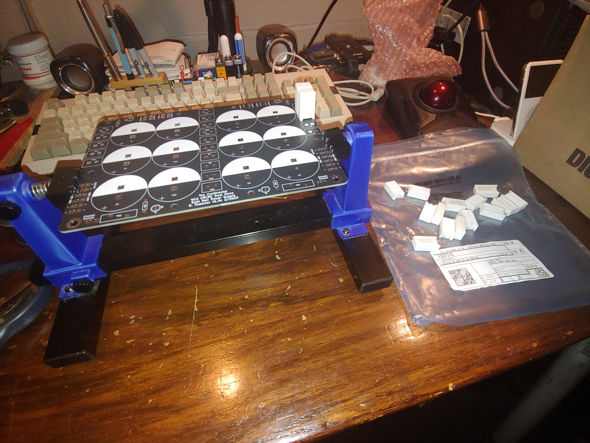

Progress update: I've stuffed and soldered all the major components for the W12 PSU. Photos included.
From Left to Right: Setting up the board for work, R1-16 installed, R17-20 installed, LED resistors installed, LEDs installed, Power capacitors installed.
I have a couple of other components on order so I'll be stopping here for now.
I went with 15,000uF for the capacitors. It gives a total of 180,000uF for the PSU. I think that should be adequate.
It may be an apocryphal myth, but I read once where a Rolls Royce engineer was asked how much power a Rolls Royce car had and his response was 'it is adequate'. I think that sums up this PSU!

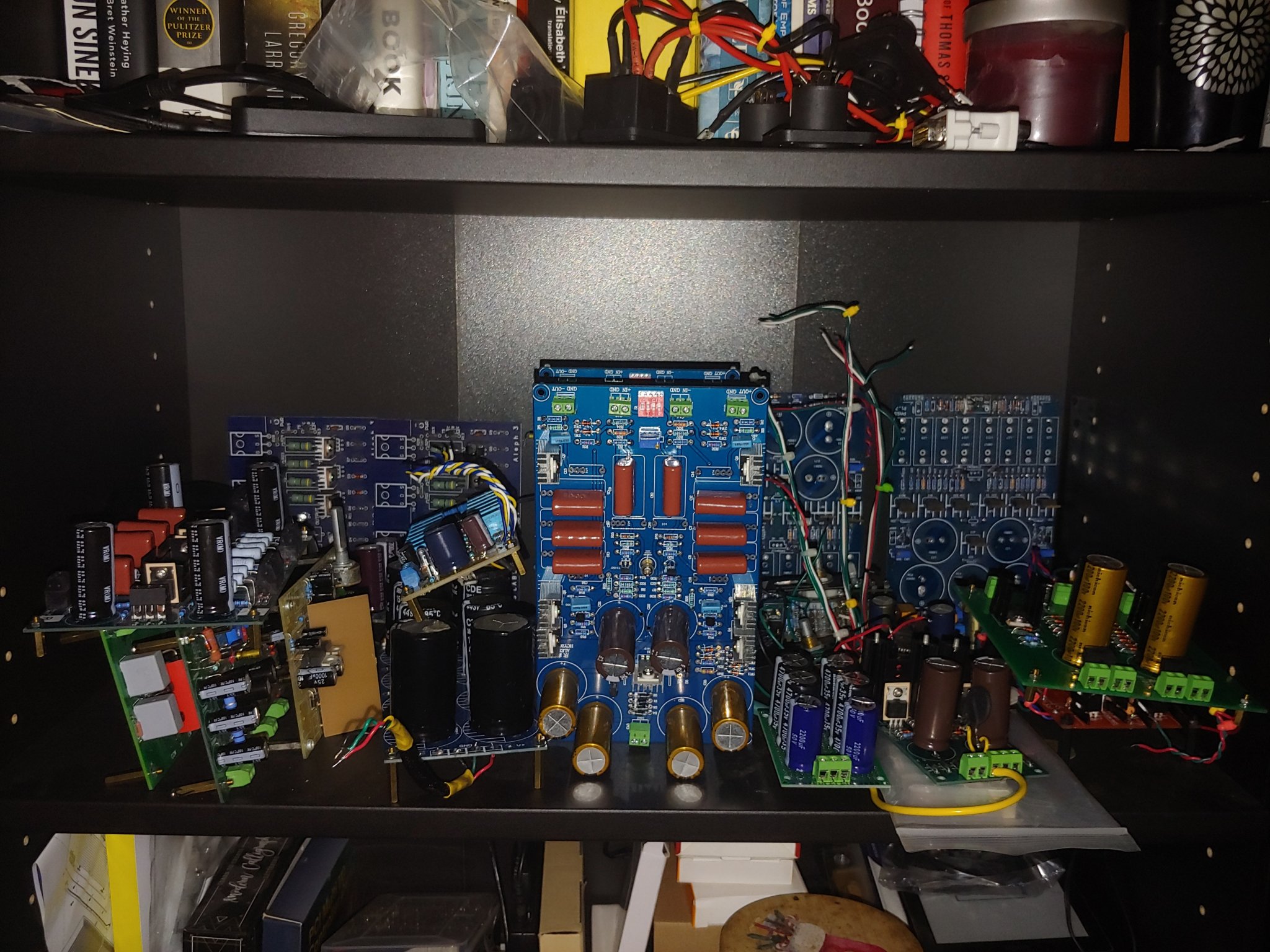

Just to finish and for Dirk's amusement here is a photo of my shelf of glorious previous projects...... Have a laugh.
B1 preamp, Ba Nutube preamp, Aleph P1.7, Aleph 3, various power supply experiments created for the Pearl 2 psu, the aleph P1.7 psu, many iterations of stepped attenuators, relay controlled input boards, there is even a couple of PSUs for the Bride of Son of Zen, At least 3 experimental relay controlled volume controls, both balanced and single ended. There are some other audio experiments in there but I can't remember what they are right now.
