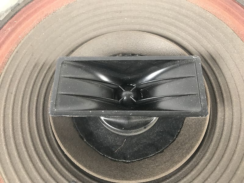

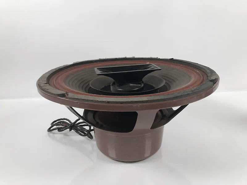

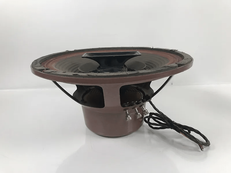

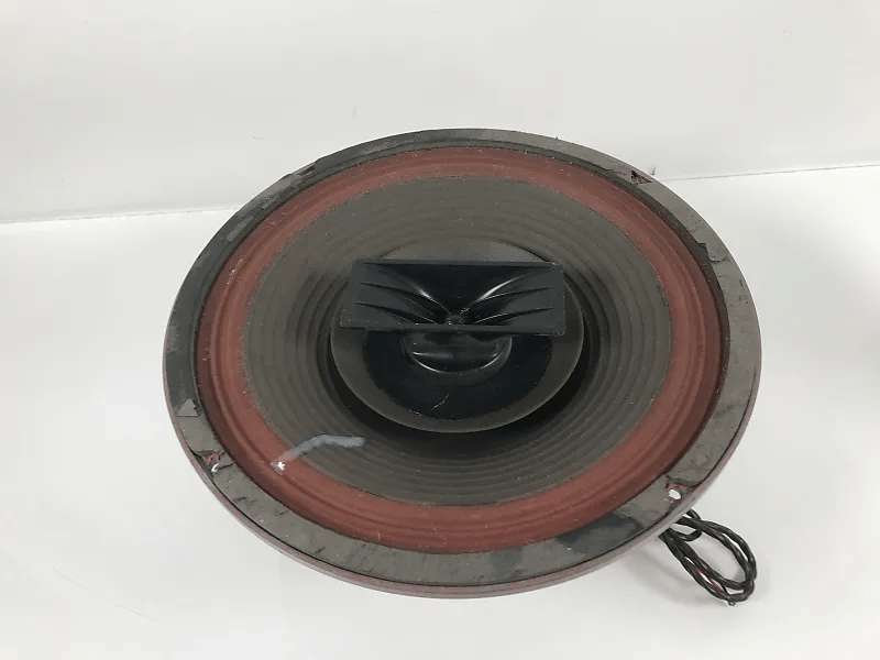

I came across this page while looking for information about another driver:Back to the actually topic - the owner of this coax driver will wait for finding a company, who can carry out the recone procedure on a routine basis - i.e. who has already done this several times - like this company under
https://greatplainsaudio.com/services/
for Altec Lansing.
https://speakerrepairshop.nl/en/bilder/c-23
info@goodhifi.com
I'll ask there next days.
This FANE model is close to those from attached files - so I think-
P.S.: who know companies in European Union like those from United States under

That, if at all possible.
If not, an experienced repair guy can remove the whole "soft" assembly: cone voice coil spider, measure voice coil dimensions: exact diameter (no tolerance there), winding length, former length, and hunt for a replacement.
IF available, he may remove old voice coil with a Dremel (grinding it from the inside) until it disappears, leaving cone and spider with a proper sized hole.
A few 100ths of a mm larger than VC former, so it can slide in.
He can rebuild the speaker with that and the new coil.
