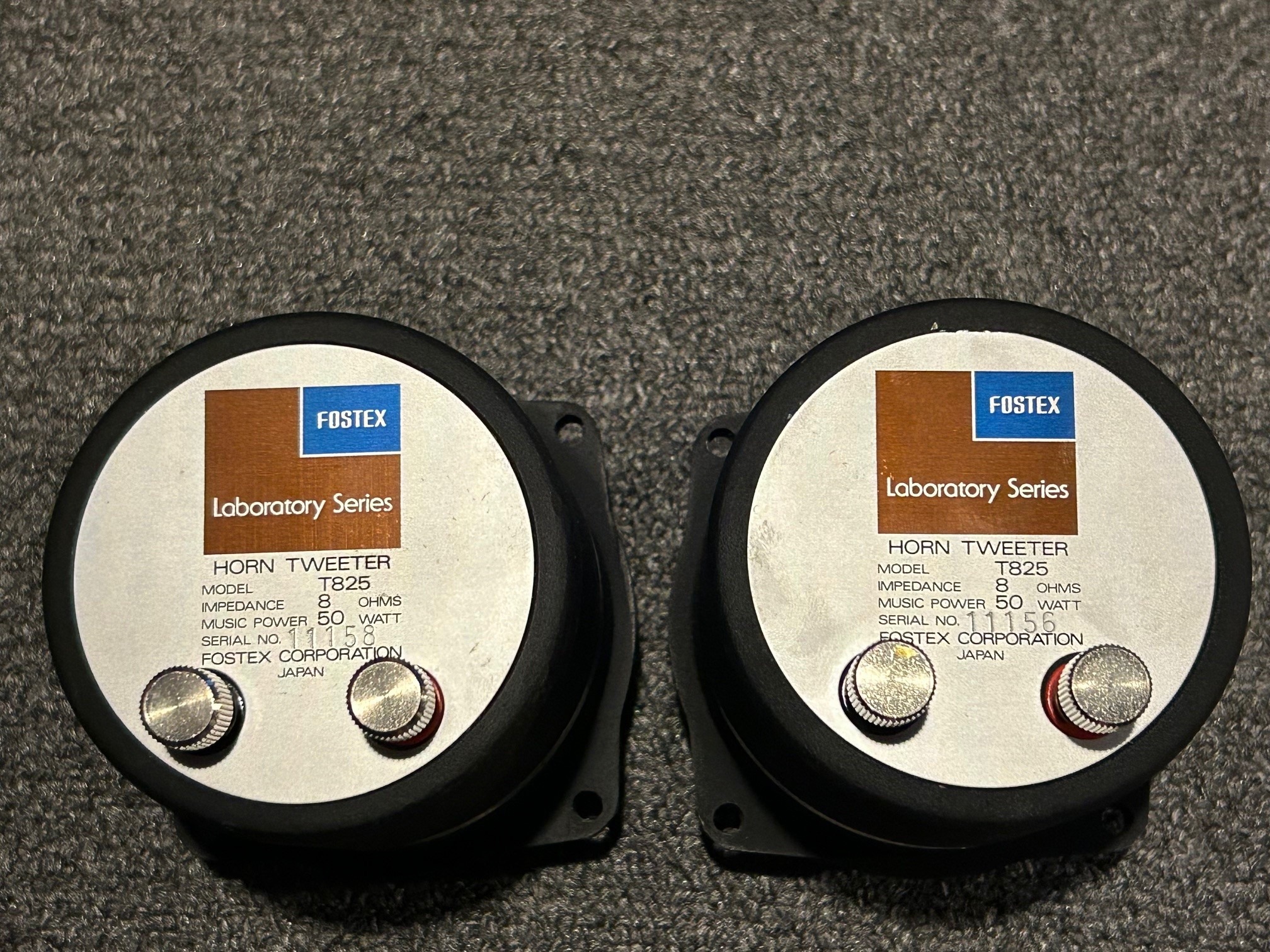

I recently purchased a pair of Fostex T825 super tweeters, probably about 40 years old (originally from Fostex Laboratory series LS/3 monitors).

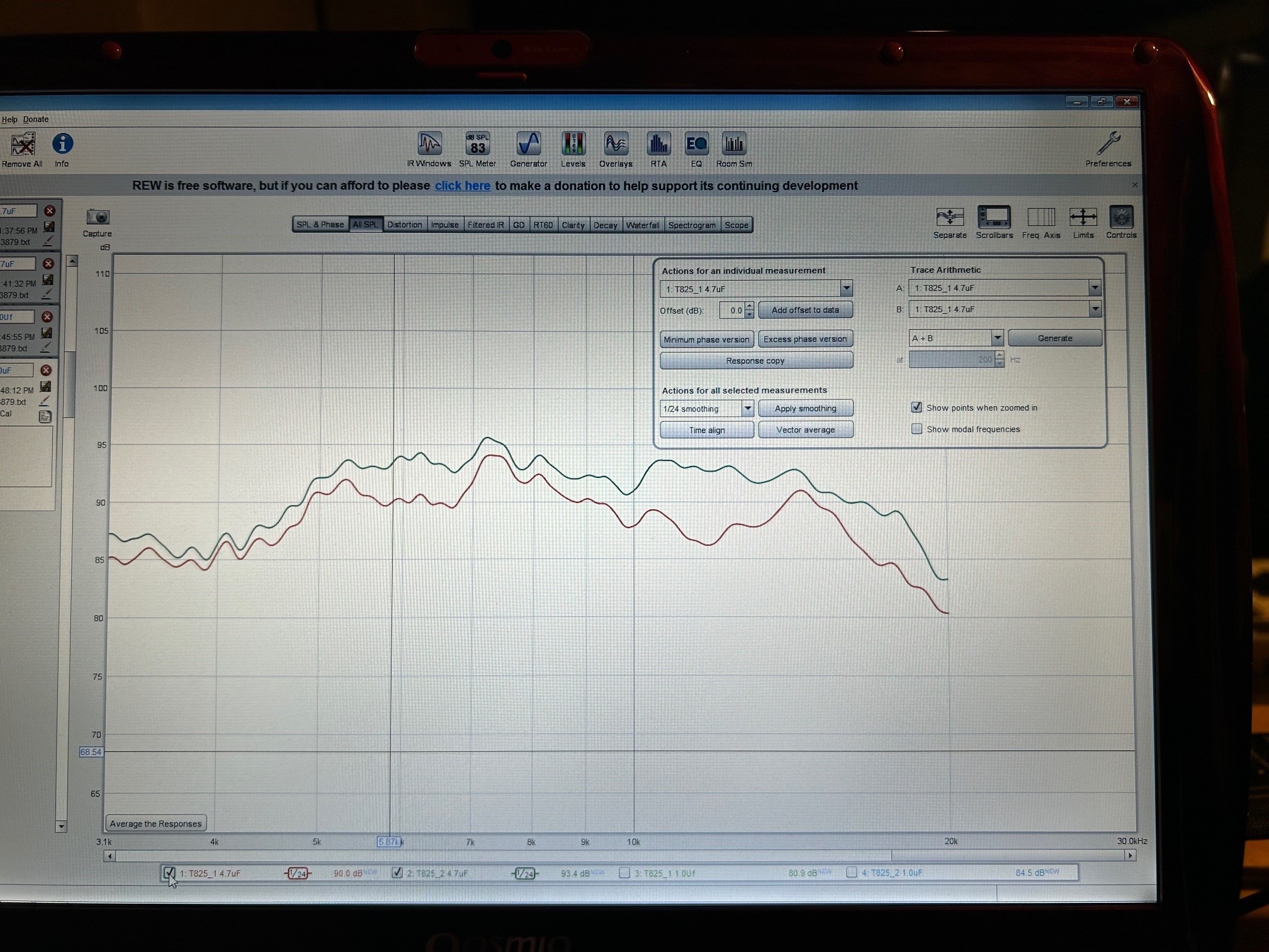

After a quick sweep the measurements lead me to believe one is faulty.
Does the lower trace show signs of a bad diaphragm? Or diaphragm not aligned/seated properly?
One sweep is with 4.7uF cap and another with 1.0uF cap.
Both measure 6.7ohms
Thankfully, the seller is willing to refund if I'm not satisfied.
Looking for some opinions before I bring them back.
Serial numbers are almost consecutive (11156, 11158).

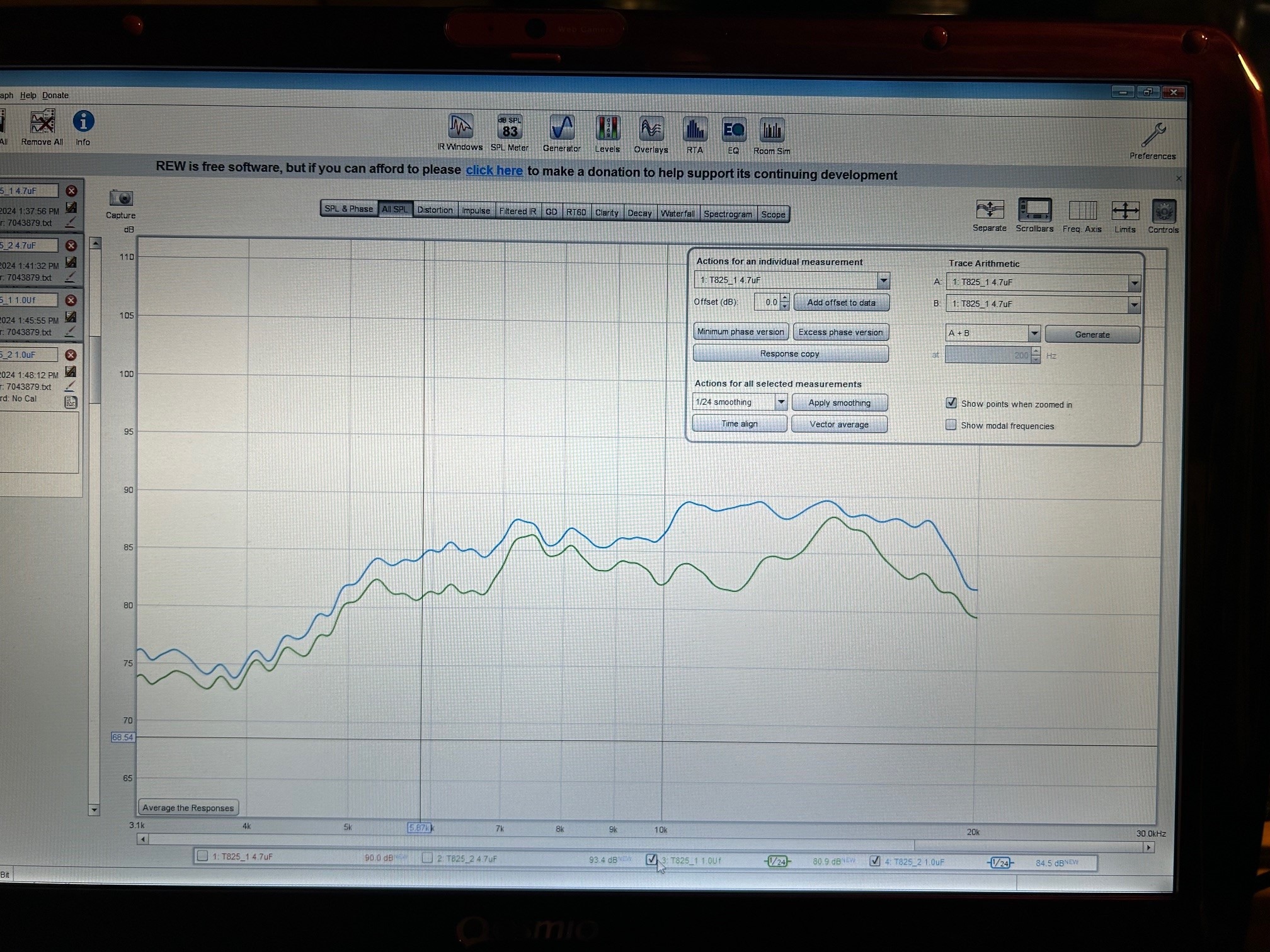

@w_oswald I did listen to a few songs using left channel only, the good T825 sounds "different" compared to the JBL 2405H. Not as dynamic, definitely not as efficient but to my ears bit more refined. I wouldn't claim one is better than the other. Both good in different ways.
The bad T825 sounds filtered, attenuated and less refined compared to the good T825. To be fair, should've listened first, measured after but the 6dB dip around 12kHz is audible.

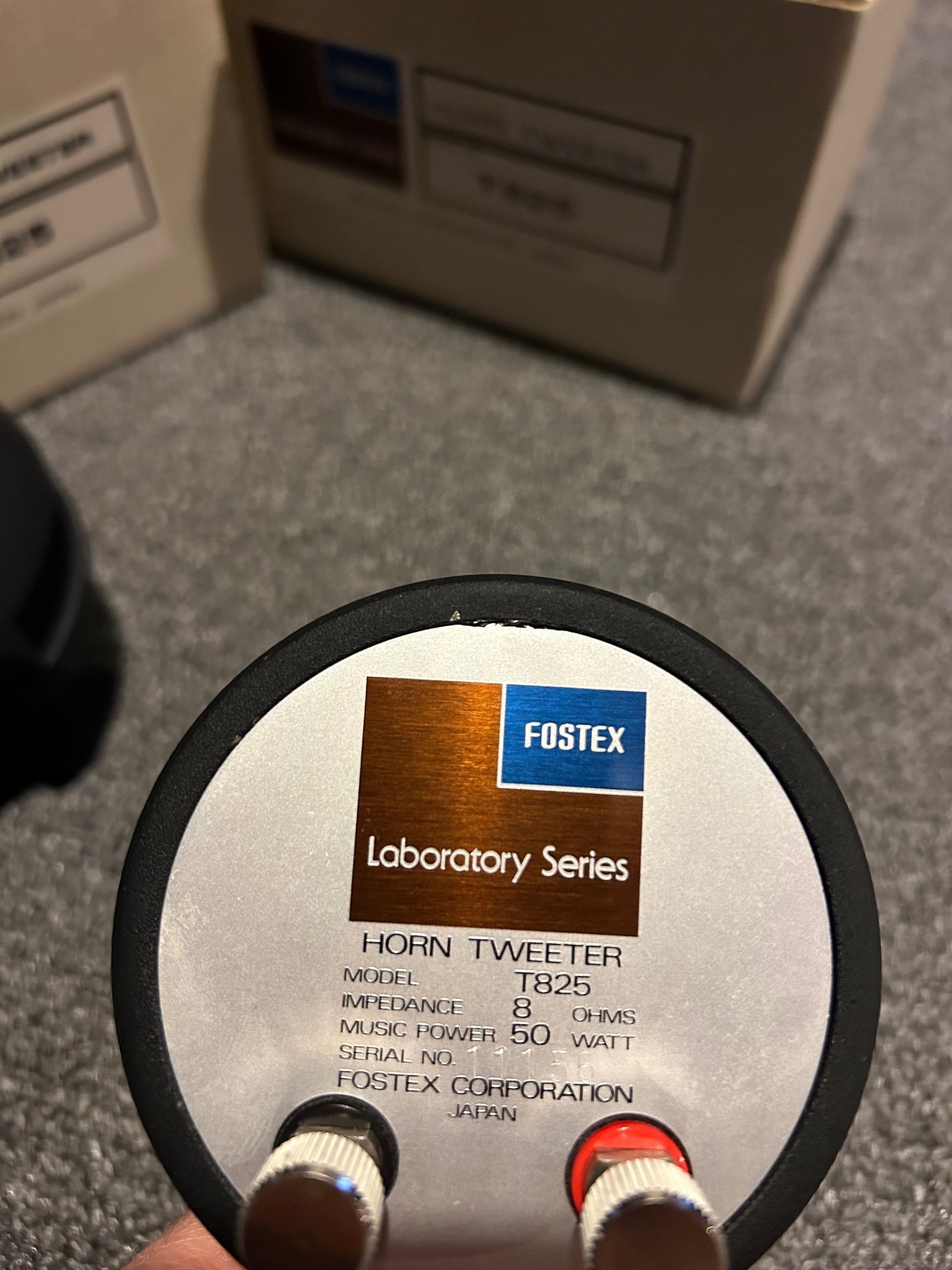

If I was you, I would open them too ;) Clearly you have experience given your suggestions in that post I linked above. The only diaphragm I replaced was a JBL 2445 from original to aquaplas (2450SL) and it was straightforward. My hesitation is ruining the back decal/plate and therefore losing my option for refund... which after further review ... I suspect the bad one was previously serviced. The decal/plate appears to show signs of a removal. The top part of the decal looks chipped like it was lifted before. Now the decal plate is firmly (glued) in place with no play, the good T825 decal has a bit of a loose feel when I tap it.
I wonder if there is two different diaphragms and hence the different response.
Or maybe a repair job that wasn't executed properly.
What do you think about the top of the decal being chipped off?

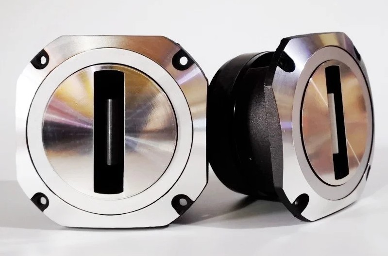

Hmmm: as you're comparing them to JBL 2405H tweeters, I would've thought you'd be after the Fostex T845 units. (Yeah, I know: pretty much unobtanium...) I recently ordered myself a pair of these (new) from AliExpress: Haven't yet had the chance to seriously evaluate them, but they look pretty nice!

Those tweeters you posted ^ look similar to the Beyma CP21. They do look nice, hopefully they sound nice too. Curious to know your thoughts after you give them a fair listening test.

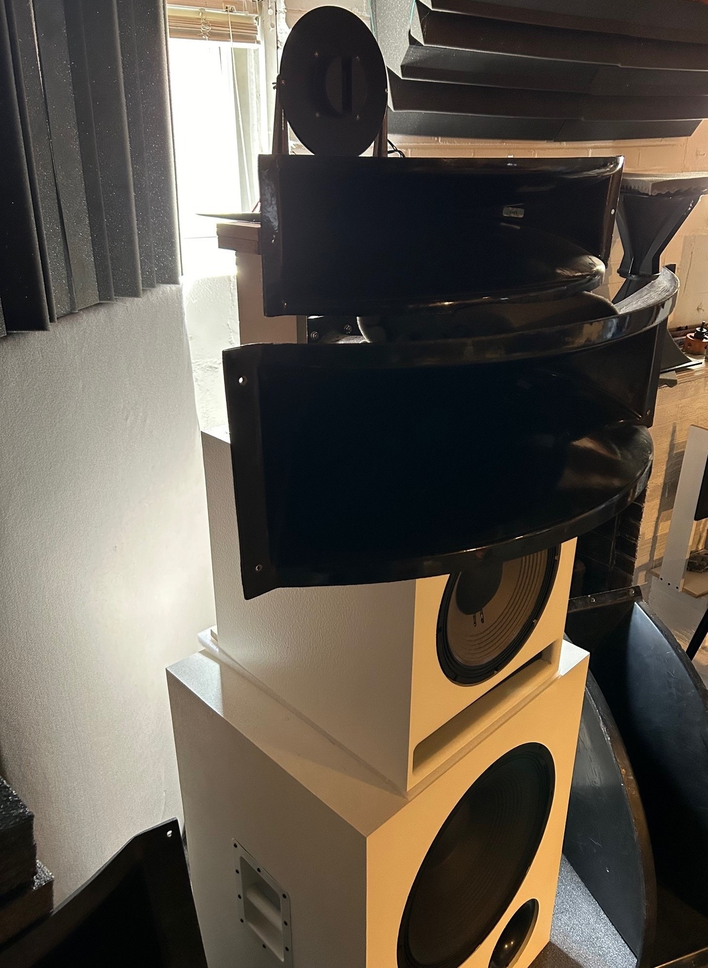

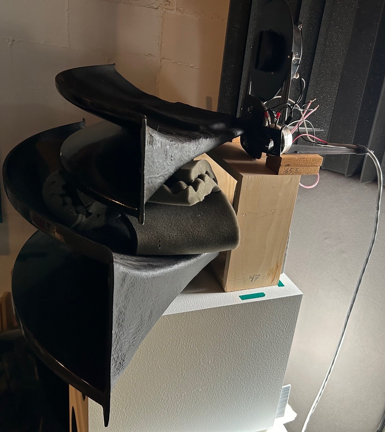

My system is an ongoing work in progress, learn a lot from experimenting. This DIY journey has lead me to understand I prefer the sound of large horns. The 2405H handles the top octave nicely where RCF ND350 begins to roll naturally starting around 10kHz on the big radial horn. Took some playing around to time align/find the correct height for the 2405H to integrate properly with the 1" horn below. Here is some pictures of a DIY Macgyver stand that achieves the necessary height I needed for nice flat response between the two drivers. Bookshelf L-brackets, patent pending :LOL:
Personally don't like using EQ to lift the natural roll-off of compression drivers, sounds a bit off to these ears. Obviously more so with 2" vs 1" but I find the JBL 2405H is effortless in top octave. The complete system sounds better overall with 2405H compared to without, even the midrange and bass is improved for some reason.
