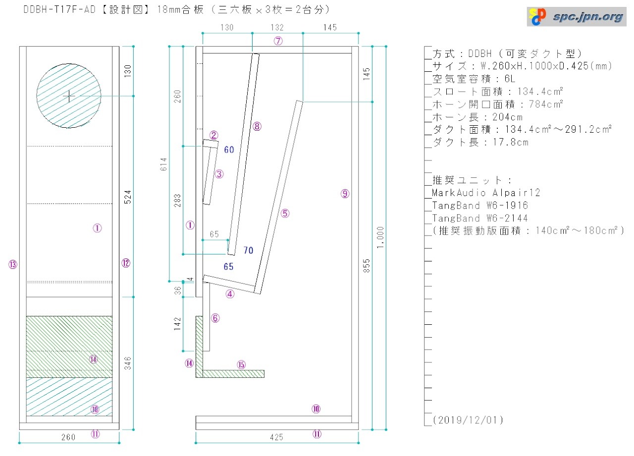

This box would be a good choice for 166ES-R.
Low frequency is adjusted by variable ducting.
https://sites.google.com/view/low-e...-single-driver/-diy-adjustable-duct-type-ddbh
