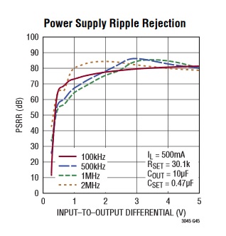

We recommend to set the Vdifference below +0,5VDC.
But actualy looks like below 0.5VDC PSRR drops rock bottom.

True! Things are too narrow with only 0.5V. This is of course only possible with preregulation. With the standard diode bridge/filter cap combination it never occurs in practice.
With preregulation I would keep 1V difference as a minimum to keep the good specs of LT3045. You may ask what the purpose of the preregulation is when torturing LT3045 with only 0.5V :)
Probably some "primitive" THT pre will deal better with heat dispersion.

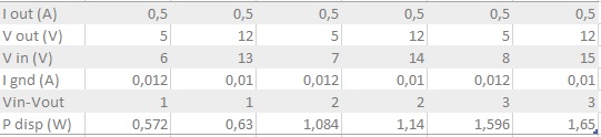

I'm actually researching topic of those chips. I need +5V,+/-12V power supply, each for more than 0,5A to 1A max. So I'm wondering what will be requirements for heat sinks with 2-3V difference.
Took equations from datasheet and it actually does not look bad with 2V difference, about 1W for 5V and 12V supplies. Even 3V doesn't look like a disaster.
Not sure if I have correctly set Ignd, but in case I'm wrong it should look even better.
