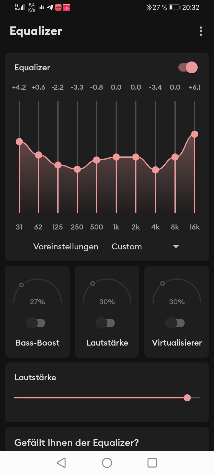

Does anyone eq their full ranges? Mine use helper tweeters, and are highpassed at line level to a sub, so its been pointed out to me they aren't really full range speakers.
Now I've settled on reversing polarity to the second order highpassed tweeters, I find the sound has a lot less sibilants, and a glare in some high pitched vocals after equalizing.
For digital sources like streaming, through a couple of different DACs, or an AVR for TV shows or movies.
With a few different phono stages and cartridge combinations, these colorations don't seem to show up.
Anyone else find this happening with different sources?
I'm not saying the different phono playback combinations all sound the same; my meaning is the different sounds aren't egregious.

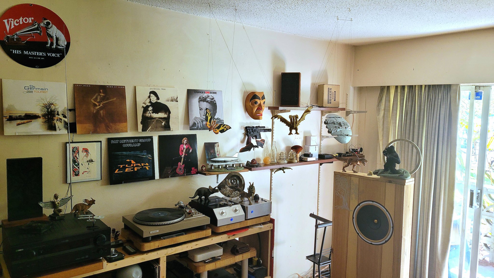

Yep, even back when the Nest was 2.1. I didn't "need" the super-tweeters either really - but prefer the fill for cymbals and the like. I don't use crossovers though and drive with a SET for even lesser use of feedback. And, I didn't really need the sub either, but they are very nice when cut in well ~ one must keep it subtle and tight, IMO. Not many full range drivers will get down to 10Hz. I even (gasp) use DSP on the back loaded horns to reduce the shout from Fostex FE168EZ and correct for my smallish room. All that said, I can defeat each of these things and still get killer sound raw from just my BLHs, even from vinyl. However, I don't prefer that.
I use 3 primary sources: digital (mostly higher rez FLAC) YouTube (Opus), and vinyl. I've tried to optimize EQ for each medium and for me there is not much difference, so I've blown it off; "it's not egregious." I have not rolled phono cartridges. For me the EQ is more about the drivers/enclosures and the room than the source medium. Yet, if the source sucks, you can't EQ in goodness anyway. I do find that my minagere of gear requires I use a delay injector to correct for the differences in processing time spent in pieces on different audio paths (only digital realm stuff). I even have a path now sending vinyl through a (gasp) pro A>D to compare its naked playing to one EQed. Maybe I should just dump the vinyl as the digital always wins bakeoffs, for me and guests.

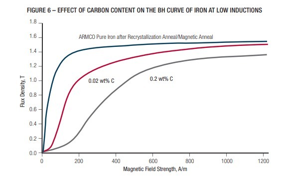

Yes. I'm almost gave up, the most expensive part is magnet structure, to be honest I;m getting trouble finding the right material with less than 0.15% carbon, Armco might be ideal but hard to get in my country, looking curently for something not soo expensive but with less than 0.2% C

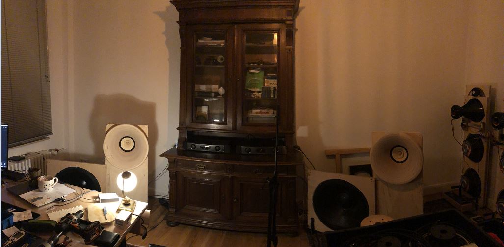

Hi there,
started as a test for a question in this forum about the interaction of a front loaded horn as waveguide for a fullrange speaker with a whizzer cone
https://www.diyaudio.com/community/...how-does-that-work-with-whizzer-cones.410910/
i think i will keep it for a while for my home office room

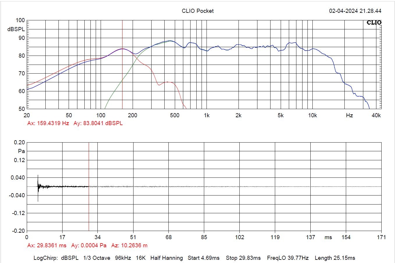

Fullrange and subwoofer technology
21 inch chassis with almost no baffle needs massive PEQ for bass
the waveguide makes a problem with a dip at 5 kHz on axis that goes away off axis
BW4 250 Hz with miniDSP 2X4 HD and PEQ for FR linearization measured about 30 degree off axis CLIO pocket measurement plot
microphone distance about 50 cm - 20 inch

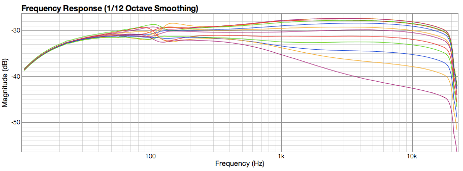

I used twelve Fountek 3.5" full range drivers in this Shaded Array / Constant Beamwidth Transducer based on Don Keele's work. 35Hz-25KHz, high output, 9 octaves bandwidth.
Full technical details in this thread: https://www.diyaudio.com/community/...e-drivers-with-35hz-25khz-high-output.412154/
The thing I'm most proud of is the RC network that shades the signal to each of the 12 drivers differently, which is a solid family of curves. It ensures that all 12 drivers equally share the bass load below 100Hz while shifting the treble to the lower drivers to achieve the desired polar pattern above 500Hz. This also eliminates most of the comb filtering that you get with arrays:
Complete tech details here.

The shaded array is definitely superior. It has much less comb filtering; and if you go to my original post and click on the links to Don Keele‘s website, it explains it in great detail.
http://www.xlrtechs.com/dbkeele.com/CBT.php
Curved arrays are better than straight arrays, that’s why you see them in all kinds of concert venues.
