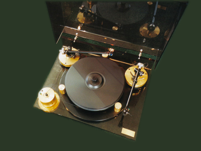

Hi Bernhard,
Thanks for the reply. Very helpful. I'd planned to reply sooner, when I'd made a decision, but one thing led to another and I forgot. With the best prices I can get for the V15 and M97, I've decided to get the M97 for now (1/3 cost of V15). I have a Mission 774 arm just sitting in a box, so I'll order a new armboard from Michell (I think it's an SME mount) and put it on the Gyro as arm #2 for the Shure. It should be compatible.
As for my comment about the V15 and M97 having similar generators, I was hypothesising that if they are similar, there should be a similarity in 'family sound'. Shure would have the economies of scale stuff down by now, so it wouldn't surprise me to find they are basically the same cart with differences noted before. BTW, I found some posts on AA saying both stylus assemblies are interchangable.
The Denon is going in a nice solid arm with good bearings: SAEC 407/23 with the ceramic shell. It managed well with a Decca, so the Denon should be a yawn.
I'll try your suggestion of glycerine to loosen the suspension. Heaven knows what my brother would say. Personal lubricant on my cart; he thinks I'm too fetishistic about the stereo now. :D If that doesn't work, I'll order another from phonophono, but they only have the black conical stylus 103C.
