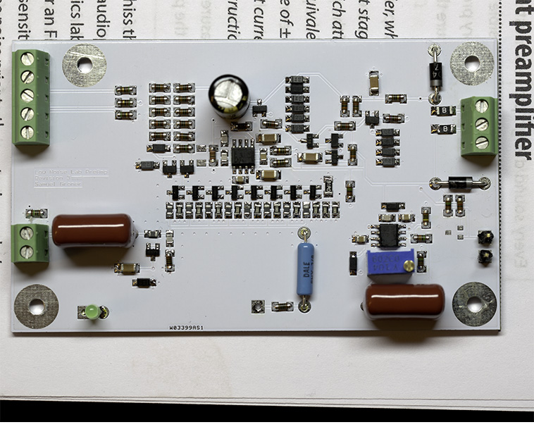

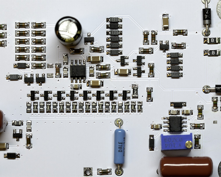

All soldered. (Whoever invented cylindrical surface mount parts needs their head examined.) Hopefully I got the orientation of the op amps and diodes correct. Will power it up tomorrow. How/to what should bias be set?

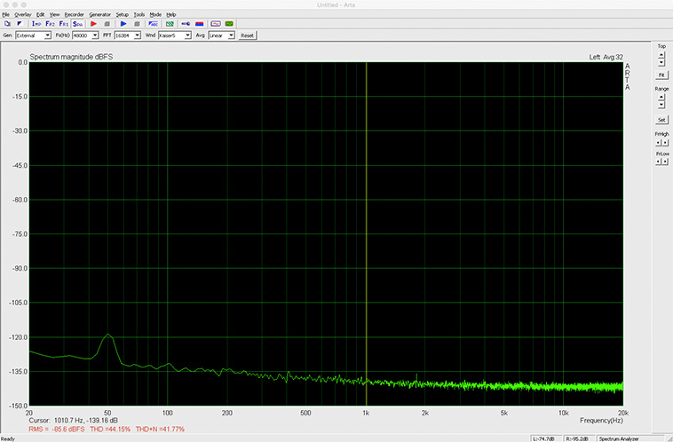

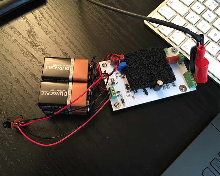

Here is what I get when I short the input to the pre-amp.
I'm just learning how to use ARTA. I have gone through the sound card calibration and setup process. My sound card is an ESI Juli@ XTe and I am using the balanced inputs (1/4" phone connectors). I entered 1000 as the pre-amp gain in ARTA.
I constructed a cable using Gotham Ministar Quad with a Neutrik NP3C-BAG phone connector on one end (stereo for use in balanced mode) and two clips on the other end. The pre-amp isn't yet in an enclosure and so I left the shield unterminated. The "tip" wires were connected to pin 3 of J102 the output of the regulator (third hole from left when looking into the connector) and the "ring" wires were connected to pin 4 of J102.
The pre-amp is powered by 9V batteries.
The output is hyper sensitive to the environment. Just pressing the foam can make a massive difference (usually settling the output lower).
