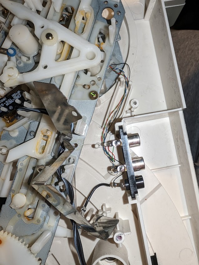

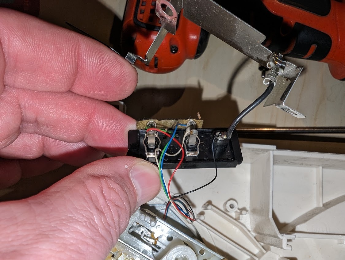

I really like my Technics SL-Q350 turntable other than the higher 60 Hz noise in the right channel. The left channel is great. I want to use it for ripping to digital with the pspacialaudio Stereo Lab software and I'm trying to get an 80 dB SNR in both channels. It uses T4P cartridges that I like, so I am wondering if it is possible to rewire the tone arm at all. The right channel has about 15 dB more hum than the left. I did my best to manage the wires that are easily accessible in the underside of the chassis, twisting the wires for each channel together tightly and keeping them away from other wires had no effect. So the only wire left is in the tone arm and the few inches that go through the gimble. Apparently the wires are far enough apart to create a loop area on just the right channel. The resistance of both channels to the cartridge is the same, around 0.5 ohms. Disassembly looks like hours of work and lots of parts, so I thought I would ask if it's possible to swap wires into that tone arm and T4P head shell?
Oh, hey, thanks for doing the work as moderator! Yes. When I swap connections at the turntable, the hum is always in the channel connected to the left turntable output. I've actually gone so far as to build my own cables, very short, and now have a very low noise balance input preamp setup. Either channel of the preamp connected to the left turntable output works perfectly. What ever channel is connected to the R turntable output has 15 dB higher 60 Hz noise. So in my mind that leaves the turntable wiring as the culprit. As my setup is now balanced input, twisting is important as it makes the coupled noise common mode, which the preamp rejects. With my current setup, single conductor coax cable would be the worst thing to use.

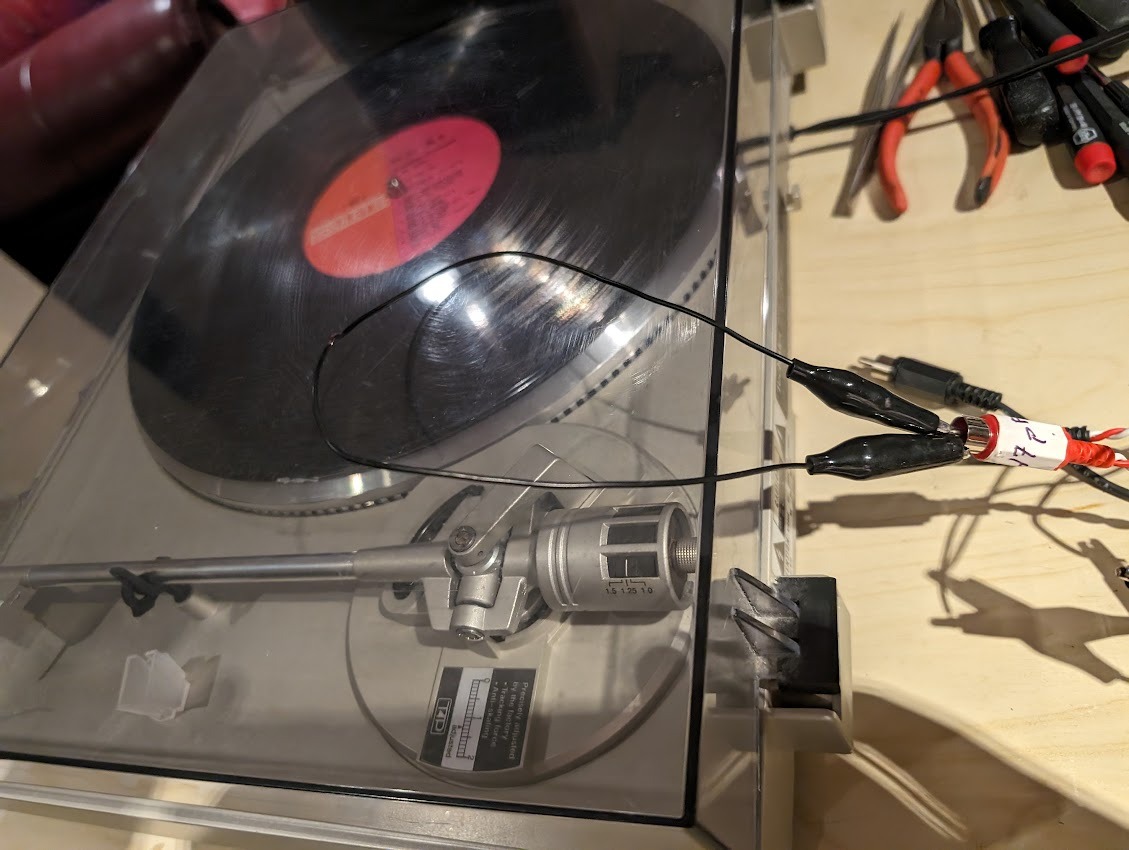

Another test is to take the cartridge out and connect it with four small wires and alligator clips to the preamp.
If the hum is gone, it's the arm wires. Its' a process of eliminating."

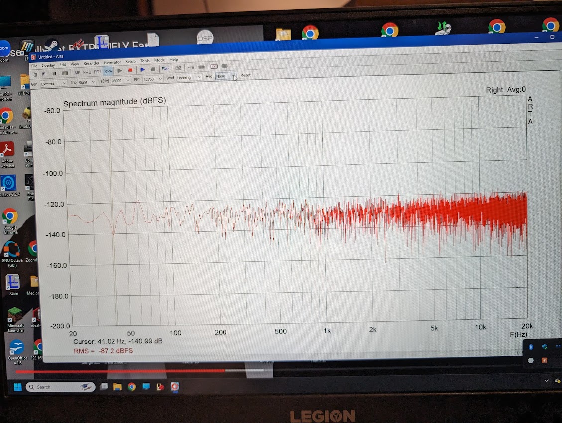

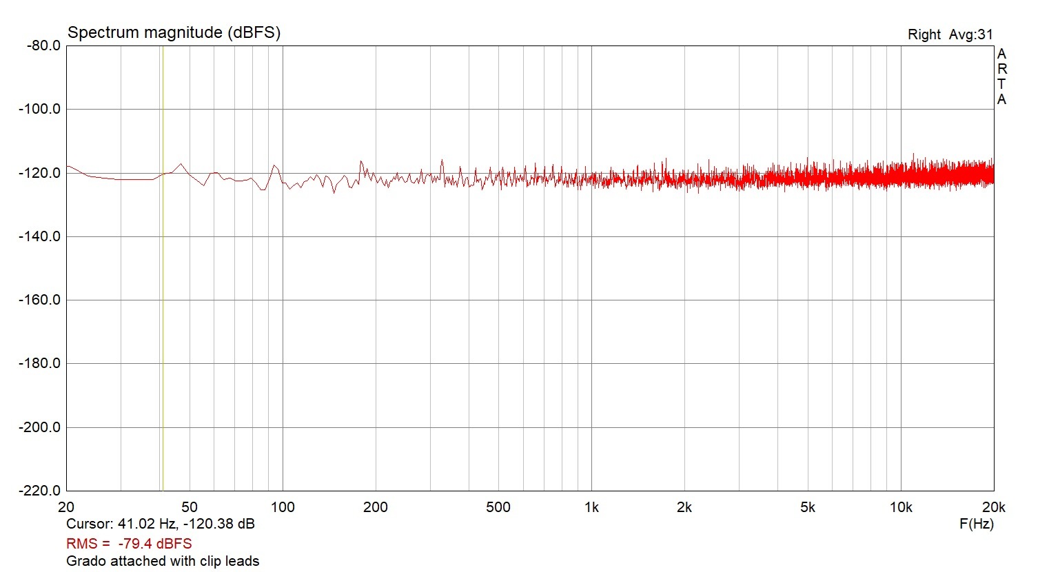

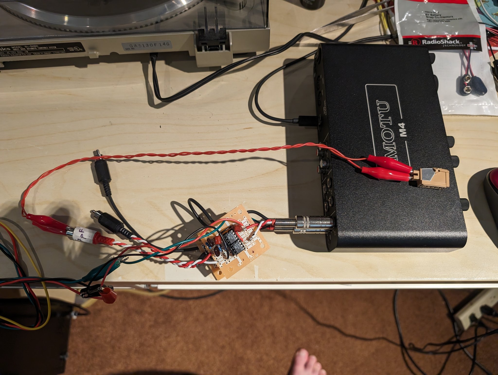

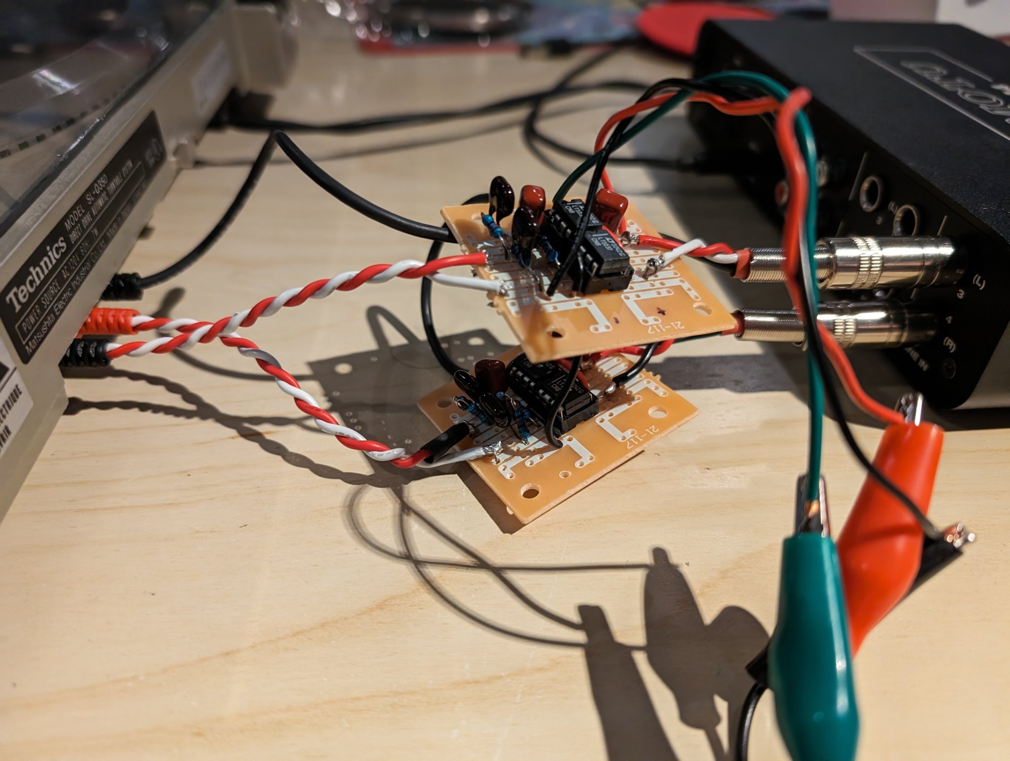

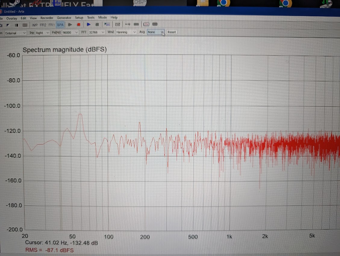

Ok, so I just grabbed two clip leads. It actually worked great. I wired the cartridge directly to the preamp as in the picture. The cartridge is sitting on the MOTU M4 USB interface. The photo with a single trace is from that configuration. No 60 Hz above the preamp noise floor. More than 12" of open twisted pair wire between the cartridge and preamp. The last photo shows the noise when the preamp is connected to the turntable. Left channel looks amazing. Right channel has 60 Hz noise and harmonics. This was a peak hold for about 20 seconds on the spectrum.Ideally, you'd run the test without talking out the cartridge ( PITA to set up correctly )...
Can you simply unclip the tonearm cables from the cartridge -while it's mounted?
If so, you could swap left and right and see if the hum moves with it...

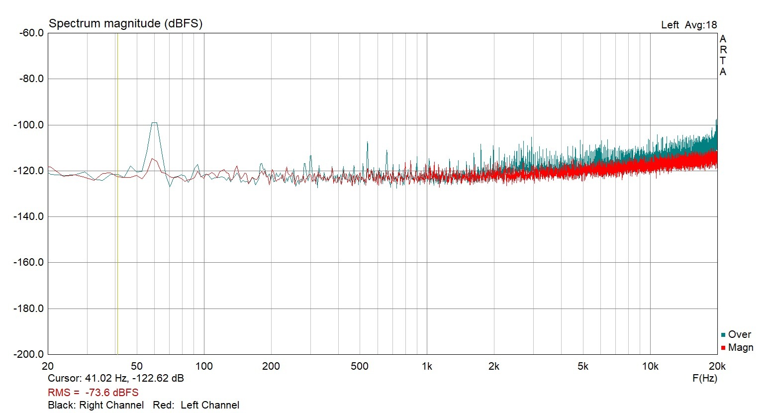

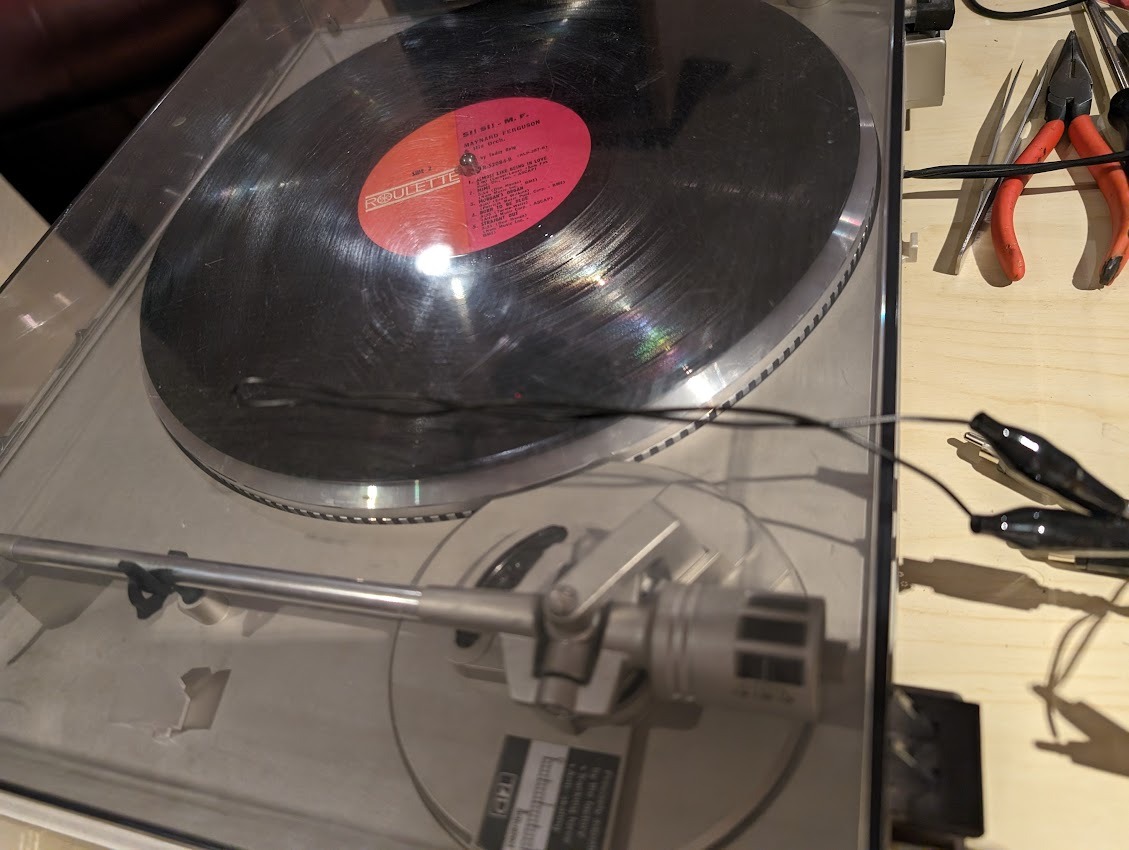

Yeah, I did that to start with yesterday. The setup is the same gain of 100 (40dB) balanced input preamp connected to the channel 3 balanced line level input of the MOTU M4 USB interface. So 0 dB is about 80 mV on these graphs. I didn't use the cartridge, so it really shows how sensitive even a shorted open loop of wire can be. Pretty much an electronics lab test of antenna theory applied to EMI susceptibility. With the cartridge in the loop, it would require a smaller open area between the untwisted wires to get the same sensitivity to the noise. I didn't even do a very good job of twisting the wires here, so the 60 Hz is low, but not as low as the turntable L channel. The first two pictures show the twisted wire and the measured spectrum with a small peak at 60 Hz. I then I opened up a loop area until I reached the same level of 60 Hz noise as I was getting with the R channel of the tone arm. The second two pictures show the open loop wire configuration and the measured spectrum. Both measurements are the accumulated peak values over about 20 seconds. Not perfectly representative of the turn table wiring as they don't have the 400 ohm up to 47k Ohm range of impedance of the cartridge and likely different capacitive coupling of each wire to the chassis contributing to the noise. So I expect if I can get the tone arm wires out, twist them, and reinstall, the line noise susceptibility problem in the Right channel will be solved. It may be a few week before I can get to trying that. It would be great if I can do it with a minimum of disassembly. I need to find a very short screw driver to reach those screws on the underside of the tone arm without removing it from the table. Maybe I can just pull the wires out with out totally disassembling the guts of the turntable.
