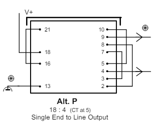

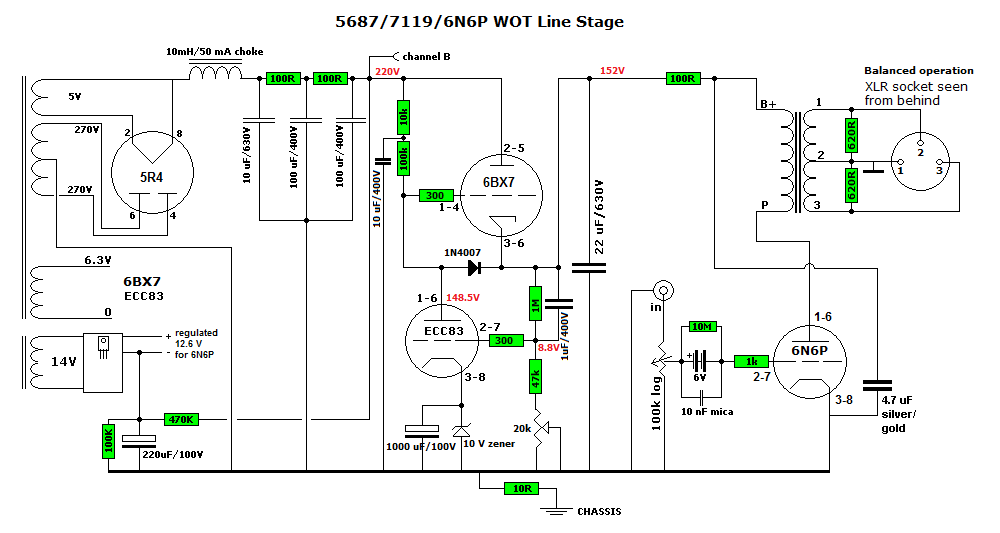

Hi to all experts out there.I just become a pair of LL1689 SE transformers rated for 30mA,now becouse I have with the Lundahls and specific with this typ no experience,plese if someone with experience can tell me if I could use this in the line stage whivh shematics is below.Im using now just simply capacitor pio on ouput.But in my design Im not using 100R resistor on B+ and also no 4.7uf mkp cap from B+ to 6n6p cathode.I will be heppy about any help.
